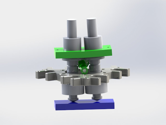

Hmmm, I was sketching a bit, how such a construction could look like and came up with three possibilities.
The two extruder seesaw:
[img]https://lh4.googleusercontent.com/-qo77 ... seesaw.jpg[/img]
spring loaded, to tip over from one side to the other and lock in position. This could easily be actuated by a two way solenoid, controlled via one single arduino pin (second extruder in use command).
A revolver like construction for more than two tools:
[img]https://lh6.googleusercontent.com/-ztPA ... volver.jpg[/img]
Your tool turret approach led me to something similar to a microscope lens revolver. Since we do have bowden tubes and cables running from the hot-ends, unlike microscope lens revolvers, the tools would have to be arranged in something smaller than a semi circle around the disc, to allow for proper mounting of the revolver as well as routing of the bowden tubes. The hard part here is, to control the tool change and lock in position. I don't think that an electromagnet for each tool could hold the disk in place. Probably, it would have to be a gear driven revolver with at least one sensor (end stop) and some locking mechanism (spring loaded ball or a solenoid driven bolt). This would definitely need some more engineering and is possibly not printable so easily.
The third idea would be to only move the tools up and down by either separate solenoids or a motor turned wobble plate. Here, X/Y poitioning is no problem, but the whole force in Z would have to be absorbed.
I think, one of the main challenges will be to get a sturdy, but still lightweight design, which can take forces in all three dimensions and keep position. However, the movement of what ever construction proves to be best, does not have to be big at all. The lift of about 1 mm in Z would be enough. Of course, positioning the new tool on the same x/y coordinates would be preferable, but a loss of 1-2 cm of the build space should be passable.

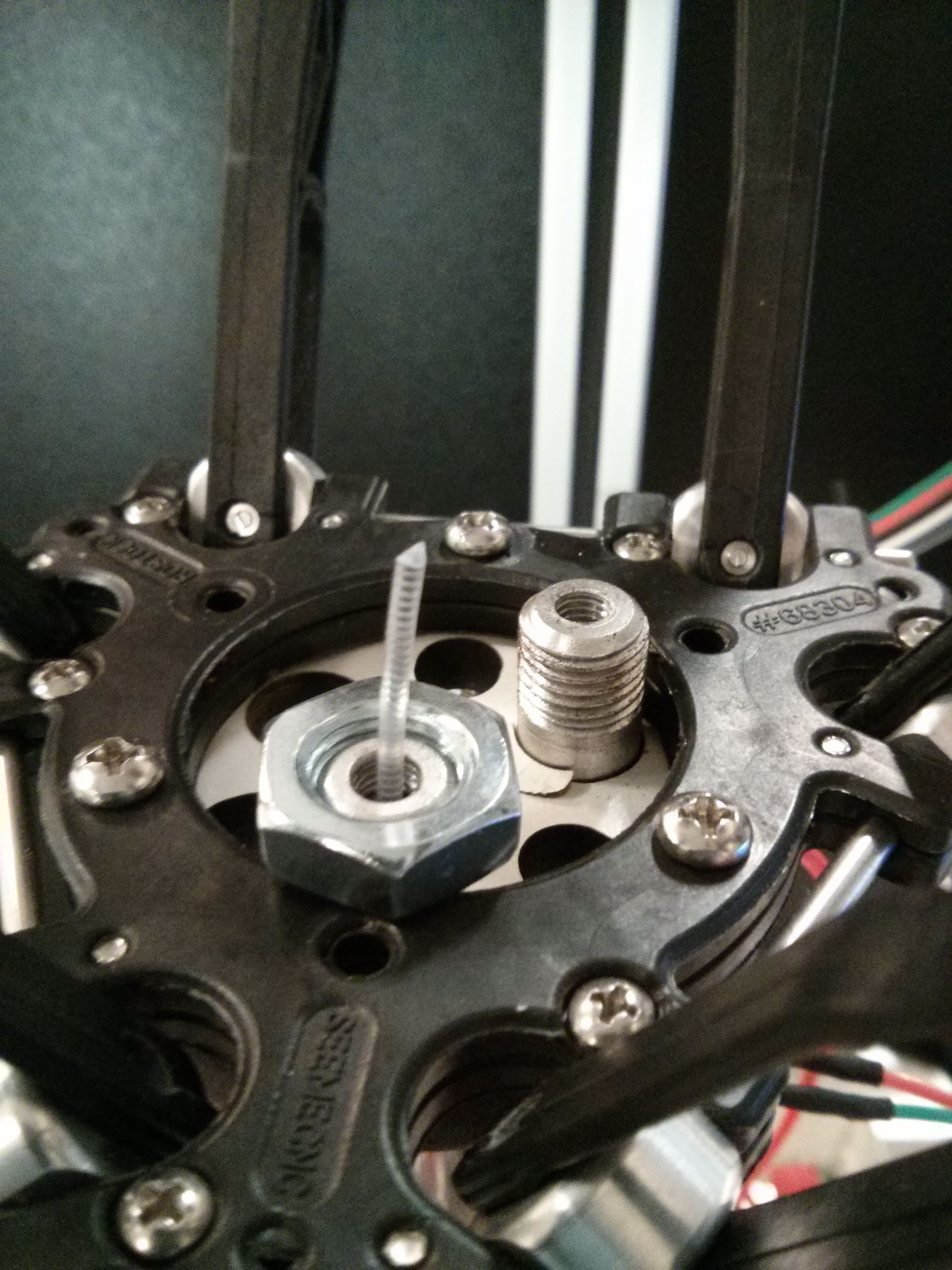

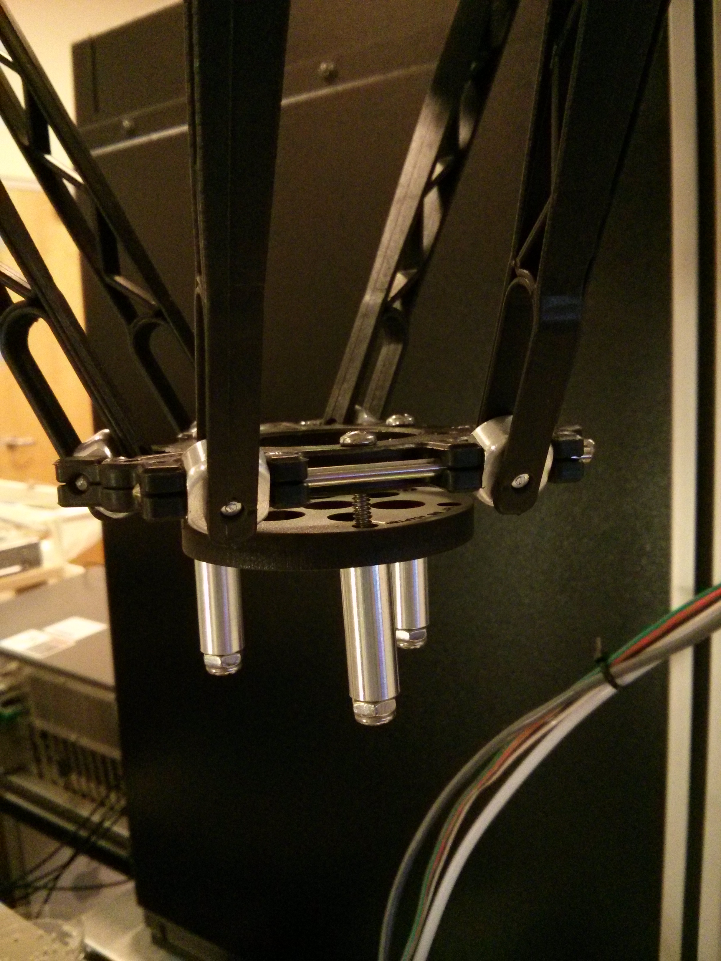

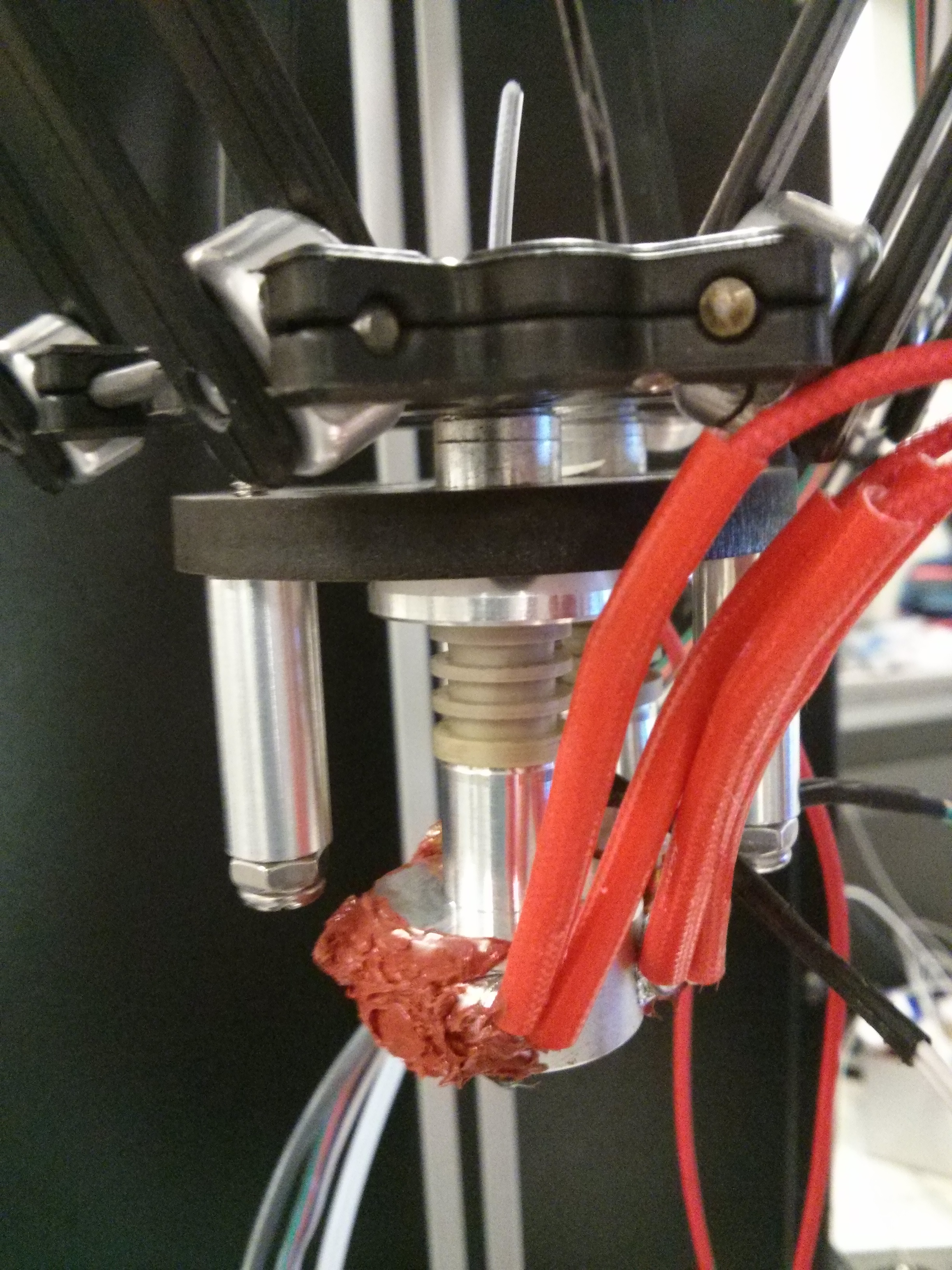

This is an old topic, but I wanted to add an idea I am working on. Using nothing but the stock parts, I came up with a way to mount 1-3 extruders, and level them. I would love input on the design.
Basic idea is to mount the plate under the base, using the screws and aluminum barrels as a way to hold a cooling fan on the PEEK. Next, a spring is placed between the mounting plate and the base on each screw, allowing the adjustment of the height of each head independently.
Advantages: Easy to level, no complicated parts, most parts already included in kit.
Disadvantages: May suffer if base is not stable during movement, as heads are not in the center of the motion (someone else mentioned this before). Currently their is not enough room on the top for the spacer and nut. The nut could be used to adjust the height, so this might work out.
