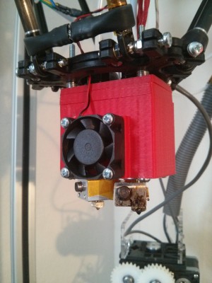

alright i have it wired like this
[img]https://lh3.googleusercontent.com/-F2bO ... 152309.jpg[/img]
i have extruder 1 on heat0, extruder 2 on heat1, bed heat 2
temp 1 on t0, temp 2 on t1, bed t2
i took a fresh seemecnc firmware and modified it as follows
configuration.h
pins.h
note in the configuration.h i changed
from default 7 -> 8 because it was stopping extuder 2 from heating.. heater_2_pin was also 7 so i think there is a conflict.
make sure the drive is enabled in configure.h also
then i connected RH and setup the printer with 2 extruders, and updated the eeprom and made both extruders the same.
now i can control them all

Thanks for the desing! I have my own copy now; thanks for the tip of screwing it *BEFORE* attaching ... hehehe ... simple, but works!dpmacri wrote:Because of the narrow opening in the stock Rostock MAX platform, I made my dual E3D adaptor place the E3Ds as close together as possible. That way the two bowden connectors actually fit through the platform...barely.I actually screw in the bowden's and align their edges *before* attaching the mount to the platform. It works although I need to make an alteration to my design for adjusting the height of one of the extruders because my 2nd extruder nozzle is a few tenths of a millimeter above the glass when the other one is touching the glass
For anyone interested, here's the link to my mount for 2 E3Ds: http://www.thingiverse.com/thing:217662

Here is my copy printed and mounted (already properly credited in Thingiverse, of coursedpmacri wrote: For anyone interested, here's the link to my mount for 2 E3Ds: http://www.thingiverse.com/thing:217662
As per the alignment problem, I added springs between the platform and the adaptor, so I was able to level the two hot ends easier.
Already had my first two color printing today (2 am !); double extruder is just so amazing!
