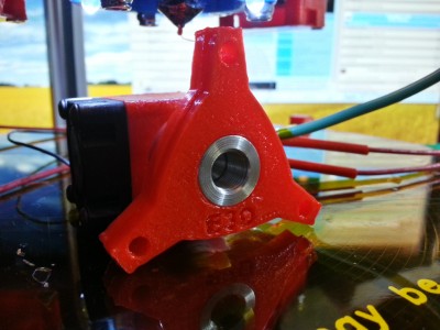

Re: The Ultimate Rostock Thing Collection
Mounting plates for an E3D hot end, which accommodates the Bowden option: http://www.thingiverse.com/thing:137140
Should work with other groovemount heads, as long as they don't need external support for PTC fittings.
[img]http://forum.seemecnc.com/download/file.php?id=2828&t=1[/img]
