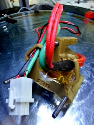

Couple easy and highly useful mods I figured out for the E3D.
First, consider potting your heating resistor with f̶i̶r̶e̶ ̶c̶e̶m̶e̶n̶t̶ RTV. Put a thin layer on the outside of it, push it in one side of the heater block with a gentle twisting motion, then do the same from the other side of the heater block to get a good coat on the inside of the block before you press it in. Then, seal up both ends (making sure to coat all the metal of the resistor casing) with some more RTV. If you do this, you will notice a LOT more thermal stability in the temperature curve screen. Much less over- and under-shooting, and I think it heats up a little faster. (Not that the E3D needed much help!) Because the hot end can run more efficiently, it should sink less power and last longer. Relying only on the grub screw to secure it lets a bunch of air get between the resistor and the heater block, and this fixes it.
Second is a preemptive fix for two things: PLA jams, and buzzing noises as the shroud vibrates against the platform. It's easy. All you need is about 2" of half-inch-wide Kapton tape. Cut this into three strips. Line up the bottom of the fan shroud with the bottom of the lowest cooling fin, so they form a plane together. Use the Kapton to seal the seams. This will ensure that the shroud is always properly lined up (which it needs to be to do its job), that no air leaks down (which will drive up the duty cycle & encourage melt creep), and that it can't "buzz." This can also revive a fan shroud that's warped because of the cooling fan being left off - it's the first thing to get ruined, and it likes to let go of the heat sink and flare out so that air can escape out the bottom.

Can you snap a pic of your tape job?626Pilot wrote:Couple easy and highly useful mods I figured out for the E3D.
First, consider potting your heating resistor with fire cement. Put a thin layer on the outside of it, push it in one side of the heater block with a gentle twisting motion, then do the same from the other side of the heater block to get a good coat on the inside of the block before you press it in. Then, seal up both ends (making sure to coat all the metal of the resistor casing) with some more fire cement. If you do this, you will notice a LOT more thermal stability in the temperature curve screen. Much less over- and under-shooting, and I think it heats up a little faster. (Not that the E3D needed much help!) Because the hot end can run more efficiently, it should sink less power and last longer. Relying only on the grub screw to secure it lets a bunch of air get between the resistor and the heater block, and this fixes it.

Surebubbasnow wrote: Can you snap a pic of your tape job?

You call it "fire cement", but your picture looks like RTV. Did you use RTV just on the outside or in the inside as well? If not, do you have a link to the "fire cement" you used?626Pilot wrote:Couple easy and highly useful mods I figured out for the E3D.
Re: E3D V4 All metal hotend
It's RTV.dpmacri wrote: You call it "fire cement", but your picture looks like RTV. Did you use RTV just on the outside or in the inside as well? If not, do you have a link to the "fire cement" you used?
Thanks! I hadn't finished setting up my E3D, yet, so I just took out the heater cartridge and followed your advice626Pilot wrote:It's RTV.dpmacri wrote: You call it "fire cement", but your picture looks like RTV. Did you use RTV just on the outside or in the inside as well? If not, do you have a link to the "fire cement" you used?
