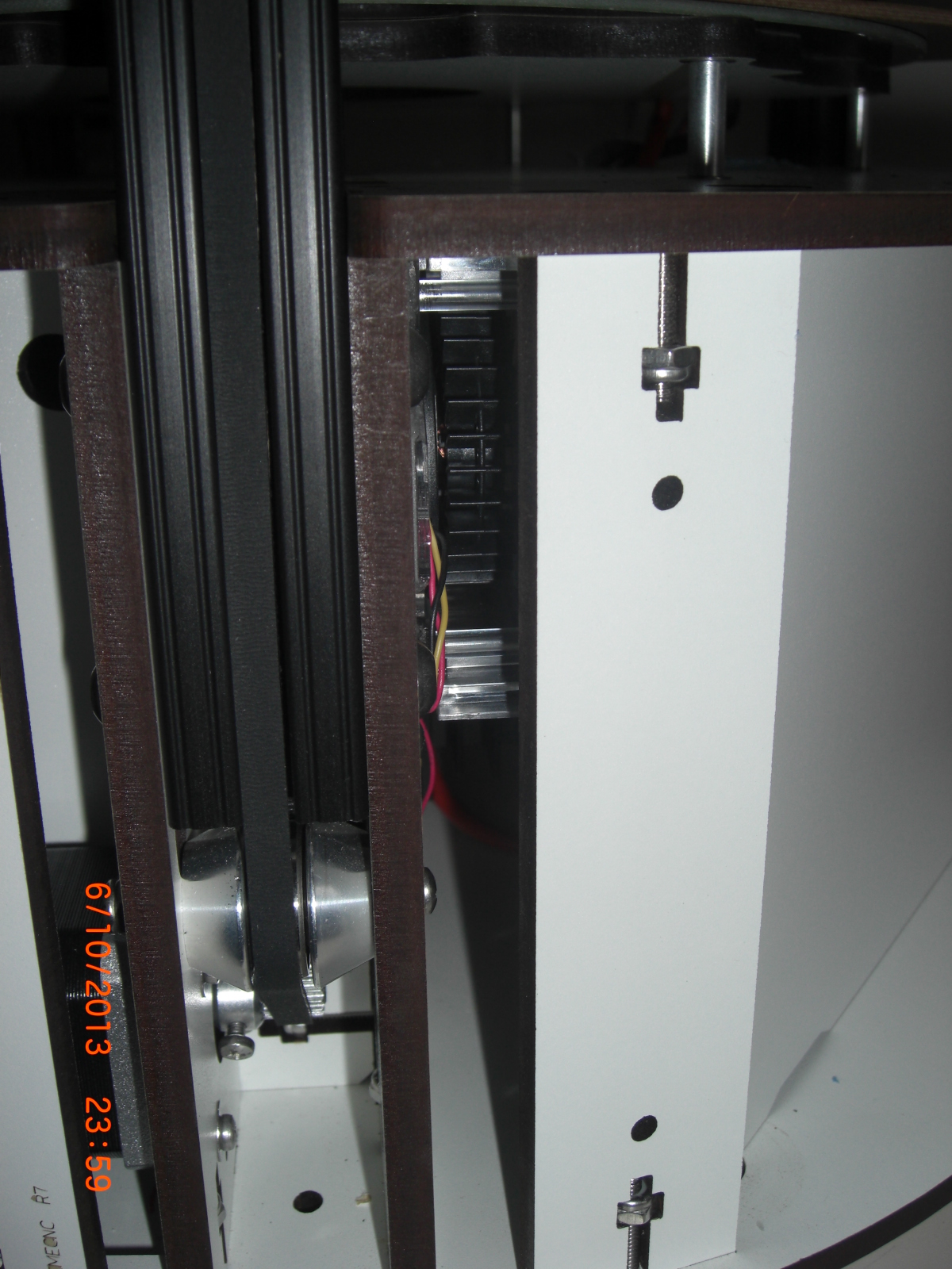

It works fine with the 24V supply but it does get pretty hot. After the bed has been 100C for an hour, the heat sink is 70C (about 155F). I moved it to the other compartment behind the LCD display to keep the Rambo compartment cooler.
The Opto 22's may be worth the increased cost if, as Cambo3d said, they run more efficiently and don't need to dissipate as much heat.

Broose wrote:Here is the SSR I used: http://www.amazon.com/gp/product/B005X4 ... UTF8&psc=1
with this heatsink: http://www.amazon.com/gp/product/B005D6 ... UTF8&psc=1
That's the same combo i'm currently using, but mine doesn't get that hot. just barely warm to the touch. do you have a drawing of how your wiring it? I have a fan in my compartment also. top left corner in the pic. It's a computer chipset motherboard fan that fits nicely in the corner and vents out between the hole cover supports. Also, I'm only running my bed at 85c so that could be the difference here. Maybe I'll take some measurements with my thermocouple at various bed temperatures and post results. I believe i can go to 125c before the software safety kicks in.

cambo3d wrote:That's the same combo i'm currently using, but mine doesn't get that hot. just barely warm to the touch. do you have a drawing of how your wiring it?
Nice looking wiring job. I especially like the circuit breaker- is that a 20 amp?
I don't have a wiring diagram drawn, but here is a connection list
SSD Pin 1, plus output -> 24V supply V+ (fused)
SSD Pin 2, minus output ->Onyx plus side
SSD Pin 3, plus input -> Rambo Heat2 Bed plus
SSD pin 4, minus input -> Rambo Heat2 Bed minus
24V supply V- -> Onyx minus side
