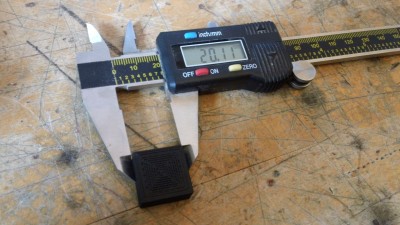

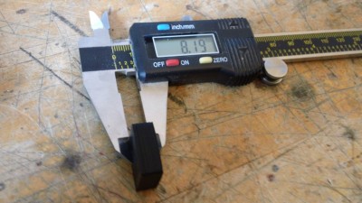

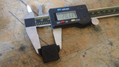

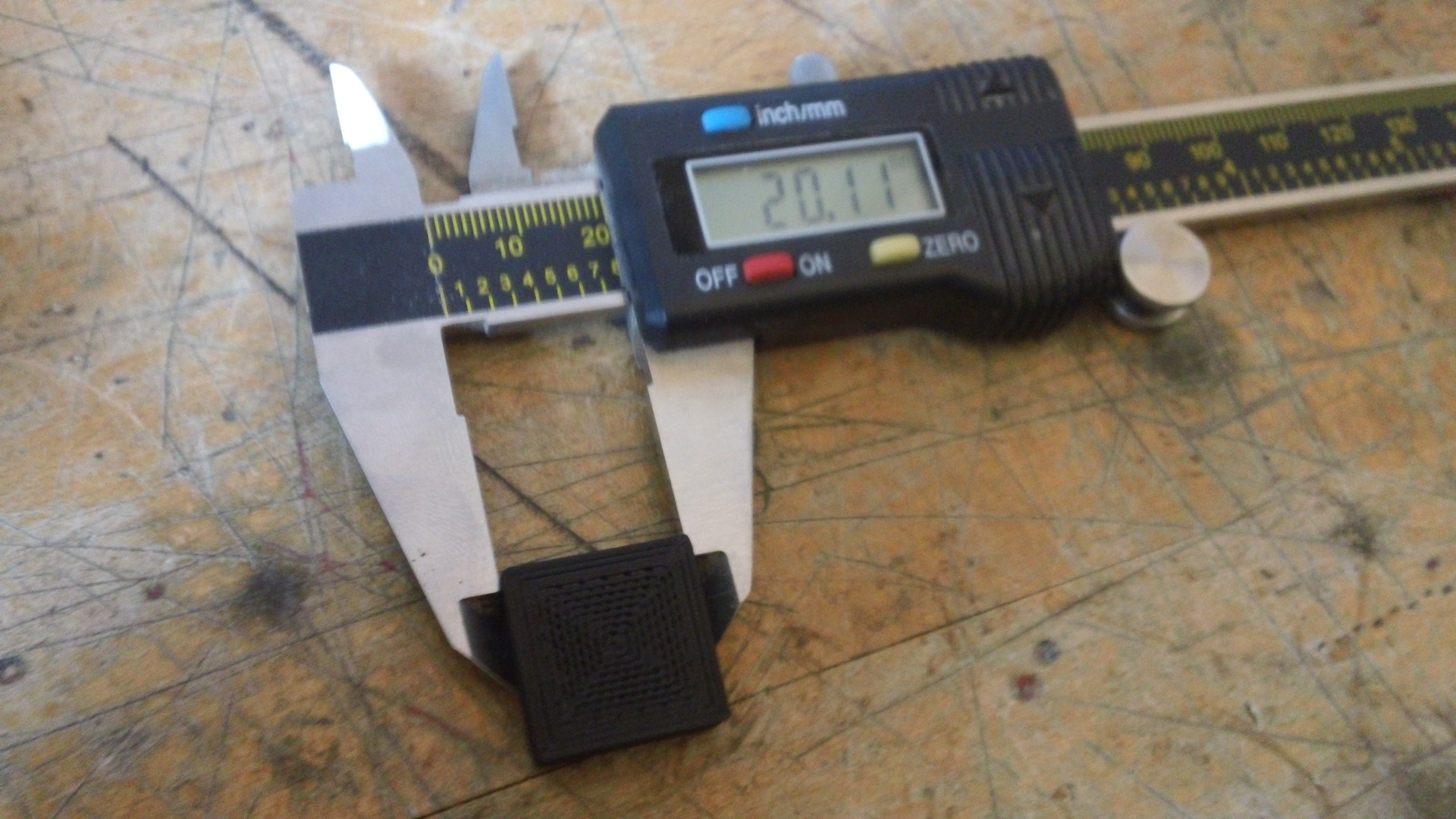

My Printer is fantastic with the only problem being that all of my prints turn out about 20% shorter than they should be. I have included photos of what should a 20x20x10 box. Sometimes I can compensate before I print, but guessing how much altering I should do has become a hassle. Perhaps this friendly community has some suggestions. Normally I could just trail and error change my settings to try and find my problem, however my attempts are futile to say at the least. I am running the newest Repetier-Host, it's bundled with the newest Slic3r, and I am using Marlin for my firmware because I have had... issues with Repetier-Firmware. Many thanks for any response and constructive critizism. Cheers!
X axis
Y axis
Z axis

I do believe your z-axis steps per/mm are 19.1% low. Have you verified that the call for 20mm gets you 20mm in lift?
