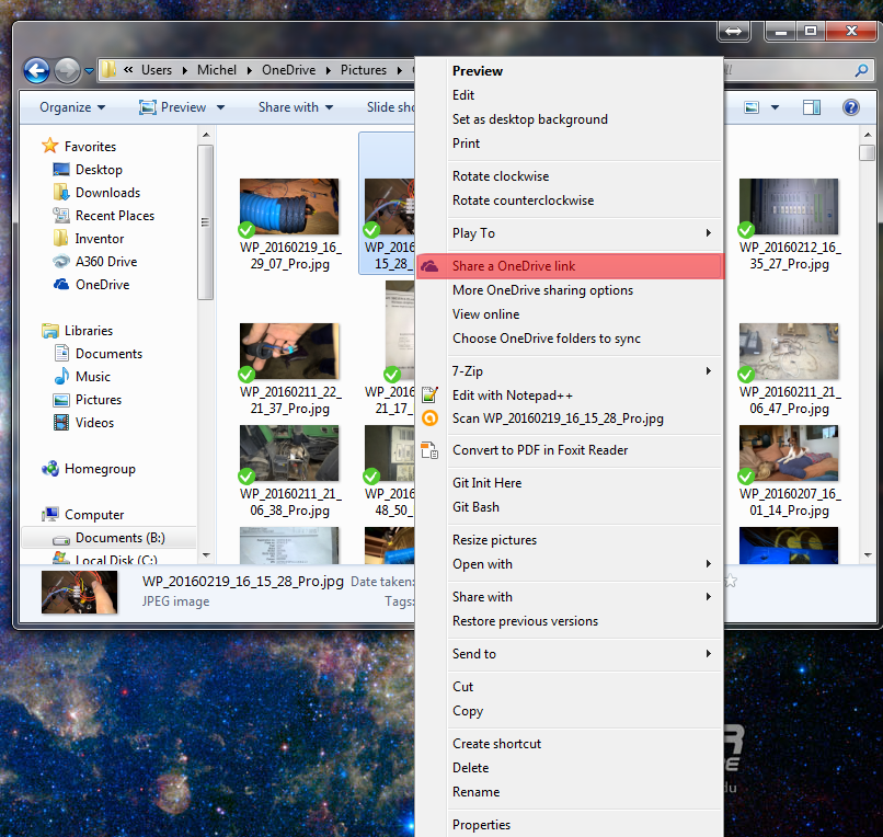

For sharing your onedrive pics, right click the image and select "Share a onedrive link" like here:
and paste it into whatever: https://onedrive.live.com/redir?resid=E ... hoto%2cjpg

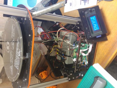

Hello to all
This is my setup:
And the DC converter is a 30A one

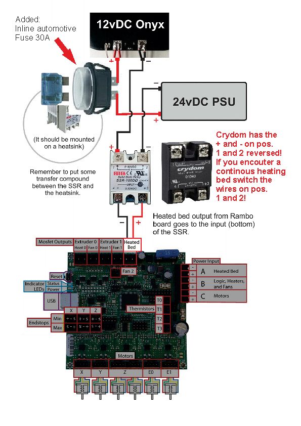

To me the wiring sketch you posted looks okay and is basically how mine is connected. One question however is on the 24VDC to 12VDC converter, how did you handle or connect the magic yellow wires?
Looks like on the 24VDC side connect the yellow to the red but on the 12VDC side the yellow should just float or be cut.

Yes, I connected the yellow to the red in the 24V side and left it unused on the 12V side...

I took Tincho's picture from the OP because that's what I used to upgrade my Max V2.
I made 2 additions:
- I have a Crydom D1D40 instead of the (ill advised) Fotek, and my Onyx heated up directly after switching on the whole mikmak. Better looking I found that the plus and minus on the output side are reversed compared to the fotek. Switching the wires resolved the problem. I have been heating the Onyx to 90C for a minute or 20. It gets the temp up dramatically quick (with the voltage of the PSU set to the minimum of 20,5V, I can't turn it lower any more than that). This SSR does not get warm at all! I strapped it to the metal of the PSU thinking it gets a bit better cooling than none that way.
- I read elsewhere that an inline fuse is advised. I found the one I added in the picture below. Looks nice and you can stick it in a hole in the base for easy changing (although the base will most likely have to be opened up if the fuse fails anyway...) What Fuse should I use. 30 Amps? Perhaps 25 would be sufficient, but I guess if the Onyx shorts that makes no real difference if a 25 or a 30A fuse gets burnt.

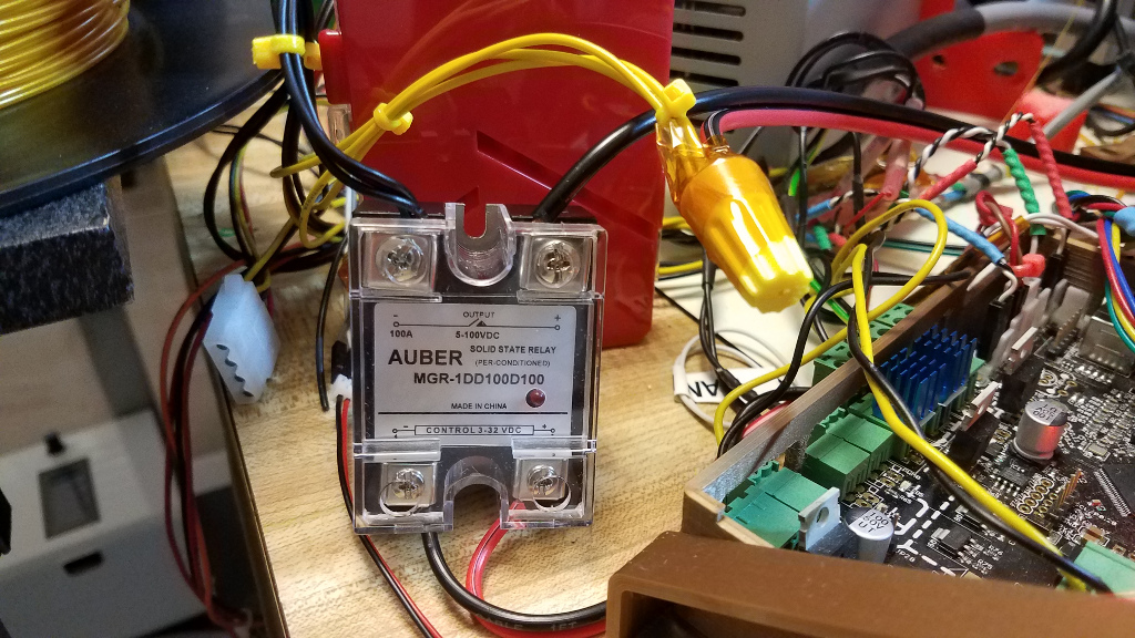

Does this look right? I'm using the old 450W Viotek power supply, using the SSR to bypass the MOSFET on the controller because the plug gets hot. I'm using three each of the + and - wires from the PSU.
PSU +12V to Onyx + through a wire nut
Onyx - to SSR +
SSR - to PSU Ground
Is that wire nut OK, or is it going to give me trouble?
