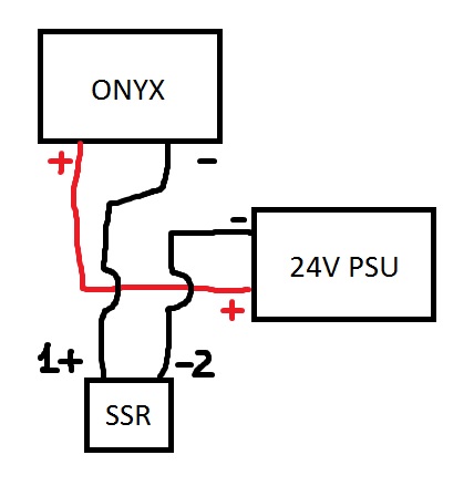

I'm kinda scared to do the 24v update. So please, excuse the silly question, but why does my SSR have different outputs?
Both will handle a + load so... does it matter where to connect the + psu or the + bed?
rpress SSR (Albertus Magnus thread viewtopic.php?f=42&t=6539):
OUTPUT 1 (-)
OUTPUT 2 (+)
My SSR:
OUTPUT 1 (+)
OUTPUT 2 (-)
and another thing, It's recommended to add a fuse between the SSR and the PSU.
But of how many amps? and what kind of fuse? a car fuse will work?
Martín S.

For the output of the SSR, put it between the ground (-) of the power supply and the bed. The positive (+) connection from the power supply should go directly to the bed. So think of the connection like this Power Supply (-) -> Wire -> SSR (+) -> SSR (-) -> Wire ->Bed -> Wire -> Power Supply (+).
Oh, and I should have mentioned that I found out this configuration the hard way :-) Originally I had the SSR between the PSU + and the Bed. But that doesn't work -- the SSR ends up always "connected" (I initially assumed I had received a bad SSR) so the bed begins heating immediately. Anyway, once I switched mine around it worked (and is working) great :-D
Tincho85
Posts: 659
Re: Faster Heated Bed
Postby Tincho85 » Mon May 04, 2015 10:54 pm
So insted of interrupting the + you are interrupting the - with the SSR?
Martín S.
dpmacri
Posts: 319
Location: Beaverton, OR, USA
Postby dpmacri » Mon May 04, 2015 11:49 pm
Tincho85 wrote:So insted of interrupting the + you are interrupting the - with the SSR?
Correct. I know it sounds strange, but that's the way it works :-)

After posting my reply, I went out and searched on how to hook up a DC-DC relay and found this: http://www.crydom.com/en/tech/tips/dc%20relays-technical%20guidelines.pdf which seems to indicate that the SSR can be either on the + side or - side of the load. However, for me it didn't work when I had the SSR on the + side. Maybe I had something else wrong, but it's a pretty simple hookup so I'm not sure :-)
Tincho85
Posts: 659
Postby Tincho85 » Tue May 05, 2015 1:09 am
I would buy you a beer but we are a bit far away ;)
It is connected like you said, and everything is working like charm. The PSU was dialed down to 21v just in case.
Now it take less than 5 min to get to 110ºc
The SSR is not getting hot at all, maybe because I only tested the time that takes to heat the bed and did not print anything yet, but time will tell.
In a few min I will be posting this wire config.
Thanks again for your help.

So, this is what I did, and its working... for now :D
Martín S.

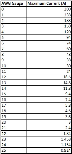

Still don't where to add the fuse. Any help on that matter would be great.
How many amps? and what kind of fuse? a car fuse will work?

Automotive fuse is fine. The fuse just goes in line with the load. Positive or negative leg, before or after the ssr does not matter. Fuses are only used to protect the wiring! By the time the current exceeds the design of the load, the load has already suffered failure so the fuse prevents fire by not allowing the wiring to overheat.
Just as an fyi, remember the glass fuses that used to be in automotive and are still sometimes found under the post in automotive power port plugs, that glas fuse is rated for 250v but works equally well in 12v applications.

On the fuse size, here is some content of a great post at http://www.oznium.com/forum/topic15761

Fuse placement does matter. If the circuit problem is the load, then the fuse can blow anywhere in the circuit and it will be fine.
However if the problem is anything else, you want to fuse as close to the positive voltage source as possible.
Let's say you're working on the machine and accidentally pinch the positive lead of your heated bed with the ground of another circuit. If your heated bed's fuse is on the ground wire, the fuse won't blow and you've got a problem.
