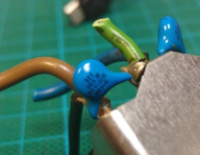

I am gathering stuff for an upgrade to 24v Heated bed and I dismantled some stuff from an old PC style power supply. I want to use a PC style power socket for connecting to the mains with usual PC power cable.
I saw these purple bulbs soldered between the fase and ground pins and it is probably a noob question but: what are they for and should I leave them?
Also I will integrate a switch and I am thinking about a fuse. Any recomendations about a fuse or a circuit breaker?

from what I understand, and don't quote me on this, those are y capacitors meant to filter out noise. You can eliminate them if you want, or choose not to. Personally, I would buy new IEC sockets if they are available to you easily (That is a more proper name for that part, an IEC standard AC receptacle), as that way you can be sure of the current rating, and potentially get a switch and fuse integrated as well. Whatever rating you have on that IEC socket and switch, I would pick a circuit breaker (Or fuse) that has a lower rating than that, by ~15%.

Andre B wrote:MOVs for surge protection.
https://en.wikipedia.org/wiki/Varistor# ... e_varistor
Great, thanks for the info! Would not hurt to leave them be then...

Those Blue lobes are either Film or Mica Capacitors similar to the linked one here on Mouser. They are used to make the power flow/wave form smoother (less noise).
There is a circuit called a 'Decoupling Circuit' that buffers the supply so if there is a voltage spike from say a small surge from the power plant the electronics after the 'Decoupling Circuit" will not see the spike. This is not a circuit that protects from large spikes like the ones you experience when your lights flicker from near lighting strikes. That is a whole another ball of a caps and resistors.

Pretty sure they're MOVs, rather than capacitors.
Seen plenty on lots of devices, they're there for surge protection.
Decoupling capacitors are a whole different kettle of fish, never that small, never right on the 240 V input, and never connected to earth.

I went with Y-caps because it's a computer power supply AC input, and a person who tears down PSU's professionally (Jonnyguru) usually sees the Y caps on the AC in, and they looked to be about that size on the teardowns I saw. see here: http://www.jonnyguru.com/modules.php?name=NDReviews&op=Story5&reid=475, http://www.jonnyguru.com/modules.php?name=NDReviews&op=Story5&reid=471, http://www.jonnyguru.com/modules.php?name=NDReviews&op=Story5&reid=472. From what I saw, MOV's and other surge suppression in PSU's lives on the mainboard. Note that the color and size between the visible Y-caps and our mystery components is very similar. I wouldn't want a MOV attached to the IEC connector. Especially on it's own, due to the risk of thermal run-away making it harder to cut power by pulling the cord at that end. Instead, I would prefer it attached to the board where it can be parallelized, and sink heat to entire chassis, rather than just the AC receptacle and wiring.
Also https://www.tecategroup.com/capacitors/applications/ac-safety-capacitors.php shows that Y-capacitors are usually designed for line to ground connections.

DeltaCon,
Can you please take a closeup of one of those blue components that connect the line to the earth terminals? I'm particularly interested in being able to read the writing.

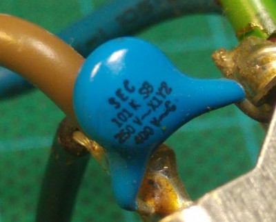

nebbian wrote:Can you please take a closeup of one of those blue components that connect the line to the earth terminals? I'm particularly interested in being able to read the writing.
Yes I can, have fun with it ;-)

Yep, capacitors, specifically an X1Y2 ceramic capacitor. I actually found a datasheet for it here: http://www.semiup.com/pdf/SEC02.pdf

100 pF 10% 250V capacitor
That datasheet also identifies many certification marks I didn't mention, if you're interested.
The testing procedures on the last 4 pages are interesting, as well. 30 seconds in a gas flame, for instance.
And to whoever said it above, these would be classed as line filter caps, not decoupling caps.

Gosh, well you learn something new every day.
I didn't think you could use caps like that, I thought they were always MOVs, designed to pull so much current in the event of a surge, that it trips the overcurrent circuit breaker.
With caps arranged as they are, I would have thought that if you turned it on at the wrong part of the cycle, it might pull enough current to trip the earth leakage breaker.
