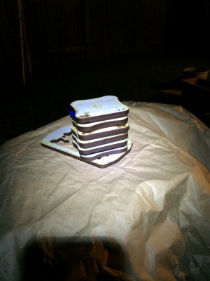

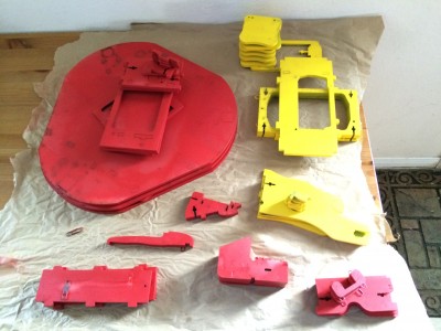

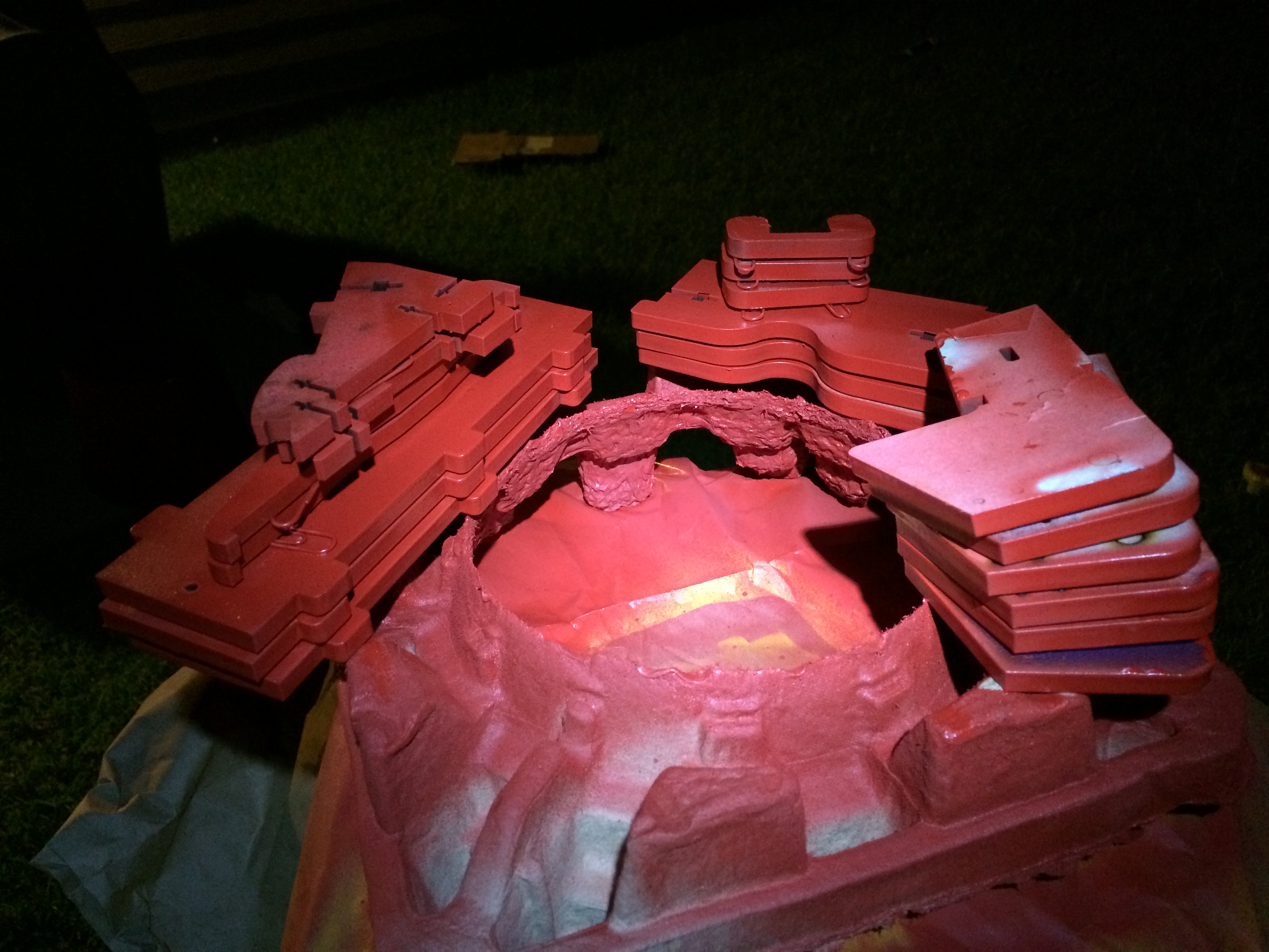

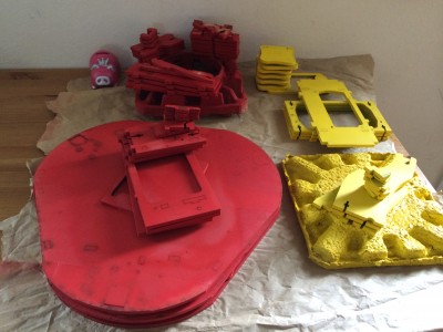

I ordered it black, as I like the combination of black-red-yellow, so, I started by painting the pieces accordingly.
As you can see on the pictures, this paint work was done at night ;-)
before
before
after
after
more
more
now red
now red
everything painted, ready to be peeled!
It is so exciting building a new kit again, after so many advances since the original one!.

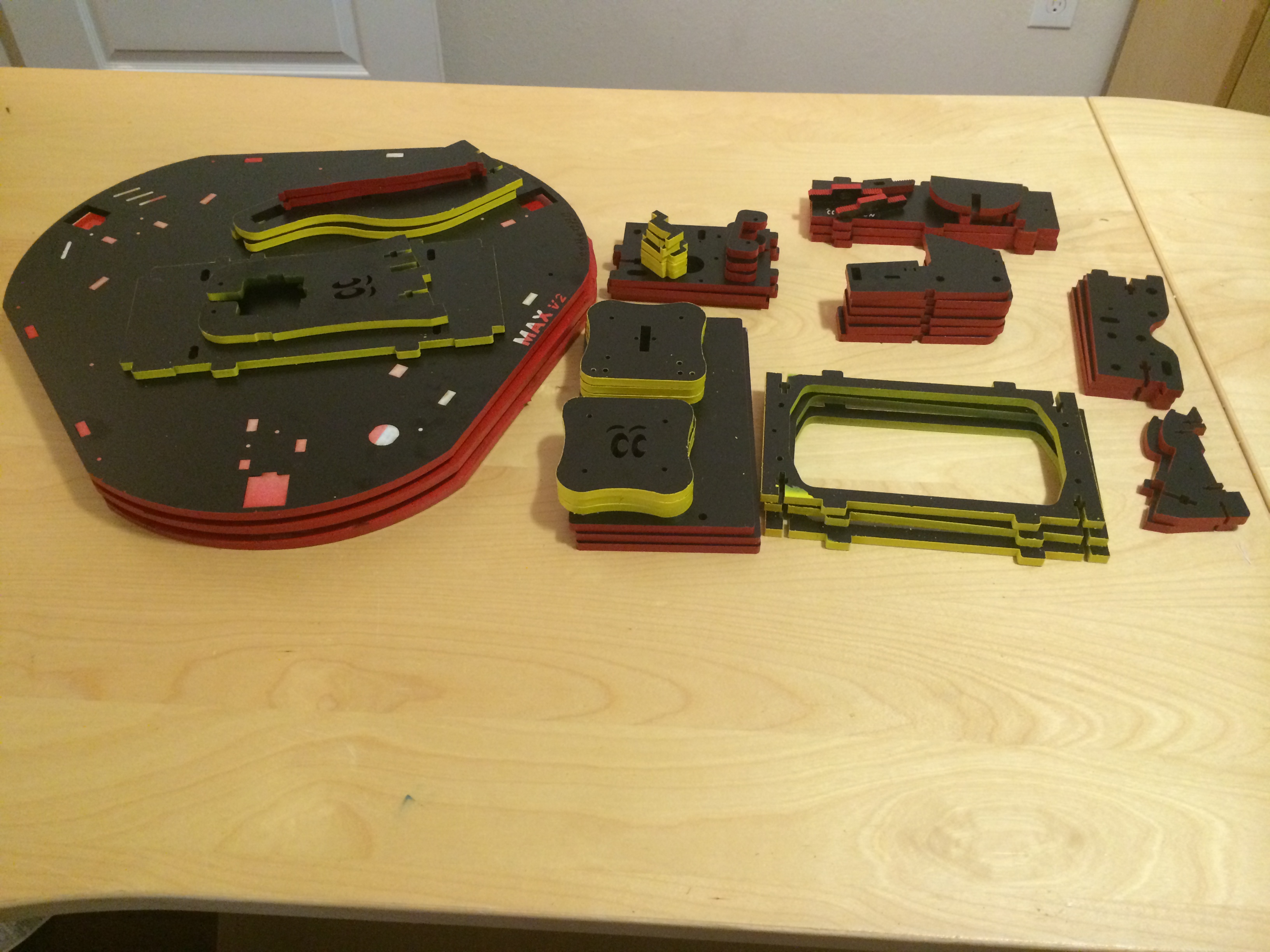

And, here is the before and after peeling ... I like it!
Ready, set ...
Ready, set ...
Peeled!
Peeled!
And I am ready to start building!!!!!!!!

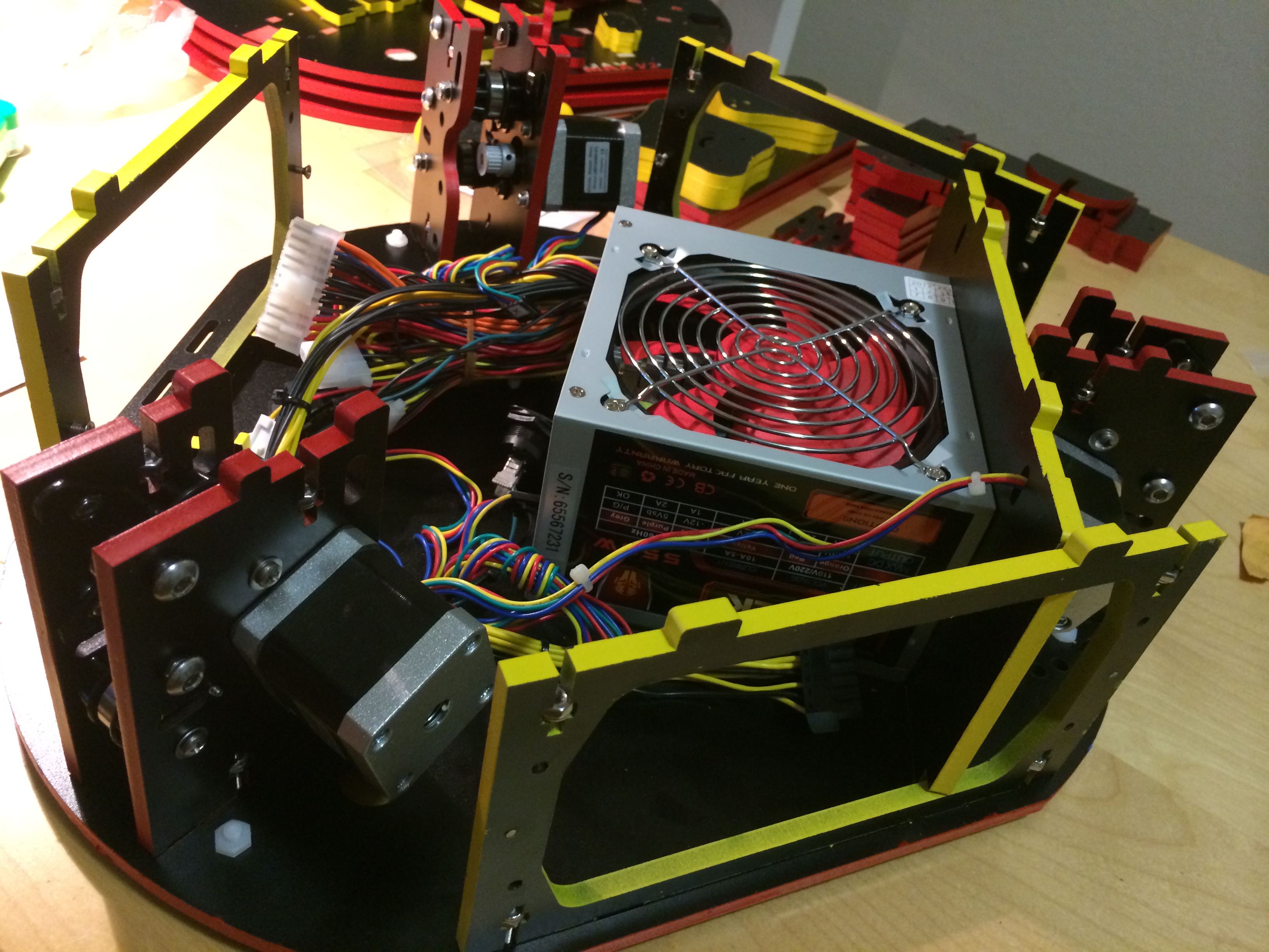

Making progress, these are the first steps in the building manual (by the way, thanks geneb!)
power source mounted

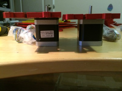

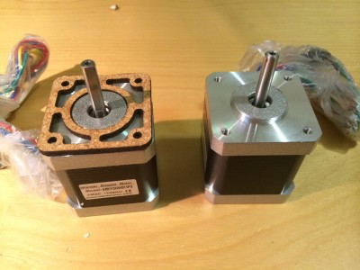

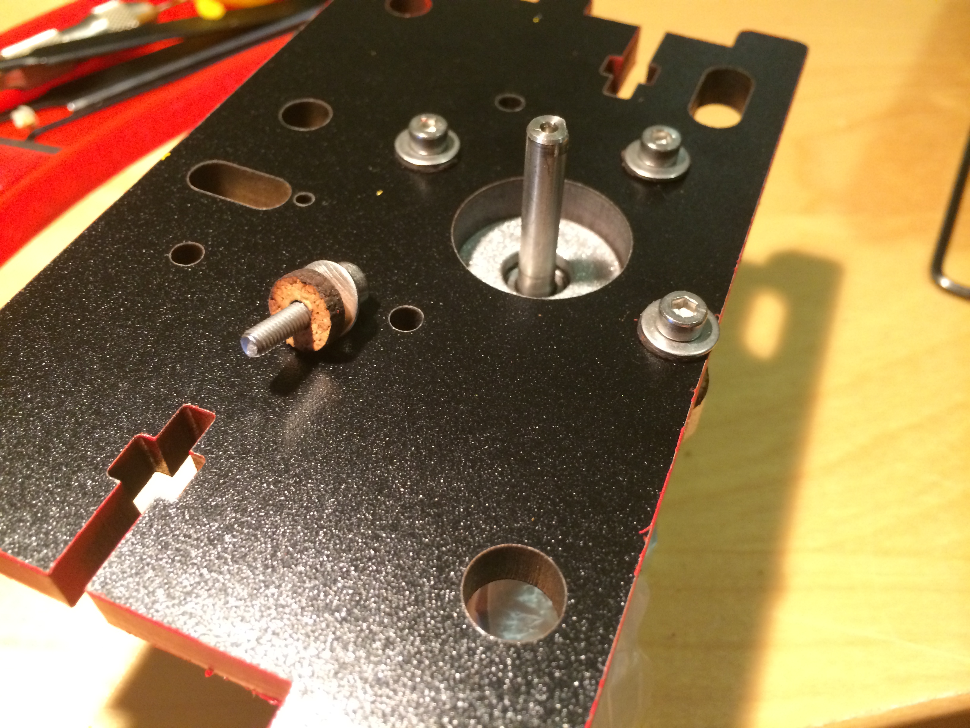

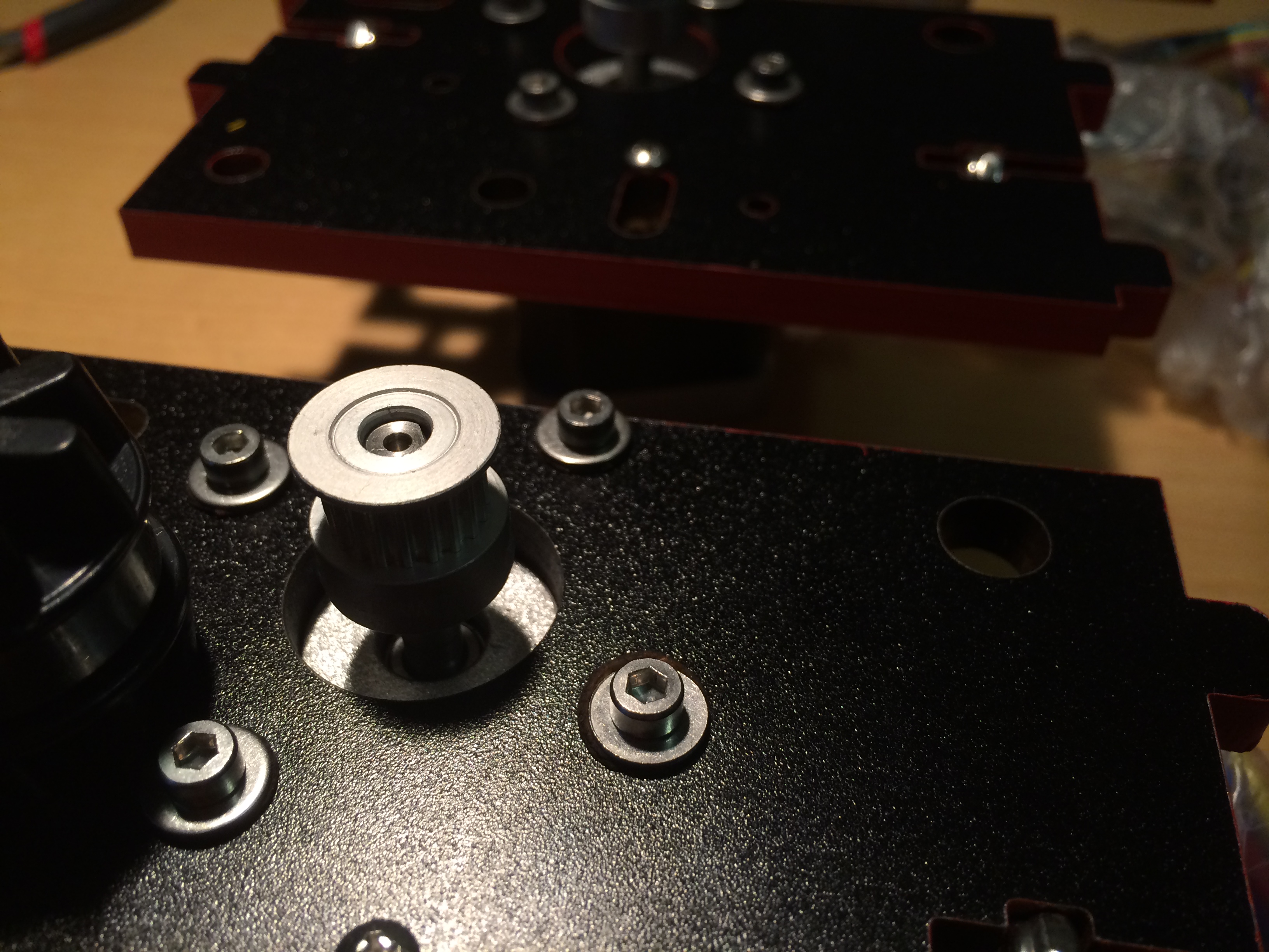

Installing the Motor Dampers (from Tricklaser ;-) )
With and without damper
See the difference between the two motors
The motor with the damper is "higher"

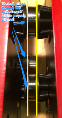

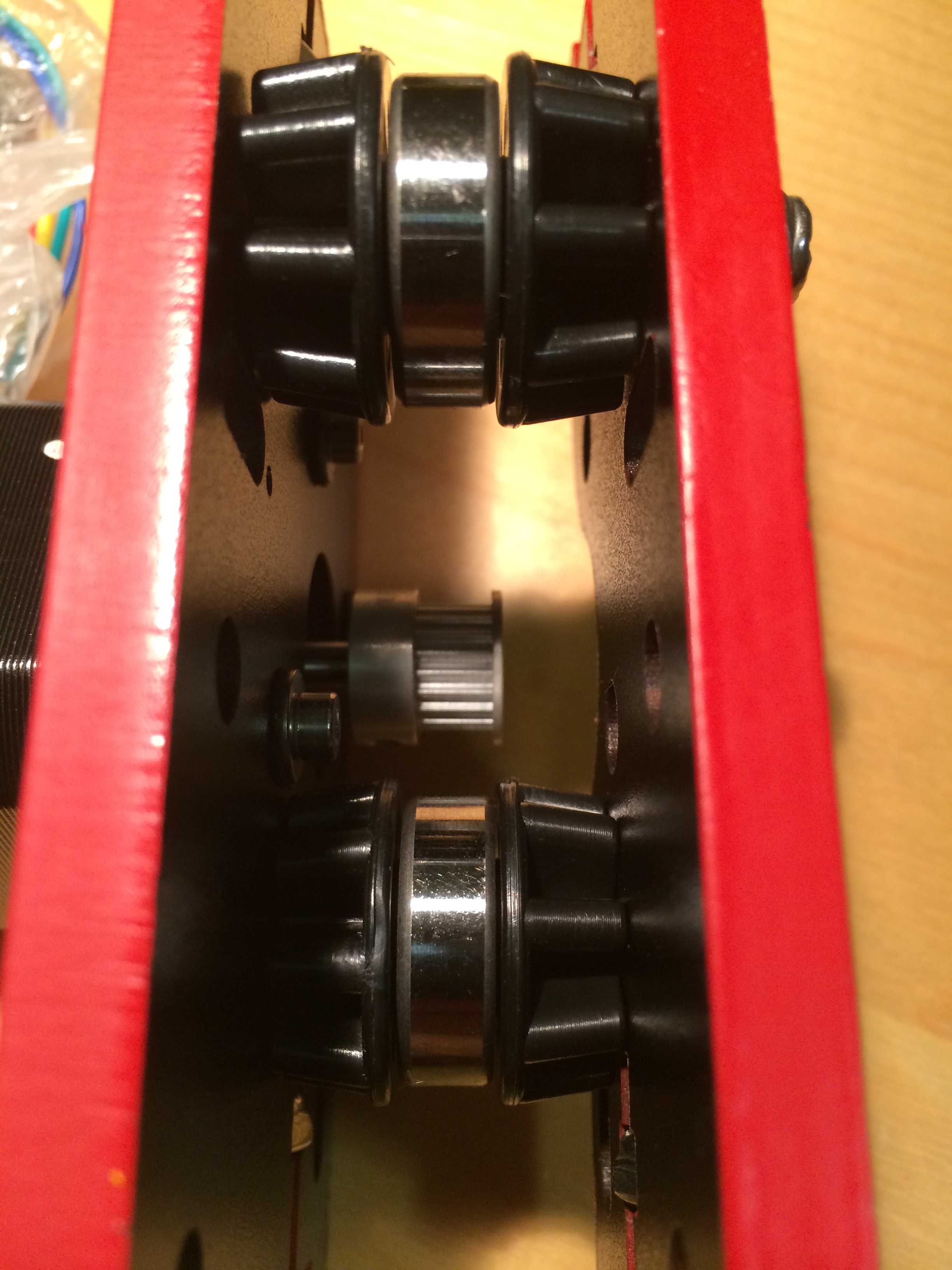

To compensate the width added by the dampers, you will need to place the Hobbed gear not aligned, as Geneb's manual indicates, but a little up.
Pulley perfectly aligned with the belt path (I jumped some steps ahead!)
Everything in line
Everything in line
Belt Path
Follow the yellow path (Oz?)

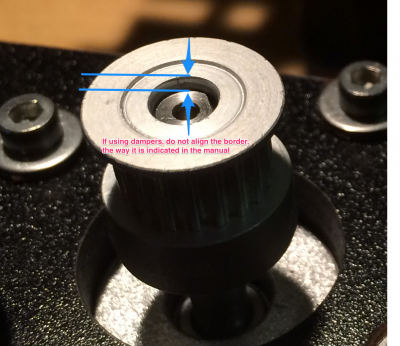

Be sure to place the damper in the screw, as well as washer, (first washer, then damper)
Be sure to place the damper and washer!

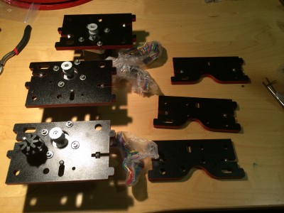

This is the gap that has to be left to compensate the width of the dampers. If not, then the pulley will not be aligned with the belt.
See the gap, to compensate the damper!
This close or is OK? :-)
Close look
Close look

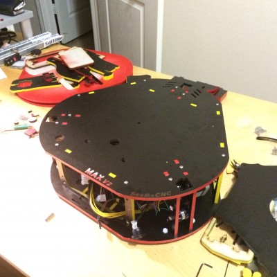

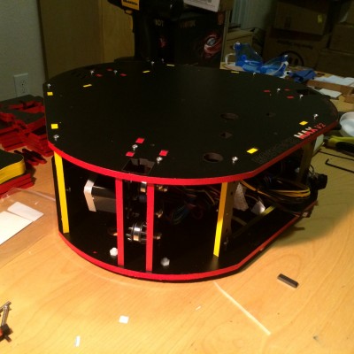

artexmg
Posts: 291
Location: Houston, TX
Re: Art's *new* RostockMax V2 (Aka Night Fury!)
Post by artexmg »
It starts to get the well known, good Rostock Max shape!
Angle 1
Angle 1
Angle 2
Angle 2
Angle 3
Angle 3
I'm loving it! (humm .. now I am hungry!)

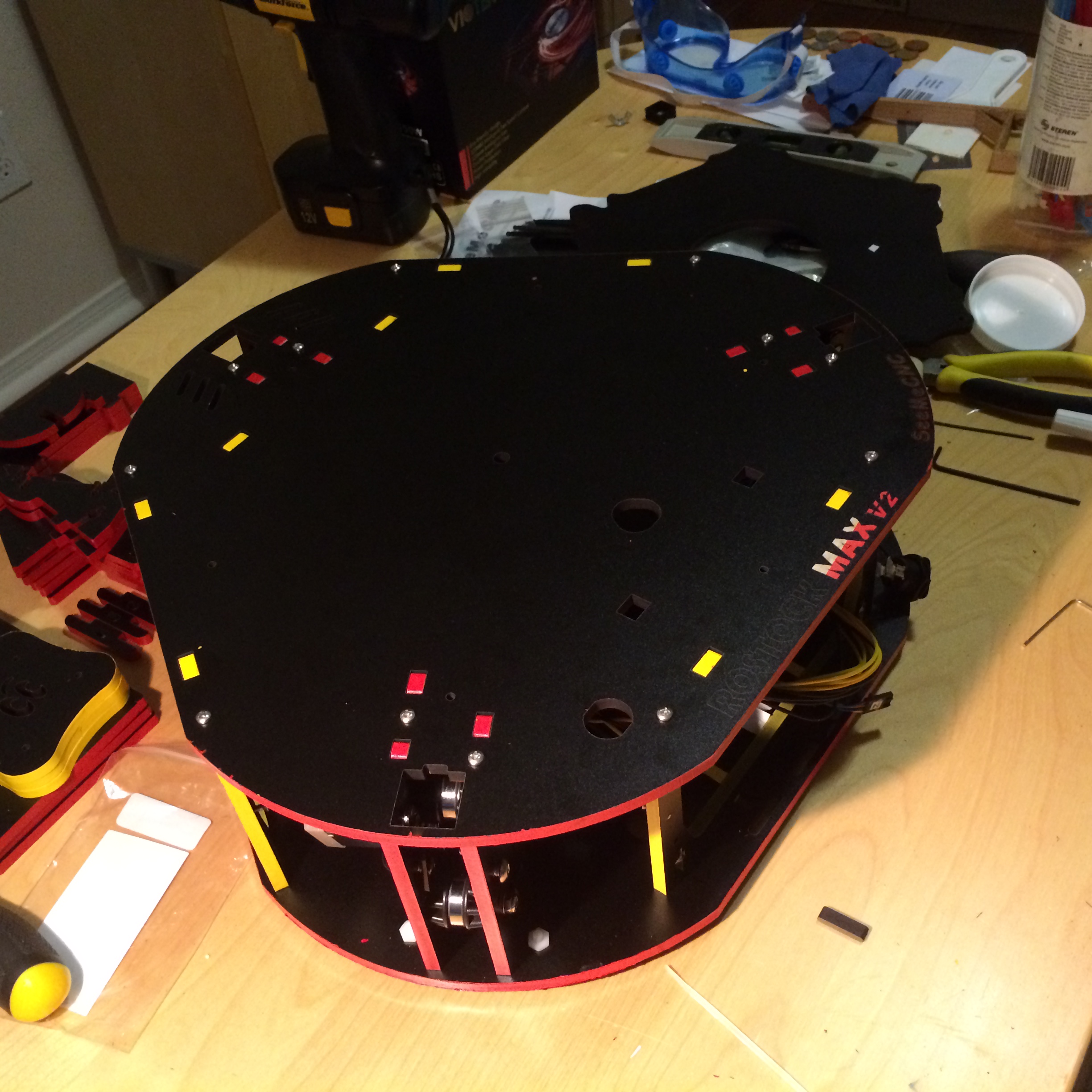

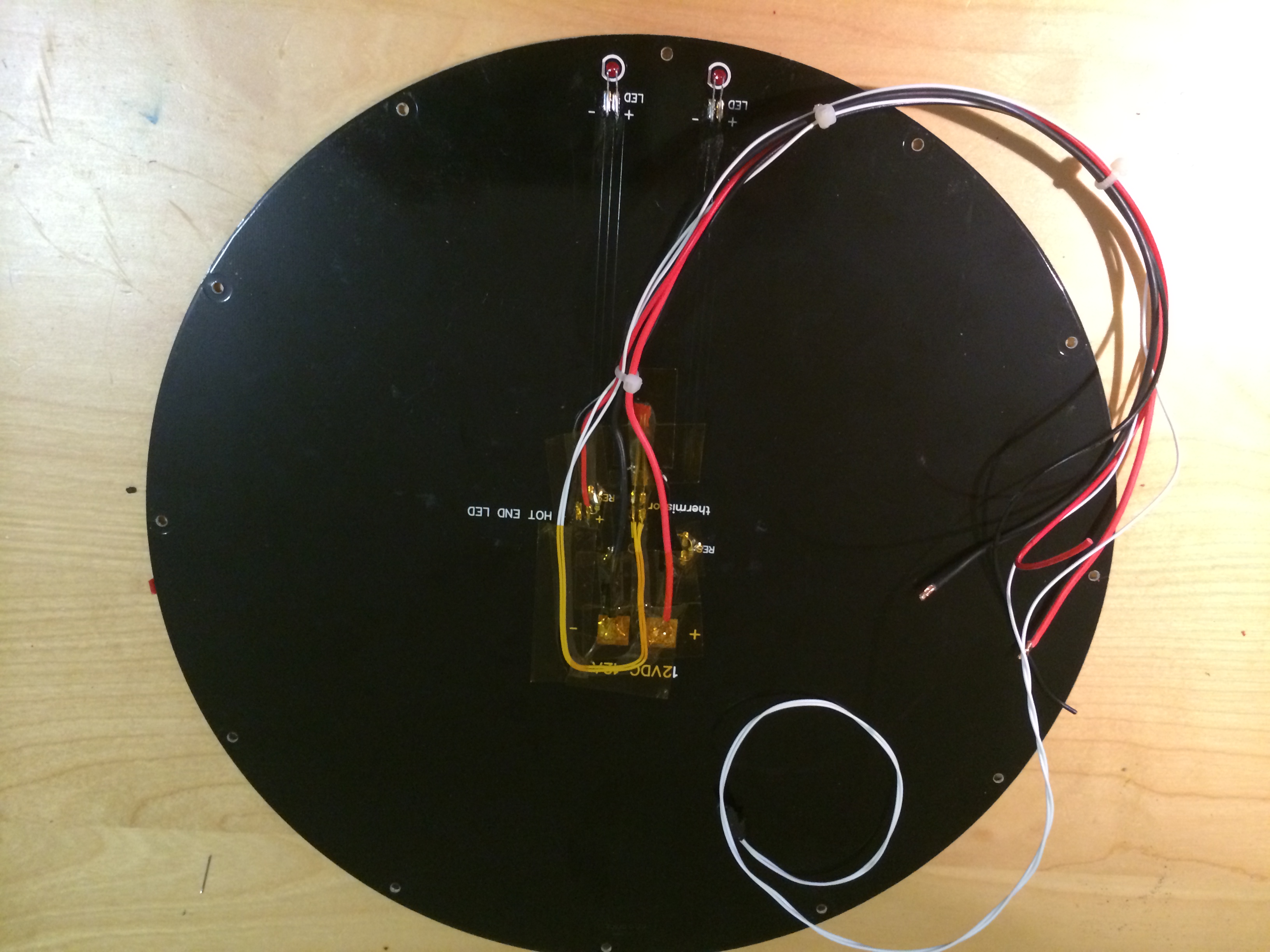

Ok, it is time to keep going!

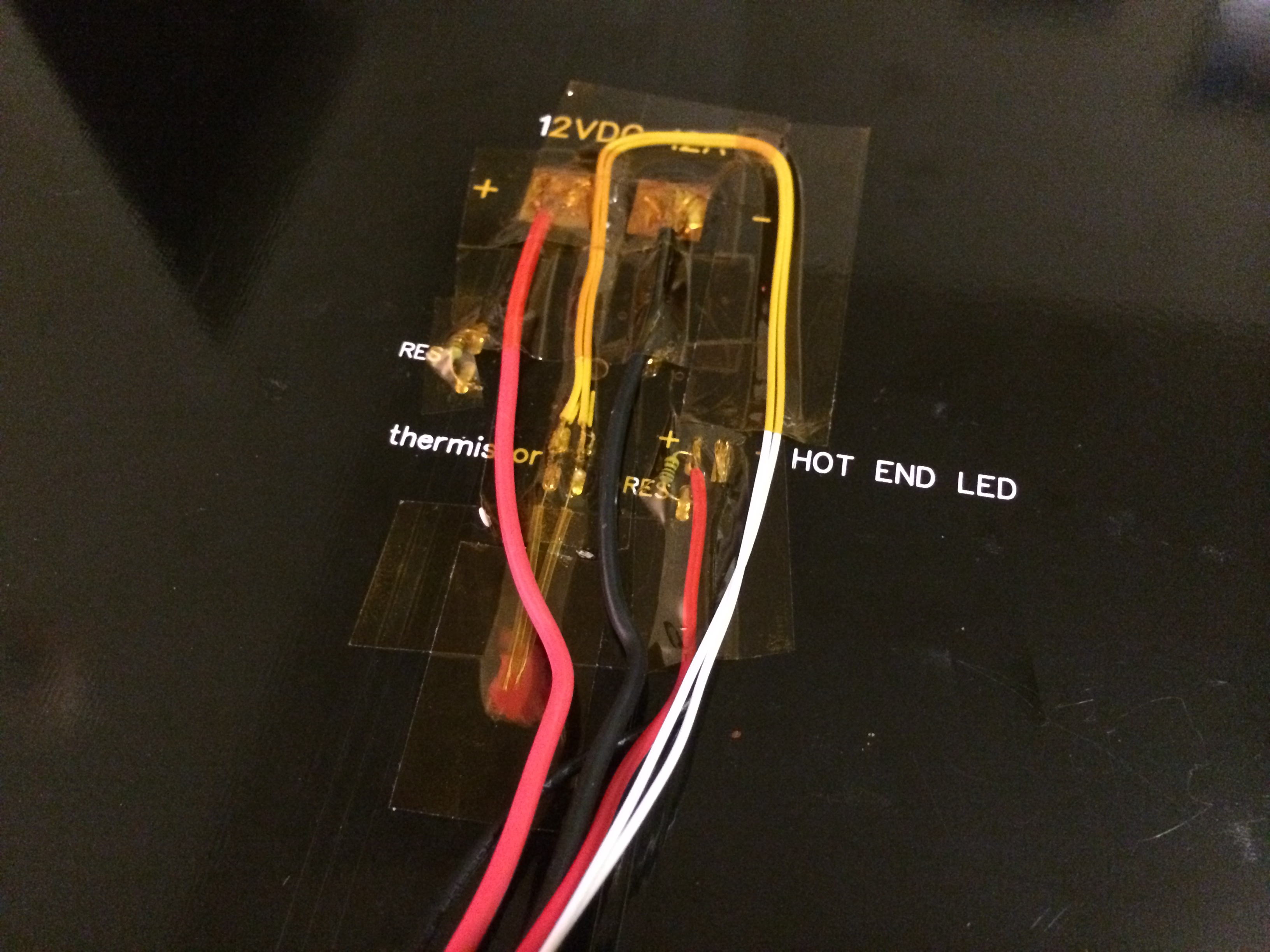

The next step was the printing bed, I tried to put the cables the most organized way I could.
I liked the V3, with the new LED to indicate the Hot End is working, sweet.
Closeup
Closeup
Hot Bed ready to go!
artexmg
Posts: 291
Post by artexmg »

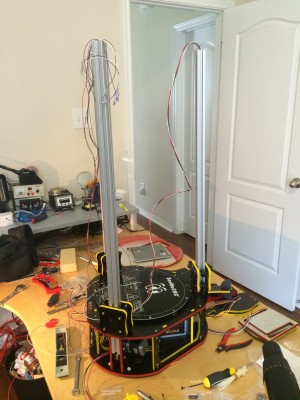

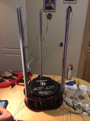

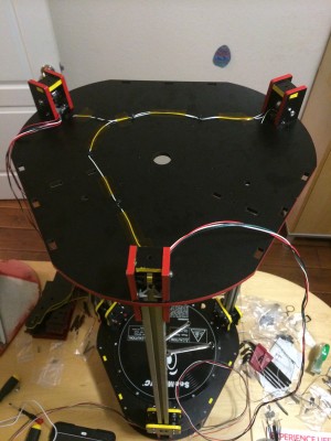

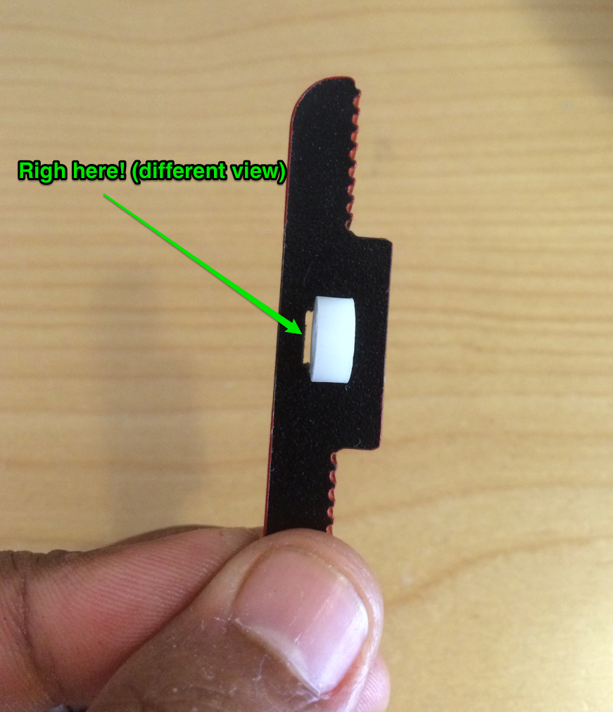

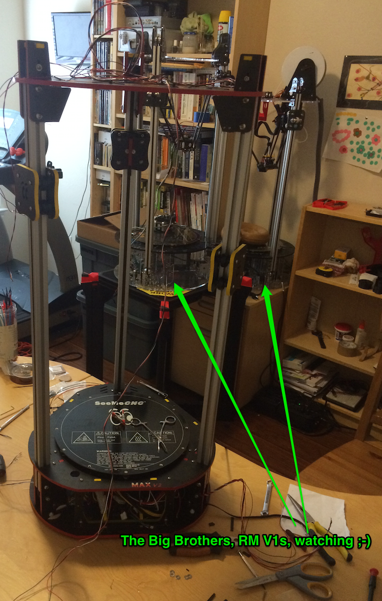

Towers mounted with cables routed inside.
Then, with the cheapskates mounted (here a short vid on how they roll work (just like geneb's :-) ): http://youtu.be/L42-53poE8Q!
another angle
another angle
artexmg
Posts: 291
Post by artexmg »

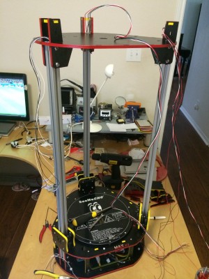

Top part in place
top part
top part
"aerial view"
this is all for now, but more coming soon, stay tuned! :-)
