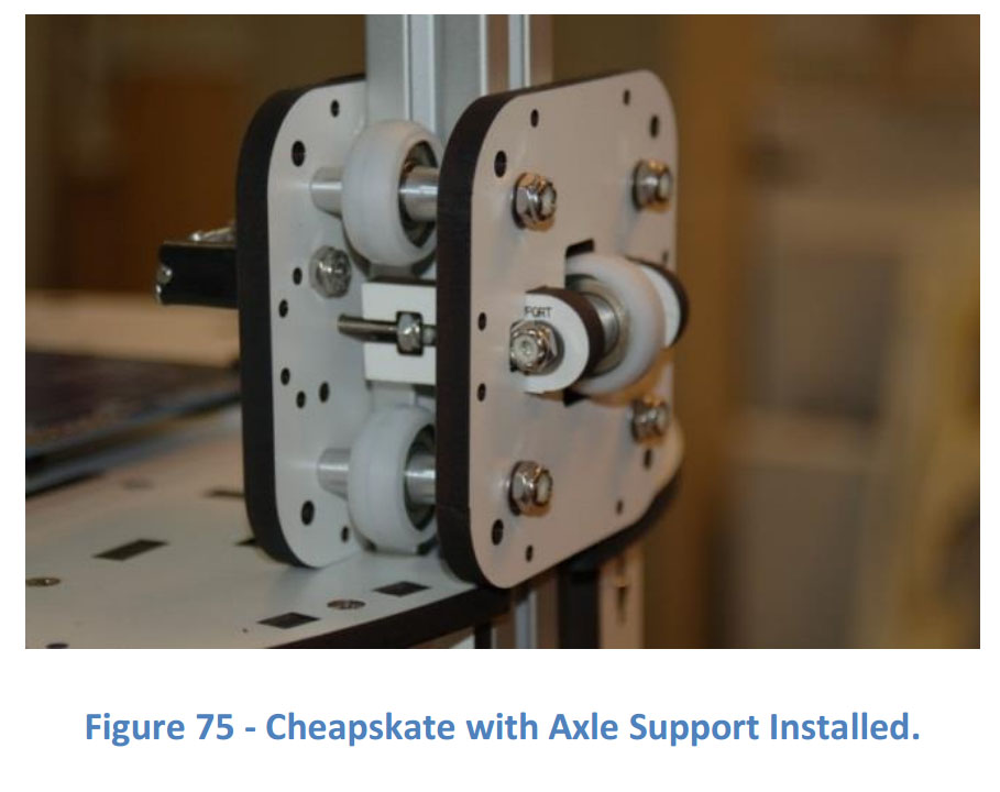

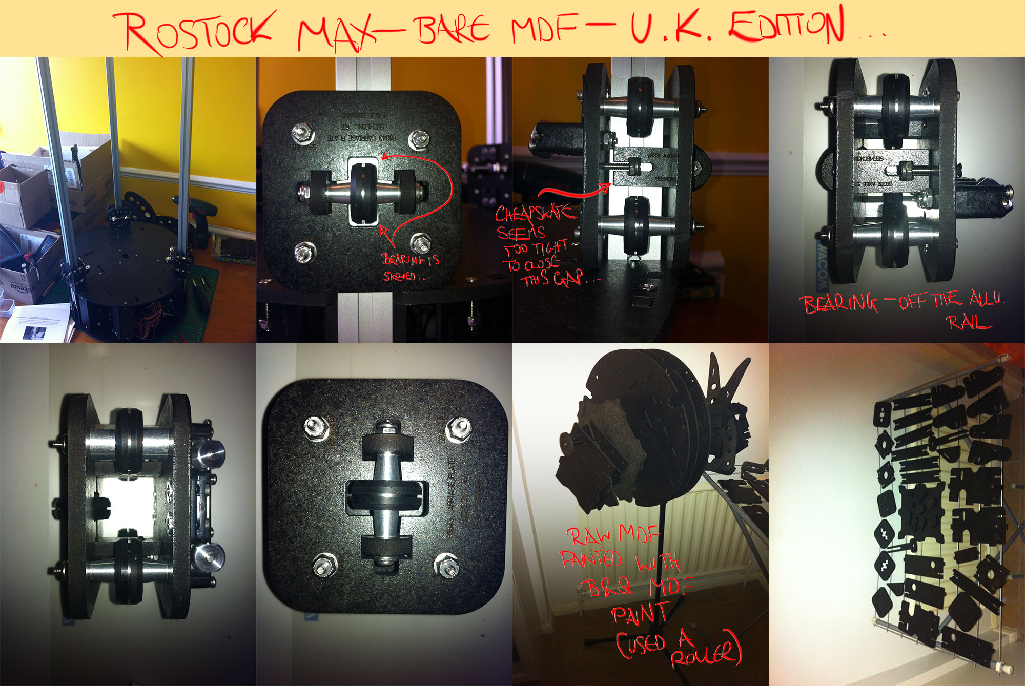

So I've assembled the cheapskates - but once fitted onto the rails I can't tighten the axle supports enough to fit the rails - It's like the bearing covers are too fat, or the rail is too thick - I need to be able to tighten the axle support bolts by about 4mm more..
See attached jpg.. Click on it to see a higher-res image...
AnalogBanana Rostock Max

You tighten these axle supports last just to to tighten everything up. They don't tighten all the way

Ok - the reason I'm worried is in geneB's pdf manual the whole assemble seems to fit together tightly - the axle support is flush, whereas I cannot close that gap..
geneB's example below...

I suffered from the same confusion initially. It is difficult to see in the picture but there is a gap. Please forgive my handwriting that is horrible even when drawing with a mousepad.
[img]http://farm9.staticflickr.com/8123/8630799577_973223bfc4_n.jpg[/img]
gap by foshon, on Flickr

Good news then, thanks for the advice Foshon! I'm going to keep building..

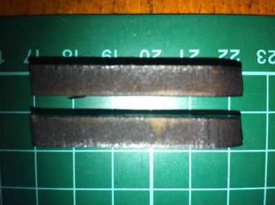

On closer examination, I found that all my axle supports have (I don't know what to call it) "laser skew"
i.e. the cut sides are not true square, as if the laser cutter took the cut at a slight angle.
It's definitely not helping with precision, but I will attempt to compensate..

Seems to be working now - quite a nice action - no slop and tension is adjustable via the axle support scres.
All this confirmed by the vendor, and he says he'll look into the laser cutter skewing.

MHackney posted something refering to the method that a laser cuts ends up in tapered cuts. Its a cone not a line, or something to that affect.
Purple = sarcasm
Posts: 5359
Re: Analog_Banana's Rostock Max in the UK
Scroll down to "Beam Angle" on this page -> http://spikenzielabs.com/SpikenzieLabs/ ... ow_To.html and you'll see EXACTLY what is going on.
If you're seeing a significant angle on the cut parts, it's likely because the laser has gotten out of focus. It won't take much at the power levels they're using to put a steep angle on that kerf.

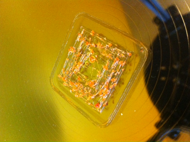

Major update: First Print
Apparently it's not essential to tune the bed, so I moved on to trying a test print:
NEED... MORE... PLASTIC...
I'm not getting enough filament out of the nozzle...
What I know id probably correrct:
Temperature = correct - nozzle is heating up to 185 degrees (0.5 mm nozzle)
Feedrate = correrct - If I type in 100mm to the repetier extrude box, Steve's Extruder spits out exactly 100mm of filament.
What may be wrong?
Steve's extruder is not gripping the filament hard enough - while it can extrude 100mm with no load, maybe the load of squeezing it through
a tiny hole is making it slip, maybe I need to tighten the feed jaws?
Maybe there is an obstruction in the hot end / teflon sleeve inside the hot end?
Maybe I have the settings wrong in the firmware / slicer / repetier settings.
Maybe some other thing?
If anyone has any tips I'd be really grateful :)

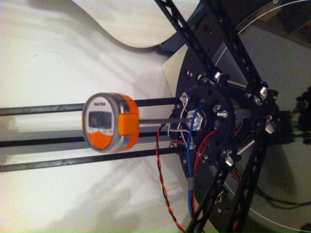

So I've been testing the hot end temperature with a digital meat thermometer.
It has a probe that's just the right size to drop down to the end of the extruder barrel with the teflon tube removed.
See photo..
Is this likely to give me an accurate temperature reading?
Here are the results:
thermistor says 220c >>>> meat thermometer = 203c
thermistor says 190c >>>> meat thermometer = 178c
thermistor says 95c >>>> meat thermometer = 89c
thermistor says 30c >>>> meat thermometer = 30c
The Salter Digital Meat thermometer has a range of 0-230c
Perhaps more accurate than the thermistor in my hot end?
The thermistor readings match at 30c, but diverge by 17c at the upper working temperatures...
So for now I will be assuming a reading of 203c is actually 190c.

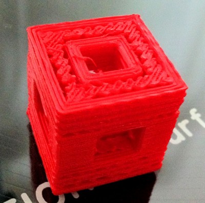

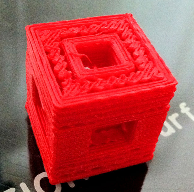

First Print!
I made the following changes:
set repetier to 203c (which measures as 190c)
Switched to Faberdashery Red PLA from their Rainbow Fun Pack
Added a 12v Peek fan to the hot end.
Not sure which change made the difference, but something's working,
The banding is caused by the peek fan switching itself off every few minutes.
I have the 12v 25mm fan runnnig from D9 on the Ramps 1.4 - Which also seems to stop the heated bed reaching specified temperature.
I'm searching for the right pins and method to run the peek fan.
The cube actually looks a lot better in real life - just the fan thing making it irregular.
There's plenty of room for improvement, but vertical resolution and accuracy is looking very promising :)
Thanks for the forum help..

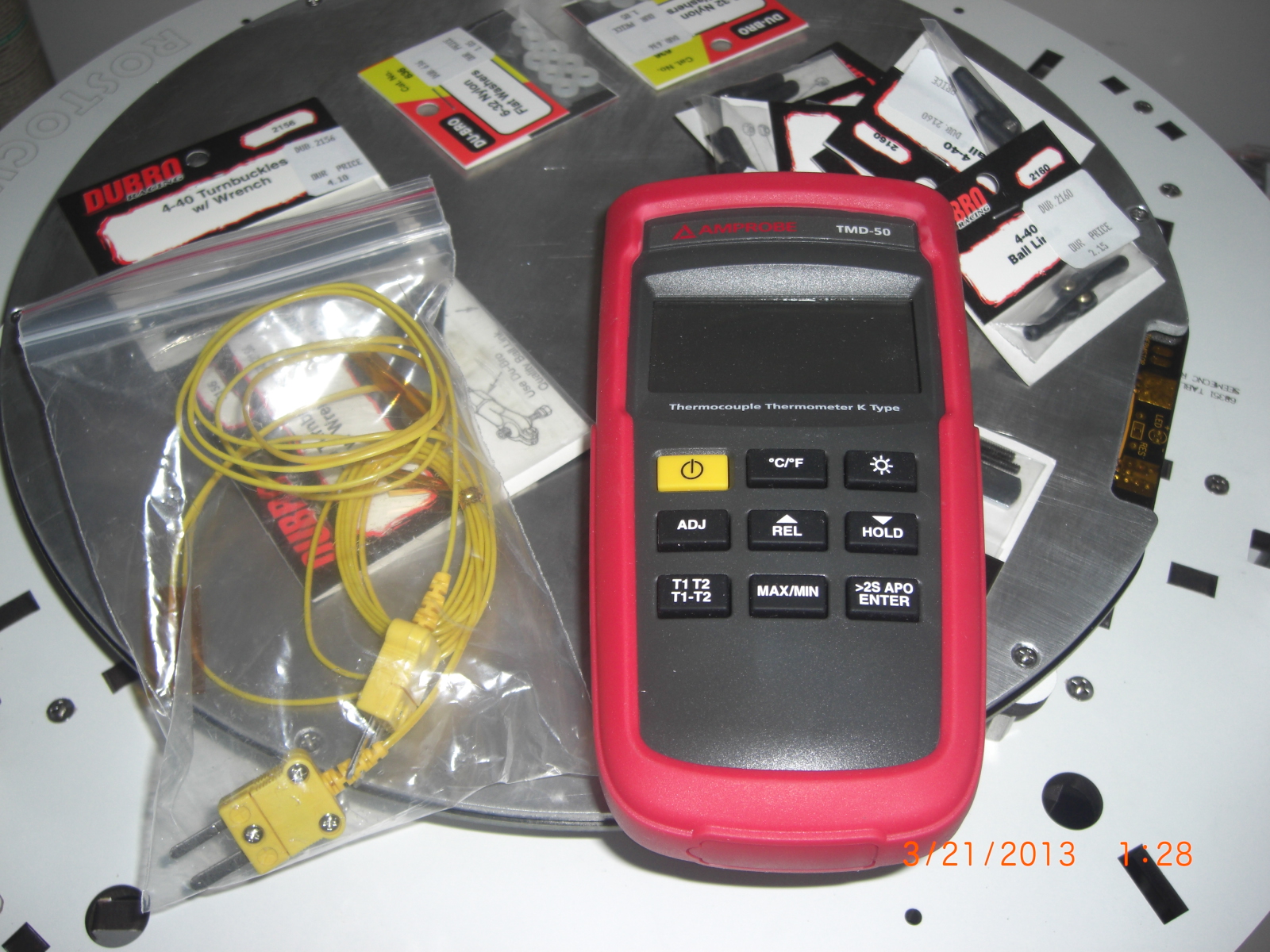

i can't stress enough how important it is to calibrate your hotend temperature with a thermocouple meter, to what your reading in rephost.
if you don't do this you will never know how accurate your temperatures are and it will effect your print quality
analog_banana
Posts: 167
Joined: Mon Apr 08, 2013 7:53 am
Location: London, England
Post by analog_banana »
Cool time to calibrate a bit more I guess - Can anyone recomend a good, cheap thermocouple meter or probe thermometer for this task?

analog_banana wrote:Cool time to calibrate a bit more I guess - Can anyone recomend a good, cheap thermocouple meter or probe thermometer for this task?
I got an Extech MN35 from Amazon. I see that Amazon.co.uk also carries it. http://www.amazon.co.uk/Extech-MN35-Dig ... xtech+mn35
The manufacturer claims that it is accurate to ±1℃.
The US version includes the thermocouple probe. Amazon.co.uk did not state that the UK version has those, so check carefully.
Here is the US URL. http://www.amazon.com/Extech-MN35-Digit ... tech+mn-35

analog_banana
Posts: 167
Thanks for all the recomendations!
I've purchased dual-probe thermometer similar to Eaglezsoar's recomendation.
It was £16.99 - only £3 more than the meat thermometer I was using,
which will now be sanitized and returned to the kitchen.
Now I just have to wait for it's successor to show up...
Ho Hum...
