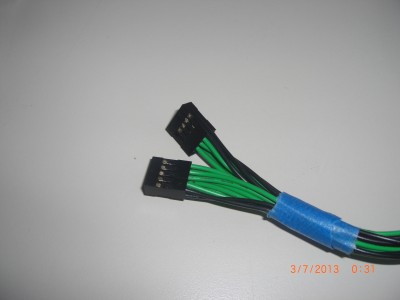

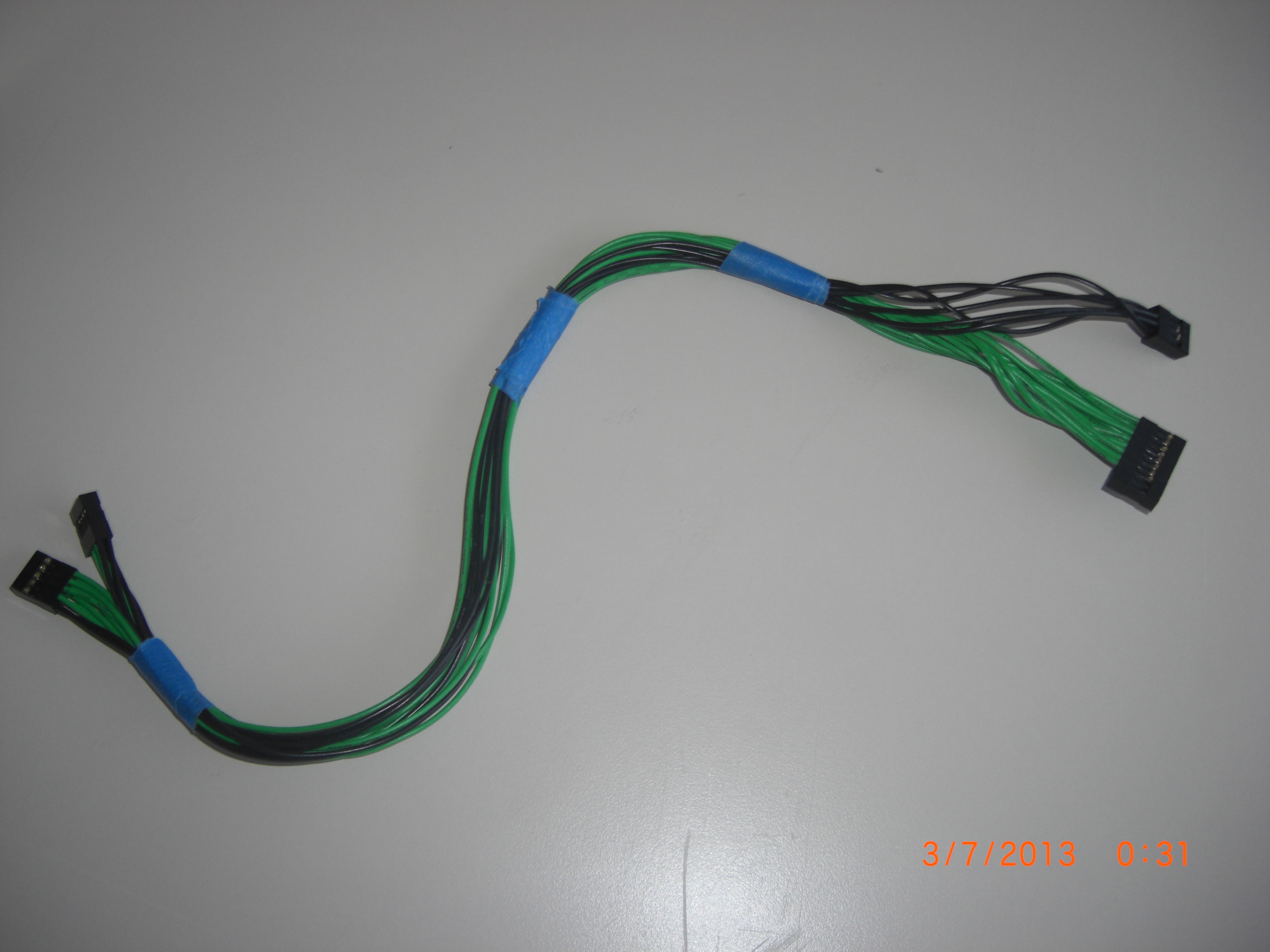

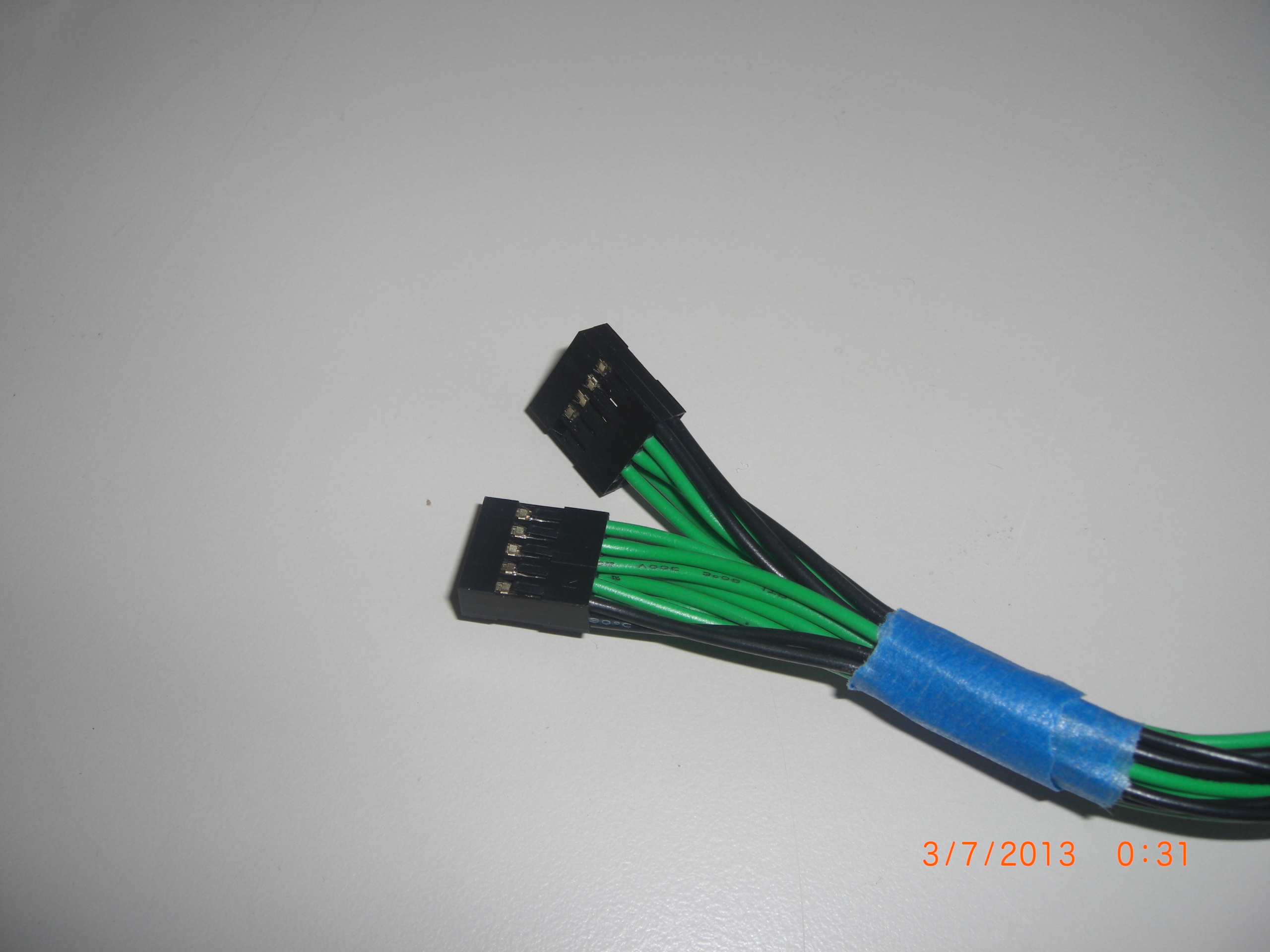

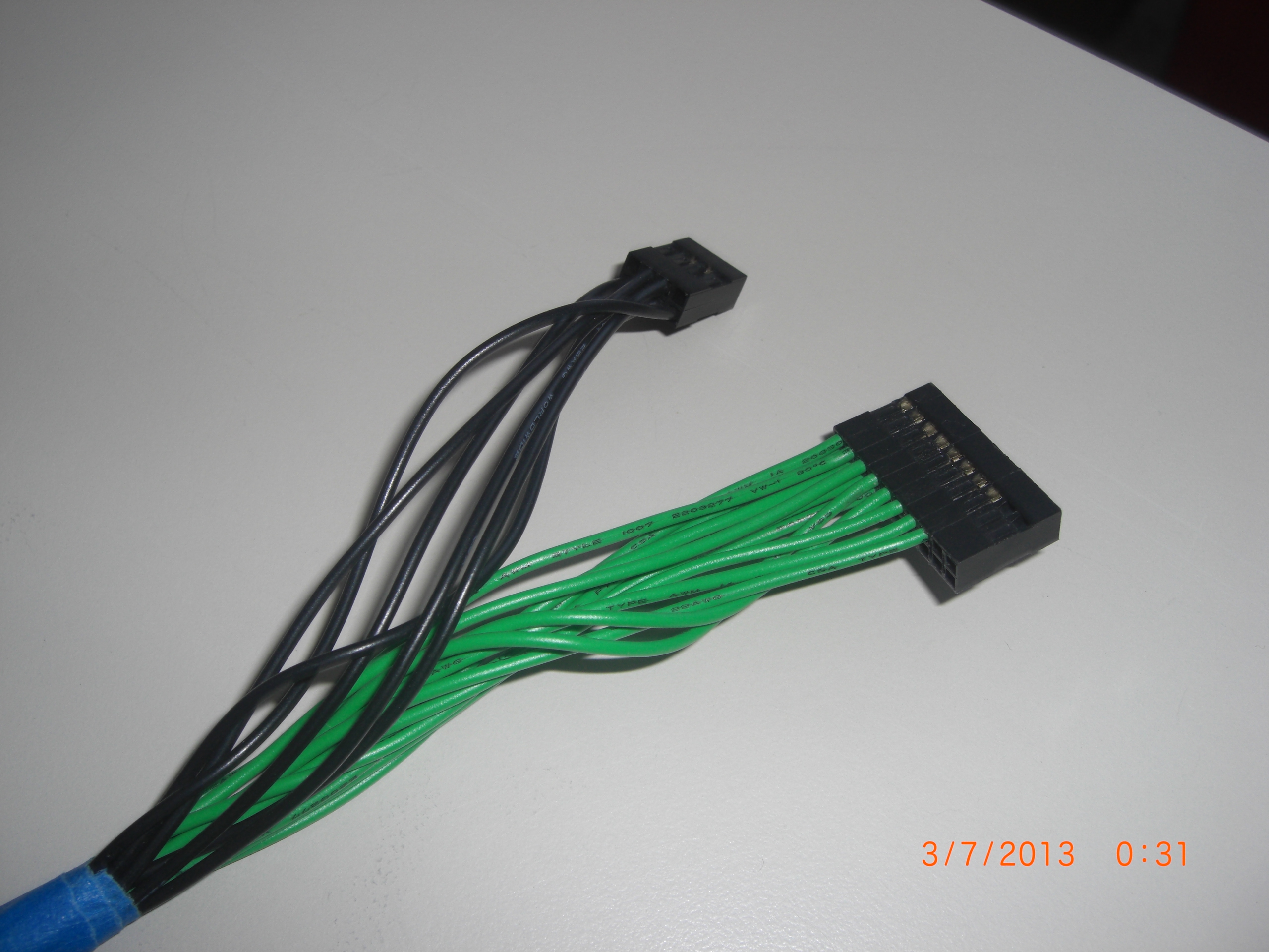

So I was bored last night. I figured I would go ahead and make the lcd wiring harness, since I had already ordered the parts. (This was before I knew seemecnc guys were now including lcd adaptors.)
but anyway, I did it using the instructions without even having the machine yet. It wasn't difficult at all. I skipped the lengthy read on how to wire it with the included harness and just made my own. Took me about an hour. Here's how it looks. Probably will use the new adapters but I'll keep this as back up.

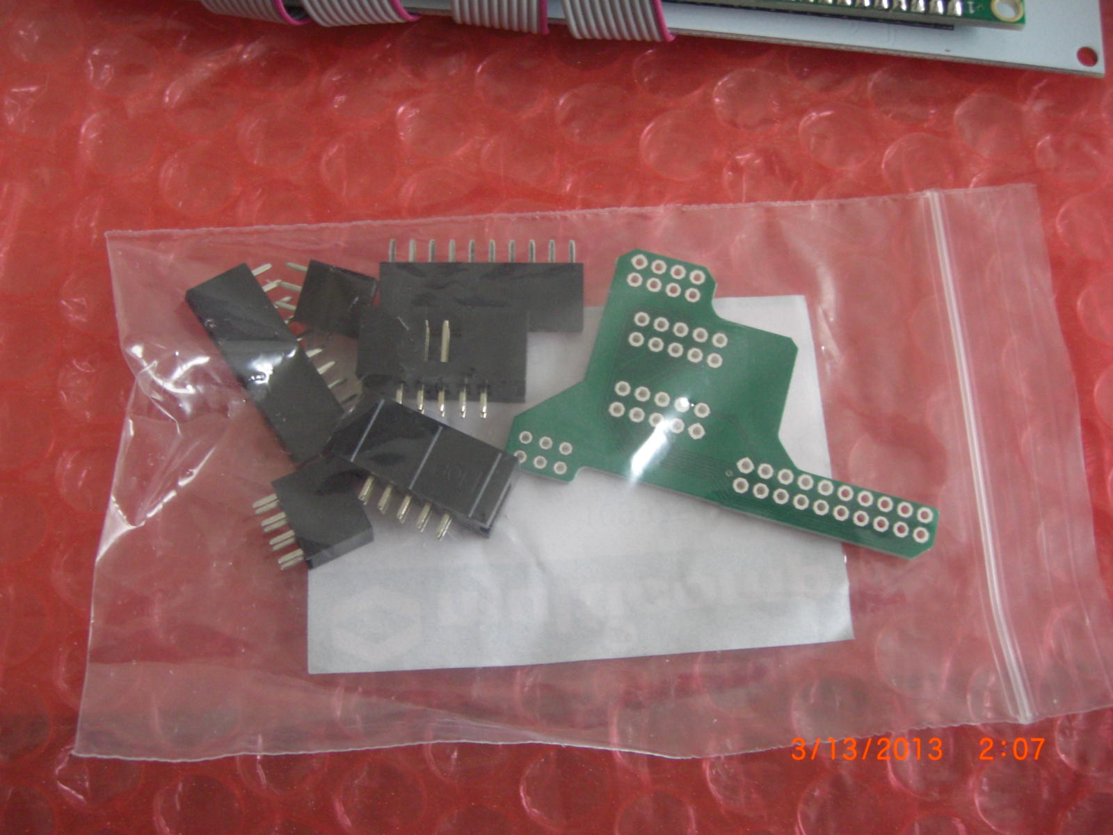

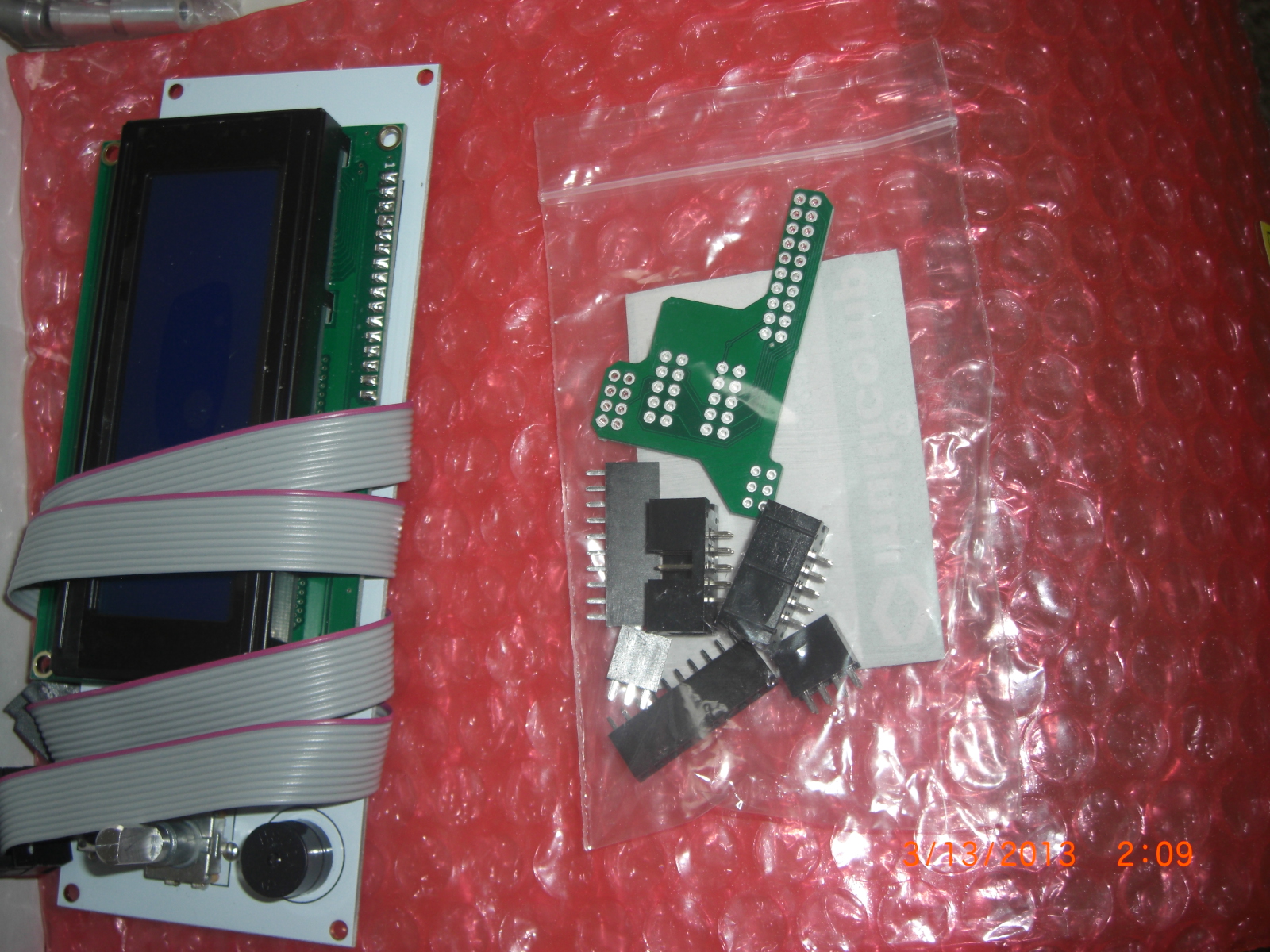

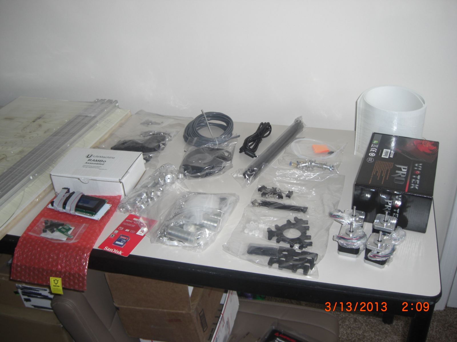

just recieved my new kit, here's a first look at the new rambo lcd adapter board.
Re: Another rostock max build

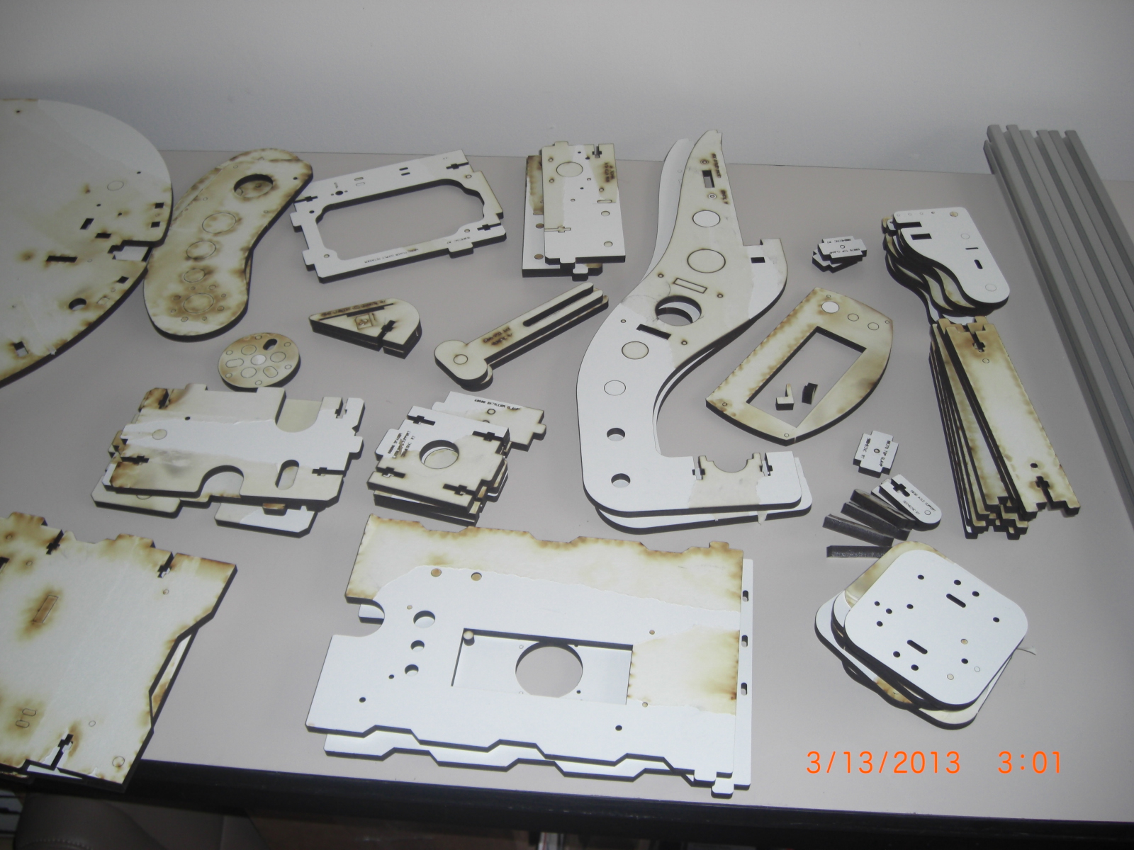

and here are some initial unpacking photos arrived safe. More to come stay tuned...

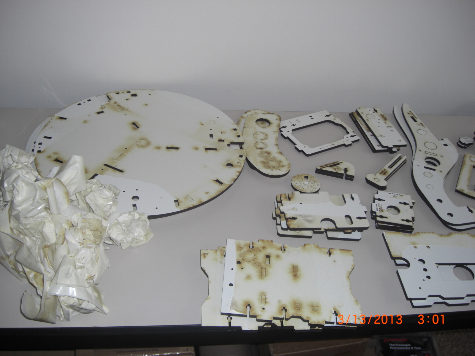

Now you get to have the great fun of stripping tape and backing off all those laser cut parts!

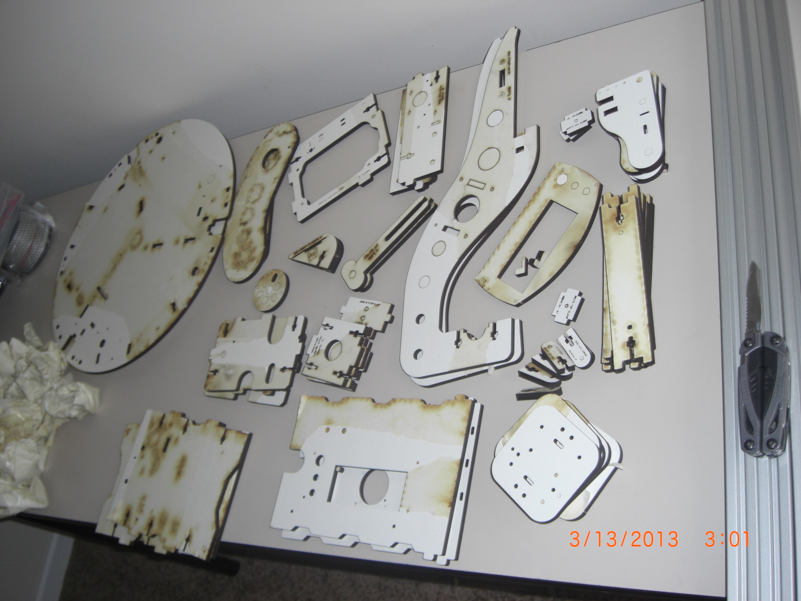

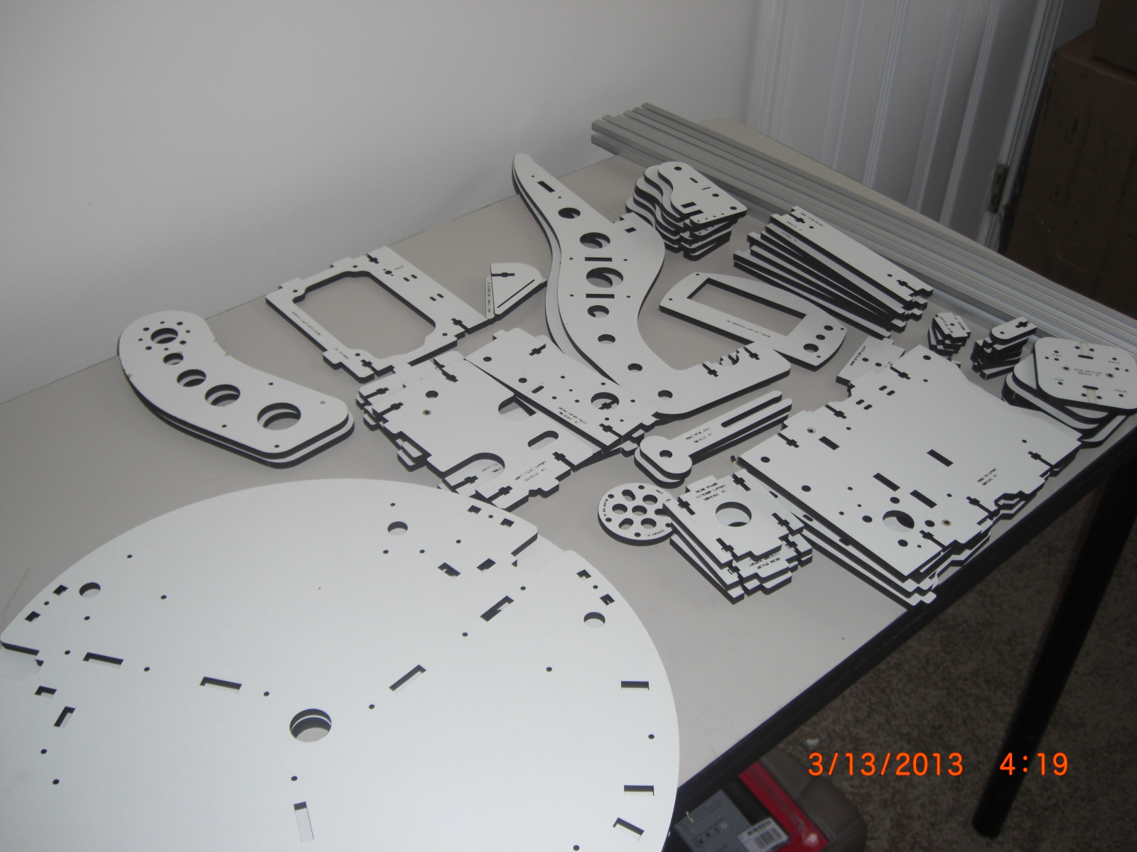

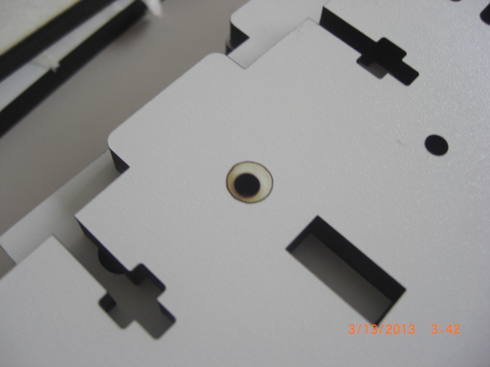

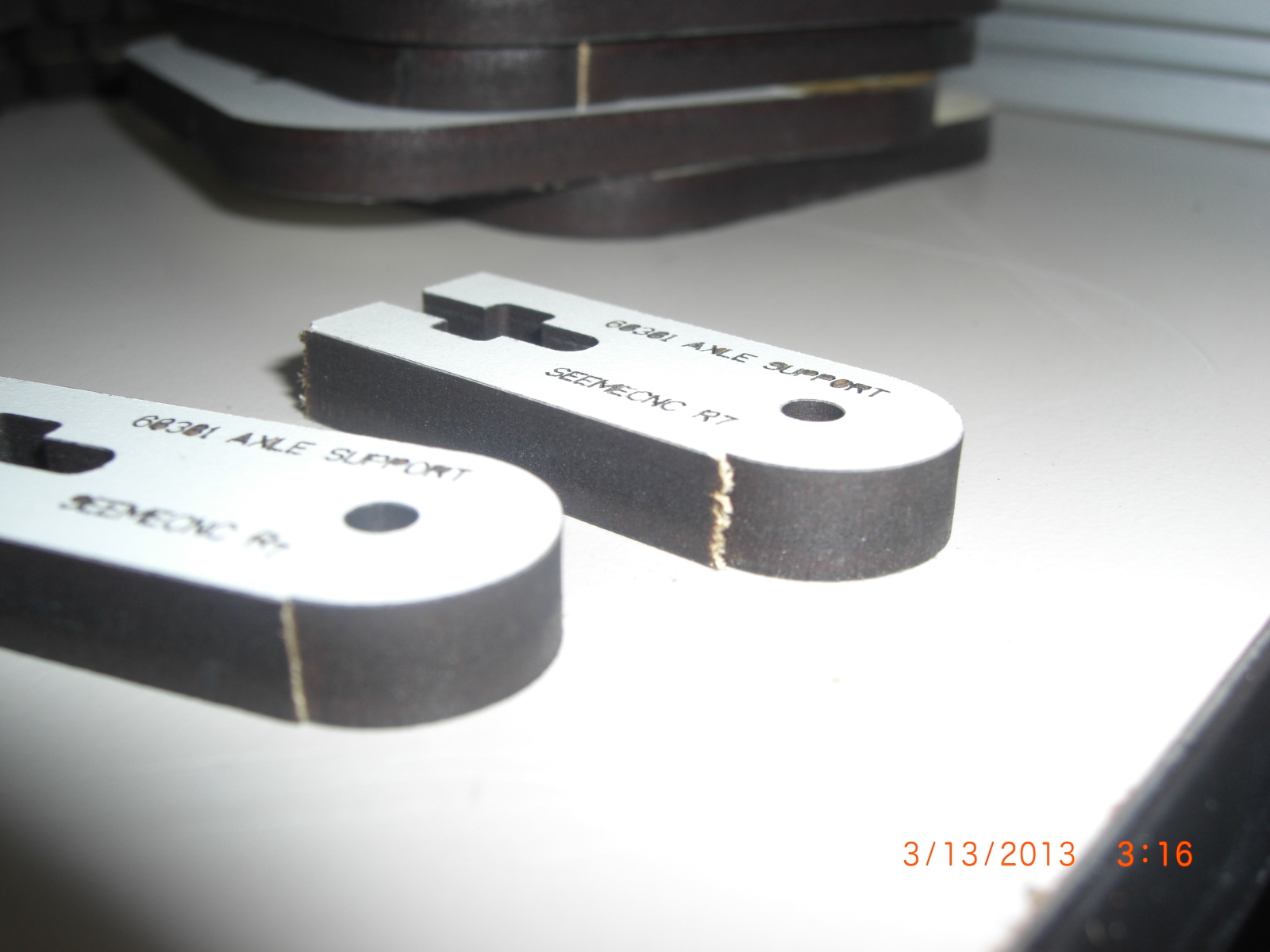

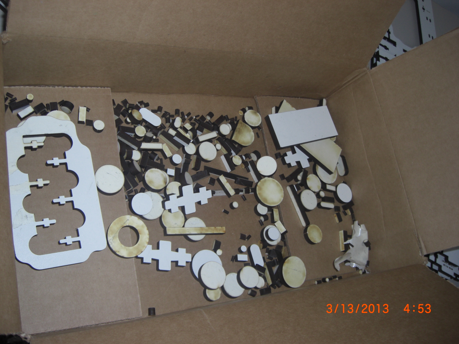

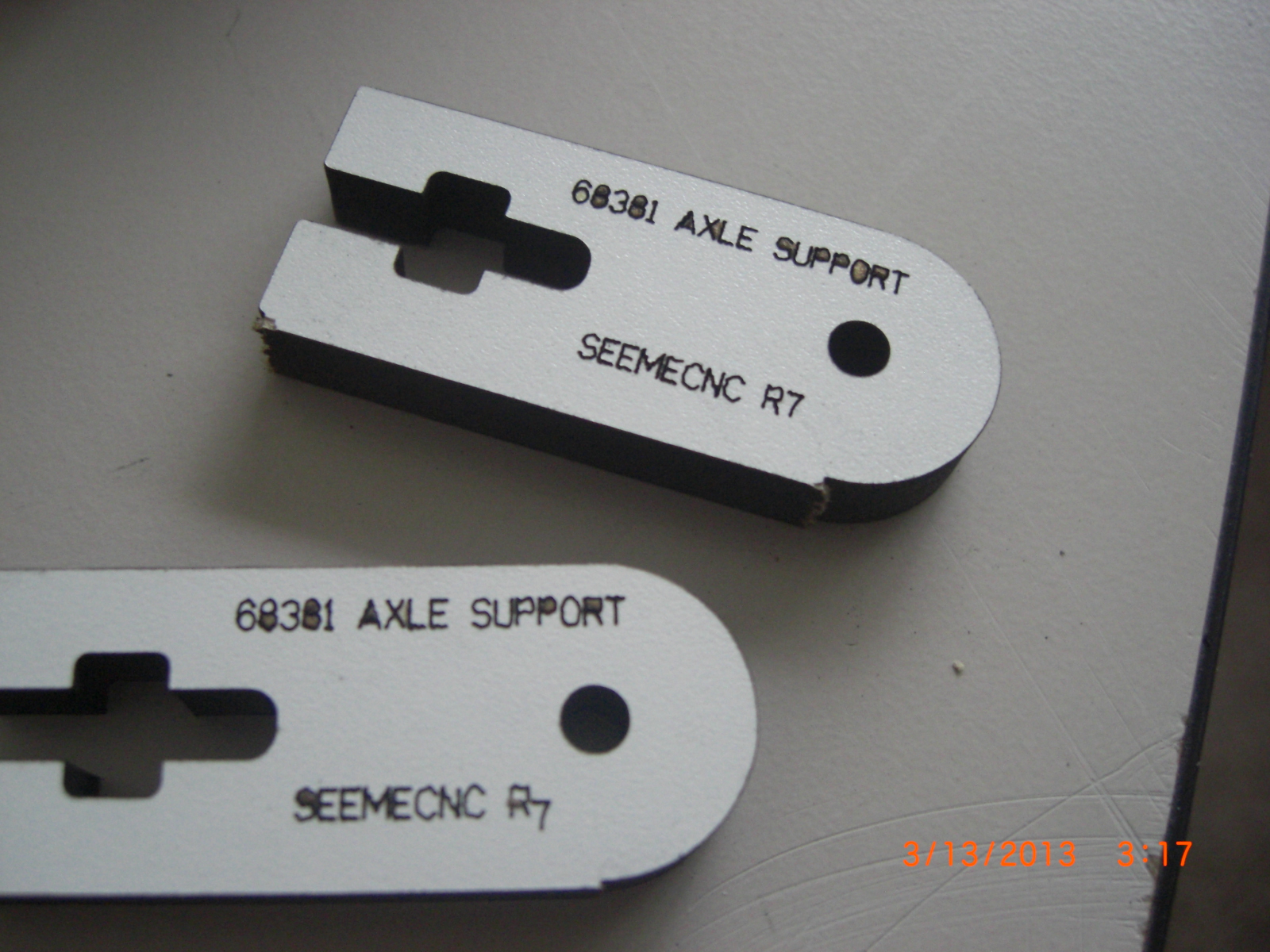

moving right along, after taking the protective film off the big sheets. 99% of the laser cut parts came right out, there were some spots that needed a little extra force. no big deal. The quality looks good. No parts look skewed from my naked eye.
looks intimidating ehh....
There was only one spot in the laser cutting that was slightly off. shown here but nothing a little sanding can't fix. Didn't look like it was drawn correctly. not laser related. All of the other axle supports were good.

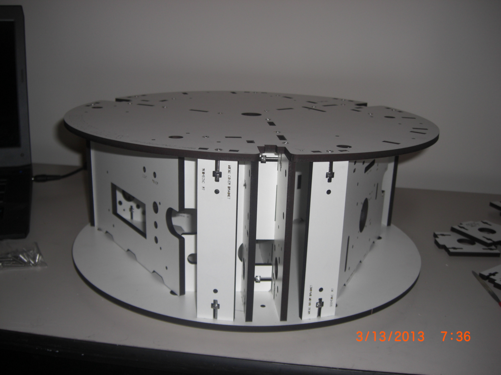

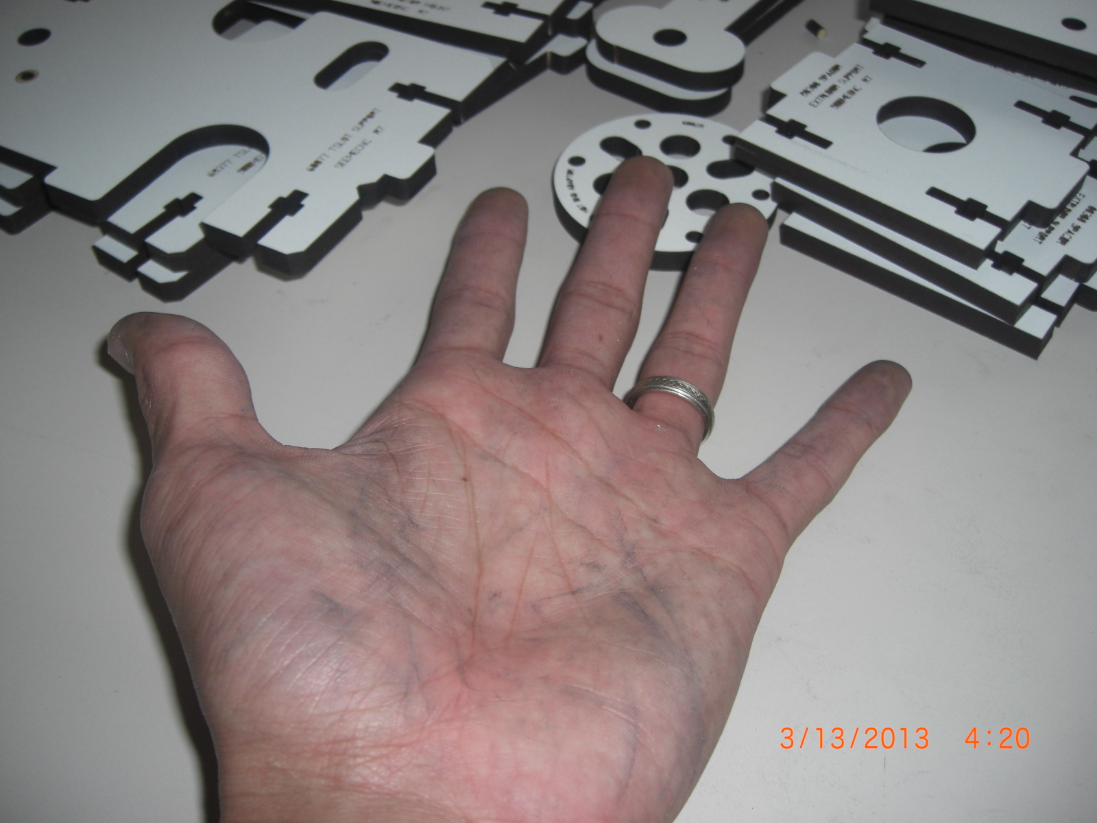

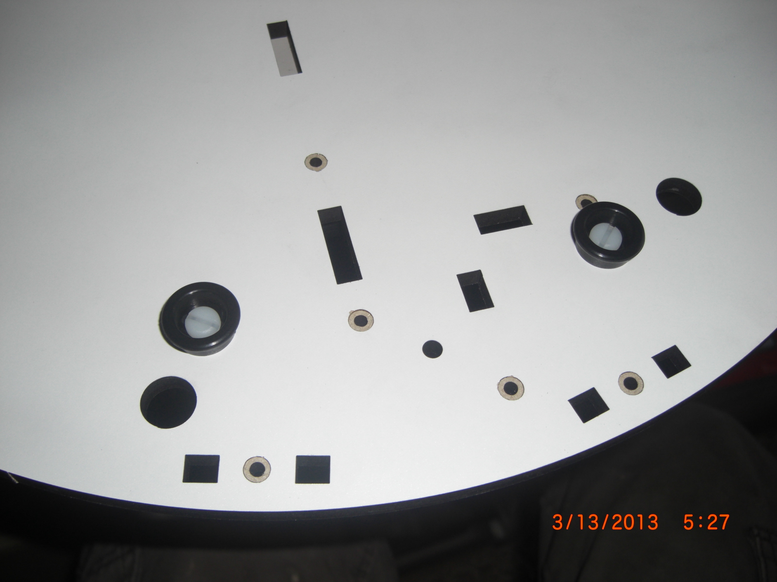

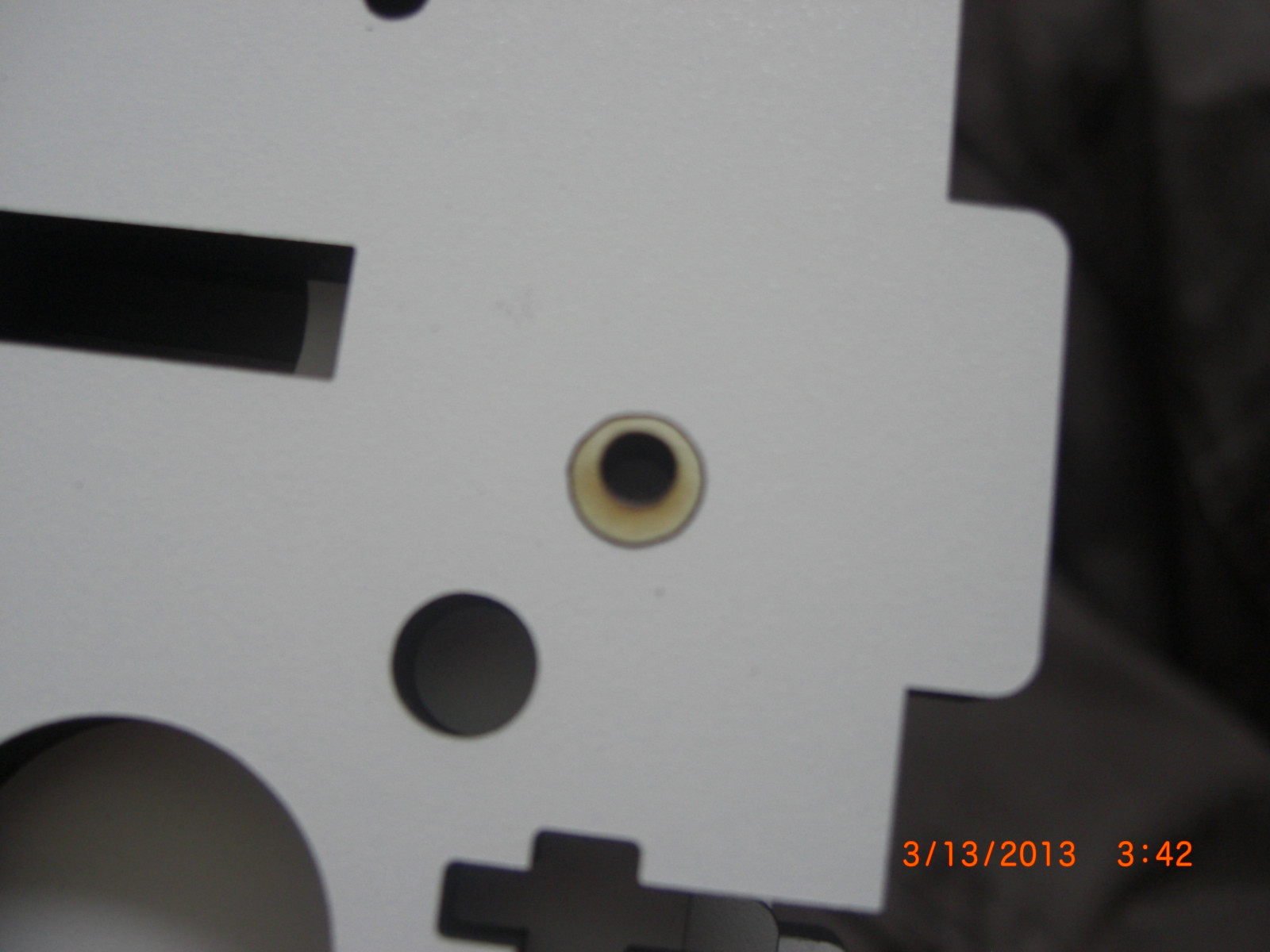

about an hour later, i'm officially rostock initiated. Maybe I shoulda worn gloves.
There were a couple of spots where the outline of the counter sink holes were not centered. hmmm

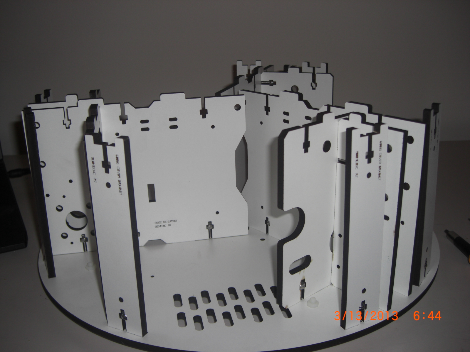

now to start base assembly.. whewww.. time for a dinner break.. more to come...

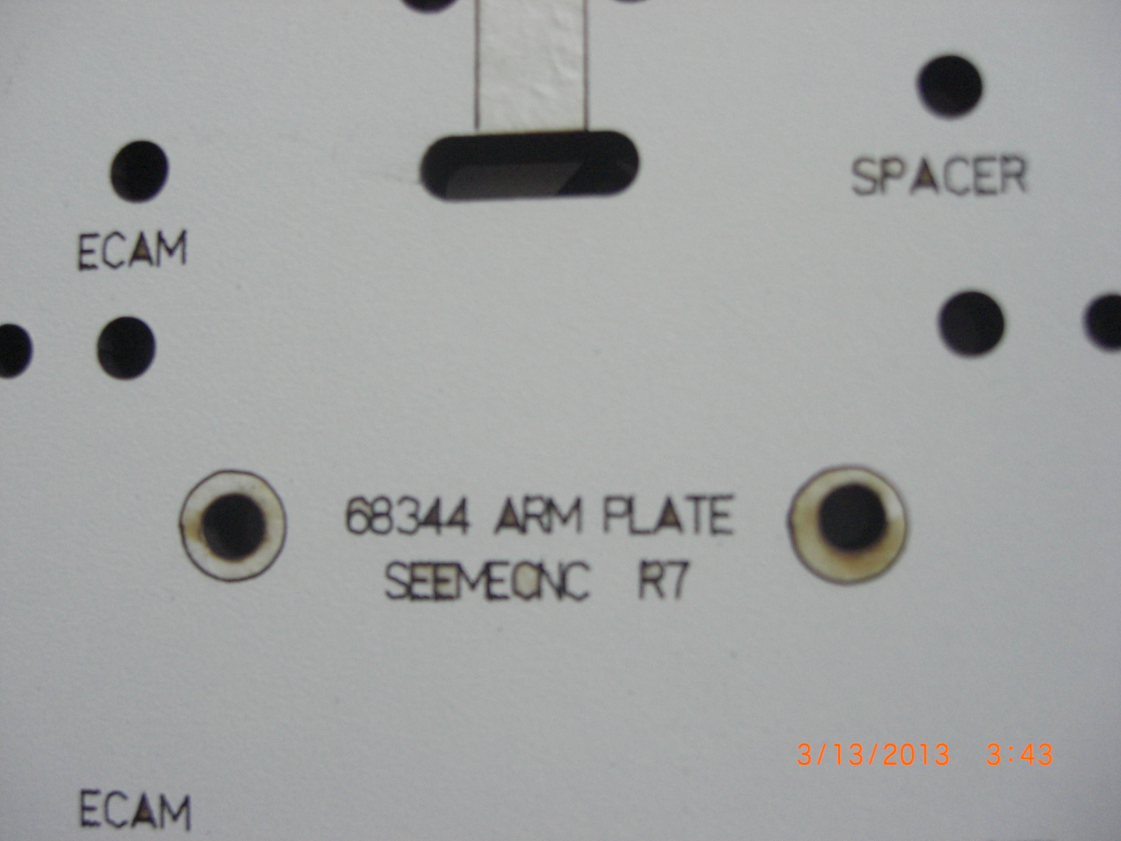

It looks like you are missing #68324 - the hotend spacer. Make sure you don't accidentally toss it!
Found it...Good eye, it was under the pile of discarded parts..

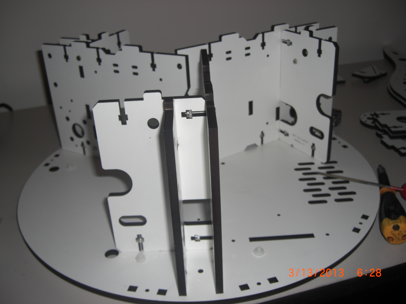

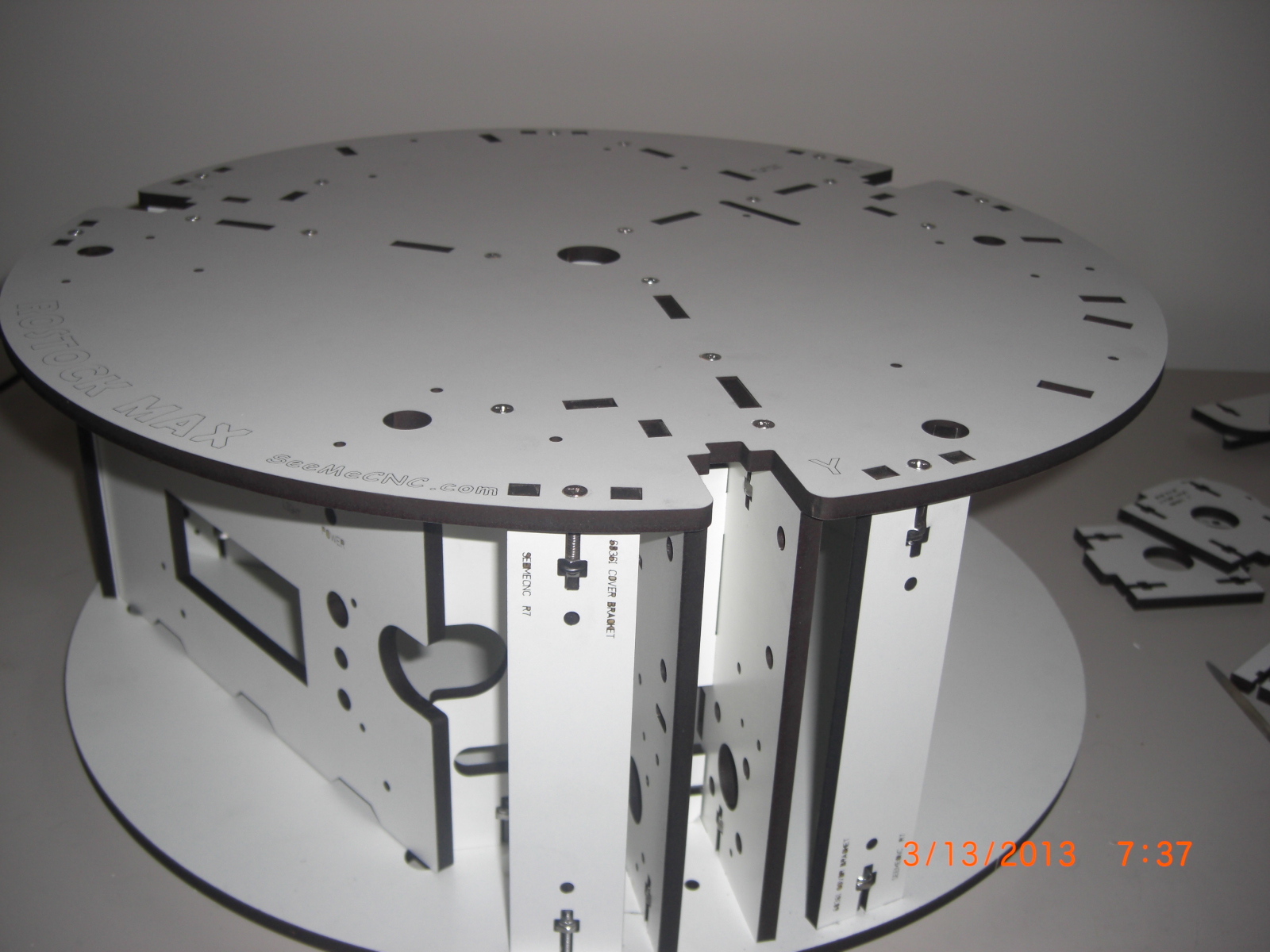

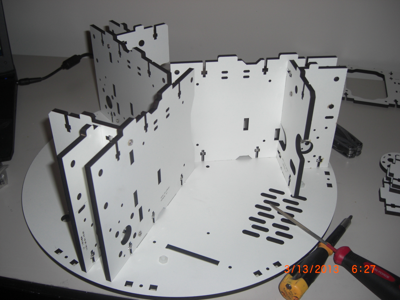

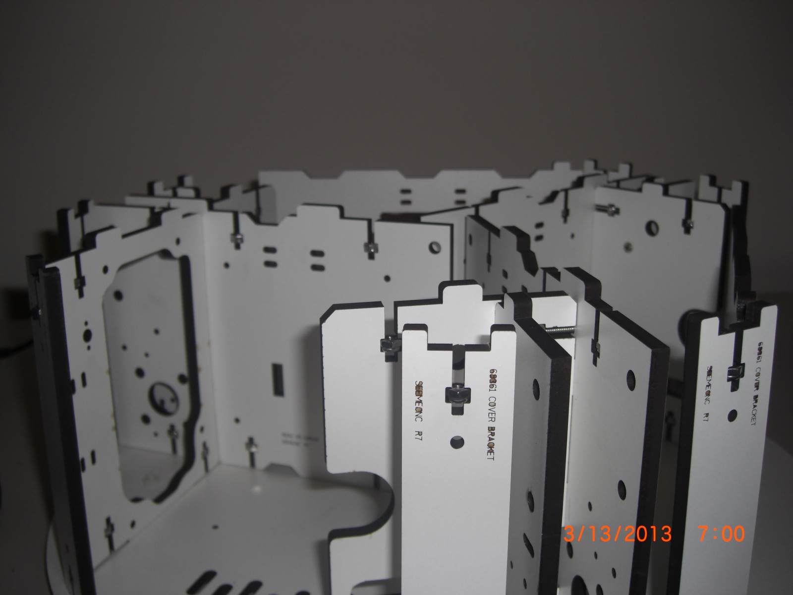

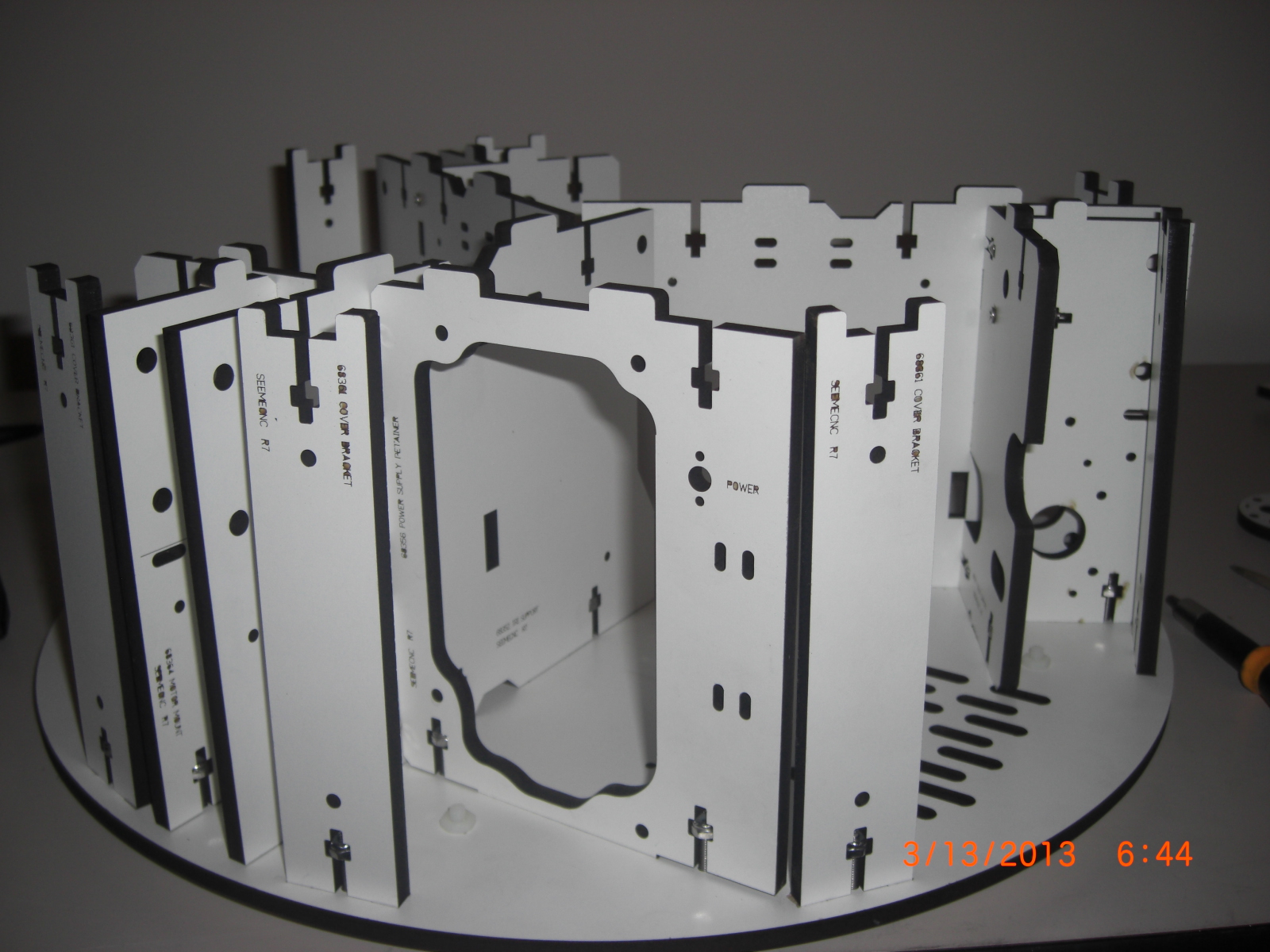

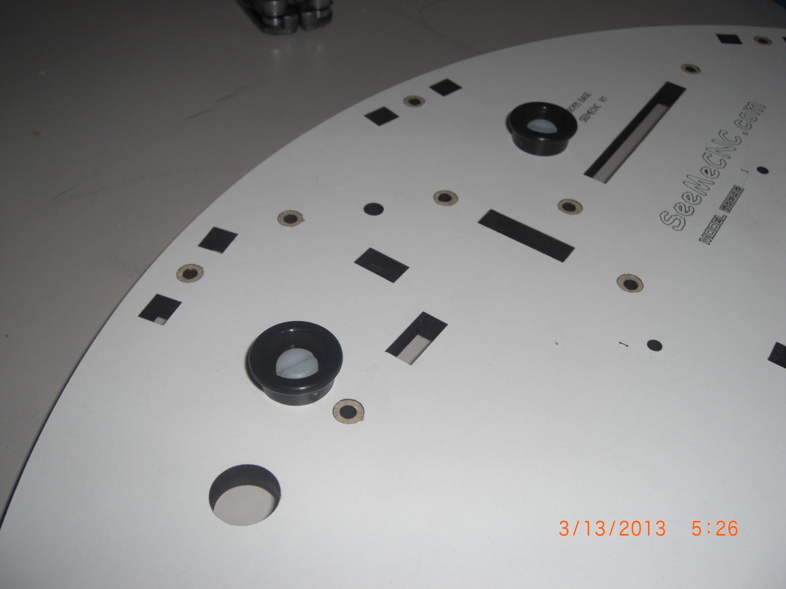

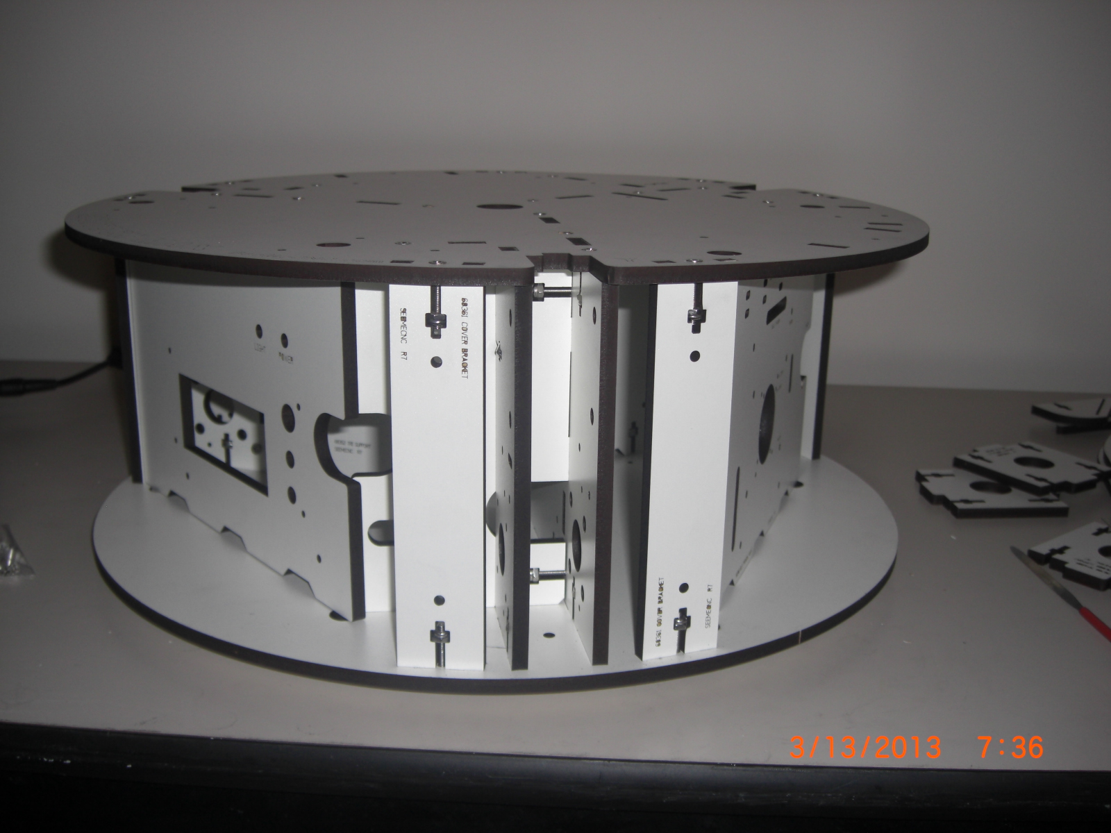

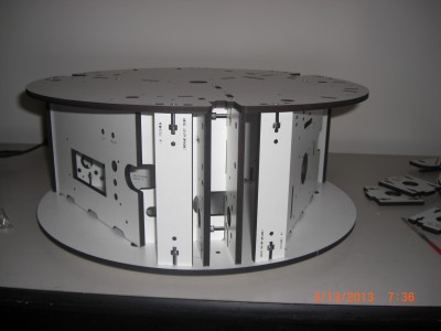

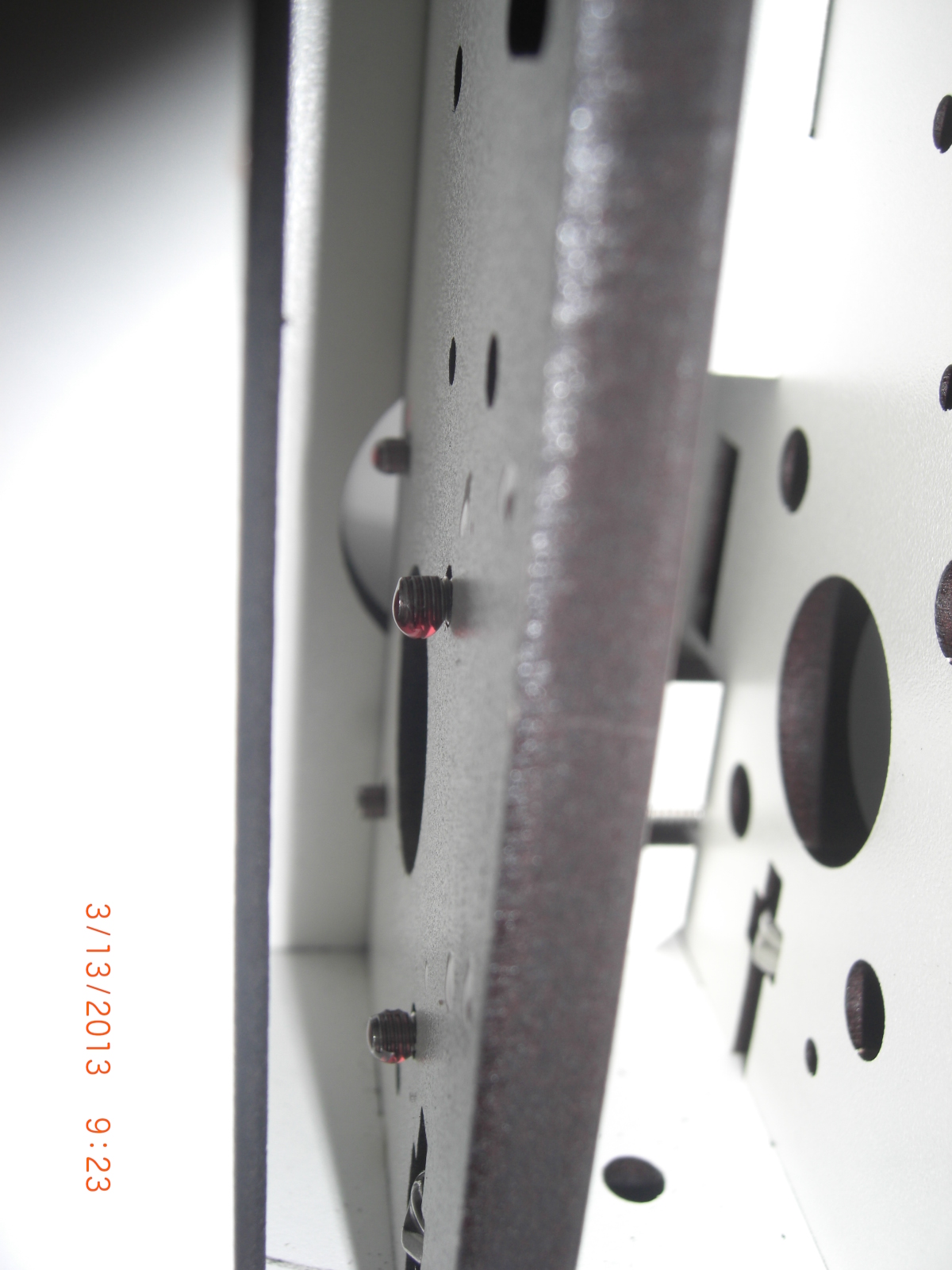

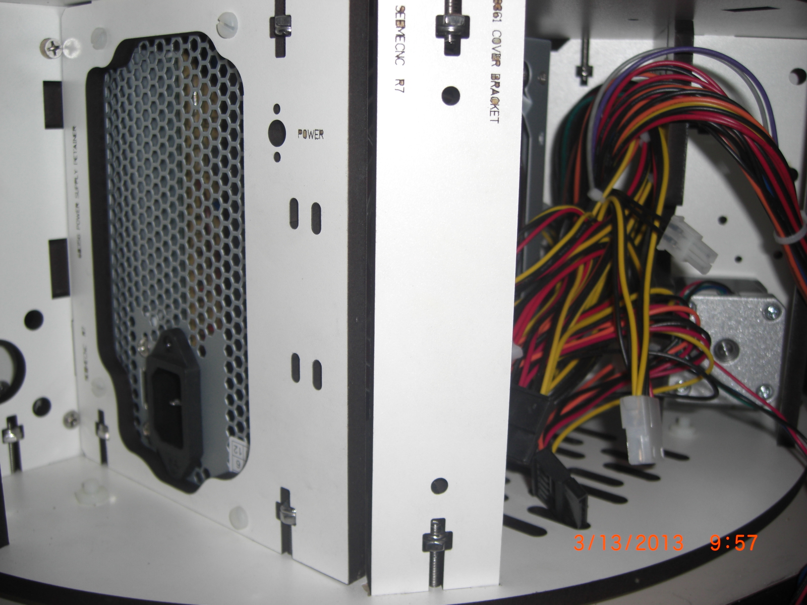

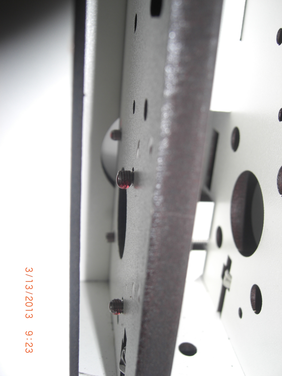

More progress. I did have to lightly sand some holes out for the nuts to fit properly but not all were like that. Some fit perfectly, some holes loose.
Had to do some minor sanding to get some of the tabs to fit. Took me a few minutes to get the top of the base lined up but I got done. Definitely not designed for ease of assembly but so far no major hiccups. Moving right along with genebs assembly guide. The off center countersunk holes weren't lining up but didn't effect assembly too much, just aesthetics.

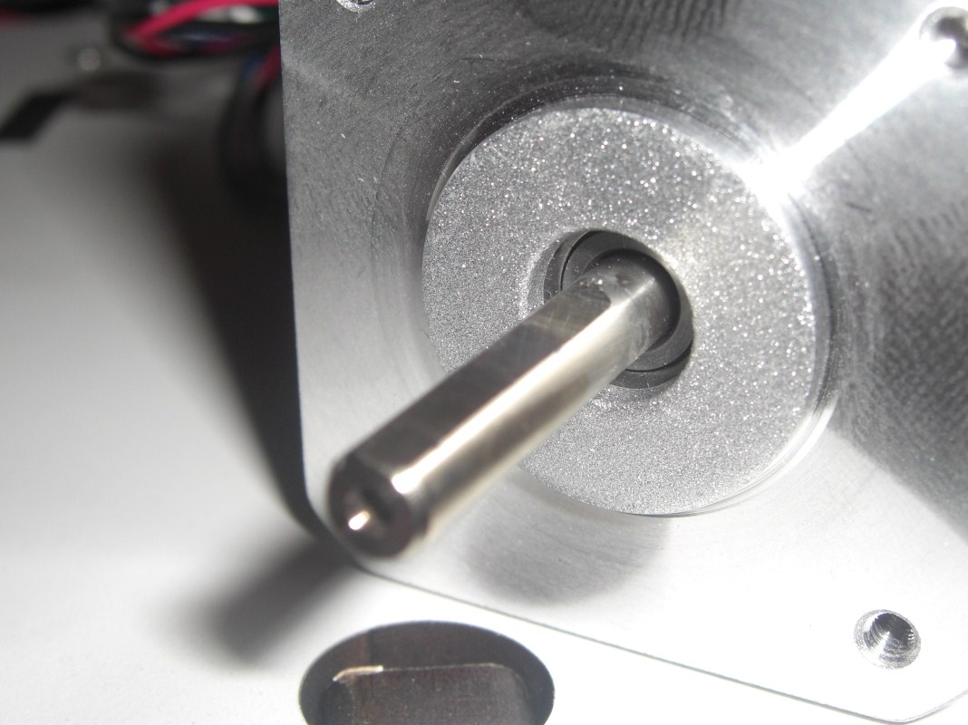

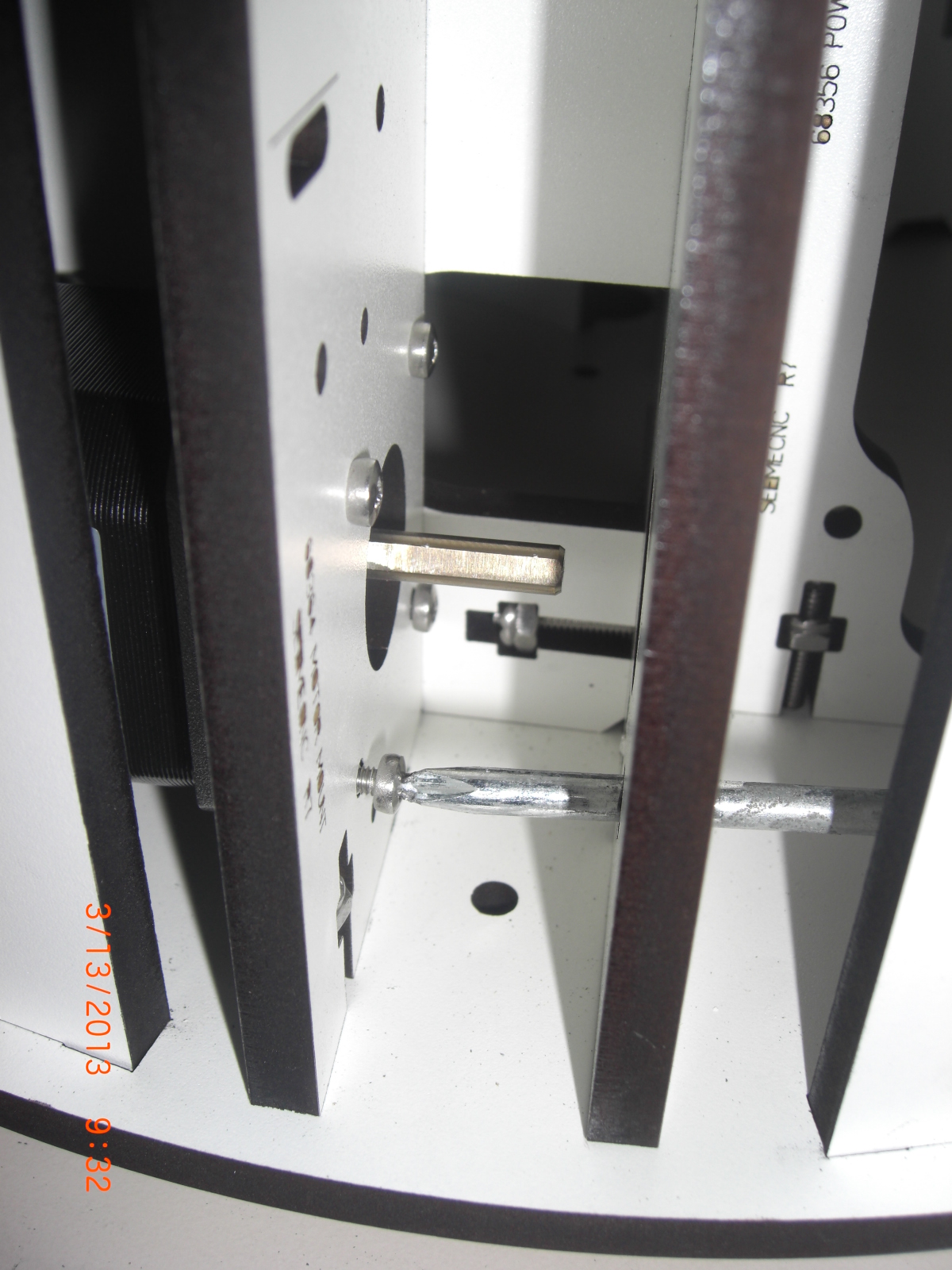

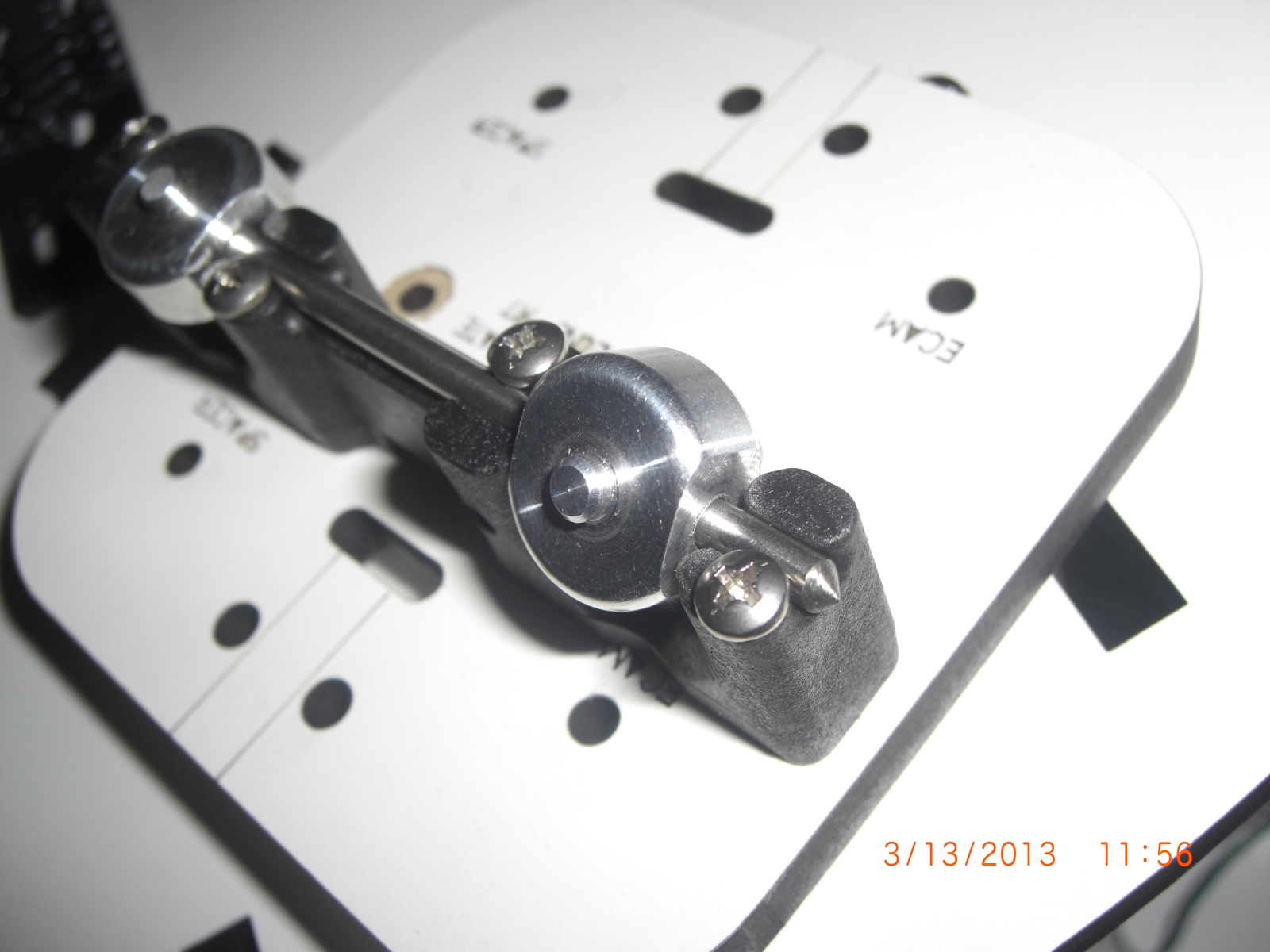

Next stepper motor installation.
These stepper motors didn't have a flat for the set screw so off to the grinder I went. Here is the result.
This will help keep the pulley anchored to the stepper motors shaft. From previous experiences in cnc machines this is a must

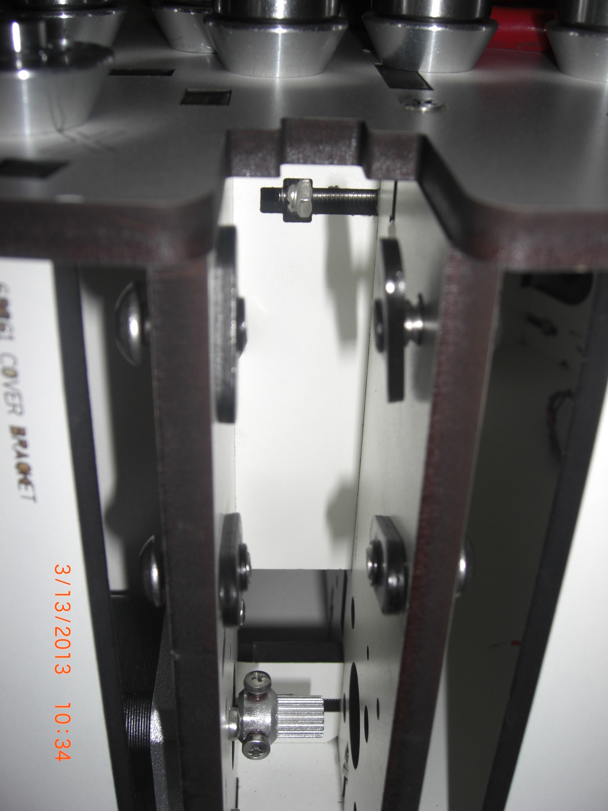

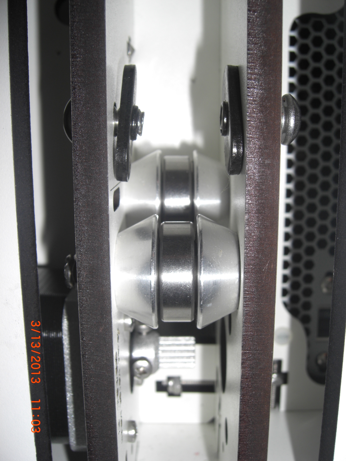

Next I loctited all the screws for the stepper motors and the set screws for the pulleys.
I started putting in the slot nuts for the extrusion and installed the bearings in there places. Installed the power supply.

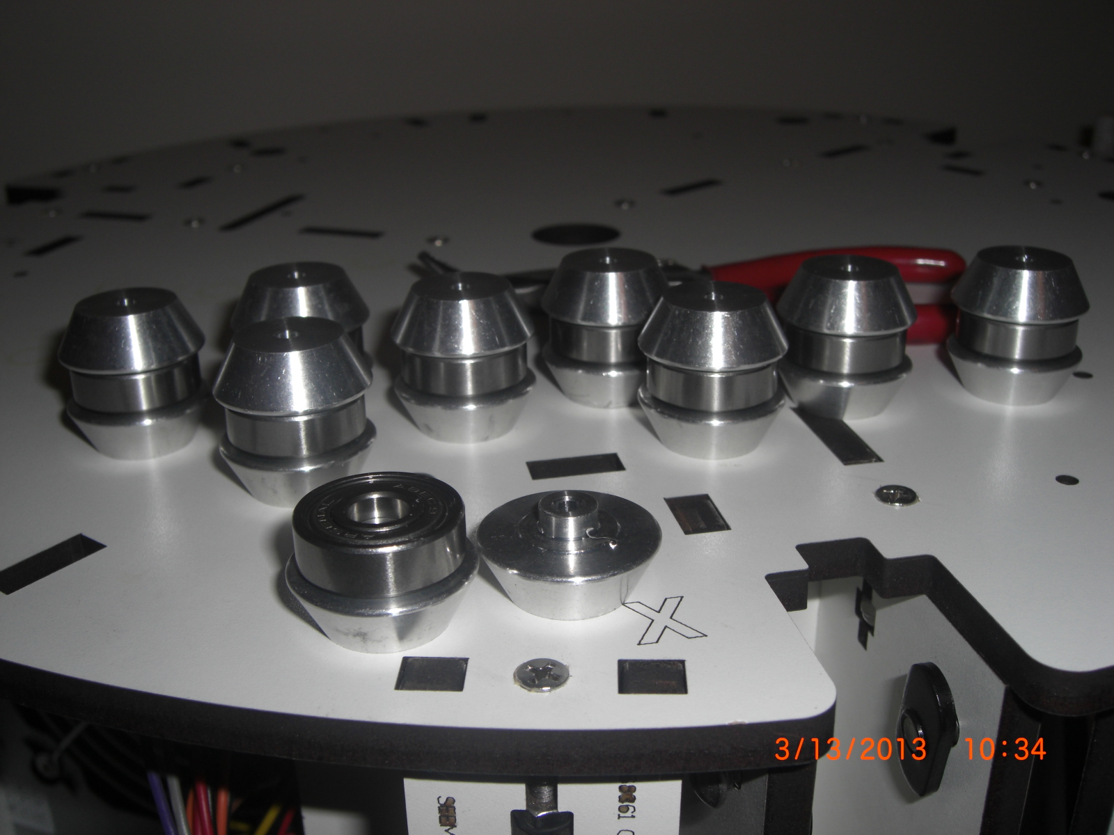

So far still going smoothly with assembly. I then started putting together the cheapskates. This took the most time thus far because the u-joints required quite a bit of sanding to get them to spin freely. Then called it a night.
Make sure when you put the black plastic things (i forget what they are called) on the cheap skates you put the hole for the endstop screws on the same side. That way the screws will be the same for all of the cheap skates. Just cosmetic really but when you bend the tabs on the switches they will all be bent the same way.

You do this free hand because of your experience, do you have any tips on how to make the flats for those of us who are not so experienced?cambo3d wrote:Next stepper motor installation.
I would hate to screw up a good stepper. The whole process of touching the shaft to a grinding wheel make me nervous and at 61 I don't have
the most steady hand. Any tips would be appreciated.
You an do it with a handfile in a vice, but I would put some tape over the front and back of the motor to stop any filings getting into the bearings.Eaglezsoar wrote:You do this free hand because of your experience, do you have any tips on how to make the flats for those of us who are not so experienced?cambo3d wrote:Next stepper motor installation.
- MorbidSlowBurn
- Posts: 169
I haven't done the stepper mod myself. Is there any concern with the radial force of filing/grinding the shaft damaging the stepper?
If you do it in a vice there is none, since the thing held in the vice is the shaft.MorbidSlowBurn wrote:I haven't done the stepper mod myself. Is there any concern with the radial force of filing/grinding the shaft damaging the stepper?
having said that I doubt unless you use a lot of force the radial load is going to hurt the stepper when using a grinder. The much bigger issue is keeping any filings out of the bearings.
I haven't bothered on mine, IME as long as the screws are tight, the pulleys don't slip, and experience tells me that screws on a flat are just as likely to come loose are screws on a shaft, so I'd use loctite on either.
