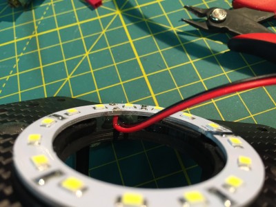

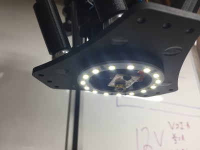

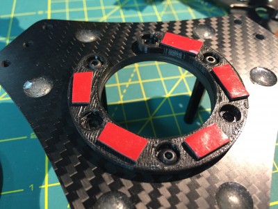

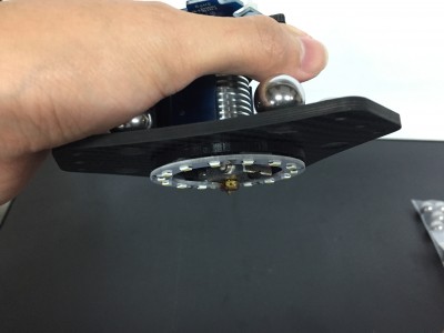

Postby Hobby Creek » Tue Nov 29, 2016 11:01 am
I used these:
https://www.amazon.com/gp/product/B00BG ... UTF8&psc=1
and installed it on the effector with a little double sided tape. It works great and I don't really have to worry about the light level. It does flicker sometimes as the hot end is heating up. What if you just add a potentiometer in line to the LED?
It's upside down in thumbnail. click to enlarge and have it right side up.
