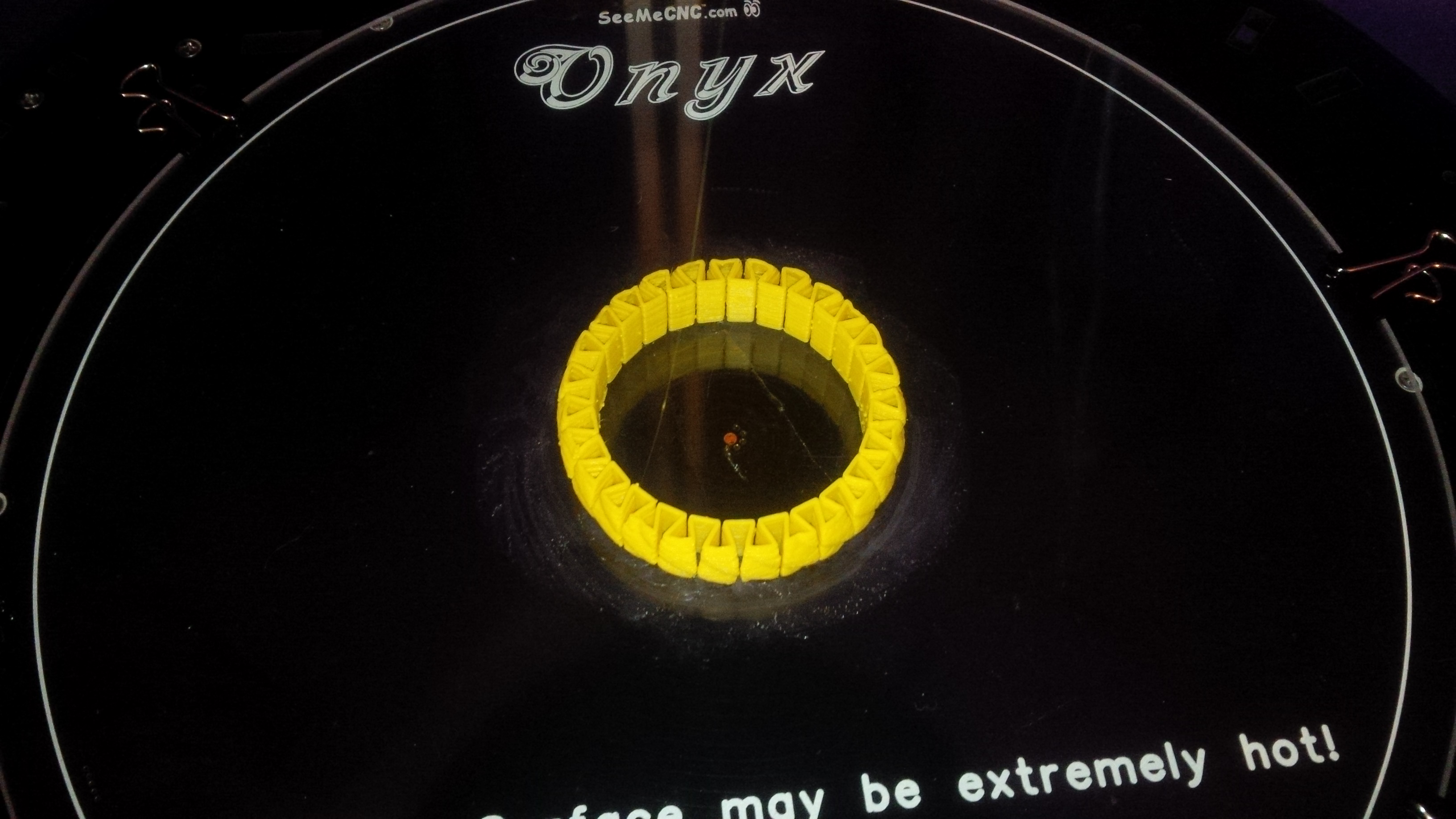

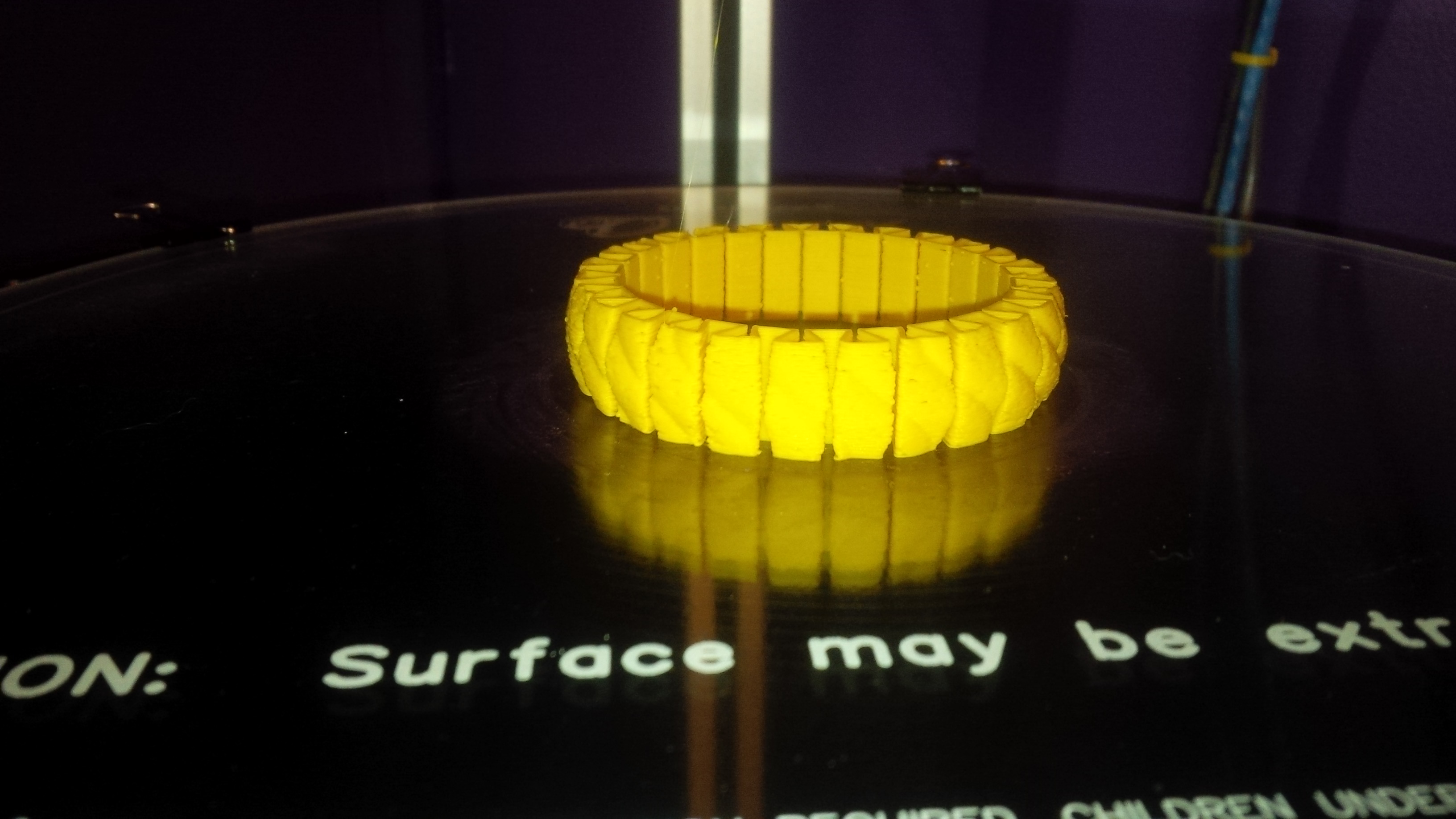

After soaking for the night and a few hours with some tiny pick tools and a very small drill bit powered by hand I got the hot end free from the clog! Back to printing I went. I printed out a stretchlet, it came out alright but not the best. The layers around the outside are very thick and choppy, I dont know if its because of the .stl file I began with or the way it was sliced but it did not have nice fine layers like my test cube did. I dont know, here are some pics:

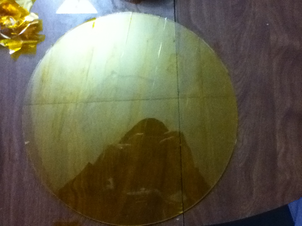

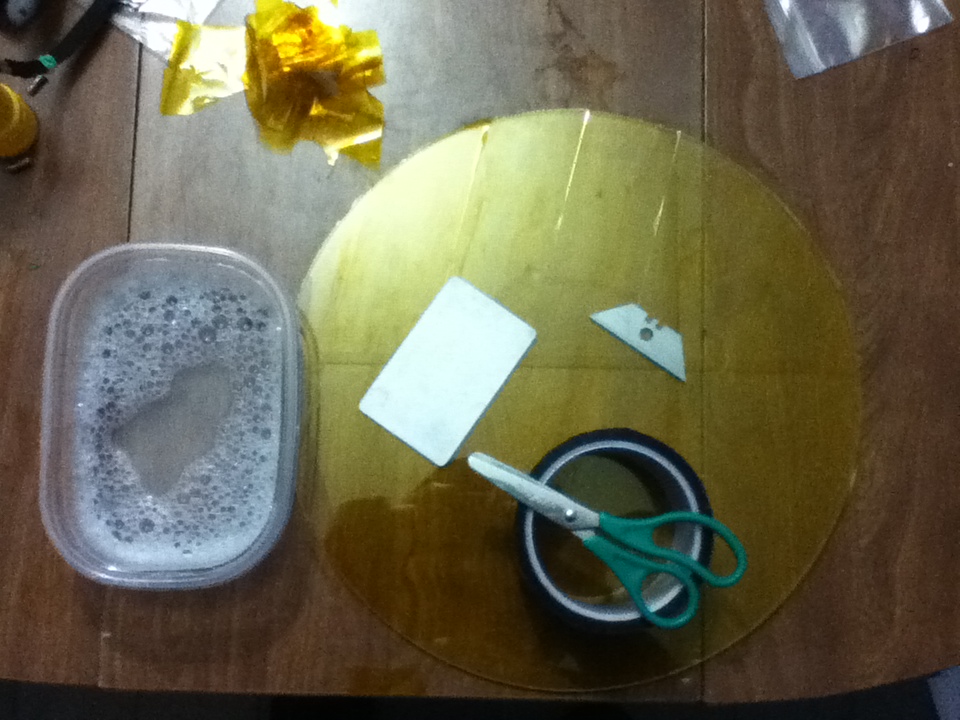

As far as putting the Kapton tape on the glass I found an awesome little trick which worked wonders, sorry don't remember where I found out about this but thought I'd share since it works so well. If you want to cover your glass with Kapton tape then this is how you should do it: Clean your glass with alcohol. Grab some sort of plastic Tupperware dish or big bowl, put a few drops of Dawn in there (im sure any dish soap will do its just what I had) and fill it up about halfway or so, doesn't need to be precise. Now pull out your Kapton tape and cut off a length long enough that it hangs over the edges of the glass a little. Take your length of Kapton tape and slide it through the soapy water fully submerging it and taking it right back out, make sure you dip the whole length so its all wet and soapy. Now just shake off whatever excess and apply it to the glass. The water allows you to slide it around and get it into place easily, makes it easy to but each strip against one another. Once in place then take a credit card or some kind of plastic card and squeegee the water and any air bubbles out from underneath it, just like putting tint on a cars windows, leave in place and keep on repeating until you have the whole area covered as you want it. Once it has dried a bit and is sticking in place pretty well then grab a new razor blade and slice around the edges of the glass to cut off any extra. Now you are done and you have perfect tape on your glass with no bubbles or anything. If you want to print on no tape then just flip your glass over. Pretty simple but it works amazingly well guys. Just thought someone may find it useful
Here's a pic of everything you'll need:
Here's the finished product:

By the way, between the Kapton and a layer of ABS Juice my prints stick absolutely wonderfully now! It's like night and day, before a lot of times it wouldnt even print the ring around the object without lifting and being drug all over the place just building up on the nozzle, I think that was why my hot end clogged in the first place because there was so much built up on the nozzle that it had nowhere to go and ended up backing up into the chamber. But we r all good now!!
Im happy with the results, and my parts are coming out spectacular!

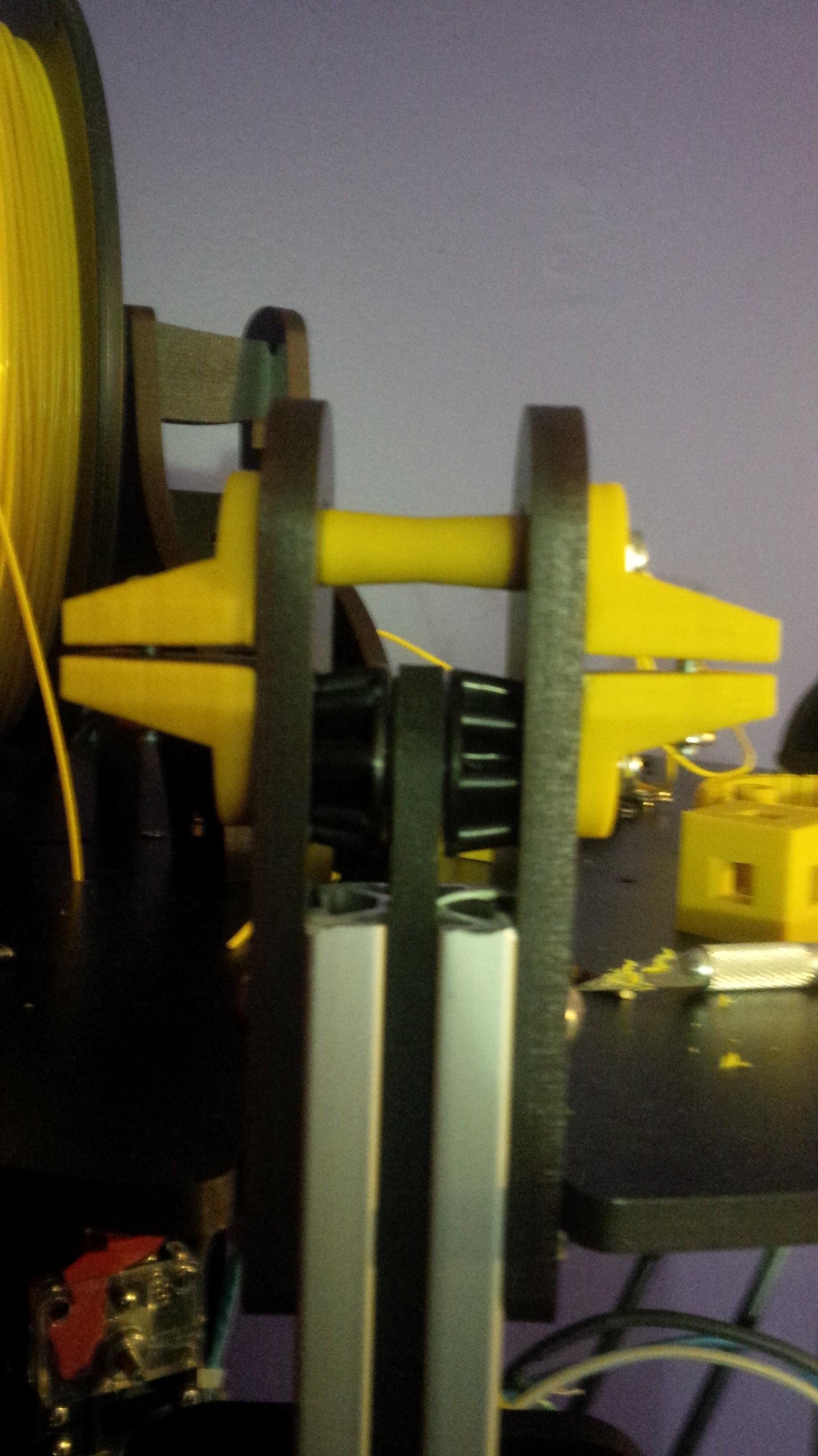

Since I am printing so well I decided to implement http://www.thingiverse.com/thing:87463 and I believe it came out good. I like this idea for the belt tensioner and think I will make the printed parts a nice blue to go with the colors on my Midnight Delta. Here is a pic of one of the tensioners:

Glad to hear the re-calibrate worked out so well. I'm thinking I'll recheck mine after another week or two to allow for any settling in on the machine.
Coincidentally, I am printing those tensioners right now too

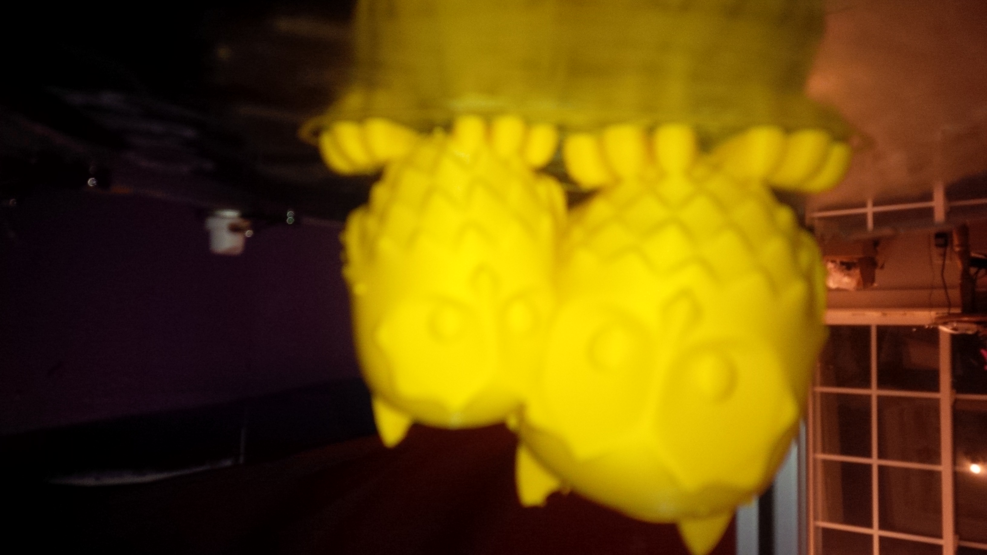

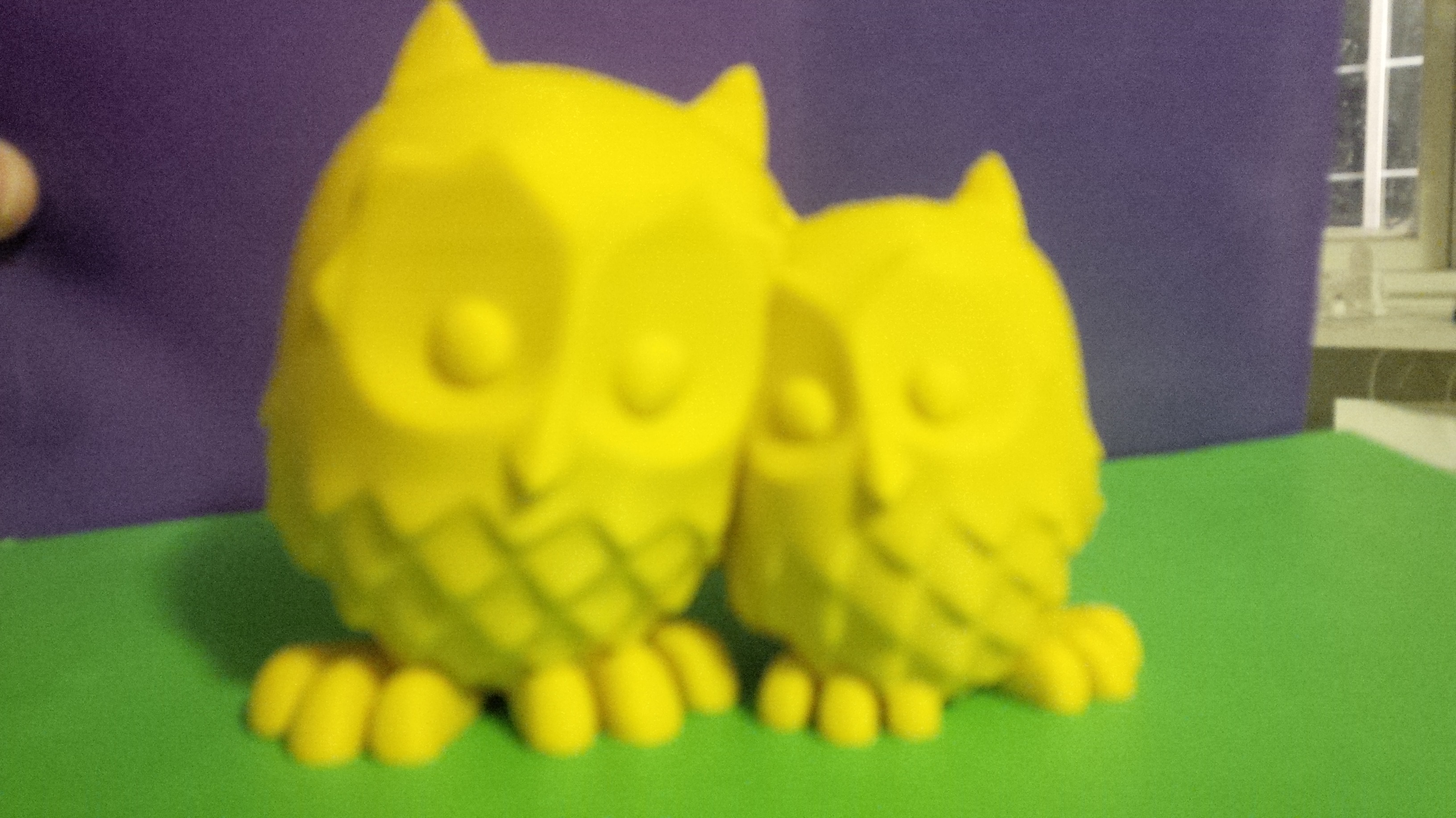

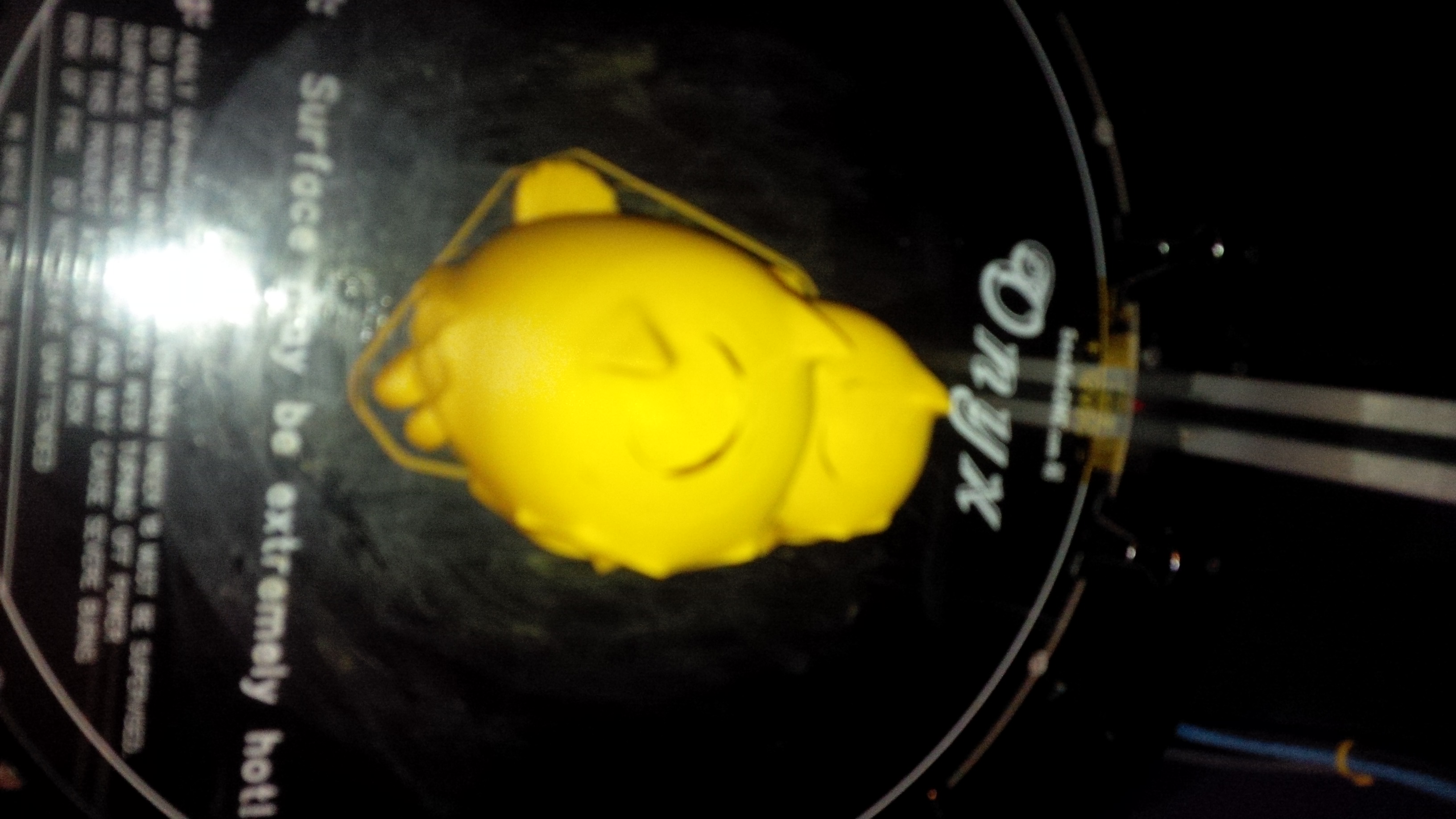

Just printed out these owls for my wife, they came out good except for they tops o their heads.
Not sure why the picture is uploading upside down??!
