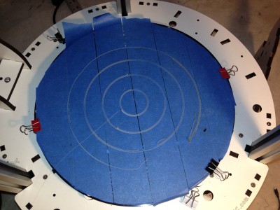

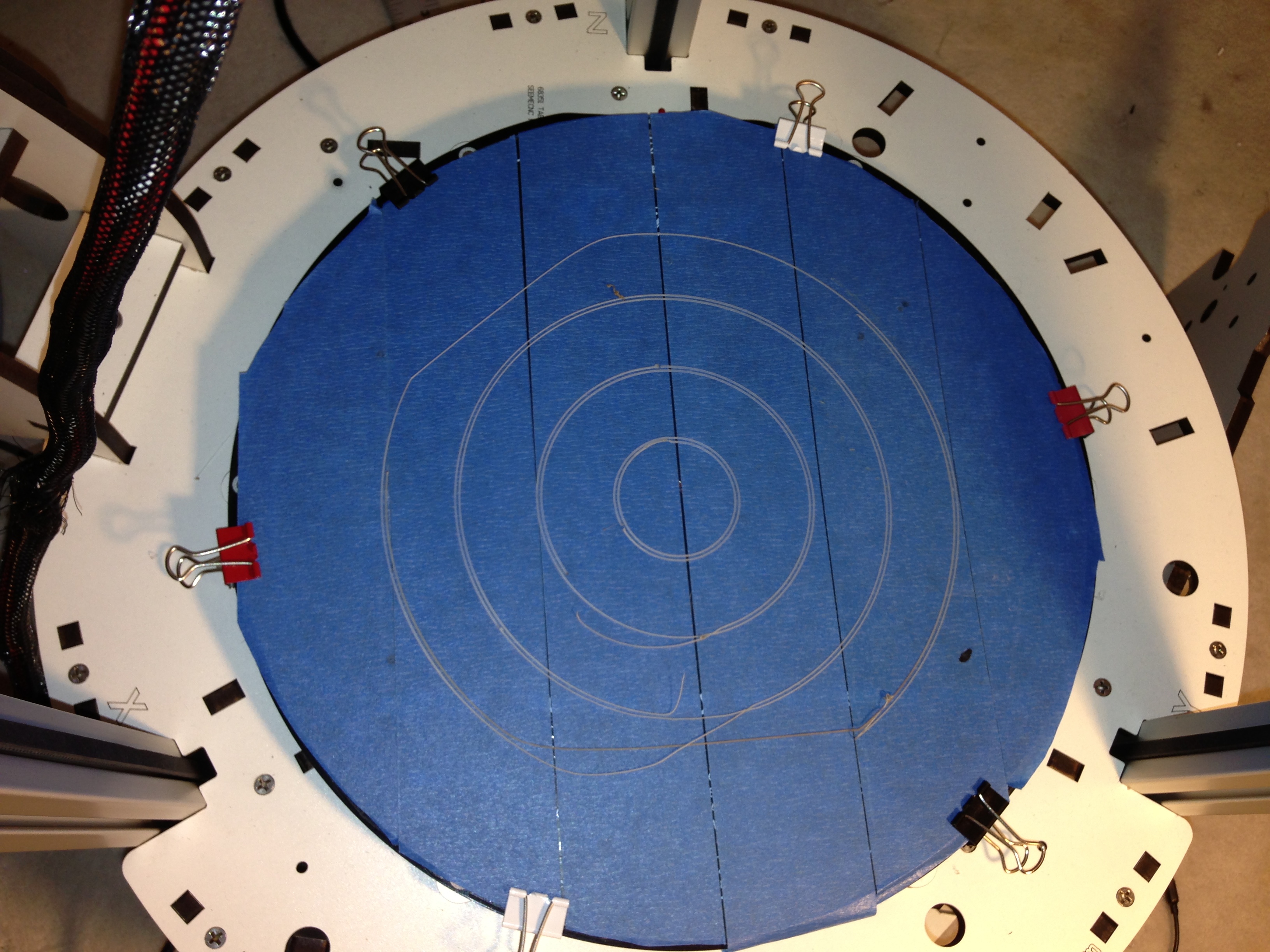

did a quick reprint. did not make any changes just homed the axis and printed
Checking for consistence.
Printed another that looked just like this.
As anyone printed something like this before to check the flatness of the bed. I am interested in seeing some other results.
Posts: 2417
Location: Redmond WA
Re: First 3D Printer Build
Post by Polygonhell »
Honestly that last one doesn't look very far off o me, I'd say in general your 0 is a little high, possibly a little higher on the outside than the inside but I don't notice any gross errors.

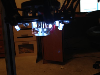

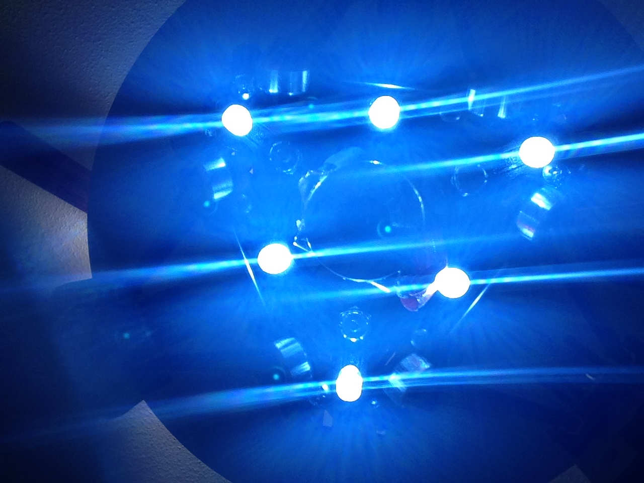

Took a break from the neverending leveling process and removed the delta arms for some sanding. While the arms were off I decided it would be a good time to install some LCD lights and the LCD. I installed some lights in the base as well but I forgot to take a picture of those.

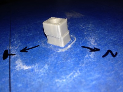

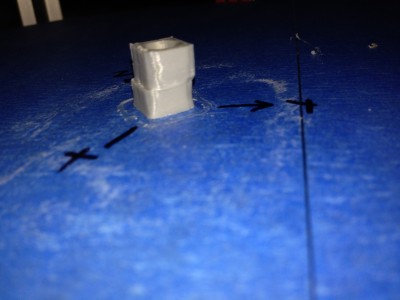

Here is a picture of a print I just made. I think it may confirm you backlash issue. I have not repeated it up 10 times to see if I get to same results. I will do that next.
Not sure how to interpret this.
Either it is a simple belt tensioning issue or something else!
The good news is, that is so bad it should be easy to find the source.
The big sidestep is indicative of skipping a tooth on the belt. Do you hear it, a thunk?

Looks much more like missing steps than backlash to me.
I can't tell is the print vertical before the obvious shift?
