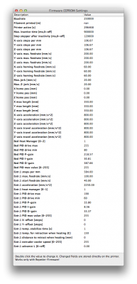

As for parameters:
KISSlicer 1.1 RC2 (released today on Mac)
.5mm skin
2 loops
50% infill
.55mm extrusion width and infill extrusion width
.25mm layer thickness
1.0 / 45° Jitter (new feature as of today, just learning how to use it!)
195°C nozzle
60°C heated bed on blue tape
10mm prime/suck
5mm wipe
20mm/s speed
1.5mm min jump
5mm trigger
On the printer side you can get the accel and extruder speeds on my EEPROM screen shot: stepper digipot 175
Let me know if I missed anything!

Actually that is not a bad idea. It might get people in the ball park. A couple of caveats:
stepper motor acceleration, speeds and current can be affected by your mechanical setup (i.e is your build tight, loose or just right!)
temperature measurements are affected by how you install your thermistor
material settings depend on your specific filament
Re: Mhackney's Rostock Max
For temperatures, maybe you could post temps measured from your thermocouple rather than target thermistor temps. And then we all could aim for those numbers?
I know hotend temperatures are material dependent as well, but like you said, it would probably get a lot of us close.
All the temps I'm reporting are calibrated and are within .5 deg C of the thermocouple measurement.
