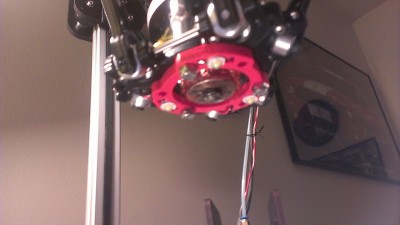

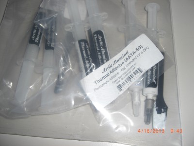

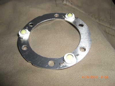

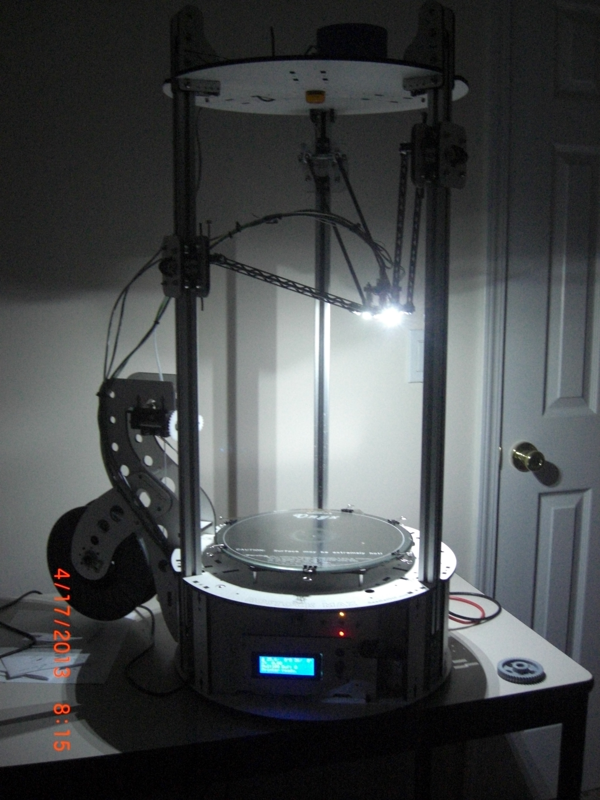

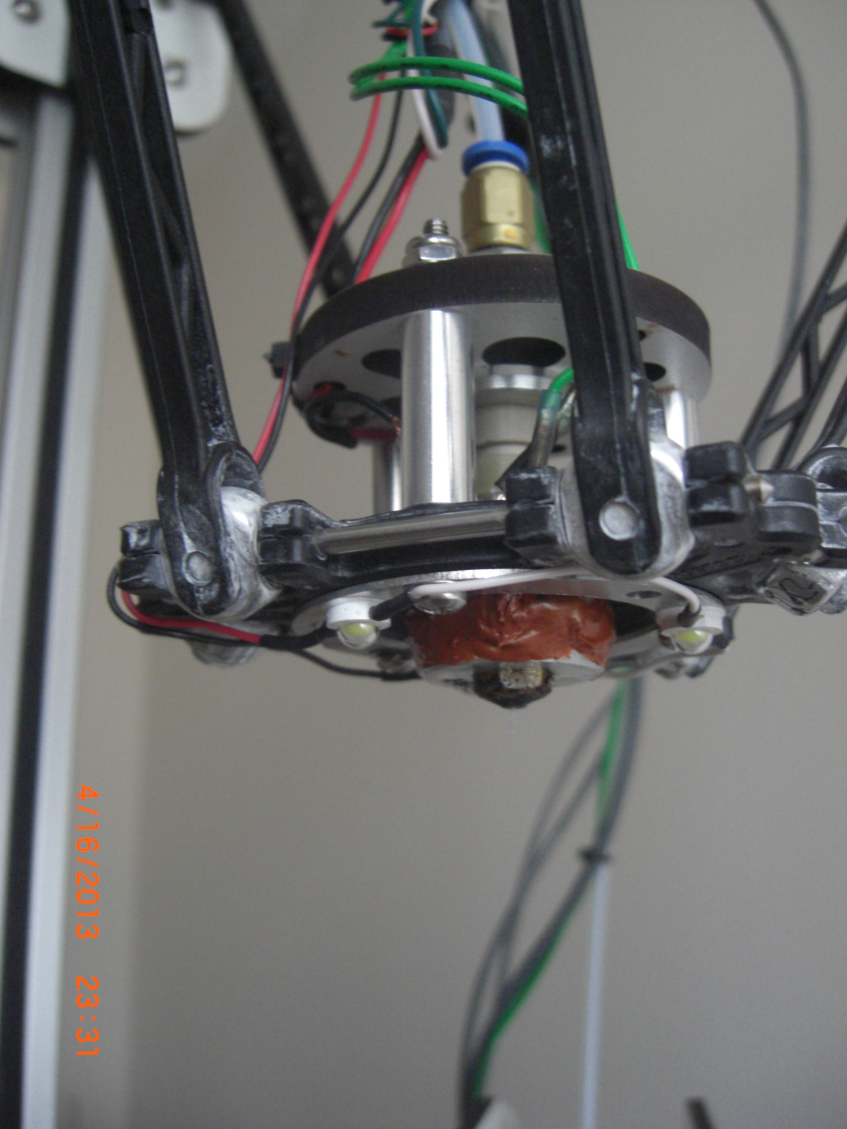

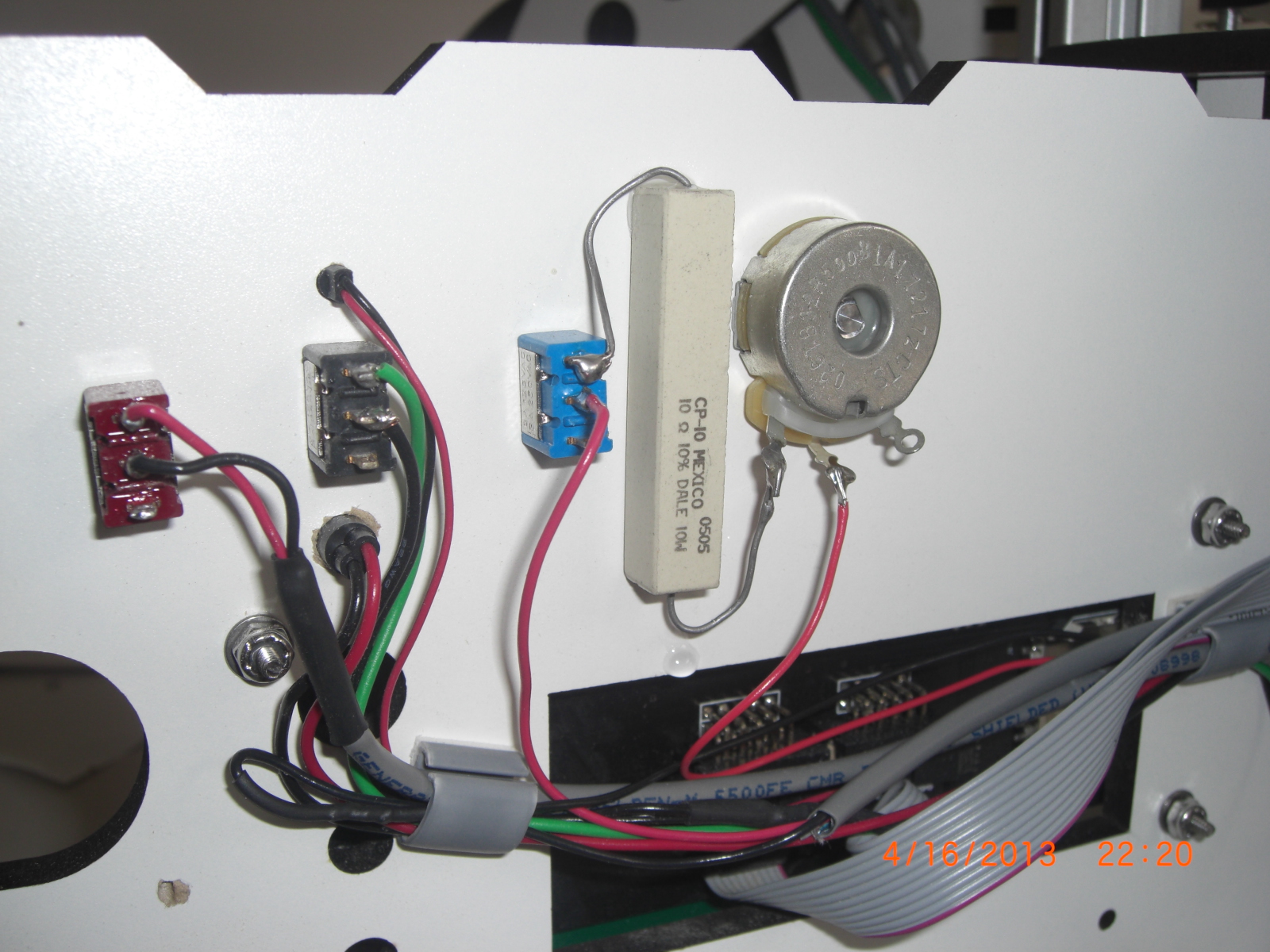

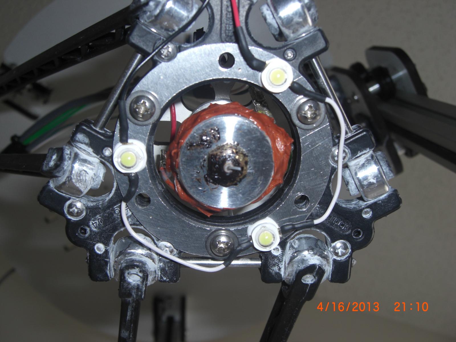

led platform lighting finished
Post by cambo3d »
leds mounted using thermal adhesive epoxy, on my custom cut aluminum heat sink http://forum.seemecnc.com/viewtopic.php ... =260#p9718
50ohm pot wired along with 10ohm fixed resister, and on/off switch
how it looks on the platform all wired up. If I make another, it will be made of pcb material so the wiring and led will be integral part of mount.
powered up turned all the way down dim
powered up turned all the way up bright
IF ANYONE WANTS AN LED MOUNT LIKE THE ONE I MADE JUST SEND ME A PM, I DONT HAVE ANY STOCK TO MAKE THEM AT THE MOMENT BUT I'LL BE MORE THEN HAPPY TO GET SOME.
EDIT: I'M NOTICING A LOT OF FLICKERING WHEN THE RAMBO IS DOING ITS PID ROUTINE, SO I ORDERED A BETTER VOLTAGE AND CURRENT REGULATOR TO ELIMINATE THIS PROBLEM.
problem fixed, using this regulator below. no more flickering.
current and voltage regulator from ebay. http://www.ebay.com/itm/221200620645?ss ... 1497.l2649
simple setup, install and turn your led pot all the way bright, then adjust the voltage pot on the regulator till the flickering goes away. There's also a current adjustment if you need it.

Re: Another rostock max build
Do you remember what size screw you used to mount the ring?
cambo3d
Posts: 1057
Location: Florida
Post by cambo3d »
it uses the stock screws that hold the hot end to the platform, no extra screws needed

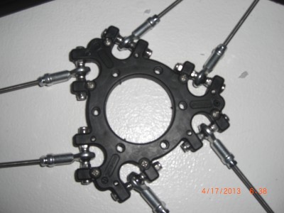

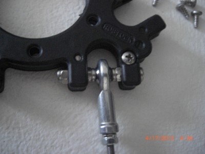

protyping the new china made arms
Post by cambo3d »
can't wait to try these out, so far I see no play in the ball ends and best of all no sanding required. http://forum.seemecnc.com/viewtopic.php ... =260#p9878
i'm using 3mm x30mm Length screws and 3mm lock nuts to attach them onto the rostock platform

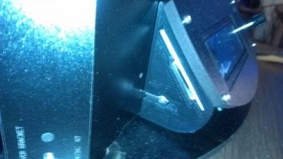

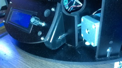

I'm still waiting on my 50 ohm pot but I printed the mount and soldered in the leds.
Your's are really bright. I like that a lot!
Here is a picture of step one for me...
I included pictures of the new mounts I printed for the LCD screen. Cracked the wood ones.
These are ABS!
Bill
right side
right side
Printed LCD mounts
Printed LCD mounts

i dont' know why didn't think of reprinting my angle mount for the lcd.. i'm gonna do that now. i broke mine awhile ago. didn't dawn on me to print a replacement...

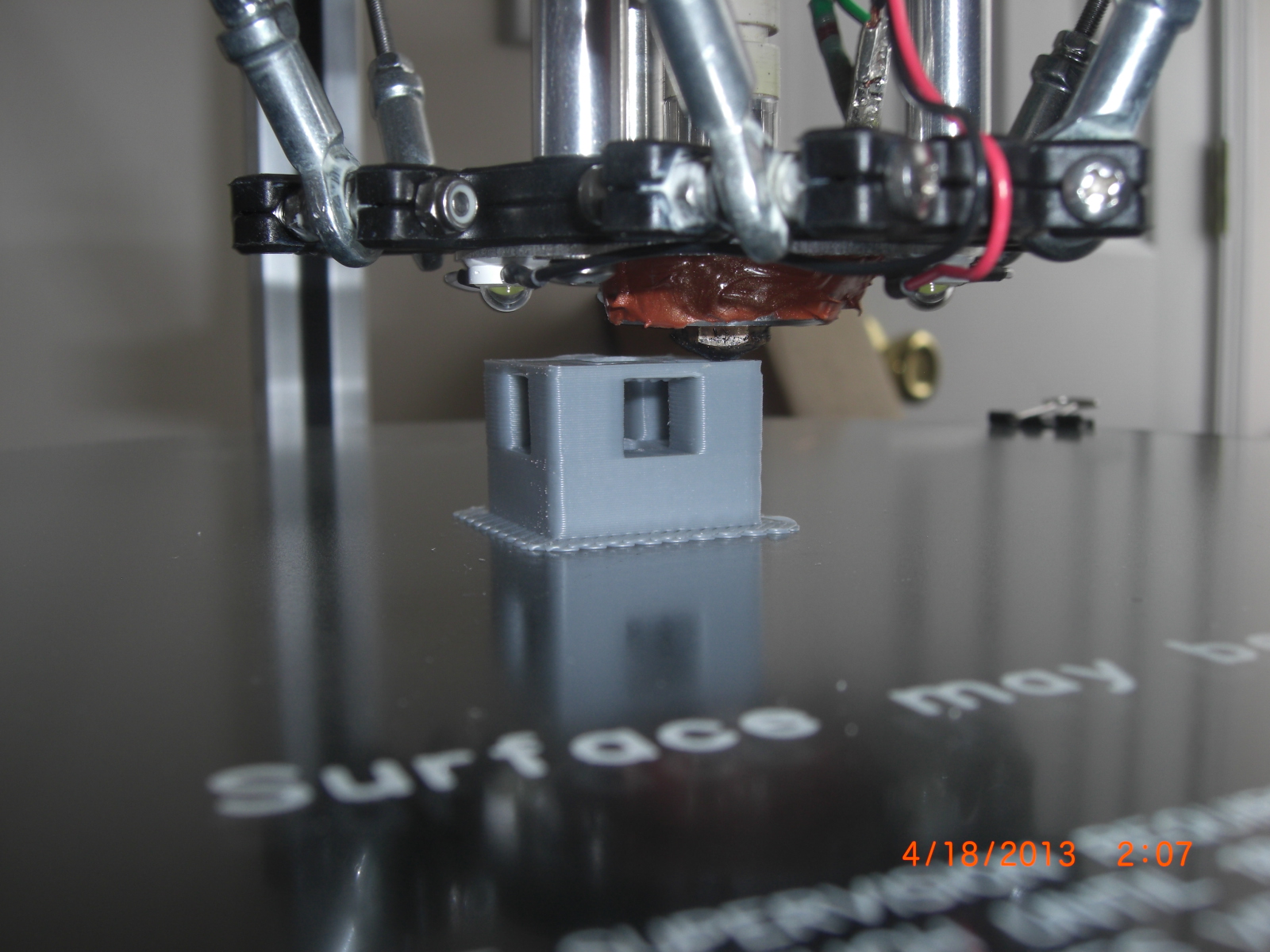

new arms work geat so far
Post by cambo3d »
installed today and doing a test print, with the cal cube. Working great so far.

aerouta wrote:How come you ordered from China instead of going with the trick laser arms? Do you have more pictures of the print or the finished product?
I had both sets coming to try but so far these china made version is working great, the print is still cookin, will post another update when done.
update: probably my best cal cube so far. still need to do some more tweaking to my flow rate. to the get the towers in between the windows to line up a lil better. Is that what what I need to adjust to fix that?

Re: led platform lighting finished
cambo3d wrote:leds mounted using thermal adhesive epoxy, on my custom cut aluminum heat sink http://forum.seemecnc.com/viewtopic.php ... =260#p9718
I am trying to learn so I have a question, what would happen if you disabled PID?
If you wanted to keep PID where would you place the voltage regulator, on the output of the power supply or the input to the LEDs?

[quote= I am trying to learn so I have a question, what would happen if you disabled PID?
If you wanted to keep PID where would you place the voltage regulator, on the output of the power supply or the input to the LEDs?[/quote]
its small you just place it inline with the power going to the leds, if you disabled pid it wouldn't flicker it just would go dim and bright when the board starts its heating routine.
Now I am beginning to understand, you are taking the power for the LEDs from the power connection to the Hot End. As the current to the Hot End varies, the LEDs also receive varying
current thus the dimming. On the same note, you are running your Onyx from 24 volts - the output from the Rambo heatbed connector is the input to an SSR that controls the 24 volts to
the Onyx. In the case of the Onyx, would you want to disable Pid for the HotBed so the input to the SSR is a more stable on or off?
