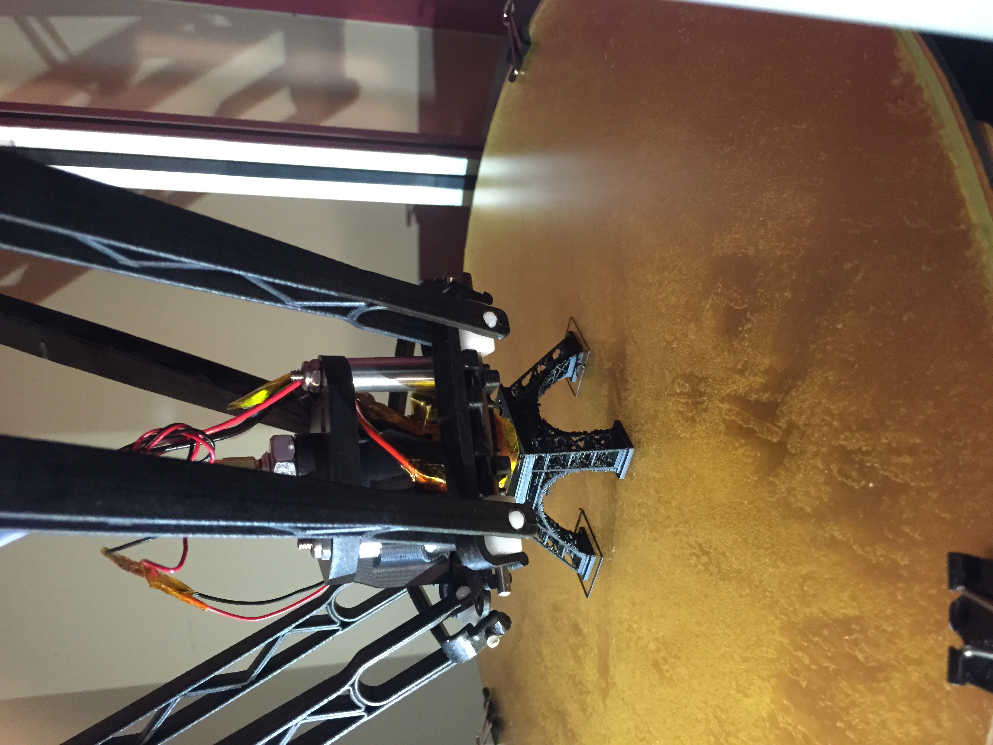

Printing the Eiffel Tower (thingiverse.com/thing:22051). This has a very small footprint on the deck. Had a bit of trouble getting the ABS to stick. After 3 tries, I increased the deck temp to 100 degrees and so far working well.
Not sure why I agreeded to such a complicated print, but my kids convinced me. In the end is cool.

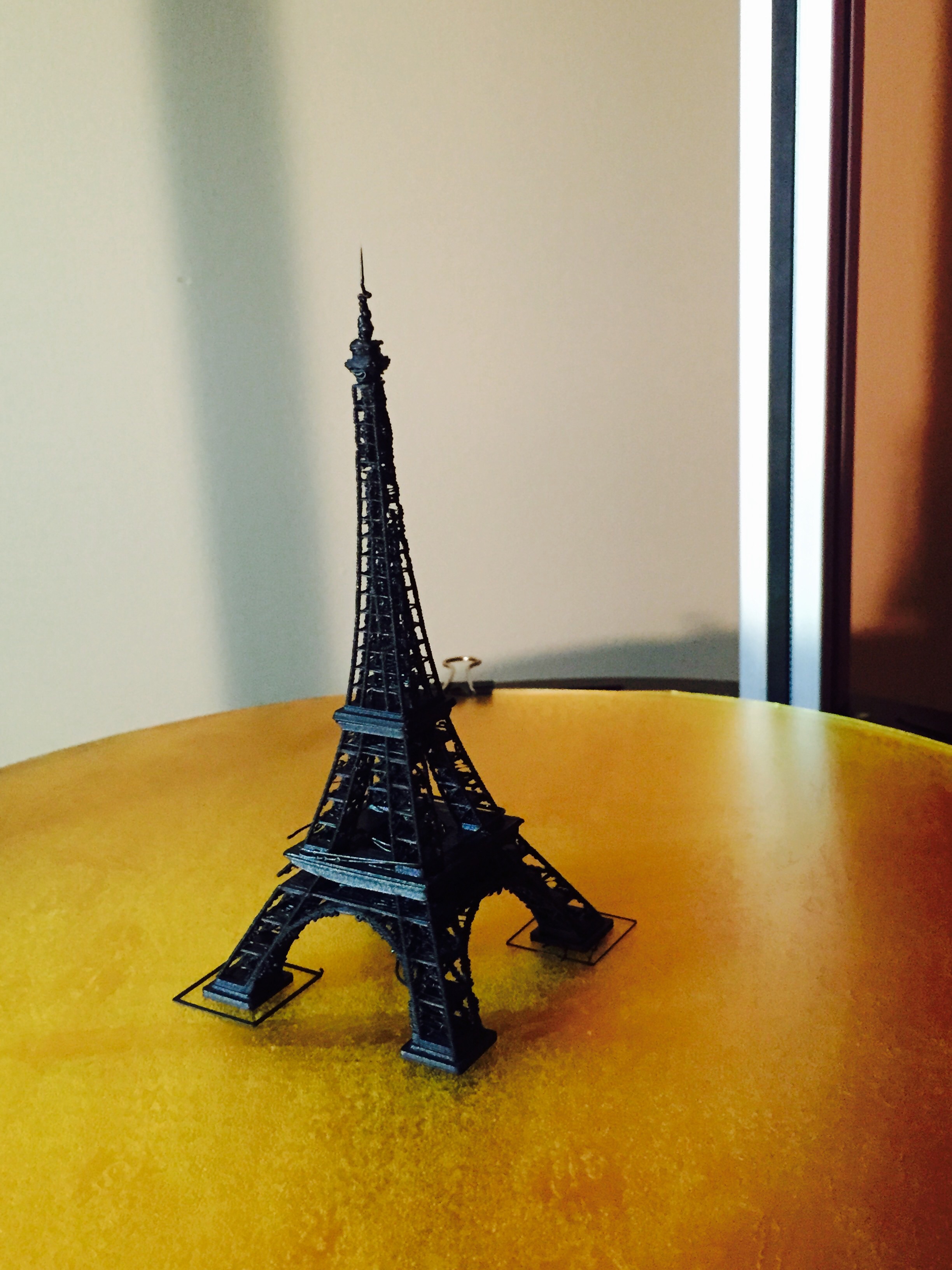

Second Print!!! :-)
Post by 3D-Print »
Here it is!!!

teoman wrote:Make sure those wires sticking out do not have any metal exposed. Getting a sort there is a good way to go on a fuse hunt. ( contact with the hotend resistor wires are also a good location to get a short)
Thank you!
I did wrap with Kapton tape twice. I have been watching it closely. Not impinging. But maybe should have cut them shorter. I may put a loop in them to keep them out of the way.
This totally rocks. My teenagers and I have been sitting here watching it print for 3 hours.

I realize the print is only as good as the print design and programming. The Eiffel Towere is totally cool but has many imperfections. Is there a grading system for the quality of a .STL file?
An iPhone 5S case is next.

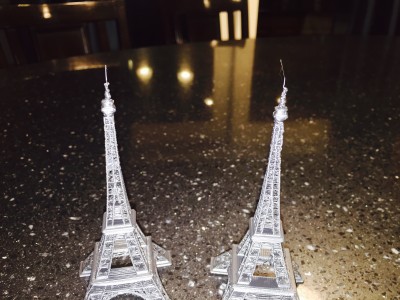

Print #2
Post by 3D-Print »
Overall interesting. Some parts of the print collapsed. Is this programming? Speed?
Still was fun.

At 100 degrees it stuck and was nicely adherent. Was able to "pop off" each "leg" of the Effile Tower at about 70 degrees very easily. Much better than not sticking at all at 80 degrees!!!
Wiped off the print surface with isopropyl and now loading up an iPhone case. :-)

You have to tune your settings a bit.
Try dropping your temp a bit.

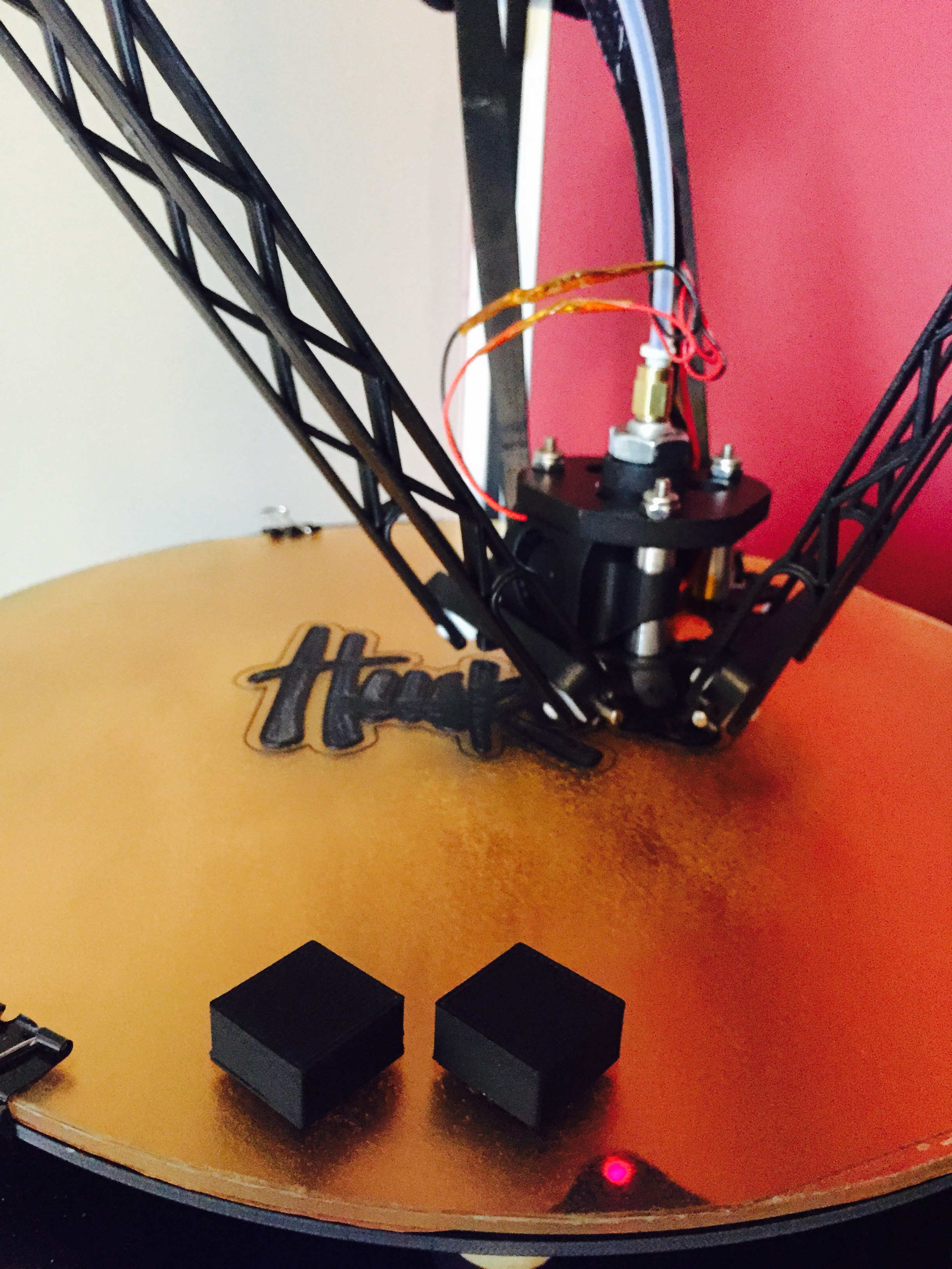

Getting our "BAP" Calibrated!
Post by 3D-Print »
So Surprising the Eiffel tower looked OK, however as detailed (http://forum.seemecnc.com/viewtopic.php?f=36&t=7361), the basics. Printed the calibration cube and although was happy overall, the first layer did not set well. Was adherent well, but one corner is curl up.
Thus, changed the first layer thickness and dropped back my HotEnd temp to 220 and bed to 90.
Running it again.

I slowed down the print which helped to see what was happening.
I changed the first layer height to 0.2 mm. With this a nice layer, however, there was some dragging of ABS by the tip which created a mess. I think, I will change this to 0.23 mm next time. Trial and error........ but learning!!!

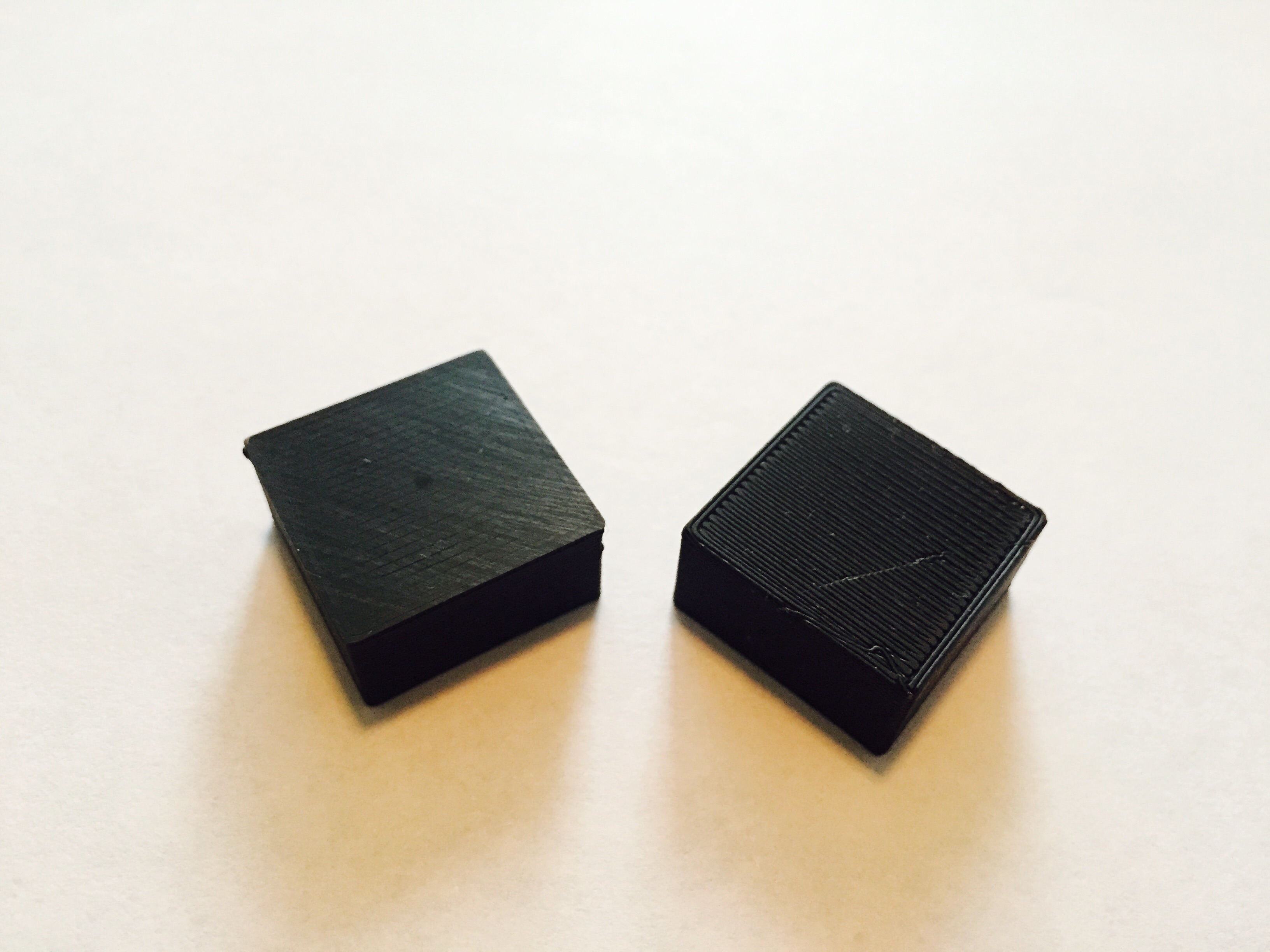

Ran the calibration Box. Only a few layers which were disrupted.

I can see the difference when I set the first layer of ABS to 0.2mm vs 0.25. The 0.2mm sticks quite nice with a bed at 95 degrees. HotEnd was 220 degrees.
Is a bed at 95 degrees to hot with my PEI? Pieces come off ok and a couple popped of at 90 degrees.

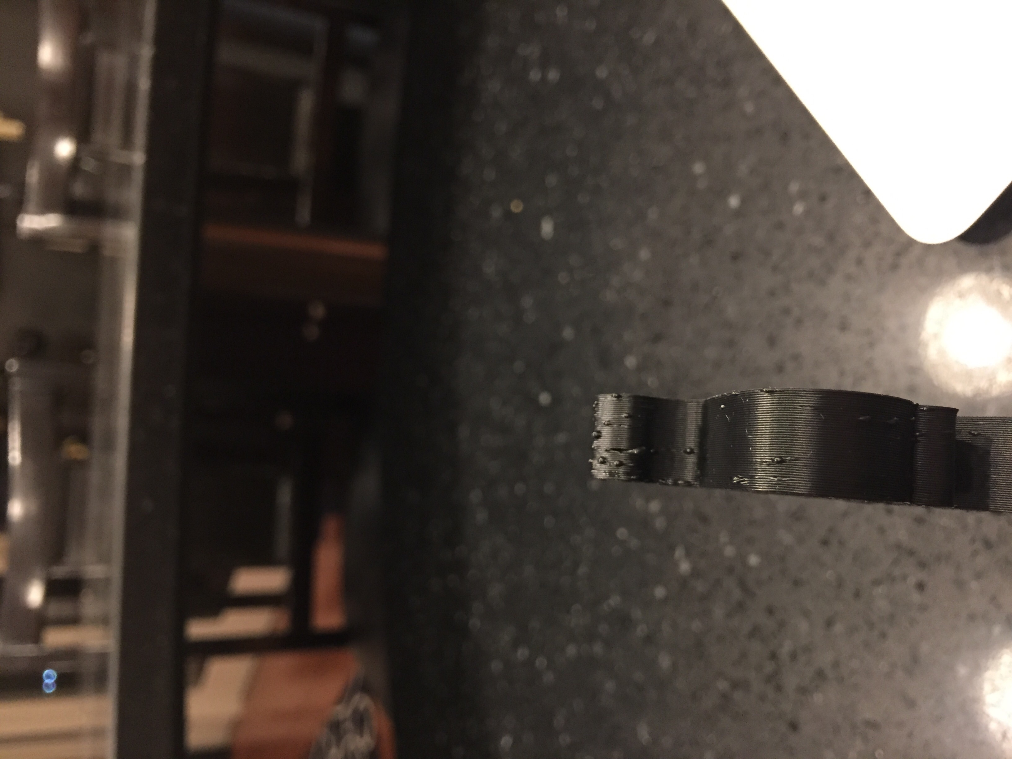

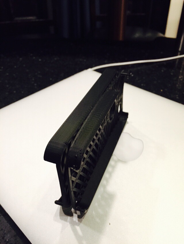

Trying to figure out why we get a bleb once in a while. I watched the HotEnd and when it is laying down at the edge, it would pause for a bit and that is when a bleb or bulge would form. Is there a programming feature to avoiding these blebs? More to learn!!!
Again, thanks to everyone for their amaizing insight and help!! :')
Dan
3D-Print
Posts: 519
Location: Omaha, Nebraska
Refinement.
Post by 3D-Print »
Ok. So in reading and watching the printer I think these blebs occur at retraction points when to much filament is extruded. Thus, I set the extrusion multiplier to 0.9. Thought about increasing the mm retracted but it also seemed reasonable that adjusting the overall rate would achieve the same thing since it appears there is general amount of excess. Then I sat and watched printing and backed off a bit more during printing with the tuning adjustment in MatterControl. We will see!

Re: My "BAP"
Post by 3D-Print »
Here are some of those "blebs!" Or what ever you want to call them.
Am I thinking about these little devils correctly?

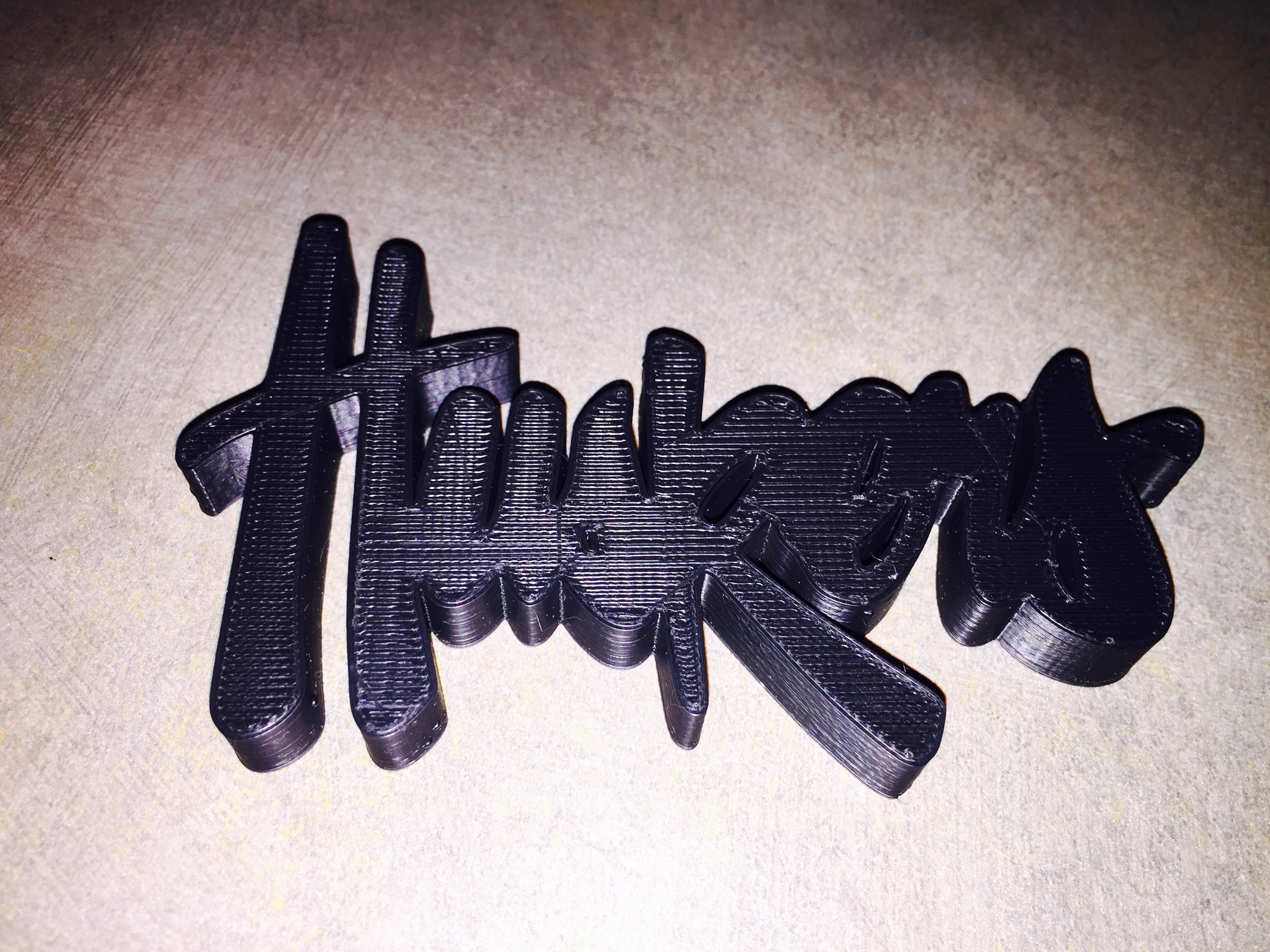

Re: My "BAP"
Post by 3D-Print »
Much better results with round #2 (left side) as compared to my first print (right side). Step wise problem solving:
1) Changed the HotEnd to 225 degrees and the bed to 90 degrees.
2) Set the extrusion ratio to .89. With this iPhone case print, it resolved the blebs. I'm now reprinting the Huskers. Will see if there are less blebs on that reprint.
3) Also increased the number of final layers to 4 to see if it smooths out the final surface.

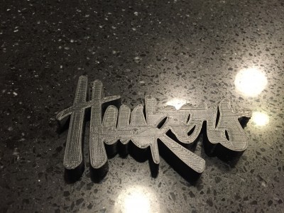

Post by 3D-Print »
A reprint of the "Husker" Logo was successful with only two blebs (at the bottom of the "H") and none after I turned down the extrusion ratio to 0.86. The finished surface has a bit to be desired and increasing the number of layers to 4 helped.
More for later but I think I need for "filament flow" for the last layer to ensure I fill the gaps between each course. :idea:

Refining My "BAP"
Post by 3D-Print »
I think I just found it. I need to modify my top fill extrusion width! Another trial of this tonight!!!
