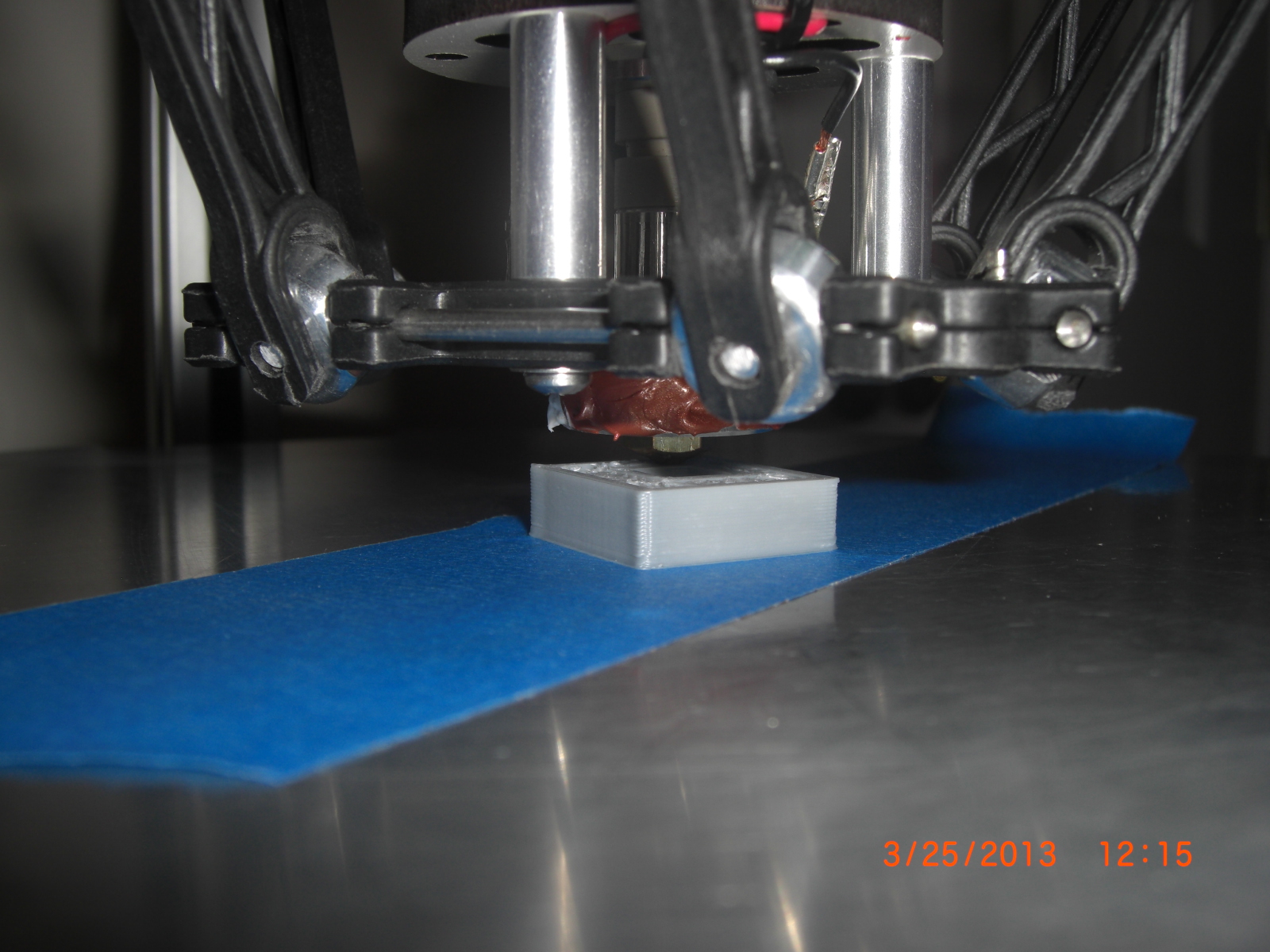

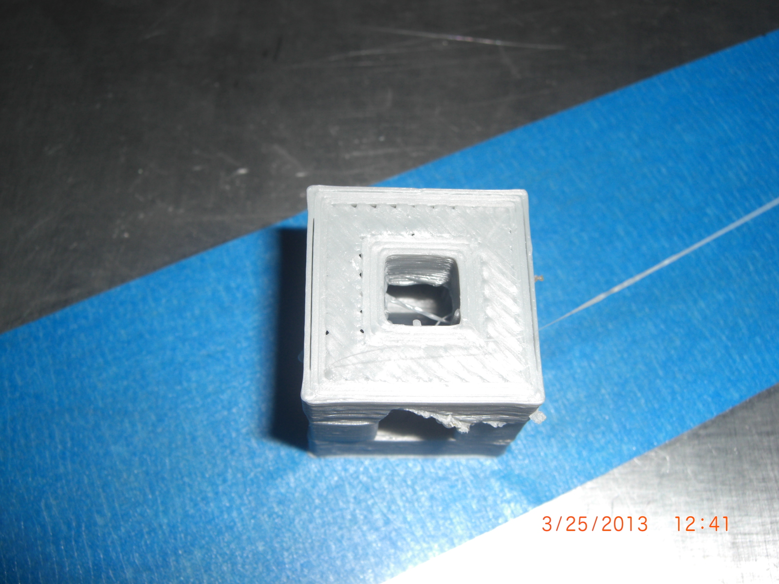

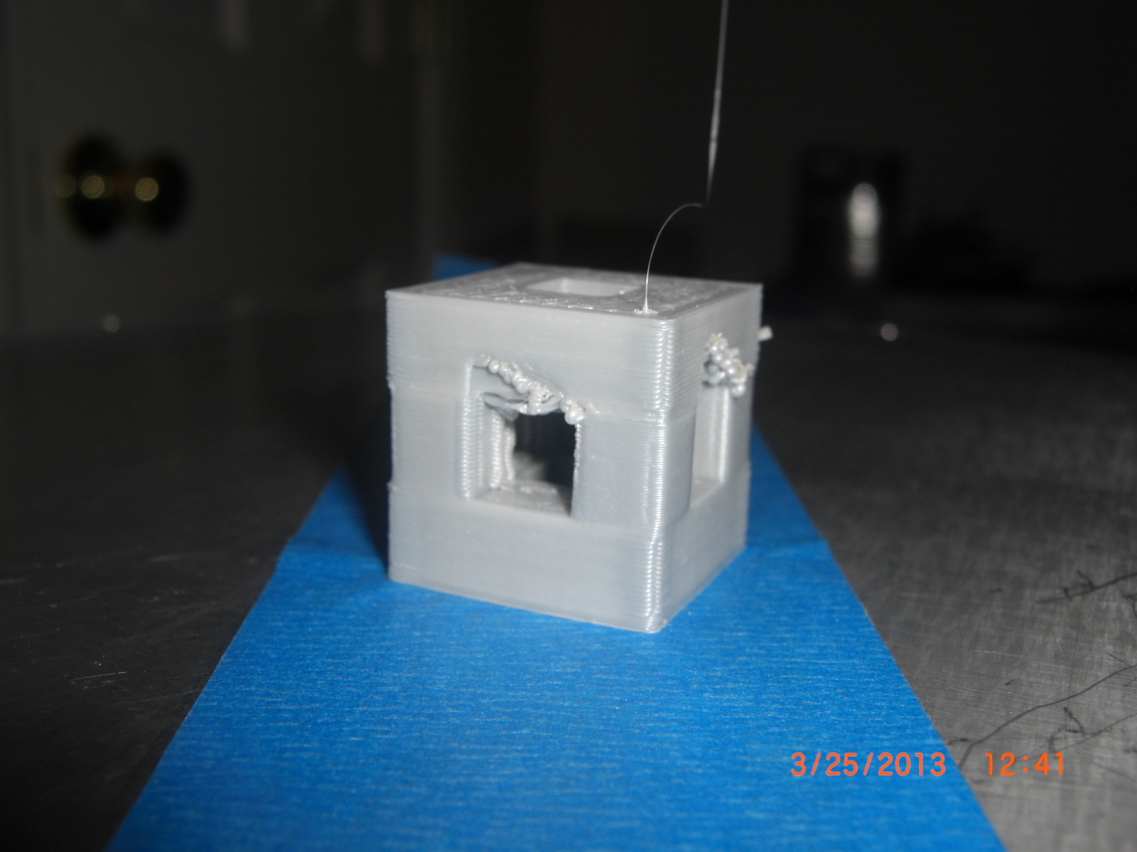

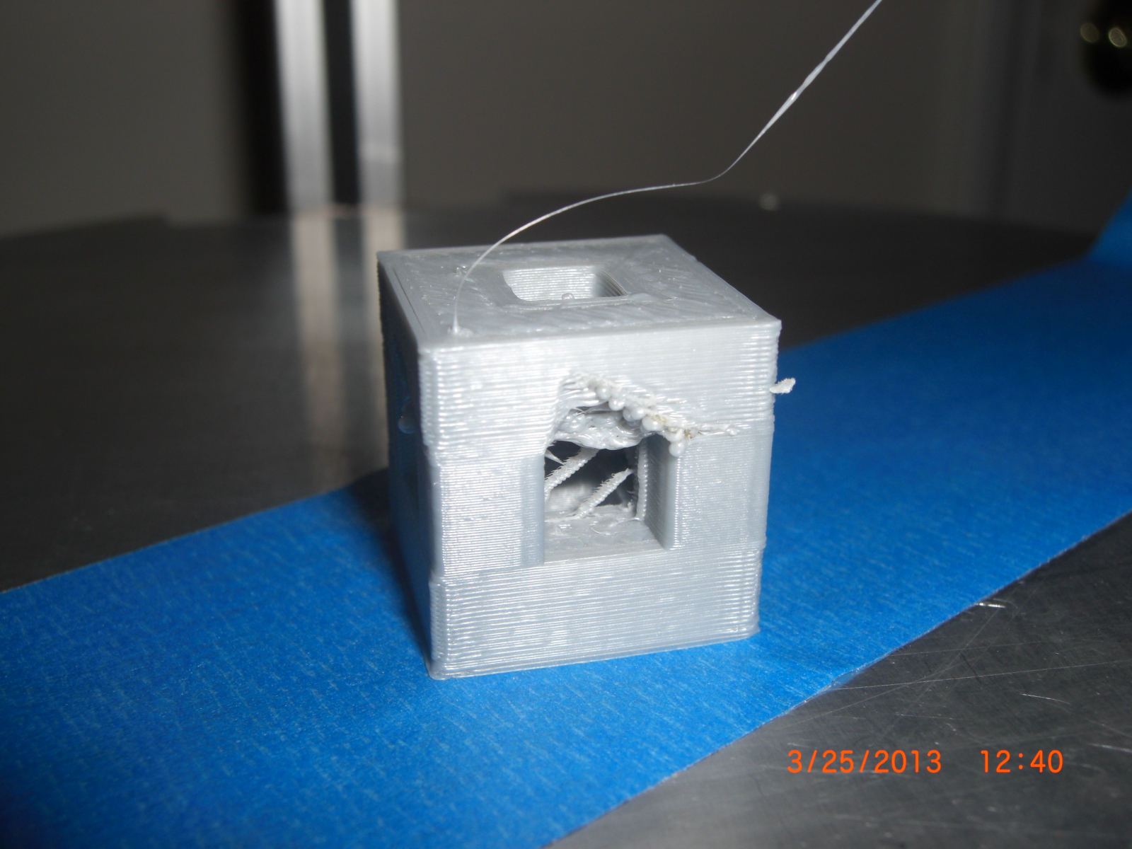

just did my first print, the calibration cube following geneb's manual. This is where all the 2 weeks of assembly time start paying off. While the print isn't perfect. I'm excited that it printed something.
for some reason i had to add in a z offset, otherwise it would get to close to the print bed, I put in 1 mm as a guess it seems to print it. probably need to adjust that.
Please critique this print and recommend suggestions on how to get a better print. THIS IS MY FIRST PRINT EVER!!! WOOHOOOOO

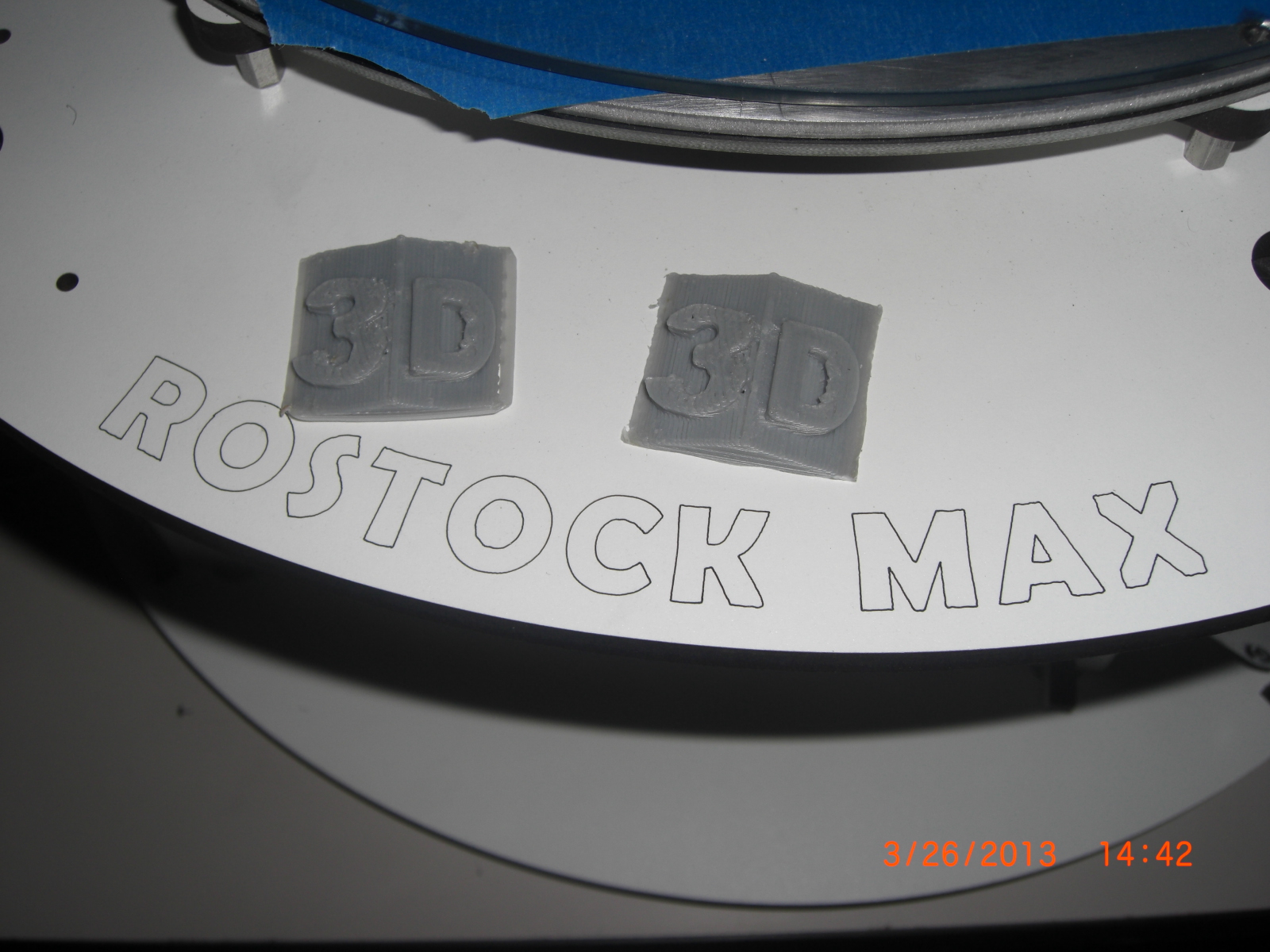

started to print another cal. cube today but it started off worse than before.
so after spending some time troubleshooting I found that the screws for the heatbed were loosening up. probably due to the heating of the bed.
darn.. now I have to recalibrate the bed height again...wtf. this time i'll throw some lock tight on it.

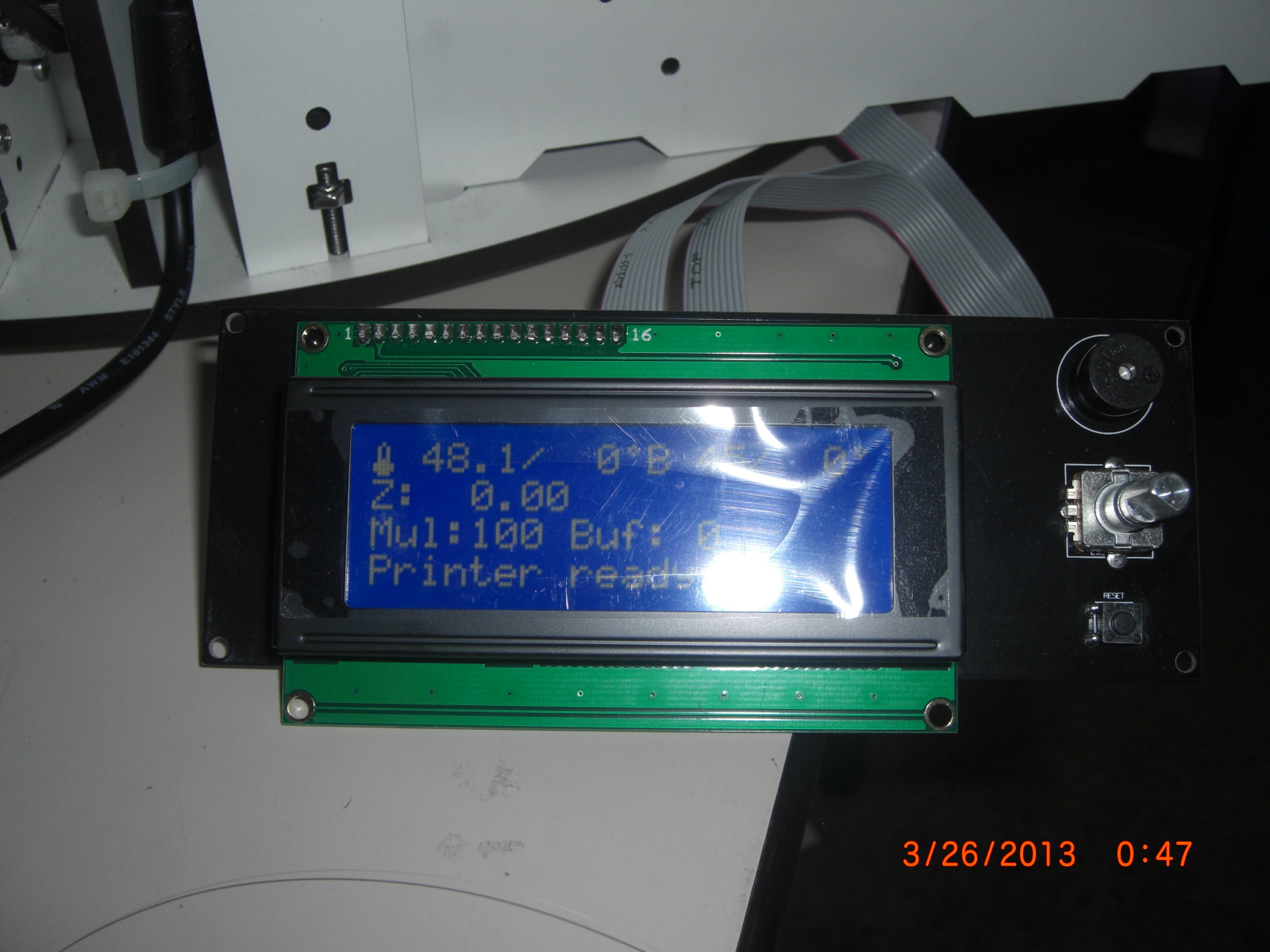

Good news though I GOT another LCD to try out, from a local 3d printer dealer here in florida, before I sent the seemecnc lcd back.
The new lcd works. SO YES I DID HAVE A BAD LCD! http://forum.seemecnc.com/viewtopic.php ... &start=130 SEEMECNC YOU HAVE A RETURN ON THE WAY.
Re: Another rostock max build
Glad you got it working! Had to be quite frustrating.
Good job!
Good job!
