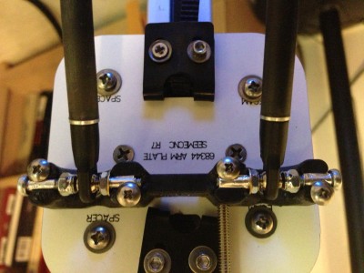

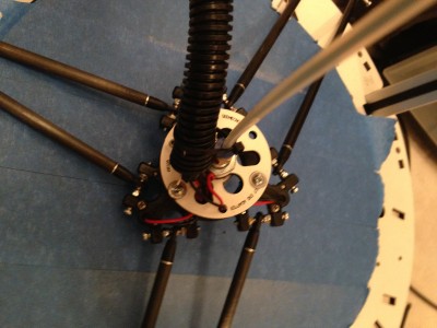

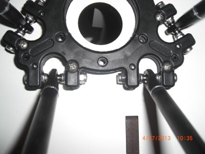

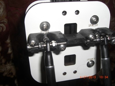

To install new arms you have to split the two platform halves. Is not too bad depending on what you have added, such as fans, LED, and wires. I was able to leave everything relatively intact.

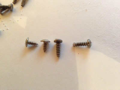

Track Laser also includes new U-joint screws. Remember the screws that sometimes prevented endstop screws from being tightened? While those have been replaced with shorter screws with a larger head.

Quick up date, The arms from Trick Laser appear to be rock solid. The end result for me was a hot end with no backlash and reduced the hysteresis I was experiencing during bed leveling. I have not had time to print a "show piece" yet because I have a lot parts that I need now/yesterday and I can actually print them! I will post some pictures soon.

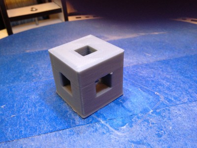

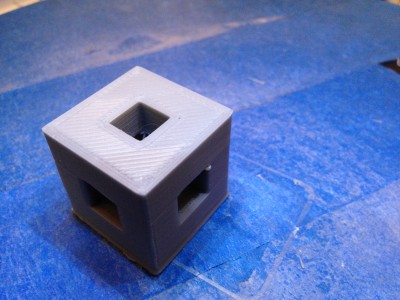

HEre is the cube moments after the print.
Best cube I have ever printed. This was printed at 0.2. I though about going for 0.1 but I have not fully calibrated at that layer height and I would like to switch out my 0.5 nozzle for that. Infills are getting much better. This was done with KISS.

Very nice looking cube, BTW.

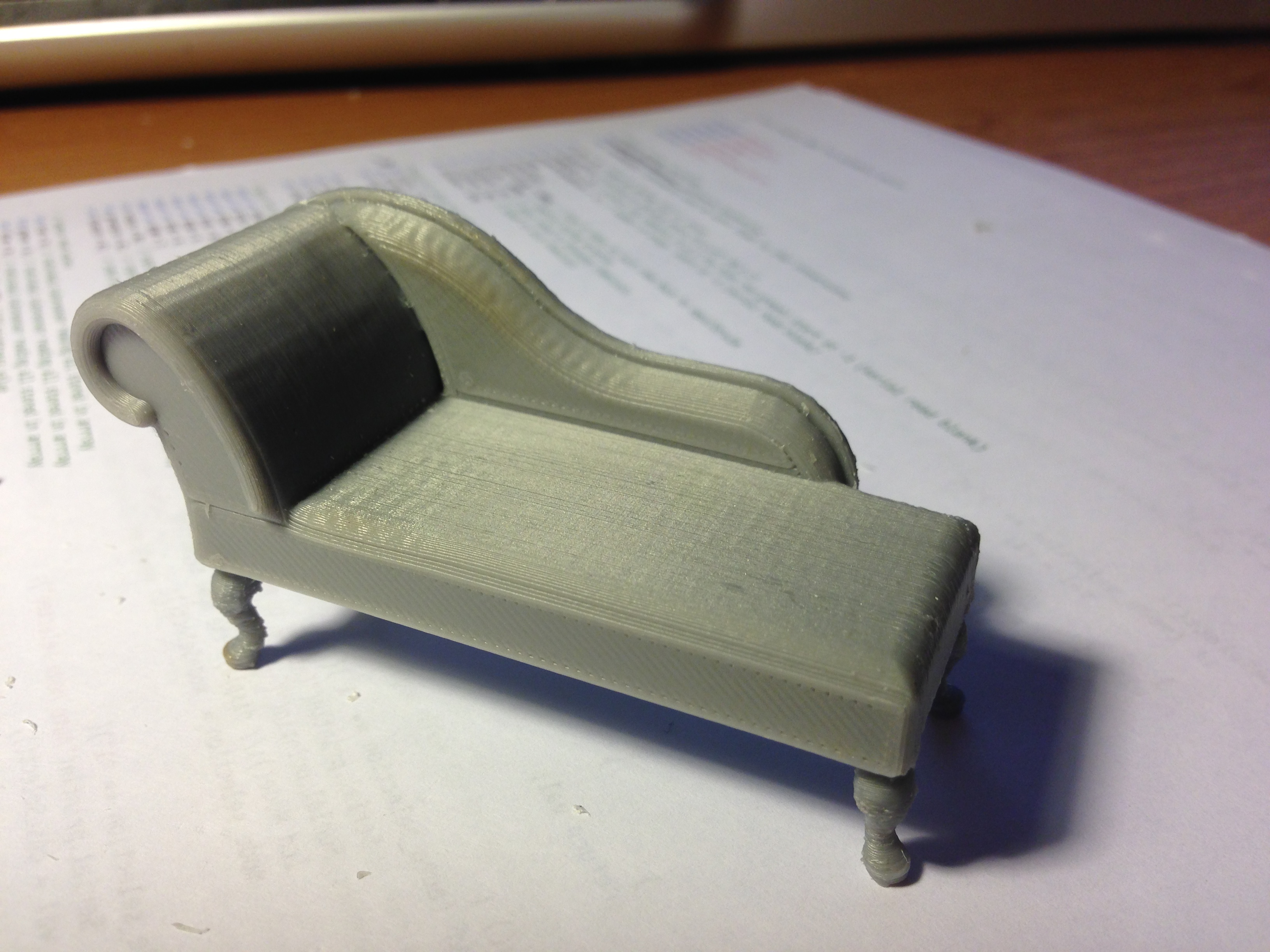

another print, getting better.
Don't ask about the brown (burn) stain... roookie mistake!!

the only thing i didn't like about the arms was the hardware they chose to use, mine actually didn't seem like they were centered when placed on there respective mounting locations. There is slight bit of play in them unlike my Chinese made counterpart but the arms seem to be a great upgrade replacement, they are super light weight. I have this going into my second rostock build.
pictures shown with replaced mounting hardware.

Yeah, the hardware is different. MY screws appear to be rapped in some type of foil or something. I noticed it during installation so I just tried to be careful with it. That is strange that yours have some play, most of mine were solid.

either way, I have notice an improvement in my prints. Part of the benefit of these arms is that I stopped questioning the condition of the joints. This allowed me to start dailing in other aspects of the printer and slicer software.

they designed it so it would be snug fit when you tighten down the rostock platform screws, similiar to the original seemecnc design. that's why they have that foil wrap around it.
I wasn't diggin it though, so I replaced it with what I have pictured above.

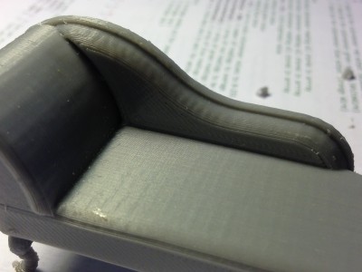

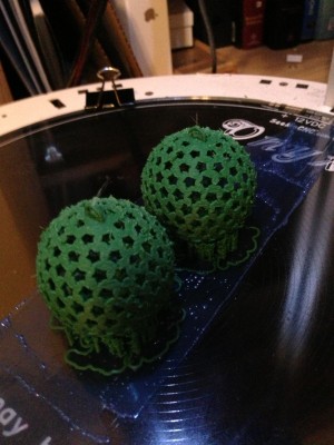

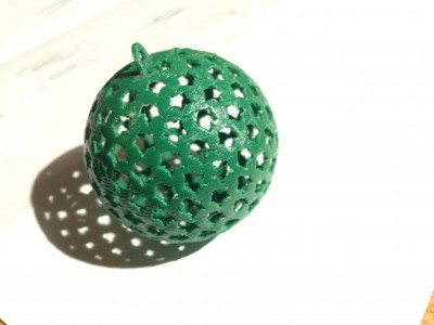

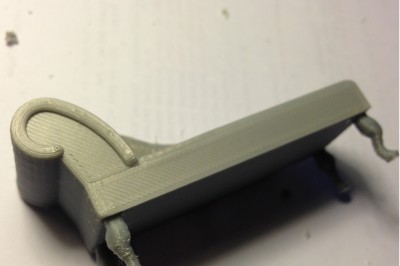

So I finially ordered and installed the E3D hotend. I am very impressed I with. Here is a picture of the latest print. Looks like I am extruding a little to much plastic but all in all it is pretty good. This is printed at 0.15 with no fans.
