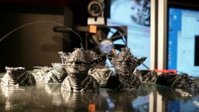

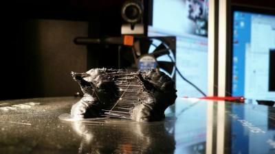

So.. Four and a half months in now and still trying to get this printer working.
Trying to stay positive :)
After much playing with temperature regulation and measurement my test prints were getting much worse, not always recognisable as a cube etc..
so my vendor very kindly offered me the new EZstruder cold end
http://shop.seemecnc.com/EZStruder-Cold ... -70780.htm
So I'm going to giver that a try, apparently this could be the problem.

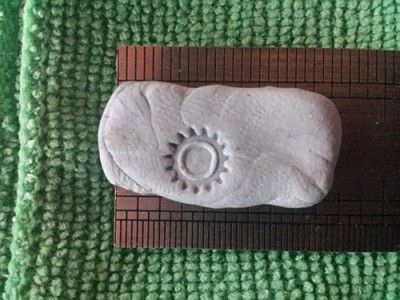

Before we go any further we need to know what is inside your printer such as the number of teeth on the pulleys that are on the motors.
If the number of teeth on the pulleys is 20 then you can proceed with the upgrade, if it is not 20 then it is a bit more difficult because there is a lot more editing that needs done.
If the number of teeth is 20 then you can go into the Repetier folder that you downloaded, find the configuration.h file and open it with notepad. Find a line that has
#define MOTHERBOARD 301 and change it to #define MOTHERBOARD 33 and save the file.
Before going any further I need to know if you know how to use a program called Arduino. If you know what it is then you use it to open the Repetier.ino file in the Repetier folder
and upload the firmware to your Ramps board. After uploading you go to section 17 of the manual, software installation, and follow the manual to the very end.
If you don't know what Arduino is then let me know and we can go into more detail. If the number of teeth on your pulleys is 15 then we need to do a lot more editing before you
can upload the new firmware.
analog_banana
Posts: 167
Joined: Mon Apr 08, 2013 7:53 am
Location: London, England
Re: Analog_Banana's Rostock Max in the UK
Post by analog_banana »
Thanks!- I certainly know how to flash an Aurduino and all the other steps you mention,
I managed it all fine when I first assembled the Max.
It's Information I'm lacking, not the skills - I've had a lot of conflicting advice,
so I'm trying to get a good basic setup guide from people who have actually got their machines working.
How to measure tooth count while the pulleys were in the machine?
I made an impression on a tablet of blu-tak attached to a thin steel rule.
15 teeth!

Sorry, I did not realize your advanced level of knowledge. But put yourself in my place, from one user to the next I don't know the knowledge level until I am told. Enough of that.
The Online config maker will work for you but you need some numbers.
For your motherboard type it is 33
For your 15 tooth gears the Steps per mm should be 105.67 for all axis.
If you are using the Steves extruder the steps per mm should be 584
If you are using the EZStruder the steps per mm should be around 92.68 (the extruder values will change when you do calibration on the extruder.
I would user thermistor type 1 for the hotend and heatbed.

Posts: 2417
Location: Redmond WA
Post by Polygonhell »
15 tooth pulley with 2mm spacing, 200 steps per rev and 8x uStepping gives
(200x8)/(15x2) steps/mm
53.333
If you have a later RAMBO that supports 16x uStepping the number is twice that or 106.666667
Thanks Polygonhell - so 106.67 it is then!
Many Thanks to Mhackney, GeneB, Craig Hardman, Jon at SeemeCnc, Charl at Creative Machines
and everyone on this forum for your help.
I am finally getting repeatable results.
Here are the main things that held me back:
If PLA is not working, try ABS.
Try adjusting you "First Layer Height" to get adhesion.
The manual says .3mm experiment lower or higher - .1mm worked for me.
That's what got me printing.
Some test yoda images are attached. Bear in mind these are 50% scaled prints so the detail is low.
After 9 months, I am now declaring this build log closed :)
