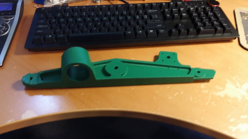

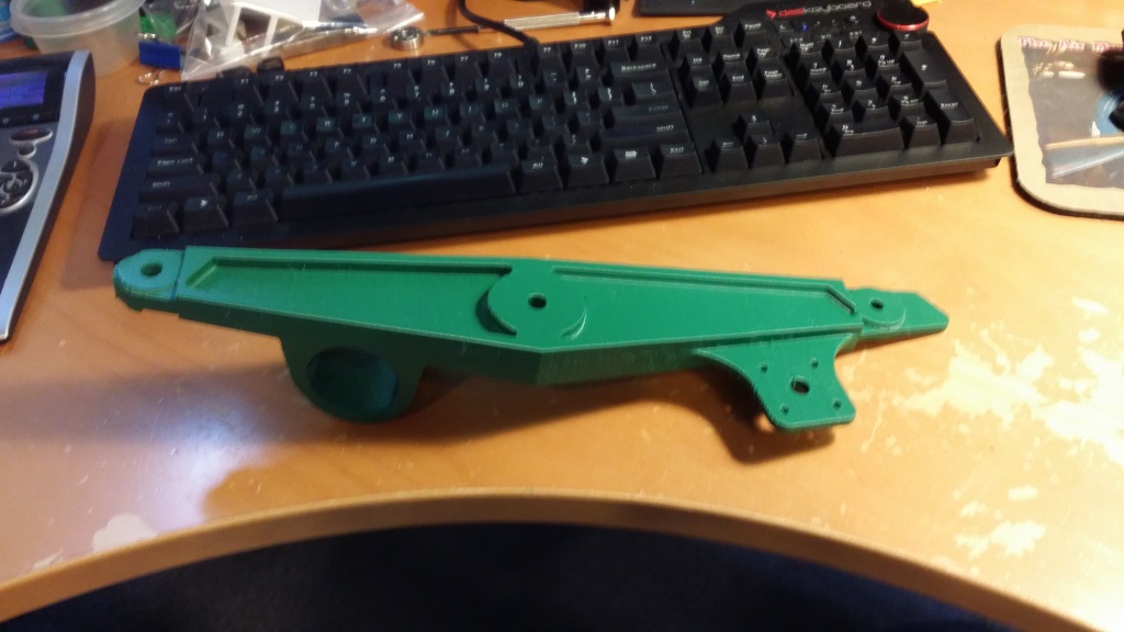

I've been working with a warbird guy in Queensland recently and last night I printed an elevator bellcrank for him. The part is 330mm long, so I had to print it on end....
Finishing up, roughly 14 hours after it started. I sliced it with Kisslicer v1.1.0.14.
Completed:
After removing the support material:
This part (or one exactly like it) will eventually make it's way to Australia where it'll be turned into a cast aluminum part and will end up on a Spitfire restoration for a museum.
Sorry for the potato quality of the pics. My DSLR is hiding in my shop at the moment. :)
Thanks for looking! :D

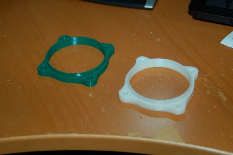

I've printed a few 66mm instrument bezels:
The green one was done on White MAX and the white one was done on the TAZ. The TAZ print is iffy because I hadn't re-done the auto-level wizard in MC after tweaking the Z axis a bit. I printed another after going through that process and it came out great. The nozzle is .35 so it takes a while. :)
