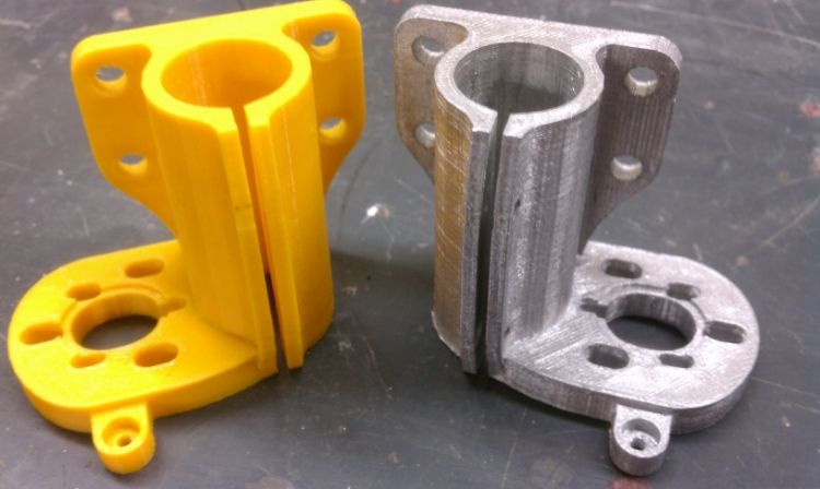

print burn cast, print burn cast, seems like all I ever do any more. But I must say I have gotten most of the bugs work out of the process now..
Printed part on left and cast on right

Very cool David! I'd say you have it down. What temps are required to burnout PLA?

mhackney wrote:Very cool David! I'd say you have it down. What temps are required to burnout PLA?
I start with the kiln pre heated to 260C and ramp up temps 200C every 2 hours until I reach 730C then I hold for 2 hours. I then back the heat down to pouring temp (usually 260C) but sometimes hotter depending on how thin the castings are. Judging by the smell I would have to say that the PLA is buring out at 500C
but the temps must be driven higher to burn out the investment. Its not the part you are really burning out, its burning out the investment.
I also use vaccum assist when I pour which does wonders for the finish. Now if I can get on the droplit beta test....well you can see me cnc where im going LOL

What do you mean by vacuum assist in this case?

Eric wrote:What do you mean by vacuum assist in this case?

Postby DavidF » Thu Jul 31, 2014 5:18 pm
Once the investment is burned out it becomes porous enough to allow air to pass thru it.
Vaccum is drawn around the outside of a perforated flask and the molten metal is basically sucked into the mold.

teoman wrote:Out of curiosity. What is the cost of such a diy setup?
Difficult question to answer. I have been into metal casting for 7 years or more and have been building and upgrading for that length of time as well.
to thow a dollar figure out i would say i have between 2-3K invested in it so far.

If you're just doing metal, it's not too difficult if you're willing to go with the bare minimum. I built a small furnace on the back porch of my high school art studio, which consisted of an igloo of firebricks, a blower, and a propane burner. We melted aluminum in a large soup can and the plaster molds were kept at the entrance of the furnace to keep them warm before pouring. You're not gonna get castings of the same high quality without the vacuum flask and fancier equipment, but it can be done on the cheap with fairly good results.
