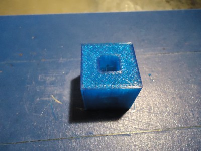

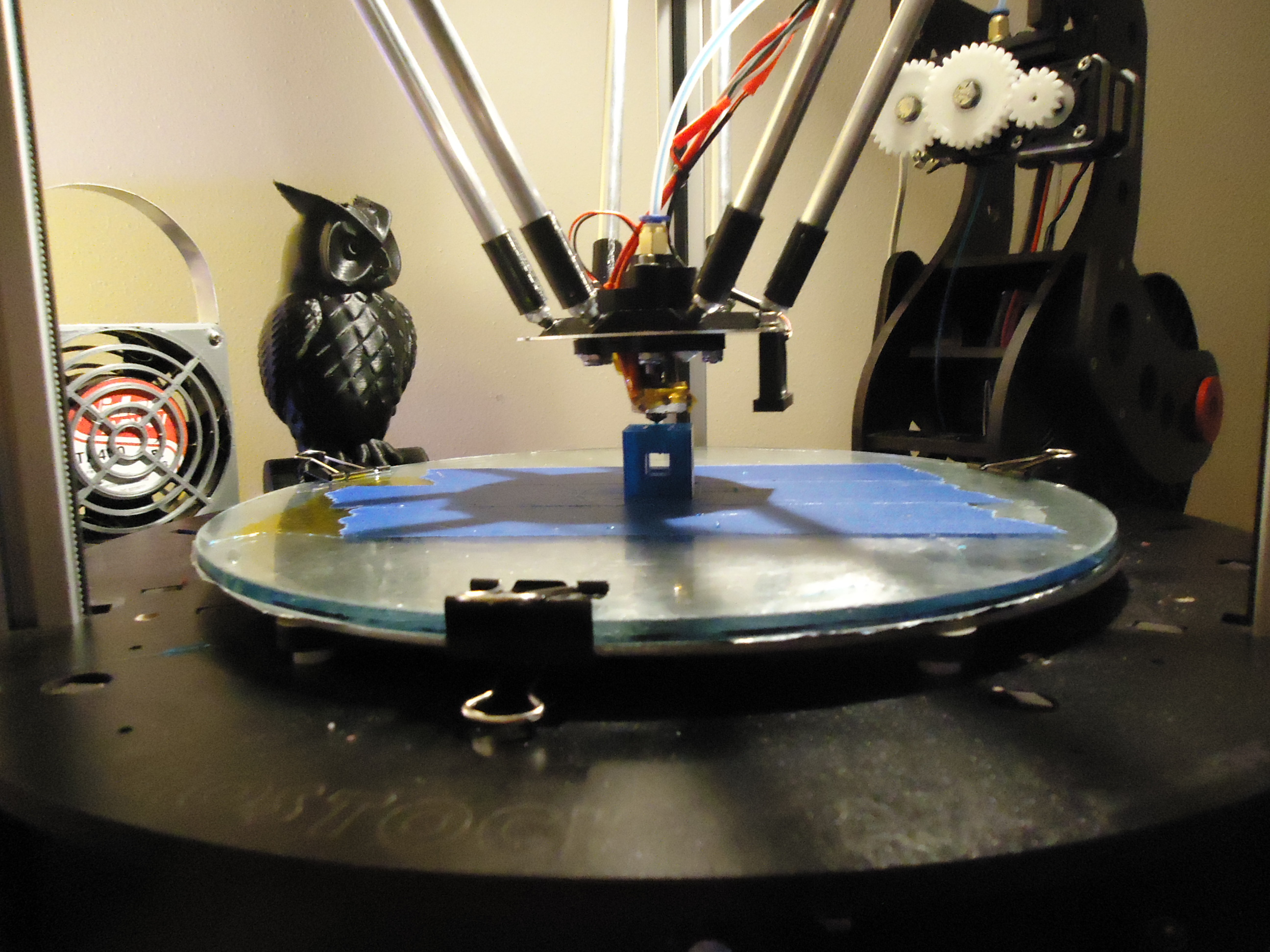

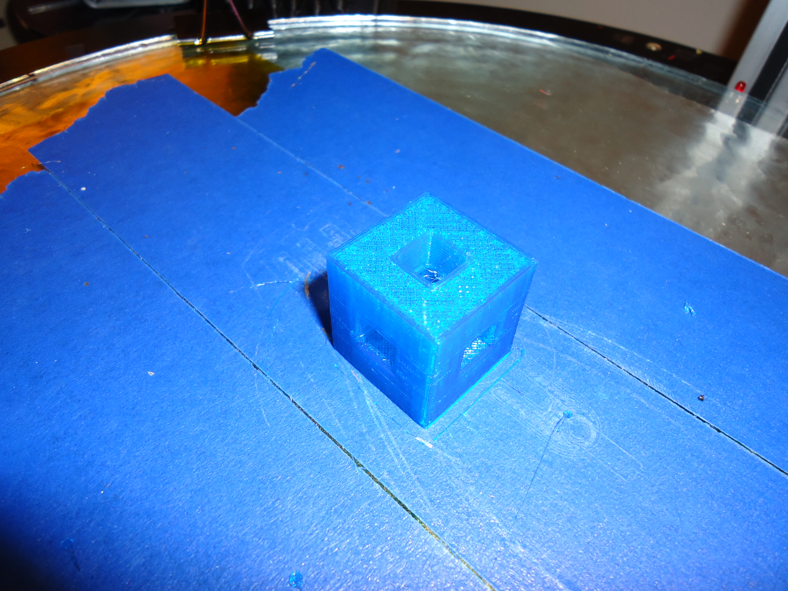

Just finished installing my mag arms and j-head. took a bit of tweaking the arms but here is some pics of one of my first prints with the new upgrades...

Re: First print with mag arms and j head..
nice looking print.
It looks like a Steves hot-end not a J-Head ?
what's your experience so far, do you like the new setup?
what did you end up using for your settings?
Using kiss 10 10 5 retraction settings and 203 temp
