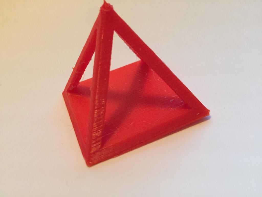

Postby dunginhawk » Thu Jan 01, 2015 5:07 pm
so here is mine... im actually really dissapointed... the close up does make it look worse, but i had a little stringing, and the blob on top...
the outside edges look REALLY good, but the inside are a little off.
wondering where to touch up... i think i need to work on the retraction piece of things.
edit : it did not peel up and deform the bottom right corner, its just sitting awkwardly on a piece of paper :)
