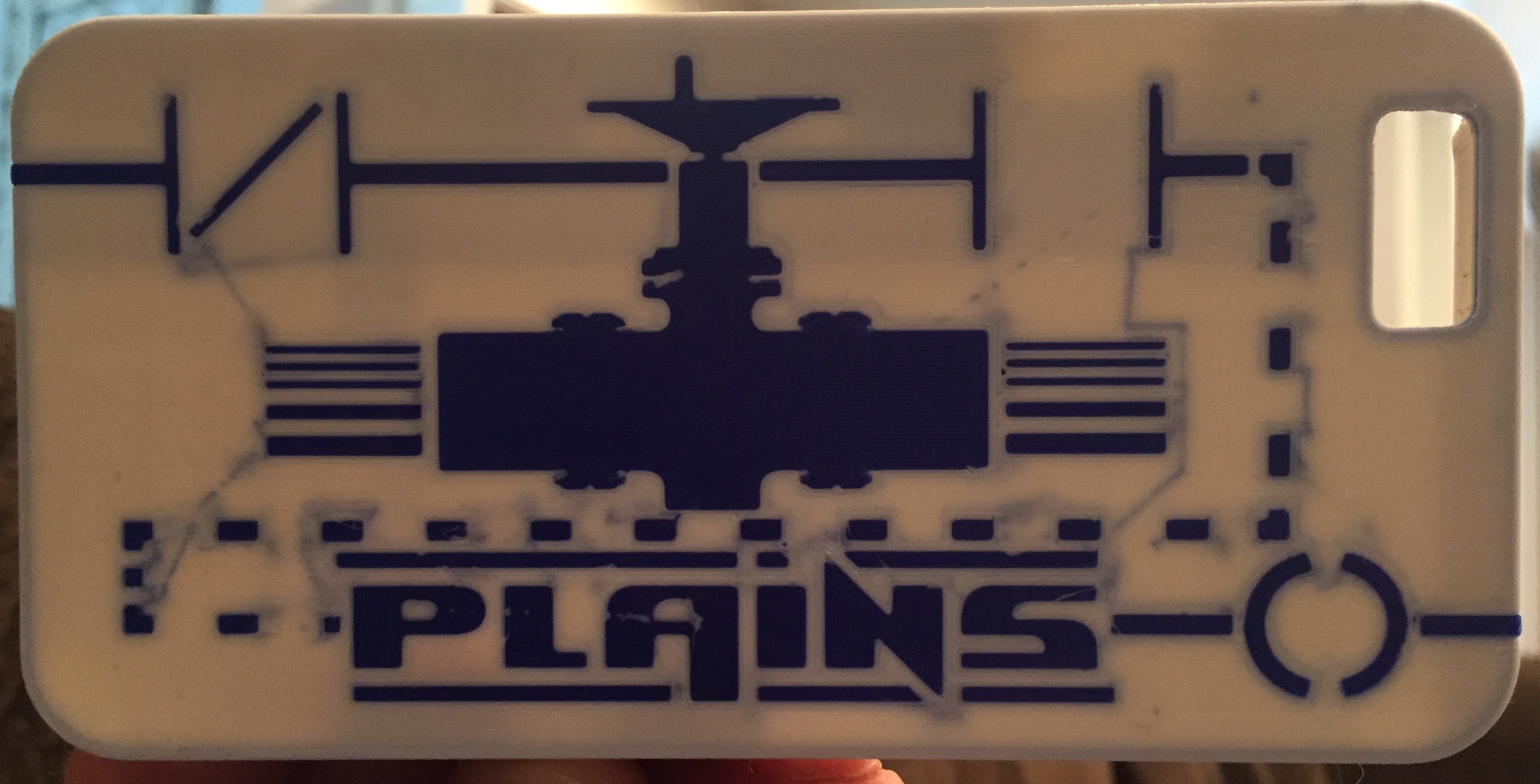

Postby Twac1 » Sun Jul 30, 2017 7:04 pm
Love the possibilities! Sure makes first layer tuning even more challenging
ULTIMATE 3D JEDDI
Posts: 2631
Re: First layer multicolor tuning
Postby Jimustanguitar » Mon Jul 31, 2017 8:14 am
Looks really good! Tell us some more about your process. Using the SeeMeCNC Y adapter, or something else? What software is making your GCode?
Twac1
Posts: 76
Joined: Sat Sep 24, 2016 8:19 pm
Location: Burlington ND
Postby Twac1 » Mon Jul 31, 2017 9:25 am
Yes the y conector. And matter control. I use a 45mm purge tower, no retraction, top speed of 35mms, first layer is set at 75% to get good detail. PLA/PHA filliment. As you can see i am still trying to adjust my retract settings, small track marks show through. but am having trouble keeping the first layer clean and crisp with any at all.
