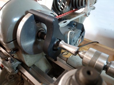

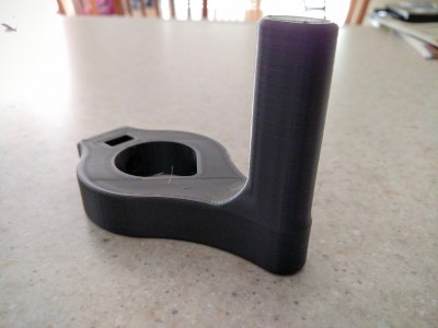

Lathe Drive Dog
Post by ccavanaugh » Sun Aug 28, 2016 2:19 pm
Couldn't find a drive dog with a long enough tang to engage the back plate. I'm only using it to polish a handle, so loads are not very large. Printed in PETG with 0.25 mm layers.

Nice looking print.... You can't print petg with the stock extruder can you?

Qdeathstar wrote:Nice looking print.... You can't print petg with the stock extruder can you?
Thanks!... Prometheus hotend on a Max Metal and BondTech extruder
