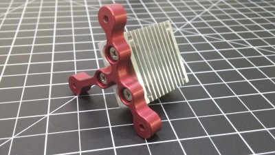

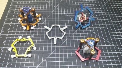

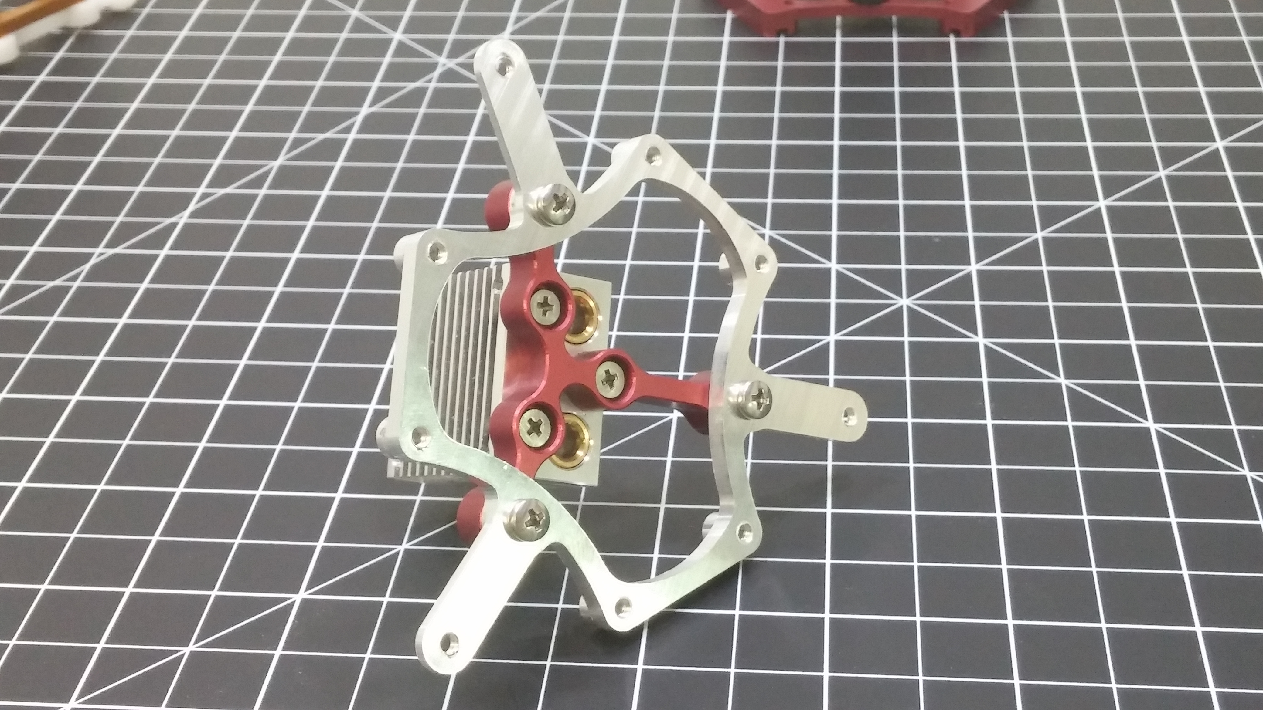

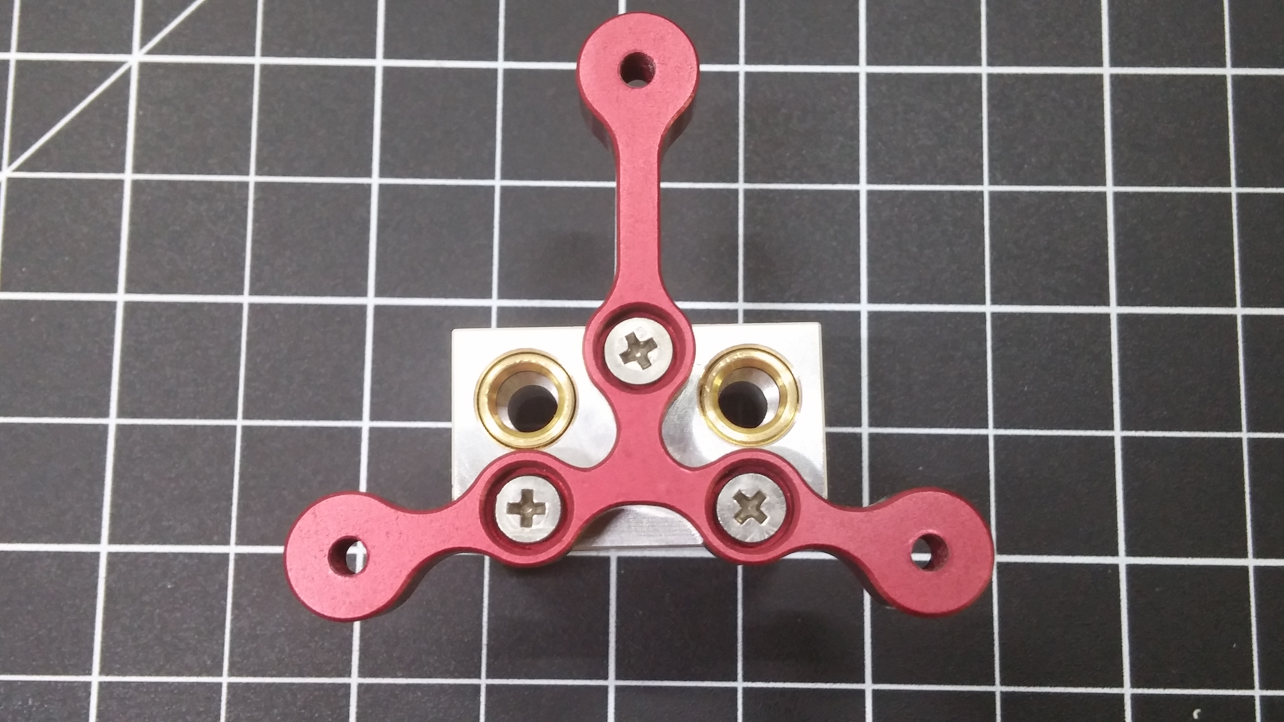

Hey Guys!
Just wanted to drop by and give a small sneak peek at the latest prototypes to come off our new mill. Soon we will be shipping out test units of our new all metal effector plates to our BETA testers for feedback. The new effector plates are offered in two styles. One of them is made to be used with the newest ball cup arms and injection molded carriages which ship on all the current Max V2 and Orion printers. The other style is a replacement for the older style arms OR for use with Trickerlaser carbon fiber arms. The second style has a very large and open center space for mounting large hot ends with ease.

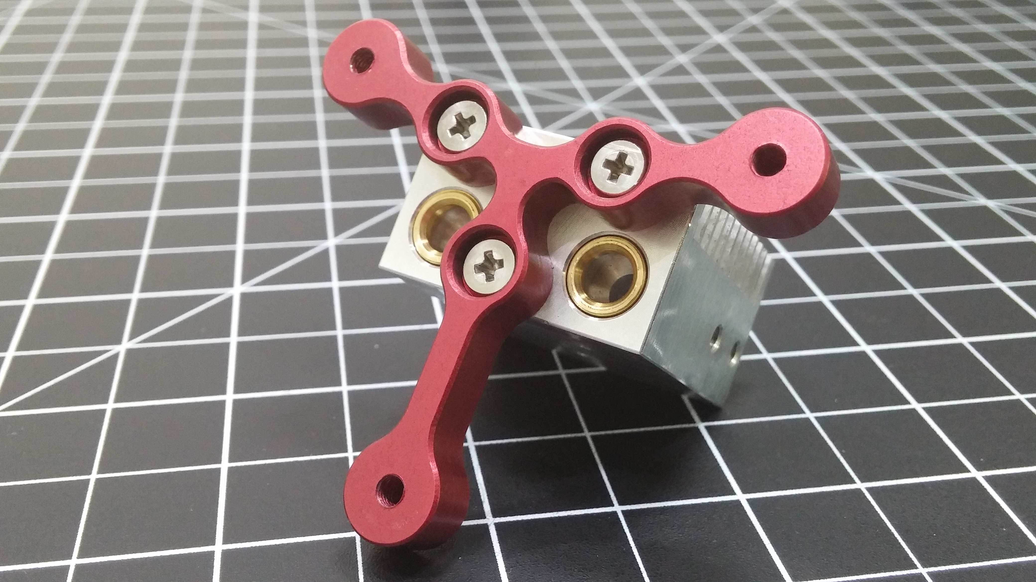

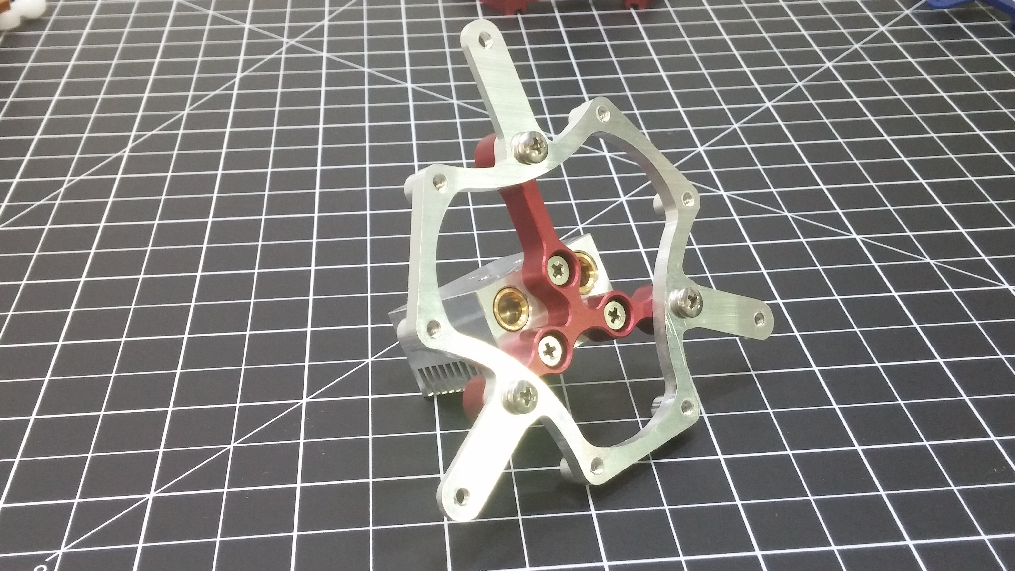

I am also finishing up work on our new all metal Chimera and Cyclops mount to add to our line up of hot end mounts.
I will post more info short on both the newest mount and the new effector plates. I am also very happy to announce that our new mill is up and running at last and very shortly we will cut our turn around time to just a few days on all orders. We are currently milling tons of stock and will officially change our stated turn around times to the new faster times shortly.

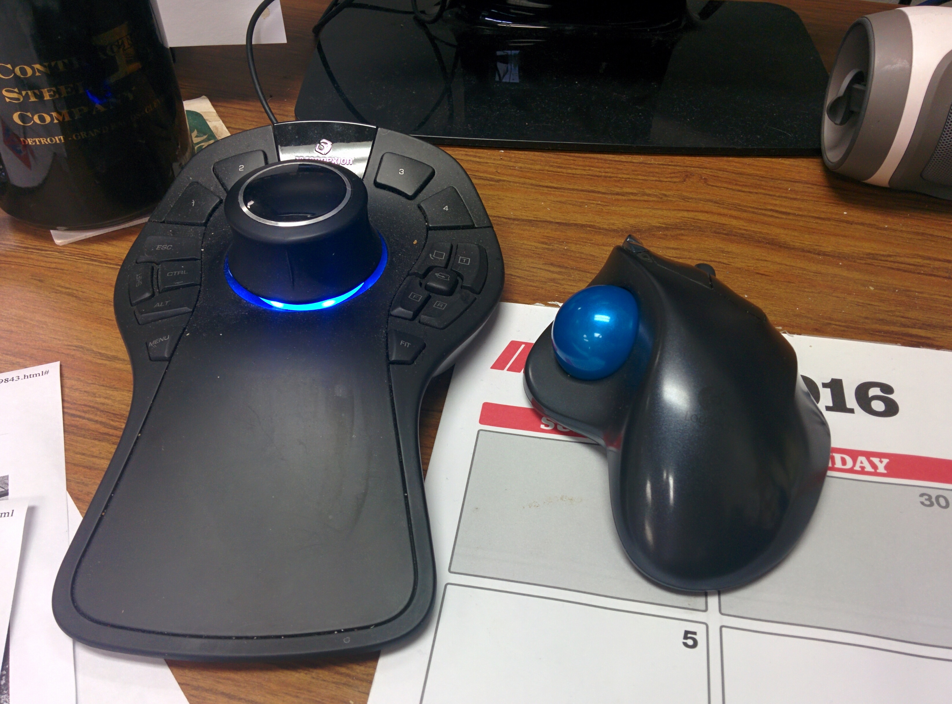

Wrong company, that's a Kensington track ballgeneb wrote:SpacePilot detected!

Well in the end you are both right Geneb and Mac The Knife. I have both items you speak of. I run a wireless Kensington Trackball Pro on the new mill ( It is a god send on the keyboard platform I use ) and I also use a SpacePilot Pro and a Kensington wired Trackball Pro on my CAD desktop. Having the Kensington trackball and the 3D Connexion SpacePilot Pro for CAD has truly changed how I design and program in CAM. I am one of the guys who finds the SpacePilot Pro to be an indispensable tool for the style of design I do. For laying out large plates in CAM for the mill and rapidly moving models around in 3D space to program CAM paths, nothing compares. I recently also switched to a Kensington Trackball pro on the mouse front for CAD and I doubt I will ever go back to a mouse on that computer. Personally for me it boils down to far less hand movement to work on the 2 wide screen setup I use on the CAD station. Just always knowing where the trackball is VS having to glance and see where the mouse ended up last time it was released. The programmable buttons on the trackball have also allowed me to pair them with buttons on the SpacePilot Pro and move even faster in CAD without needing the keyboard near as much.
- Posts: 1407
Re: New prototype metal effector plates and new Cyclops and Chimera aluminum mounts

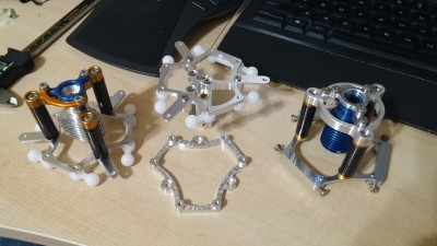

Just a lowly Space Mouse Pro, and a Logitech M570. Working off of architectural prints, a mouse would get lost in the clutter, so a trackball was the way to go. I got really comfortable with thumb operated trackball. The 3d mouse became really nice once I started doing work in Solidworks.

I'm using an older SpacePilot ($50 on eBay!) and a wireless logitech performance mx mouse.

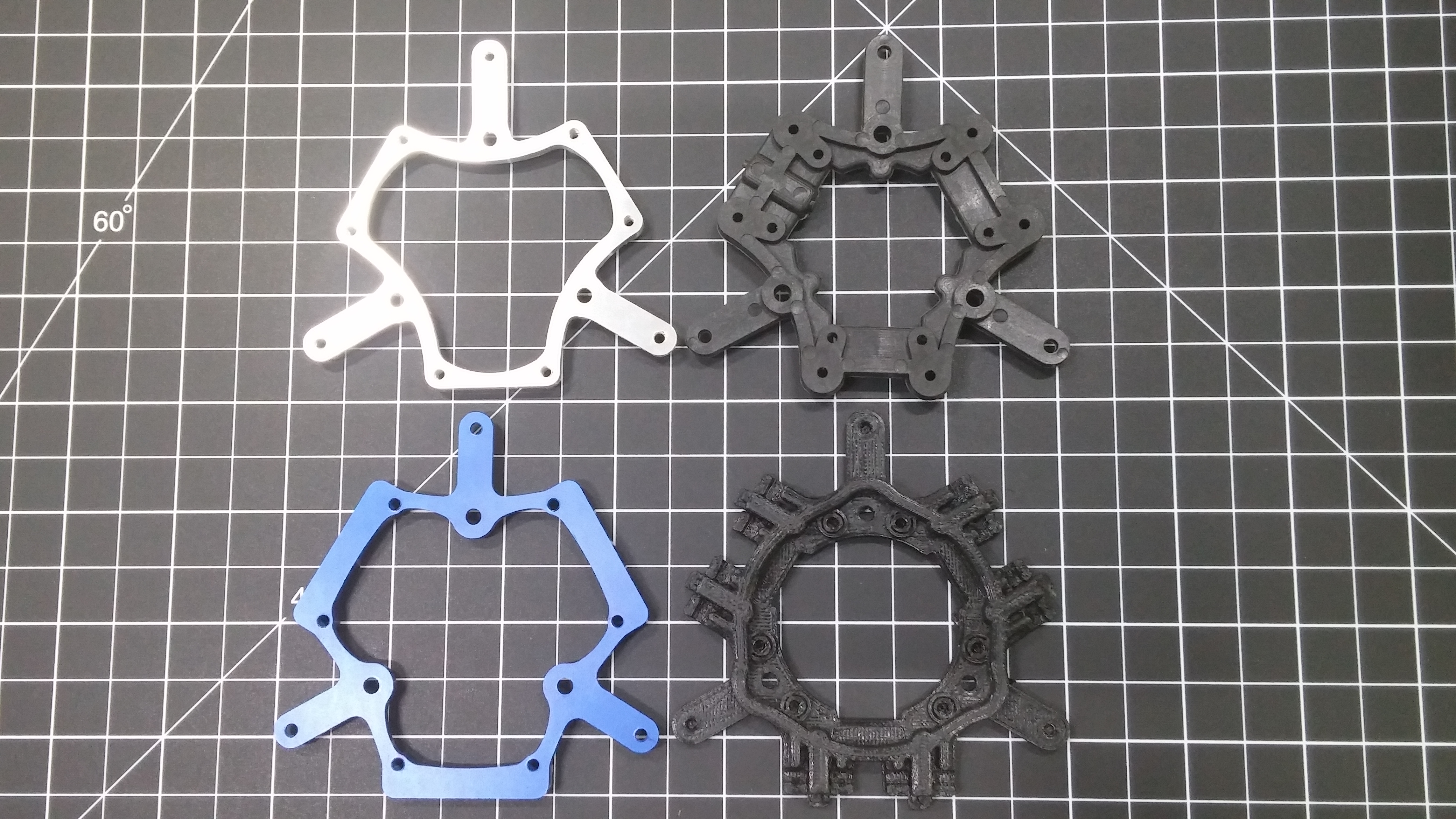

So the first run of effector plates have passed through anodize and will start print testing this weekend. Things like best spacer height and layer fan design will be looked at before the test units are sent out to field testing by our beta testers. The first Chimera / Cyclops mount is also ready to first printer tests and I will be seeking Chimera / Cyclops owners interested in beta testing the mount shortly. We will ask that you already be a Chimera or Cyclops owner to test the mount. If you own one or both of those hot end and would like to be a tester for the mount ( you will be sent a free mount in your choice of colors for testing which you keep as a thank you for helping us test a new product) Please message me at [email protected].
More updates soon and feedback is always welcome.

Did the first test print with one of the new metal effector plates in the old style (Tricklaser arms). The print came out perfectly with only a Z height reset when the effector was switched out, no re-calibration needed as it should be. This afternoon I will switch out the trucks for the new ball cup injection molded style and run a test on the new style effector also. But the result should be the same. Beta testers are being contacted now and test units should go out shortly. Once the green light comes back from them, we will have these on the site.
