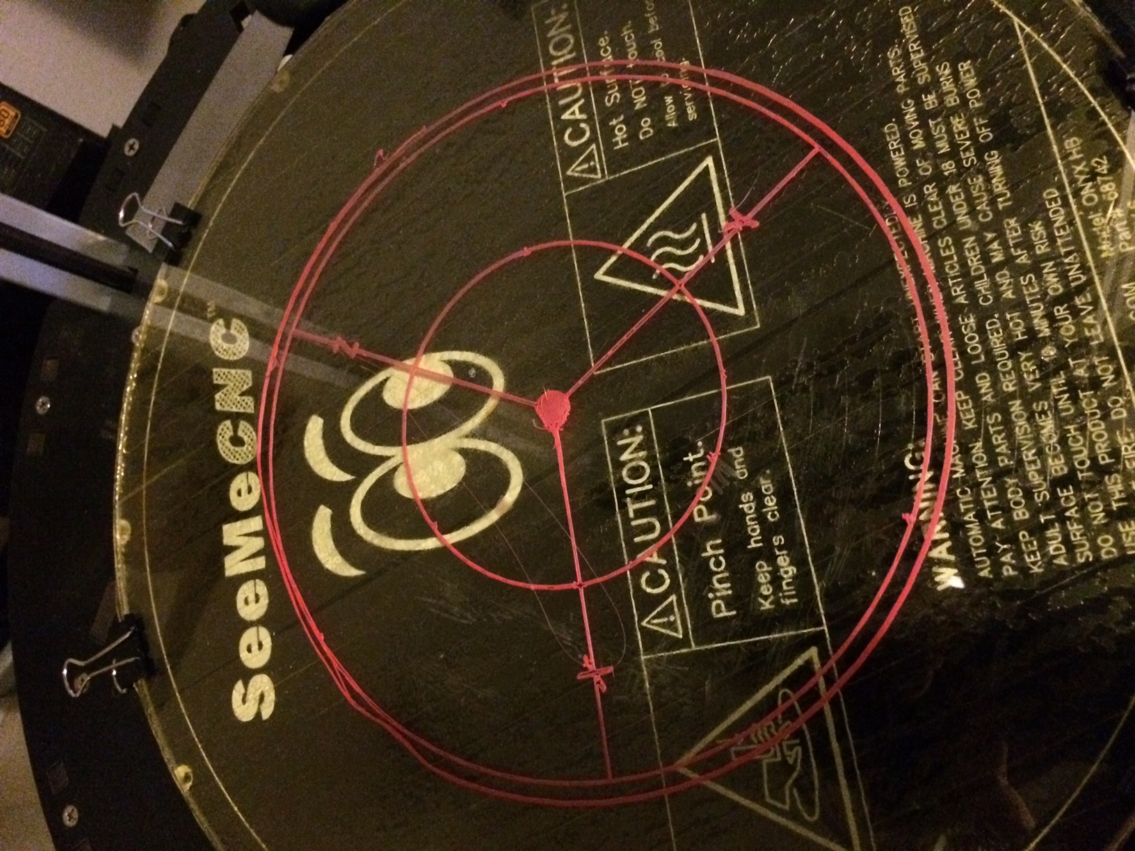

longshot
Posts: 33
Joined: Tue Apr 02, 2013 1:39 am
Re: Unsolved Mystery. Weird Z0 behavior around build perimet
Post by longshot » Sat Feb 21, 2015 1:04 am
Ok so I printed the calibration thing from thingiverse. After some adjustments to the tower angles (within 0.5 degrees), checking belts, skates, etc.
This is what I have.
The areas between Z and X is high (not much adhesion) and the area between Z and Y is Low (squished plastic) . Areas at the towers seem to be ok. Any ideas on what my next step should be?
Still stumped. . .
redoverred
Posts: 159
Joined: Tue Sep 30, 2014 2:28 pm
Post by redoverred » Sat Feb 21, 2015 5:04 am
Not having a z probe, I determined using a sheet of paper that the points directly across from the towers are significantly higher as far as the nozzle distance goes, i.e.: the nozzle doesn't touch a sheet of paper at these points. Using the z height menu, I can see they are all over .2mm away from the bed. My z height at each tower and center are perfect. I am using points 120mm from the center for each of these points. I figure rotating tower angles is pointless with this error being on each tower-tower arc, so what the heck else can I do to fix it? I can get decent prints near to the center of the bed, but a calibration circle will not stick properly on the outer diameter (240mm diameter circle).
626Pilot
ULTIMATE 3D JEDDI
Posts: 1719
Post by 626Pilot » Sun Feb 22, 2015 4:12 pm
It's not pointless. Tower angle and radius offset can both have an impact on that. The printer thinks its towers are somewhere they aren't, and that's what causes that problem. If it only knew where they really were, it would lay down a perfect 1st layer every time.
redoverred
Posts: 159
Post by redoverred » Sun Feb 22, 2015 5:38 pm
626Pilot wrote:It's not pointless. Tower angle and radius offset can both have an impact on that. The printer thinks its towers are somewhere they aren't, and that's what causes that problem. If it only knew where they really were, it would lay down a perfect 1st layer every time.
Even if they are all high opposite the towers? I guess I'll have to fool with it a bit, but even after reading this whole thread and others it just seems like people are randomly moving things around until it fits. Is there even any math involved or steps to take to fix this in some sort of logical manner? Either way I guess I'l mess with the rotations a bit.
