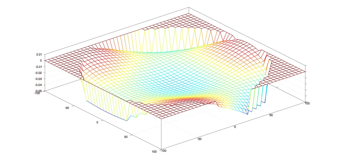

Post by Polygonhell » Fri Jul 18, 2014 7:01 pm
I assume what you are seeing is basically this
I took the matlab model from here http://wp.boim.com/?p=67 and tried to reproduce the error you were seeing.
It's a combination of RodLength set incorrectly, then compensating for the error with DeltaRadius. In the image above I introduced a 1mm error in the RodLength, then tweaked DeltaRadius by 0.3mm to more or less compensate.
The issue is that both introduce doming errors, but because the errors aren't the same degree of function, if you compensate for one with the other you get the high order harmonics you can see in the graph above.
As to fixng it, I would start by trying to get an accurate measurement of the RodLength

Polygonhell wrote:I assume what you are seeing is basically this
Pretty much, yep. For some reason, the proposed firmware fix didn't have an effect on my machine. Still waiting to hear from others.

Post by Polygonhell » Mon Jul 21, 2014 10:54 pm
The firmware fix, would have just changed the printer radius, that may well be necessary, but the crux of the issue is it's two errors interacting. The first thing you need to do is accurately measure the the length of your arms, center of pivot to center of pivot. Once you have that accurate and in the firmware, it should just be a question of getting the delta radius correct.
Unfortunately I can't think of a good way to get both values correct iteratively.

The firmware fix didn't have an effect because the parameters in the software for your machine don't match the actual measurements of the machine. Polygonhell showed something I mentioned previously.
On the same note, improper tower rotation will cause the low points between towers to be higher or lower than each other.
Tweaking rod length and radius should allow one to get to the point where the area between towers averages zero, from there tower radius could be tweaked to get close to a true zero.
Calibration using a large radius and small radius 6 point star, plus center, should give and indication of which direction to make changes (longer or shorter rod length).

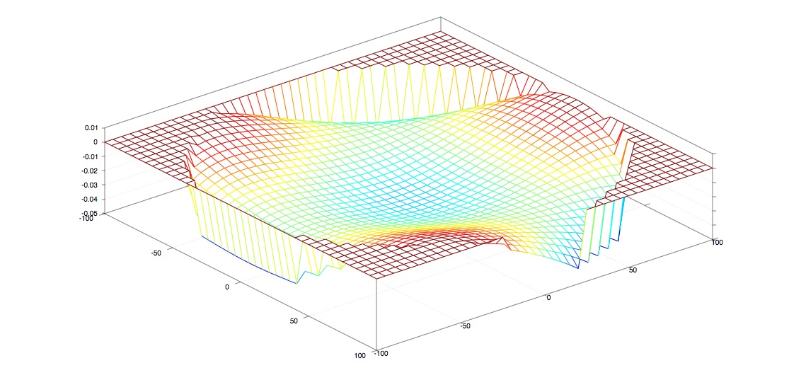

How "accurate" would that need to be ?
I am thinking;
Take the rods off, U-joints and axles too.
Assemble pairs of arms, U-joints and axles with approximate spacing.
Lay them on the bed and heat to maybe 32C (measure above a running bed to know EXACTLY what temp).
Measure outside of axle to outside of axle, subtract axle diameter.
Maybe average it for the three pairs ?, maybe that would be UBER fussy ? (-:
It needs to be accurate to 1/10th's of a mm
The easiest way would be to put pins through the arm ends, use a caliper to measure the distance and subtract off the diameter of one pin.
I'd do it, but I don't have a caliper big enough.
