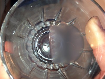

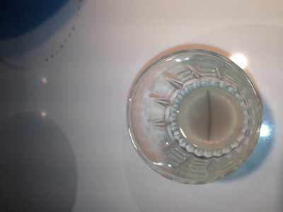

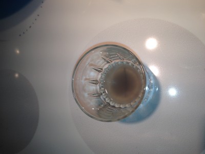

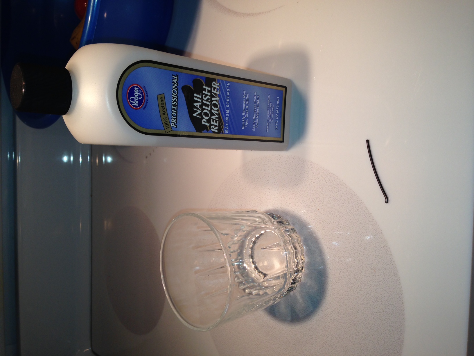

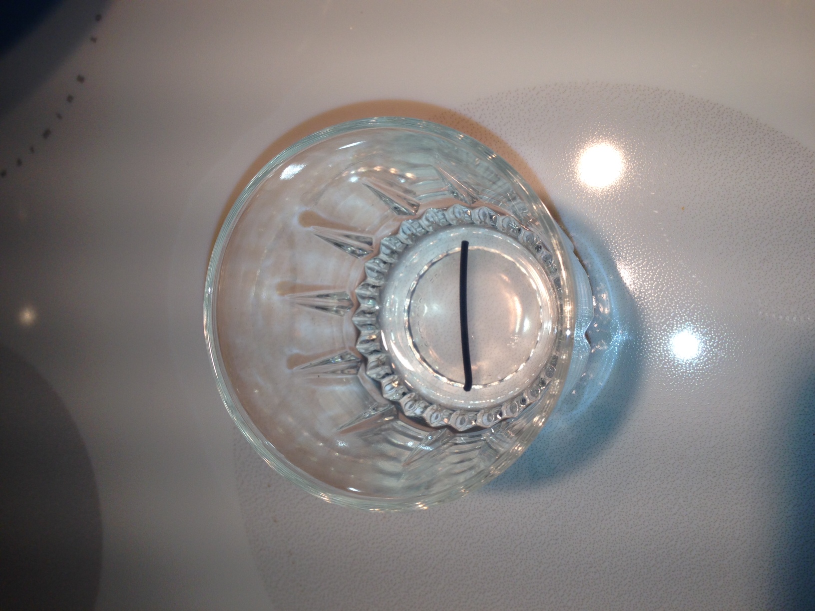

Here are the results of the filament I use. Mine is Black 1.75mm from Botfeeder.ca
45mm of filament and standard nail polish remover (Note: I did agitate the solution during the test)
After 2 Minutes
After 4 Minutes
After 6 Minutes
After 8 Minutes
After 2 Minutes
After 4 Minutes
After 6 Minutes
After 8 Minutes
