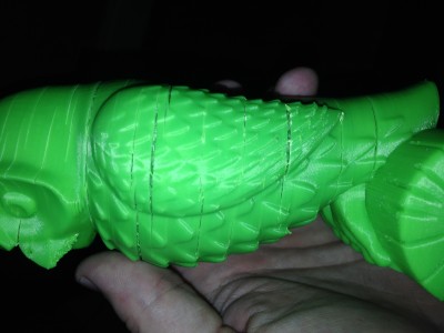

Hey Guys,
So I still have my other issue going on but I can still print. I am noticing all of my prints there is some separation of the layers (see pic). Can you tell me how to fix this?

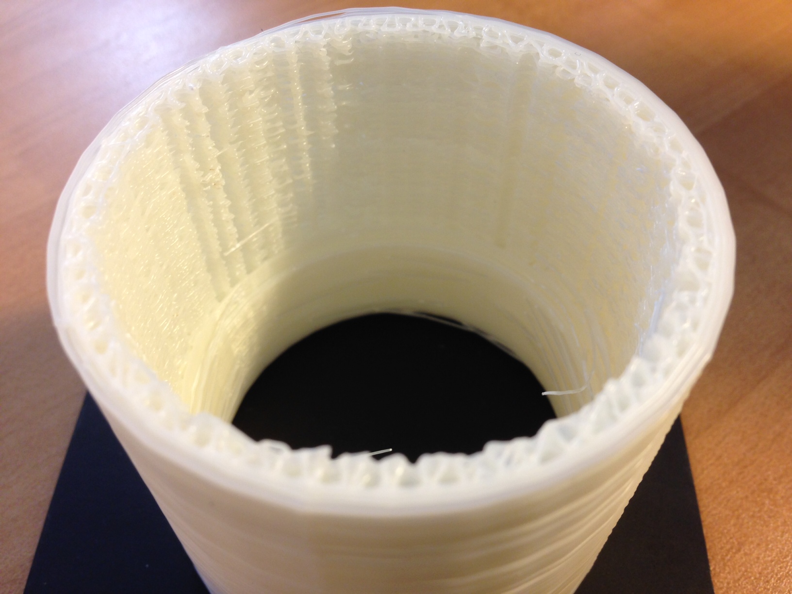

Dear All-

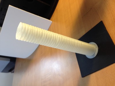

I think I may be dealing with the same thing:
Here are my specs using Toner Plastics ABS (I have the same type of issues regardless of color (black, "neutral" (in pictures), and silver):

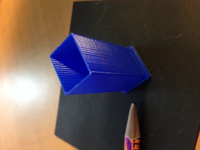

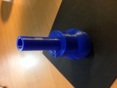

The items printed in PLA Blue convince me the machine, mechanically, is "dialed in", but when it comes to ABS, it seems it is either a temp (as in environmental because I have varied the extrusion temperature from 210 to 240 without change) or material issue.
(By the way, I use Elmers Washable School Glue Stick (disappearing purple) with consistently solid results on a tempered piece of glass over the Onyx. One application of the glue works with multiple prints and when the purple color is gone, I know it is set and ready to go. Before I apply, I do an alcohol wipe-down of the plate.)
Any thoughts?
Regards,
Scott
(not only layer separation, but axial separation of inner, fill, and outer rings as well)
(alot of separation and "crunchiness")
Re: Layers separating during print
Your temperatures seem fine, about the only thing left is the quality of the filament you are using.
I have used many different ABS filaments and I have never seen separation like you are seeing.
I have used JustABS, Jet ABS, Sainsmart ABS, and several others with good results.

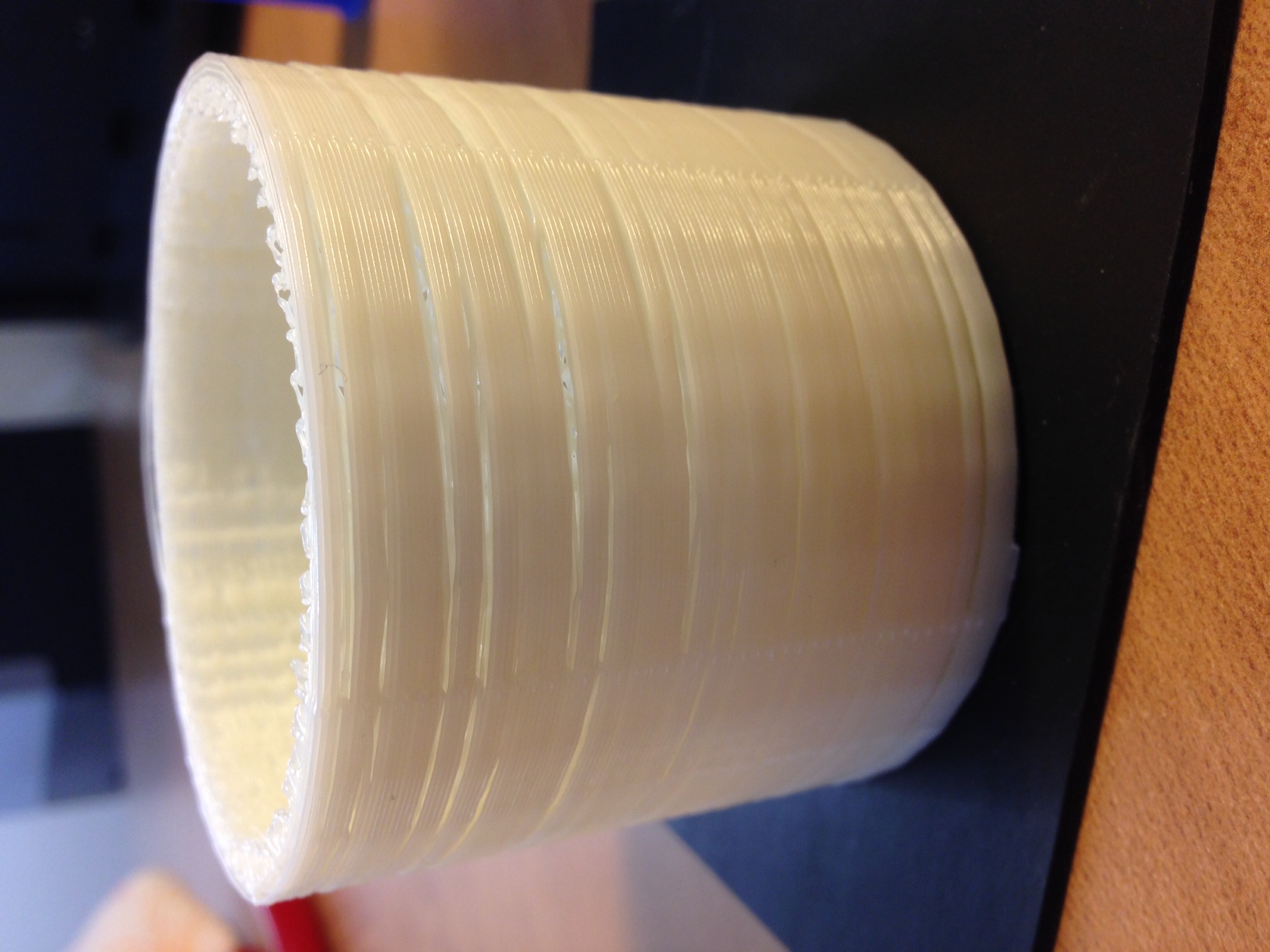

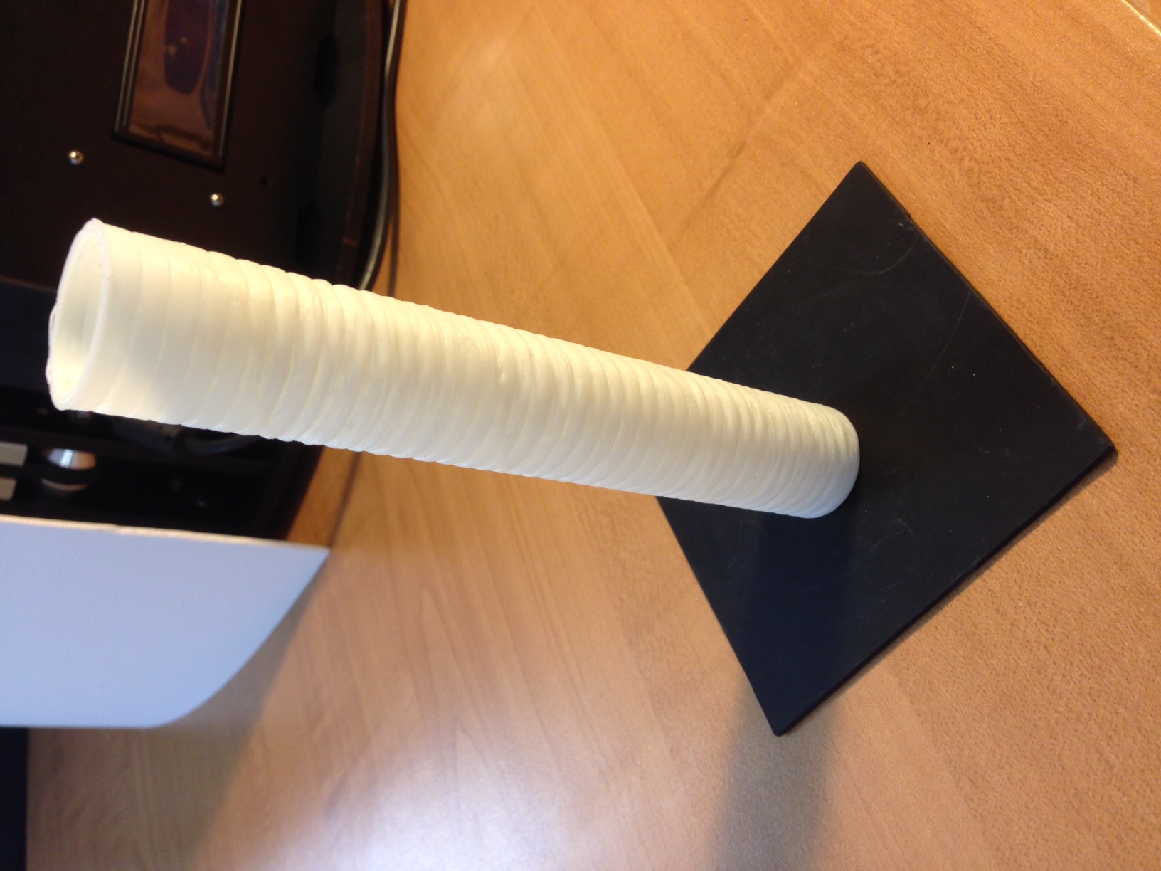

Thanks for your thoughts- I got the TonerPlastics ABS from MicroCenter here in Sharonville, OH (maybe old stock?)
I am now not so convinced I have everything dialed in, and/or I am dealing with what the OP mentioned about environment because I am trying to understand this latest test failure:
(Worsening delayering and spiderwebbing (inside) as the print gets higher out of the 6" draft shield created from the foam cards which shipped with the kit)
I had 1 success with the Neutral- everything worked fine, but it was using a 0.7 mm nozzle, and I was not able to repeat it.
My thoughts at this point (could be one or a combination of):
1. Cold air (we do keep the place around 70) draft is coming over the top of the draft shield
Solution: Enclose the entire build chamber.
2. Material- all colors (neutral, silver, and black) of the same, purchased from the same source, same time exhibit the same issue
Solution: Purchase new material.
3. Settings (although I think I am close enough to get solid layer cohesion)
Solution: Go through settings again and via trial and error until satisfied- could be a long haul
4. Machine calibration
Solution: Perform a complete calibration cycle.
5. Extruder issues (could it be something to do with the consistency with which the filament is fed into the hot end?
Solution: Adjust extruder motor current?
If you've never seen separation like what I am encountering, I am worried indeed!

To further isolate the issue and address the environmental issue of drafts, I created a container of sorts (out of bubble wrap) around the printing area of the system:
Sealed top and bottom
And this is the result:
(oddly, worse, with even more pronounced banding of separation)
So that eliminates draft or changing temperatures as a factor- so #1 is done.

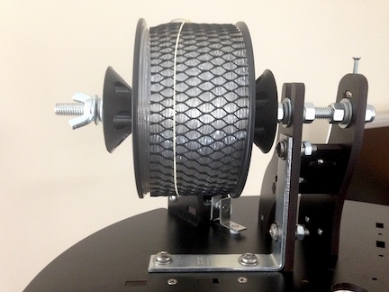

Problem solved with a couple changes:
1. (90% solution)- BAD MATERIAL!! I got a bad batch (3 reels) of TonerPlastics ABS from Microcenter.
2. (10% solution)- The stock reel support arm (with its square edges) assumes the inside ID of filament reels are smooth and concentric in order to payout filament smoothly and consistently. This is not the case. The new filament (which works beautifully by the way, is SainSmart) had a "burr" on the inside of the reel which made me think about the issue more closely. My solution was to modify the current reel holder support as shown below.
Printed "cones" out of ABS; got the rest of the hardware at a local Ace Hardware store for less than $10. I will upload the mod to Thingiverse and others.
Using brass bushings (instead of bearings- unless you are printing reaaaalllyy fast) pushed into a pair of cones, located around a bolt and some washers and nuts, the modification self-centers all types of reels from Taulman T-Glase (small) to SainSmart and others (larger). Using a wingnut makes the changeover fast and easy. When you need to start the thread of a new filament into the extruder, you can tighten (a bit) down on the wingnut to prevent un-winding. Loosen the wingnut when the system is ready to print.
Everything is nice and dialed-in except for my poor construction skills affecting performance and creating a bit of the Delta Arm Blues.
I am hoping that the order I just placed to replace the v1 with v2 arms helps.
