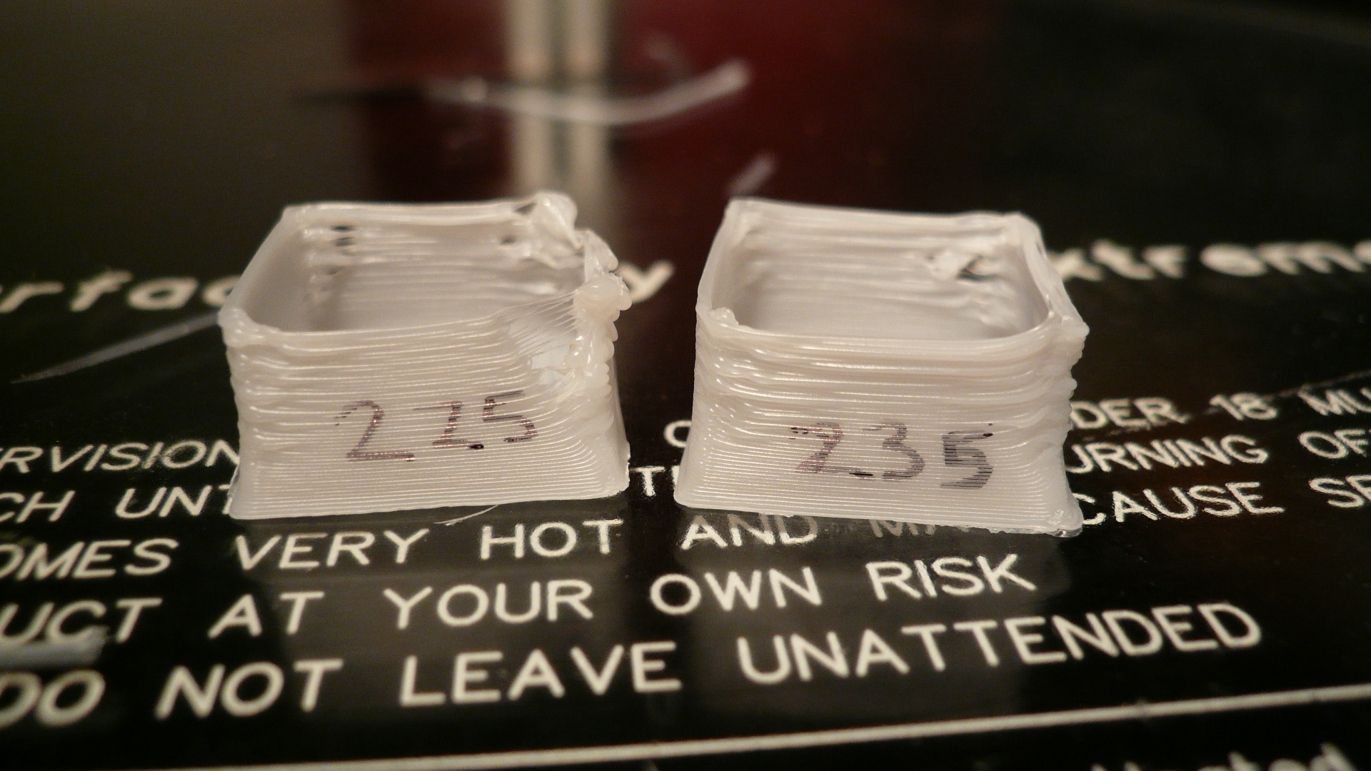

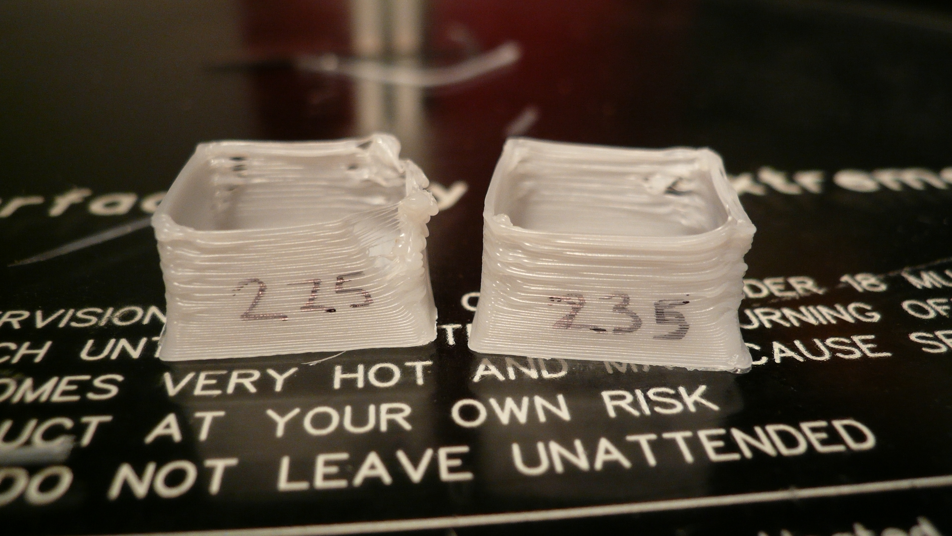

Mhackney Calibration box tests: - after partial rebuild / full recalibration
I think I'm using the correct calibration box now..
Here's the kind of mhackney hollow box tests I'm getting: (temps written on boxes)
It's hard to measure the walls due to the poor quality, but on the one area that was smooth I got .54mm
with my calipers. So I guess the right amount of plastic is being extruded.
The same old corner artefacts are there as ever.. Can't seem to shift them
Also sagging, shrinking inwards towards top, and all the usual problems I have been seeing.

Ho Hum...

Re: Extruding OK - I think? Now What?
Ok, I saw my name and had to reply!
It really looks like one problem is you are way too hot. I'm assuming this is ABS at those temps?
Here's what I'd like you to do...
warm up your hot end to 220°C
extrude 10mm of filament
Did it extrude nicely? If not, raise the temp 5° and try it again. Repeat until you get good extrusion. However, I'm guessing it extrudes fine at 220°, so LOWER the temp 5°. Extrude 10mm? How does it extrude? Repeat lowering until you get to a point where it just doesn't seem to extrude nicely. Once there, add 5° and report back here what that temperature was.
Also, slow WAYYYYY down when doing this test, 20mm/s is too fast. Go down to 5mm/s. It crawls but that's the point. Print after you find the best temp as above and slow down as just stated and then let us know what happened (with a photo please!).
Give it a shot. I'm also avail to chat today if that would help.

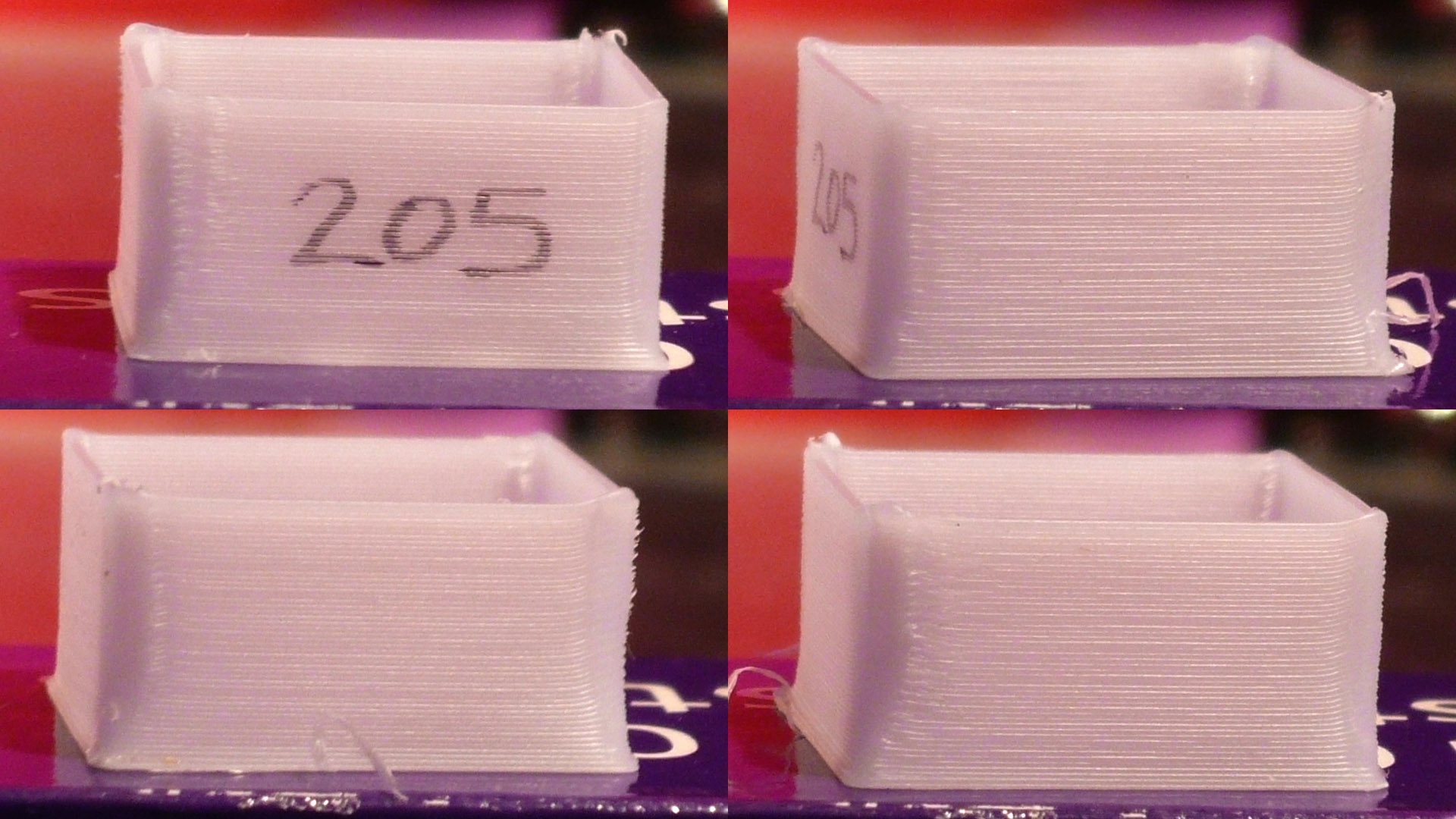

Ok, so it looks like 200-205°C should be good for slow-moderate speeds. As you speed up (later when things are sorted) you usually have to bump up the temperature a bit because the filament doesn't have a long enough residence time in the hot zone.
For now, lets use 205° 0 which is a lot lower than you used in the prints above. Slow down to 5 to 10mm/s and let's see what happens. Don't worry about the filament diameter right now, especially since you got reasonable wall thicknesses above.
This is 205@ 5mm/second speed.
It is neater with the ultra-slow speed.
As always the corners are quite bumped up, with the nozzle grazing over each previous layer,
causing the corners to deform.

BTW - wall thickness measures ok at around .55 / .57 mm
