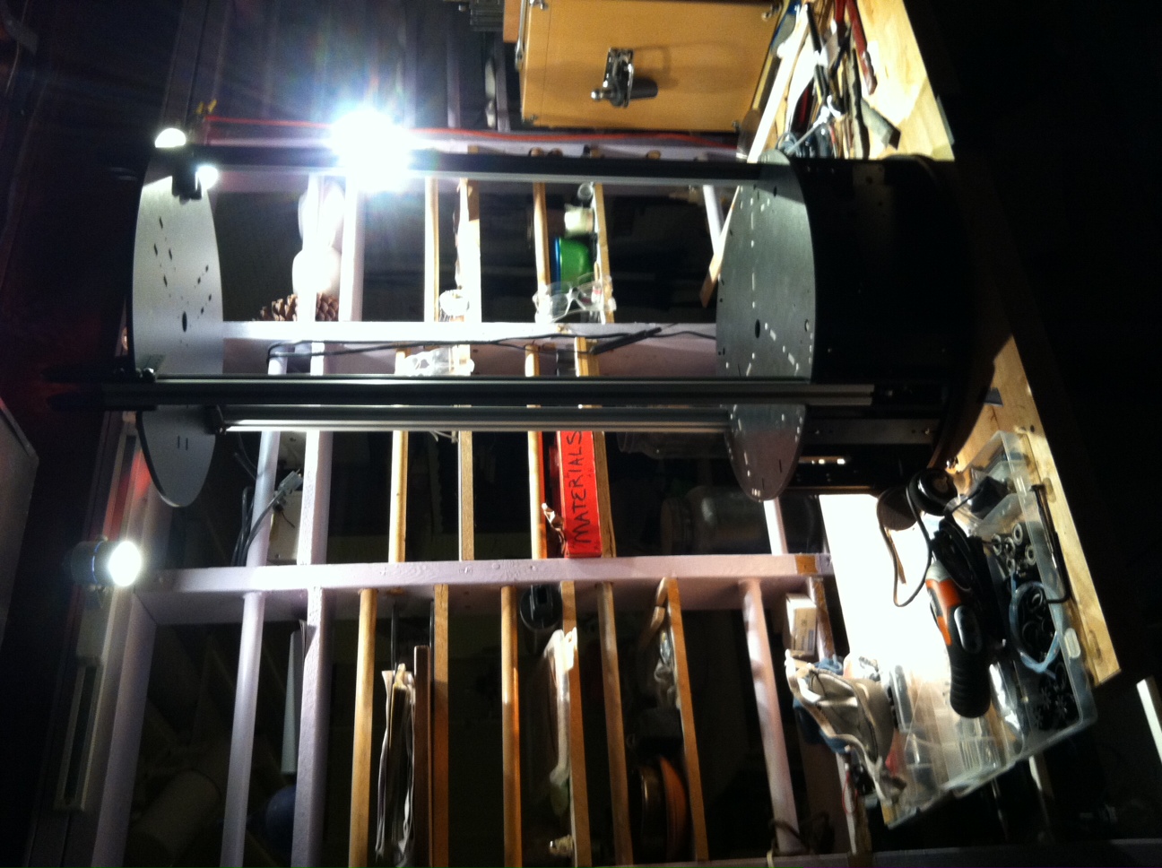

I have my towers squared to the bed, and top platform. now I notice a slight twist when comparing one tower to another.
I have attempted to adjust this by adjusting the screws slightly, Don't want to tighten or loosen anything too much though. And still it is off by about 5 mil.
The only thing I can think to do is to try to shim the towers in the tri-Supports. It really has to be the the tri-supports that are causing it, As I did notice it before getting the top on, I just thought I had it out before I squared everything up... but back it came.
If I run my square on the inside of the tower, it is square to the bed and top. if I rotate the square by 45º around the Z axis (parallel to the tower) the tower is square to the bed. But the twist is there. at 90º there isn't enough bed to really gauge it.

The only thing I can think of, is to Shim the towers in the triSupports to remove the torsion.
Any other Ideas? Hopefully better, as I don't know if shimming it would through anything else off.

maybe pull the t slot off and set them side by side on a big flat surface, verify any twisting and bending.

yup verify that those metal bars are not bent or twisted

So. I pulled the towers from the base, There is a slight deviation in two of the towers. if I take them and set both convex portions against each other, the gap is at or less than 1 mil.
This does not account for the deviation that I am seeing when assembled.
My bed does have a little warble in it. Yet again, I do not think this is the cause. here is why.
I aligned the top plate with the Bed plate, they seemed to be dead on. I even did it with the towers in place so that I could get a better registration than I did last time
Towers are installed, I push the top up and into position. Square everything to the inside face of the towers and the bed.
attempt to square the towers to the bed at 90º to the inside face. all 3 towers have at least 1/8" deviation over 24" (length of my framing square) and all of them in the same direction.
Has anybody else tried to square in that direction? I wonder if those who have had permenent caibration issues, may have the same issues. If I can't get this square, there is no way I am going to get a decent print.
Seriously need ideas on how to correct this! Or do I get a new melamine kit?

Ok,
I think I figured out what was throwing this all off.
Big Caveat here, I am not 100% on this, though I strongly suspect this to be the case.
After attempting to install and reinstall the towers/ disassemble the base and rebuild multiple times SeeMeCNC sent me a replacement Melamine kit. This not knowing where the fault lay. (I think I did more harm by trying to "adjust" the twist out by tightening and loosening screws)
Truly, these are good people and deserve my respect. I intend to honor them with the best build I can muster... then extoll, brag and push their product!
In this build, I took a small square and checked as I built
Ostensibly, the culprit: 3.5 of the Cover Brackets have a tab that is oversized. Compare the 3 following images

When installed with the etched text orientated like Gene's manual, text out and down,
[img]http://www.neurascenic.com/show/RostockMax/Docs.png[/img]
This forced a rotation in the top plate which translated into into the other components.
The image below is pre fastened, so is probably exaggerated compared to final assembly, but when multiple of them are orientated in the same direction, I think it to have an accumulated effect.
[img]http://www.neurascenic.com/show/RostockMax/Gap.JPG[/img]
Using a needle file, I took down the excess
[img]http://www.neurascenic.com/show/Rostock ... leFile.JPG[/img]
and the result
[img]http://www.neurascenic.com/show/RostockMax/NoGap.JPG[/img]

After the top is installed
[img]http://www.neurascenic.com/show/RostockMax/Square.JPG[/img]
So... net result, things feel better. But the proof in the bread pudding will come tonight when I install and square the towers.
