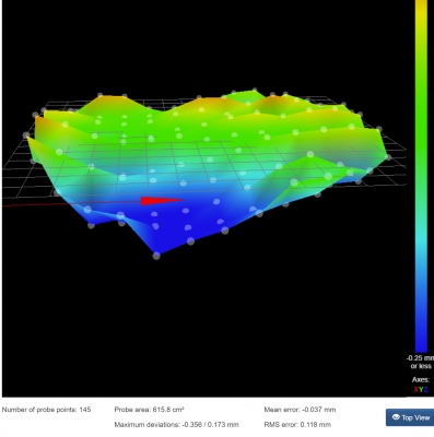

i have a modded rostock max v2 with some bed leveling issues that i was hoping for some insight on:
first, the mods:
duet wifi
tricklaser ball end arms
tricklaser aluminum effector plate
tricklaser trucks
tricklaser fsr build plate
e3d v6
bondtech extruder
johnsl + fsr x3
mahackney inspired fsr mounts
pei build surface (sanded)

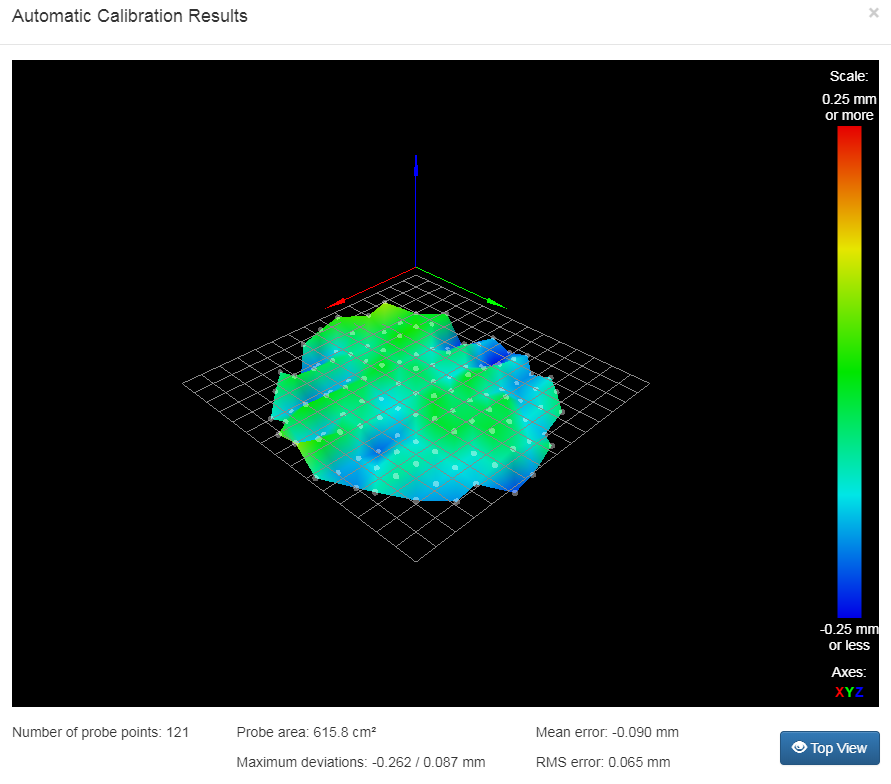

despite my auto calibration being something like 0.090 i get these terrible results on bed mesh leveling.
does anyone have any idea what might be up? i've checked for belt slippage, binding in the fsr housing, fsr sensitivity, johnsl reponse, bearings and so on, yet i always seem to get some permutation of this sinewave readout with ~1mm spread
thanks in advance for your help!

The ridges and valleys running along the X direction mean that the height of the effector depends on whether that XY point was approached from the +X or -X direction. This could be caused by loose or sticky joints.
The big drop at the right hand side is odd. It could indicate that the FSRs don't trigger as well over on that side. If you are using steel-cored belts, it could mean that the steel core of a belt has fractured (this is common if you run steel-cored belts over small pulleys).
The curve along the rest of the X direction is probably caused by auto calibration trying to reduce how bad the errors at the extreme right are.

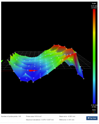

klaubauf
Noob
Posts: 3
Joined: Thu Nov 23, 2017 12:26 am
Re: mesh calibration issues
Postby klaubauf » Thu Jun 21, 2018 6:11 pm
thanks for the input dc42 and rootboy!
things are improved quite a bit after digging deeper into FSR response. the sensor at Y seemed to have a dead spot in the center for some reason while the outside was much more/equally responsive to the other sensors. i replaced it and things seem to be significantly better as shown below.
i'm not understanding that front dip, though. i've rotated the glass, observed normal tap/hop movements during probing at the coordinates, checked FSRs (more thoroughly this time). would that likely be binding that occurs at the FSR mounts of X and Y only when hitting the edge of the plate? there's a similar phenomenon at the Z tower although not as drastic.

I de-attached one of the plungers and things are looking much better...
rootboy
Posts: 213
Joined: Wed Mar 12, 2014 2:34 am
Location: Lewisburg, Tennessee
Postby rootboy » Thu Jun 21, 2018 9:19 pm
dc42 wrote:SeeMeCNC has their own version of the Smart Effector now, and that may fit your ball and socket arms better. The Duet3D one is designed to be used with magnetic joints.
Good to know, thanks!
After knocking one of the plungers loose (the Z axis), the map has improved immensely. What I am thinking about trying now is to detach all of them and use bicycle tire patches as my mounting medium to the bottom of the bed. I'll glue the patch to the top of the plunger, and then peel off the backing and stick the patch to the bottom of the bed, This should give it the tiny amount of lateral play that it needs to move freely.

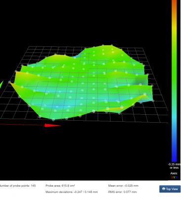

klaubauf
Noob
Posts: 3
Postby klaubauf » Fri Jun 22, 2018 4:04 pm
another previously undiscovered issue has been resolved and my mesh results are the best i have ever seen on my machine. the issue was slightly bent arm (the one the holds the eccentric nut) on the Y trick truck carriage. it seems that at certain coordinates, the carriage would lift away ever so slightly from the linear rail. i bent it back into flatness with gentle hammering and a board, then tested against a 1-2-3 block. results below:
dc42
Posts: 414
Postby dc42 » Fri Jun 22, 2018 5:24 pm
The X-direction ridges and valleys at each end suggest that you still have a small issue with backlash, probably caused by either a sticky joint or play in asjoint.
