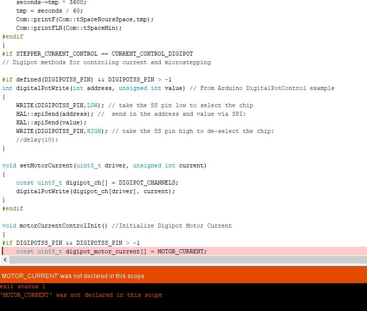

Hi All,
I have a RMv2, Ball cup arm, HE280 (w/ HE300 head and thermister) and the accelerometer board. I am updating the firmware. it is now telling me i need motor currents to proceed with the upload. what do i need?

Postby geneb » Mon Mar 26, 2018 12:12 pm
That makes no sense. :) Can you post a screen shot of the error?

Postby kineprinter » Mon Mar 26, 2018 4:22 pm
This is the error.

Postby rootboy » Mon Mar 26, 2018 10:45 pm
What it's telling you is that the variable/constant "MOTOR_CURRENT" is undefined in the scope of this routine. Where did you get your firmware files?

Postby rootboy » Tue Mar 27, 2018 7:01 am
Since you're being tight-lipped, I'm assuming version 0.92. Details Pinky, details...
You need to define "MOTOR_CURRENT" at some point
Look in either "configuration.h" for one of these lines, and uncomment one of them (remove the "#" from the front of the line):
#define MOTOR_CURRENT {140,140,140,130,0}
Did you run the configurator first?

Postby geneb » Tue Mar 27, 2018 9:03 am
MOTOR_CURRENT is already correctly defined. I suspect he's not set the configuration options for the printer and hot end type properly. (it's at the very top of Configuration.h)
ALL the firmware that the Rostock MAX v2 or 3 uses is 0.92. It's the revision date that's meaningful. :)

Postby kineprinter » Tue Mar 27, 2018 10:00 am
You were right geneb, I had put the machine type as Eris. Fixed that. Loaded the new firmware. Now my home direction is backwards. The firmware is 92.2 20171204. This is what I get for updating after running it for over 4000 hours and only minor upgrades. The hotend was causing issues and decided to do some upgrades.
