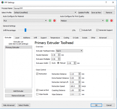

With my .4mm nozzle, I have coast set to 1mm. ( see attached pic)
Don't run with Auto extrusion width, it's garbage. Calibrate with a thin-wall hallow cube and measure the wall thickness to adjust the extrusion multiplier.
Your .05 coast on a .8mm nozzle wont do much of anything. Also, again -.02 Extra Restart Distance is nothing on that size nozzle. ( also depends on your retract distance.)
What layer height are you printing at? It almost looks to squished for a .8 nozzle.
Coast is your pressure relief in S3D. If you have any back pressure with any bit of vertical lift, you'll see those extra blobs during lift movements.
I recommend taking it to the extremes with tons of coast and large retracts to see any differences. Don't mess with the extra restart distance until you tune the others in.
Coast further, retract more, and/or retract faster. Its just finding that combo that works to your expectations
