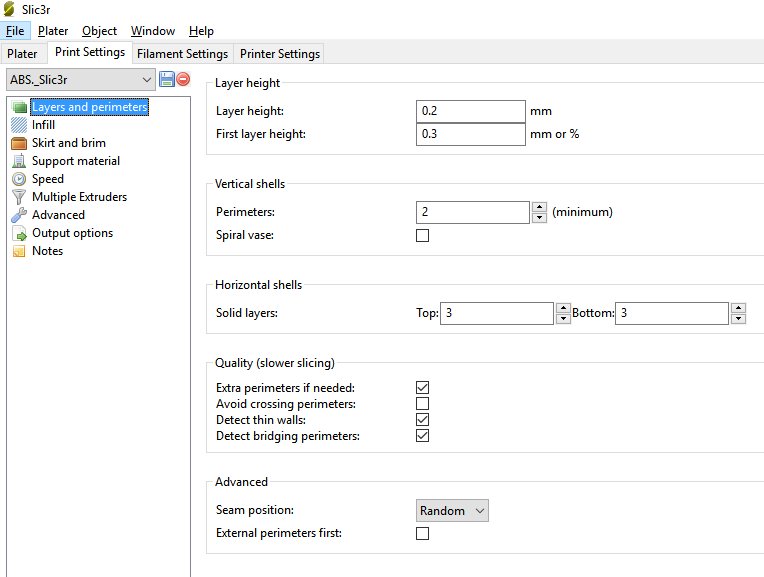

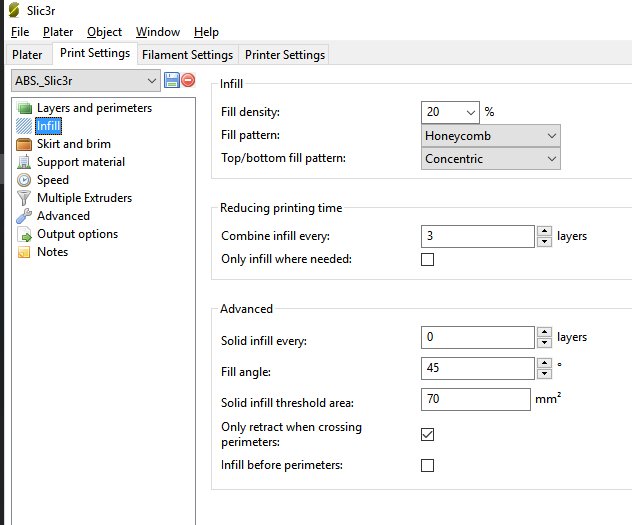

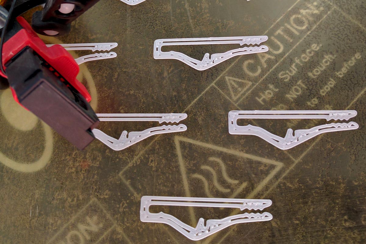

I used Slic3r for this clip. For some reason layer 1 is not filling in solid. Is this normal, or am I missing a setting?
