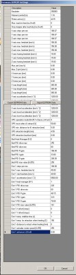

but I can't see anything like that in the eeprom settings list.
Nothing Horizontal, no radius..
See image:
See image:

Me again :-)analog_banana wrote:Yes - You would think that!
Did you wipe your EEPROM when changing from marlin to repetier?
To be sure the INIT-Run of 0.91 created all values and pointer correctly do the following.
1. Set "#define EEPROM_MODE 0"
2. compile / upload and start the controller
3. Set "#define EEPROM_MODE 2"
4. compile / upload and start the controller
What ist RepHost saying now (EEPROM Settings)?
Oh - don't forget to export your EEPROM table vie RepHost before doing that procedure.
~Jens

This is what hapenned:
Set "#define EEPROM_MODE 0" = eeprom settings are blank
Set "#define EEPROM_MODE 2" = eeprom settings are visible - settings restored to defaults.
I still can't see a Horozontal radius option...

Re: Maybe Belt/Motor Skipping?
Just based on what I see from the EEPROM screenshot, you're not using .91 - there's a TON of stuff in the .91 EEPROM table.
Instead of flipping the wires in your stepper motors, you can just reverse them in the firmware. I don't recall the exact name of the fields, but you're looking for "invert" with regard to the X, Y and Z axes. (rummages around in Red Sonja's firmware directory)

Don't worry, I am using 0.91 now, the screenshot was from one of my earlier attempts yesterday.
I have since upgraded to a functioning version of 0.91 and the only problem is temperature stuck at 205.

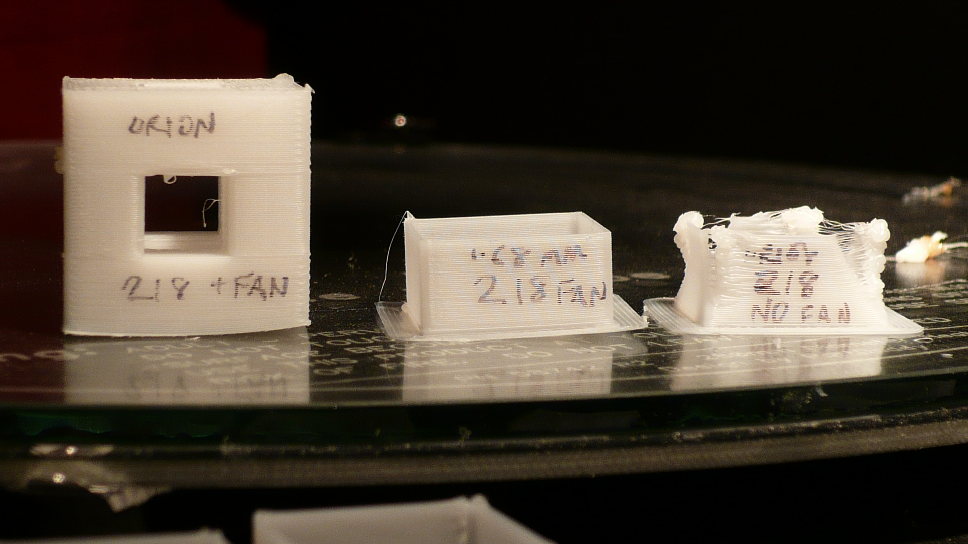

On GeneB's Advice I have done some test prints with the orion quickstart slic3r ABS settings here:
http://download.seemecnc.com/orion/quickstart/#/23
This is a vast improvement.
For a successful print I find that the print cooling fan MUST be on...
Without it I get the usual mush.
It's interesting to see that the "official" Orion ABS settings use a print cooling fan.
I have been told many times to never use a print cooling fan for ABS - but it still seems to be essential to me.
And maybe it is OK if SeemeCNC are issuing settings that use a cooling fan for ABS?
Thanks again to everyone. I'm seeing progress..
