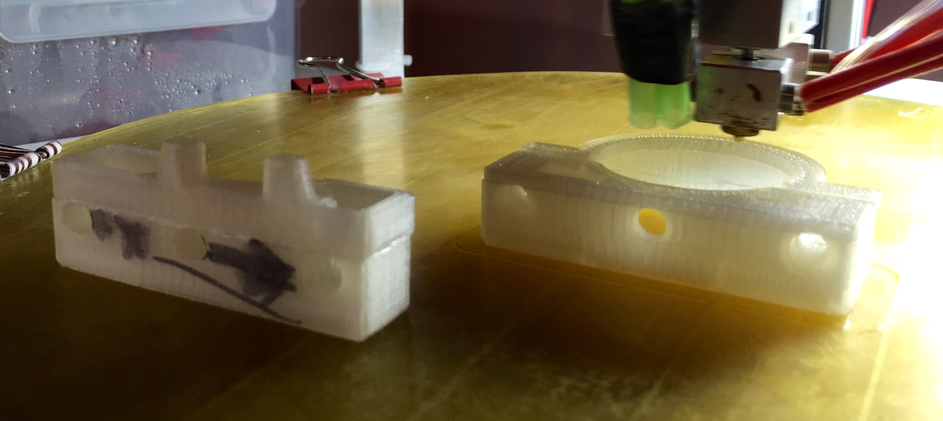

Now I have an unexplained layer shifting problem! All was well until today when I attempted to print this QR extruder mount. I let the print finish so I might learn what was going on. Checked everything and started another print. Got exactly the same shift at exactly the same layer. In my case, the shift is towards +X and -Y. Close up it looks like there are several very small translations over 6 layers - a stair step effect - rather than a single shift. Very odd.
Re: Layer Shifting
Forgot to add - when I say shift in X and Y I mean Cartesian X and Y! Not towards the X or Y towers. That's what's perplexing.
I'm doing another print at 50% speed to see if it happens again and maybe be able to observe something odd.

Well the 50% slowdown print turned out perfect. So now I'll try 75%. The original is my normal speed so there is something odd going on.

You might try changing position of parts on table and re-slice. Could be a certain move(s) causing enough jerk in direction change to lose steps?
I have had my engraving machine lose steps and shift position only on a certain custom logo. Fix was I went back and adjusted a few nodes in my digitized graphic, then problem went away. Vector path had a sharp direction change in one spot that made stepper lose steps.
