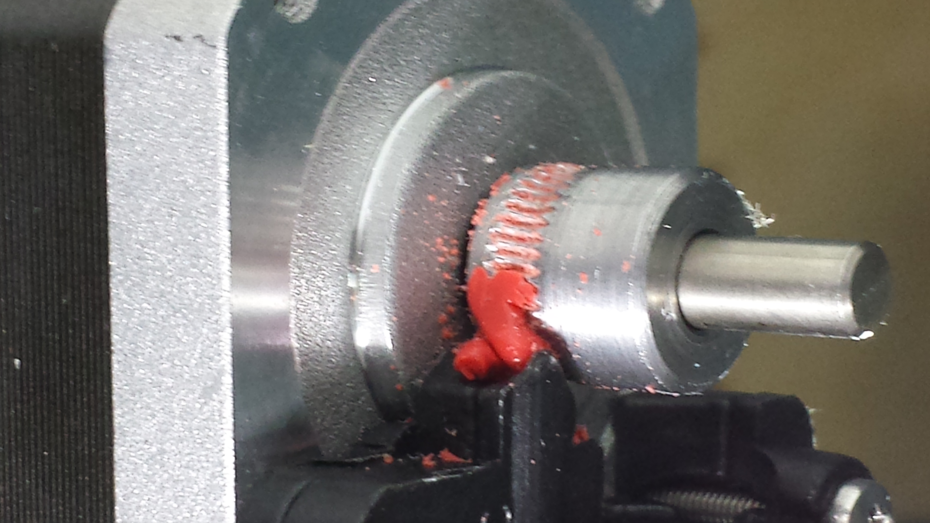

After failed print after failed print, I can only conclude that the heat from the extruder stepper is causing the filament to soften to the point that it just squishes and won't feed.
Is there a way to fix this problem?

You could point a desk fan at the motor long enough to print a fan shroud for it, then hook up a small 20mm fan or something for a more permanent installation. Wire it up to the same wires that feed the PEEK fan perhaps?

i will totally concur, not that is causes me issues, but that stepper motor gets BLISTERING hot.

This is what happens between 1.5 and 2.5 hours into every print.
						Re: Latest problem is with extruder stepper
How fast are you printing?  What temp?
I've found that things like that happen when you go too fast at too low a temperature.
Interesting! Thank you, I'll investigate that further.geneb wrote:How fast are you printing? What temp?
Cheers
I had a simular problem. My extruded motor would get super hot with jobs that had lots of retracts. I ended up attaching a fan with a built in heat sink that I had salvaged from a old video card. I wired it inline with the peek fan. Solved the problem of the hot motor.
Also interesting as this print does in fact have a lot of retracts. Thanks for the post.RichardMac wrote:I had a simular problem. My extruded motor would get super hot with jobs that had lots of retracts. I ended up attaching a fan with a built in heat sink that I had salvaged from a old video card. I wired it inline with the peek fan. Solved the problem of the hot motor.

I think both of those suggestions were very helpfull.  The latest print (which is actually still printing at this moment!) is doing very good.
I made 2 changes.
1: I reduced the speed by 25%
2: I switched to RepetierHost and Sli3er.
Sli3er has produced a huge reduction in retracts and the filitment extruder is over 12 degrees cooler!
Slower seems to have produced a good result too
Thank you for your feedback and suggestions. They have been very helpfull to me.
I spoke too soon.
Still can't get a successfull print with Red PLA.
