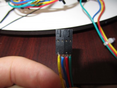

I checked the wiring again, and pulled each 4 pin motor connector out, inspected it and plugged it back in. All had a nice fit. Each has the wire order just like in the build manual, showing yellow, blue, red, green. I attached a photo showing the connector. I am using the repetier available on seemecnc. I have not altered the motor current, I have only done exactly what it says in the manual. Of course this could still be the problem.

Ok, give me a minute, but based on that picture the problem is in your cables.
Posts: 2417
Location: Redmond WA
Re: G28 problem- please help!
Post by Polygonhell »
The pins aren't fully seated in the connectors, they go all the way in and a bit more.

chbeckdb9 wrote:I checked the wiring again, and pulled each 4 pin motor connector out, inspected it and plugged it back in. All had a nice fit. Each has the wire order just like in the build manual, showing yellow, blue, red, green. I attached a photo showing the connector. I am using the repetier available on seemecnc. I have not altered the motor current, I have only done exactly what it says in the manual. Of course this could still be the problem.
yes those pins are improperly crimped, not allowing your pins to fully seat. they need to go all the way in.

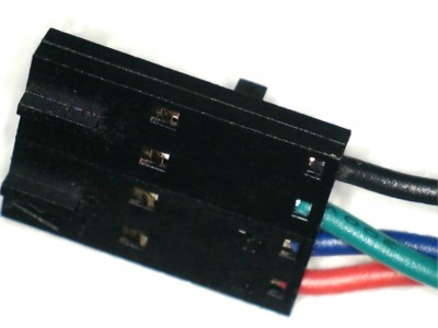

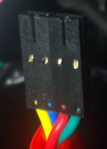

My dog came and threw up under my desk, so that took me longer than I thought.... you'd figure he wouldn't eat stuffing from toys if it did that but.....
Anyways.. Here's pictures of my connector. It clicks into place when done right, you should have to press the little tab down to pull the back out, and you will not see the base of the connector
edit: Just to give another example apparently lol...

Thanks! that got it working.
I really appreciate the quick responses, I can't believe I overlooked something so simple.
