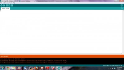

Im stuck on page 145 in the build directions and when i got to upload the new settings i get this screen.

CJGerard wrote:Im stuck on page 145 in the build directions and when i got to upload the new settings i get this screen.
You have downloaded the RepetierMAX software from github and extracted the .ZIP file, right?
In the Arduino IDE application, use File->Open. Navigate into the RepetierMAX/Repetier folder and open Repetier.ino.
Now you'll see a whole bunch of pseudo-C++ source code.
Select your board and port as Gene describes, then hit Upload.
Something will happen. Hopefully, something good.

sweet! THANK YOU SO MUCH. it worked hehehe
