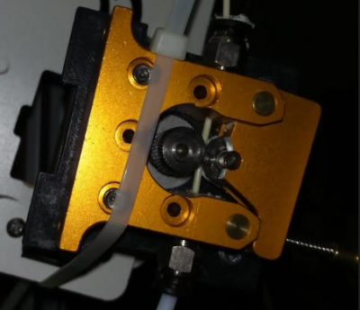

geneb wrote:Steps per mm for the extruder look to be unusually low to me.
Good catch! They would be if it were the original extruder. :)
I replaced my ez-truder with a:
https://www.ebay.com/itm/Aluminum-Bowde ... 2749.l2649
and I'm driving it with a NEMA 23 stepper.
The extruder had to be modified for the larger shaft of the NEMA 23 motor by drilling out the filament drive gear to 1/4" and then cutting away the extruder frame where it got in the way of the drive gear set screw (Lewisburg isn't the place where you want to live if finding small machine parts on a weekend is a necessity). This was actually a bit of a rush job so I had to make do with the parts on hand.
The screw that holds in the roller was removed and inserted from the inside of the extruder (where the screw threads are). I now have a NEMA 17 stepper motor with a 5:1 gearhead on it, which would at least look nicer (no tiewrap to hold things together). But since it is working flawlessly (not taking into account its looks), I'll probably leave well enough alone.
So far it has stripped the filament just once. That was because the filament had a "Z" crimped into it from the factory that wouldn't go into the head. That's it. :)

Yup! Grin.
After replacing the hotend, the old extruder worked much better. But it would still stall out for no apparent reason (although I now suspect that my volume problem was the root cause). I got *really* tired of having to nudge the filament along from time to time as it went, and so I got medieval with it. :)
