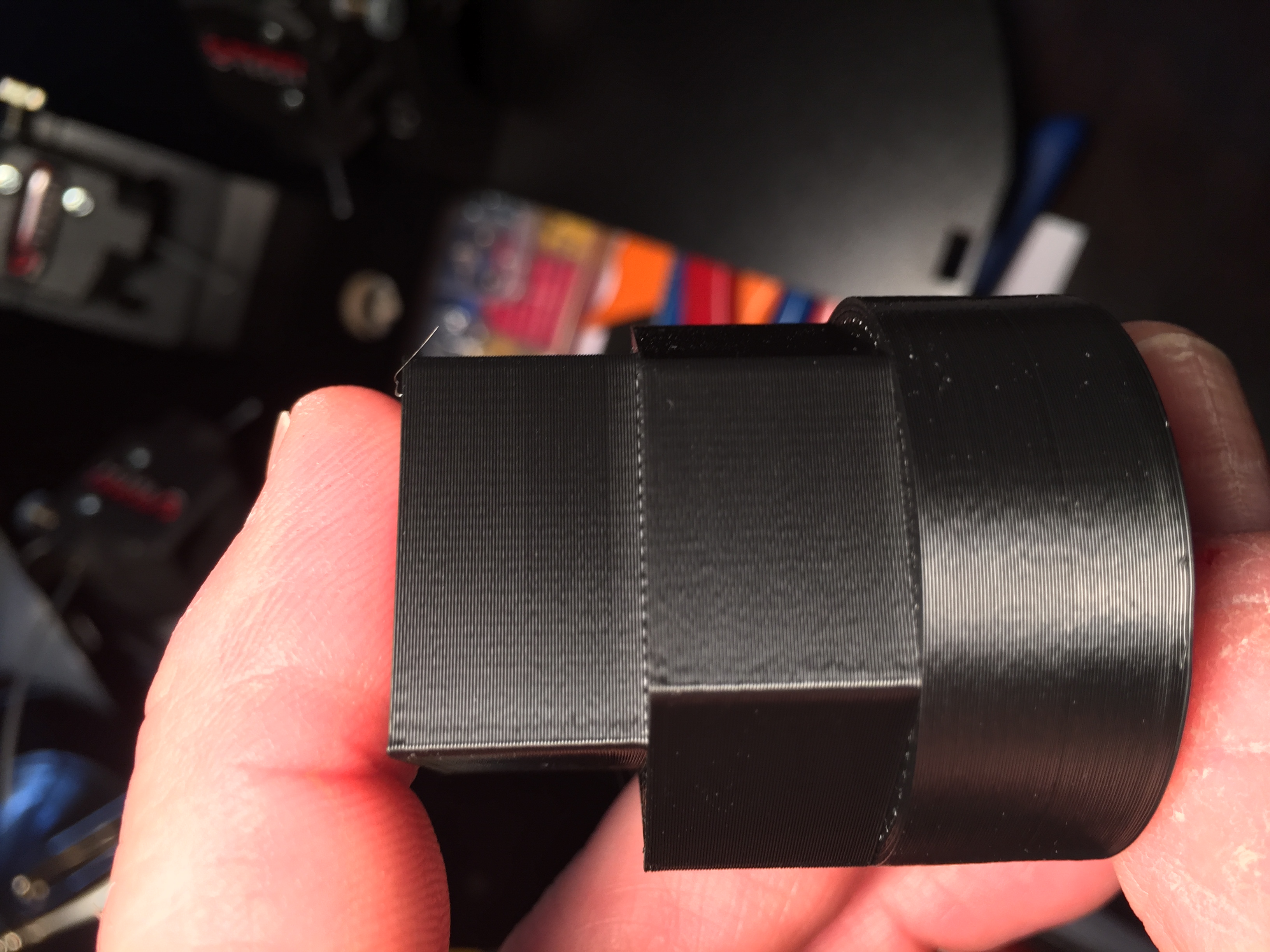

So there have been a few threads on this in the past: http://forum.seemecnc.com/viewtopic.php?f=54&t=4203&
But I can't find a definitive conclusion. Has anybody gotten closer to solving this:
[img]http://i.imgur.com/qUuzctT.png[/img]

I think the infill making such banding...I use cura and i use 20% infill overlap with walls... Which gives such banding but the part is almost smooth just you can see texture like this..i normally use 0.6mm wall thickness (0.2x3 layer of each wall)... do all of your parts the same banding i.e same pattern pitch?

On an unrelated note, what effector platform is that?

It could be possible that the smaller nozzle creating a thinner shell could be causing the infil lines to show through more? Do the align with the infil pattern?

You could isolate the possibility of infill affecting it vs delta segments by printing a large square vase with spiral vase or 1 wall no infil enabled

mlapaglia wrote:On an unrelated note, what effector platform is that?
It's the V1 platform, from before clip on arms. A disgruntled employee started running plastic parts that weren't black as a test, and they ended up in the junk pile.

What's your segments per second at? (EEPROM should be able to tell you)
Re: Vertical Banding Revisited
Some guys on the MakerHive forum recall that changing print speed would effect this... um... effect. If it's a resonance problem, test it by changing the frequency.
I'm going to do a control piece, then print the same code with the speed multiplier turned up, and then I'll try slicing it faster as well.
Running a job at the moment, but I'll look up my segments per second too.

I get some vertical artifacts, and if I change speed - go slower - they go away. Mostly they are just a surface texture and I don't care if that is part of the price of printing fast.
