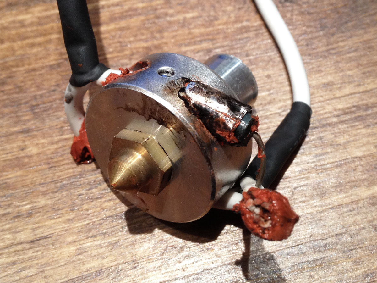

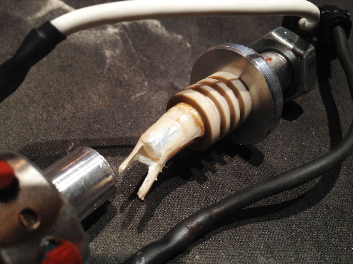

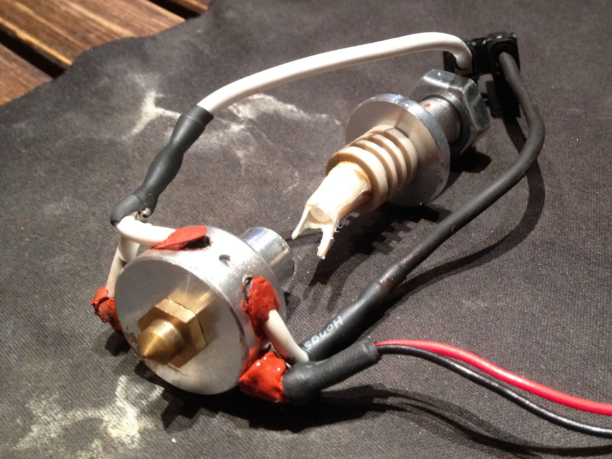

Hi guys, I was just finishing my build, started with the soft... and when I turn on the Hot End to check it was working, smoke started coming out.
After 1 min, the Hot End melted and broke in two pieces.
I'm so frustated, this is my first 3d printer and everything was going well.
Here is a pic:
Will upload a video in a few minutes.

Seems like the only possible cause for that would be a short in the resistor installation. Surprised you didn't blow a fuse on the Rambo though...
I'm a noob though, so let's wait for the more experienced guys to chime in.

wowsers, this happened to me, but i caught it before fire.. My cause was i tried to exceed the temps of the PEEK unintentionally. gotta stay below the 250's mark or the PEEK will melt. I would also think that a short from the resistors would cause a fuse to blow... but that didn't happen here.

How can I check if I exceeded the temp of the PEEK? (don't know what that isbubbasnow wrote:wowsers, this happened to me, but i caught it before fire.. My cause was i tried to exceed the temps of the PEEK unintentionally. gotta stay below the 250's mark or the PEEK will melt. I would also think that a short from the resistors would cause a fuse to blow... but that didn't happen here.
Thermistor short... could be, but I double check that before putting the RTV.
did this: "In order to make them bigger, you’ll need to cut a strip of aluminum foil and wrap the resistor. You want the width of the foil strip to be about 1/16” shorter than the length of the resistor body so that it can’t come into contact with the leads on either end of the resistor."
But it does look like a short...
And I thought that the smoke was normal

The PEEK is that tan plastic part of the hot end. It can only take around 240-250C before melting, but I don't think that's your problem here. This looks more severe than that. It does look a little bit like a short in the resistors there - especially that one spot on the head that looks blackened.
I did not use the tinfoil, based on some comments from one of the SeeMeCNC guys where he mentioned simply putting the resistors in and pumping the holes full of RTV. That's what I did, and it seems to work beautifully. My hot end heats up very quickly and there should be no chance of a short with everything filled with RTV.

Oh the PEEK definitely melted. Based on what I see, my guess is that your resistor leads were touching the heater block. You'll need at least one new resistor, a new PEEK section, and possibly a new thermistor. Get yourself some kapton tape and wrap the leads of the resistors from the body of the resistor up to the connection with the other resistor so that you can't do that again.

The absolute maximum temperature on that type of hot-end is 240, if you exceed that your Peek
part of the hot-end will start to soften. You should invest in an inexpensive thermocouple and
meter to put into your hot-end to verify that the reported temperatures are accurate. Here is another

I've just purchased another Hot End kit, a peek, thermistors, resistors and also two 40w cartridge heaters just to be covered. The Kapton tape is arriving this week, or maybe the next. Here in Argentina it doesn't exist.
I was very careful with the tinfoil, also with the wiring. I double checked those connections. My guess is that the thermistor was not working, because the Repetier-Host never showed the temperature increasing. And about the smoke... yes, I've seen some 3d printers working, and I know they shouldn't do that, that's why I film it. But I thought it was a onetime only thing, like part of the calibration process... now that I read what I was thinking atm, it seems wrong, I know =/

I would agree that is a good possibility or the thermistor did not have a good thermal connection to the hot end. My thermistor worked its way out of the hole and I ended up melting the PEEK on my hot end.Tincho85 wrote: My guess is that the thermistor was not working, because the Repetier-Host never showed the temperature increasing.
