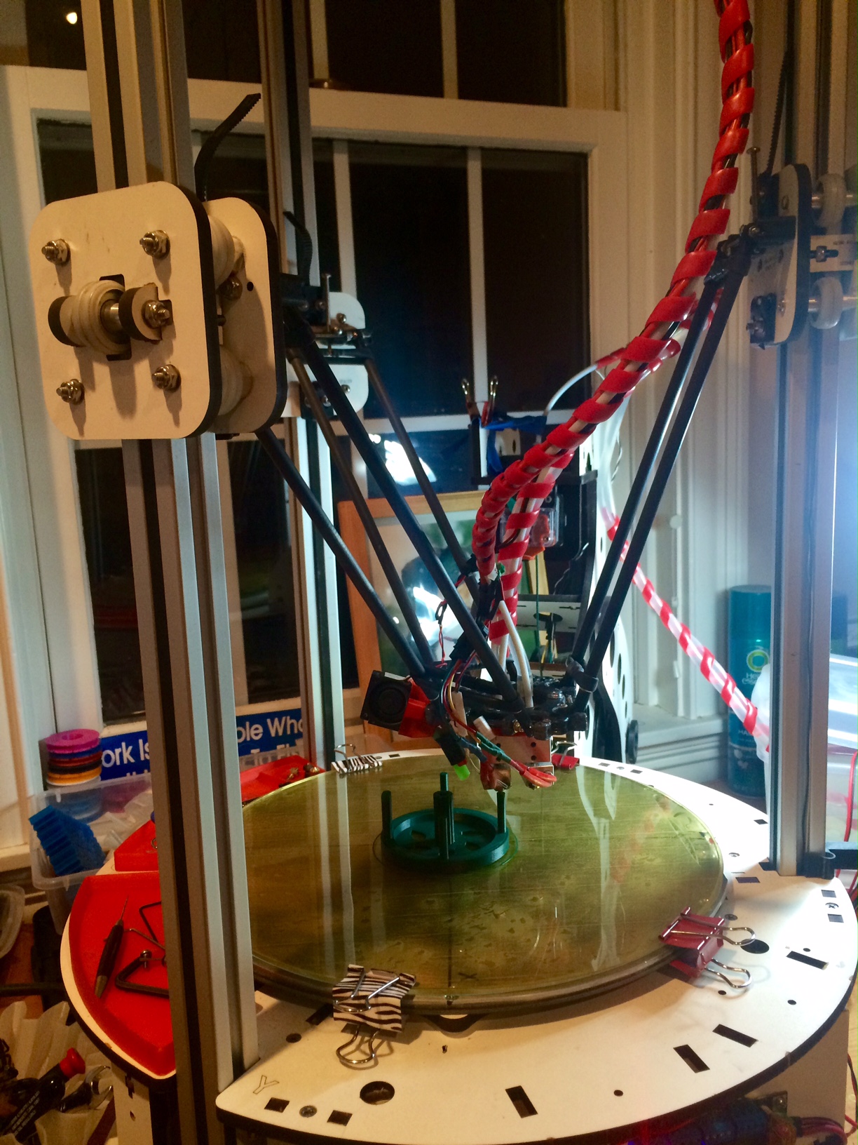

I took this photo a few minutes ago for a gent on another thread. But I realized you can see the PEI surface quite clearly (click the photo to see the high res version).

How do you clamp down the aluminium, glass pei combo to the onyx.
On my last few prints it has shifted rather badly...
nitewatchman
Posts: 624
Location: Birmingham, Alabama
Re: PEI print bed surface experiments
Post by nitewatchman »
I use the industry standard 3-D Certified Paper Clips (5).
