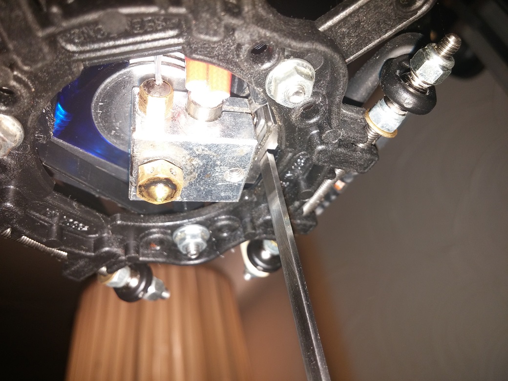

duvdev requested close-up pictures of my setup earlier. Definitely need to get a Z-probe.
On a second note, I am currently testing the new XYZ offset which will replace the Delta Radius "calibration". I am sure this is not the only mistake I have made, so if you notice one please let me know. Also, thank you JFettig! Please dig for more errors!
I do plan on actually calibrating the Delta Radius, I just have not figured out how to do it at the moment.

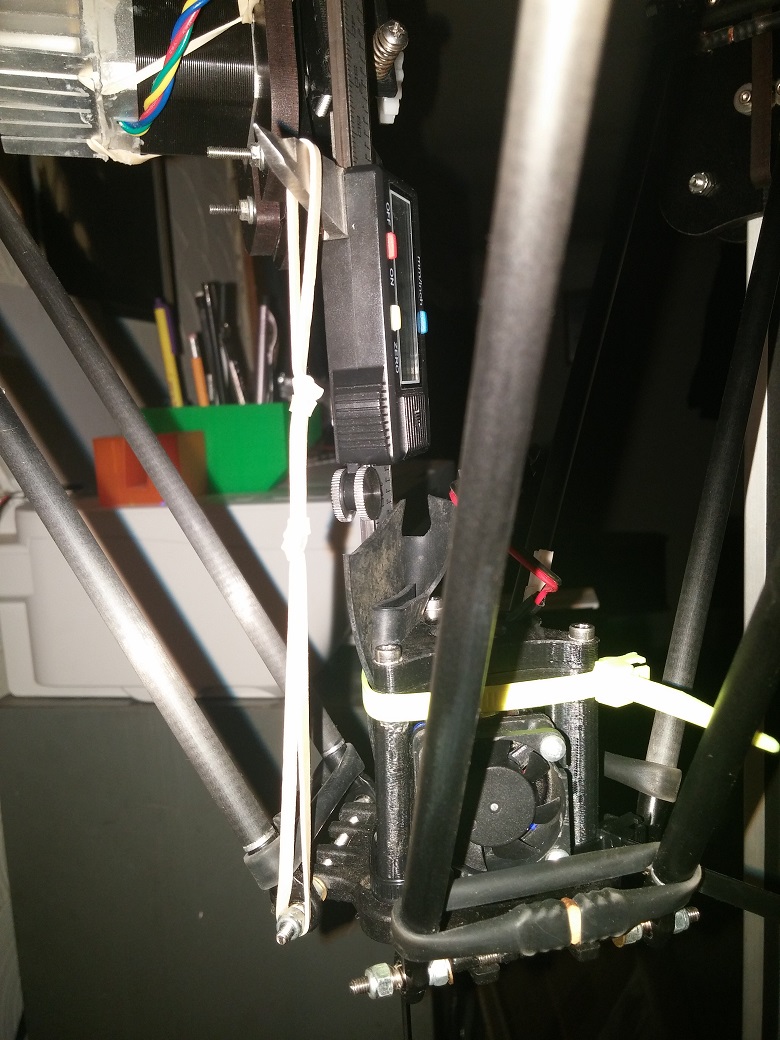

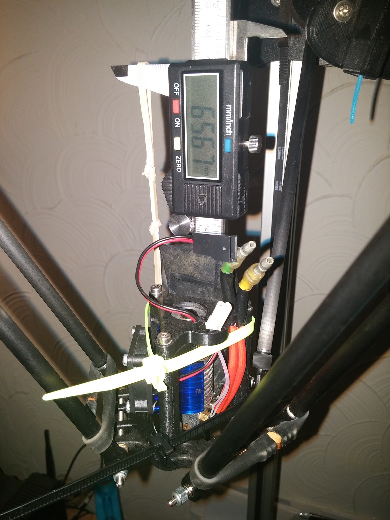

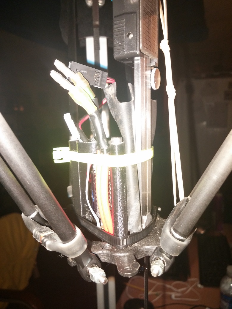

Properly calibrated with 4 point calibration, diagonal rod length(for x-y calibration), horizontal radius, and tower rotations you can get it dialed in perfectly. I do believe the delta a, b, c adjustment could further calibrate it but we don't have good enough tools to actually know that we're getting things dialed in better. With these my printer prints flat and to proper size.
I haven't touched your program, just the theory. While you can make it give you flat build plate, you need to do so without greatly effecting other factors.
Take your pick, anything is better than a zip tied rubber banded depth measuring caliper :P

Thank you for the links, I am going to order one tonight!

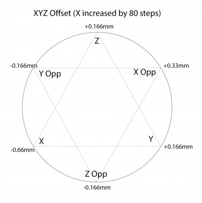

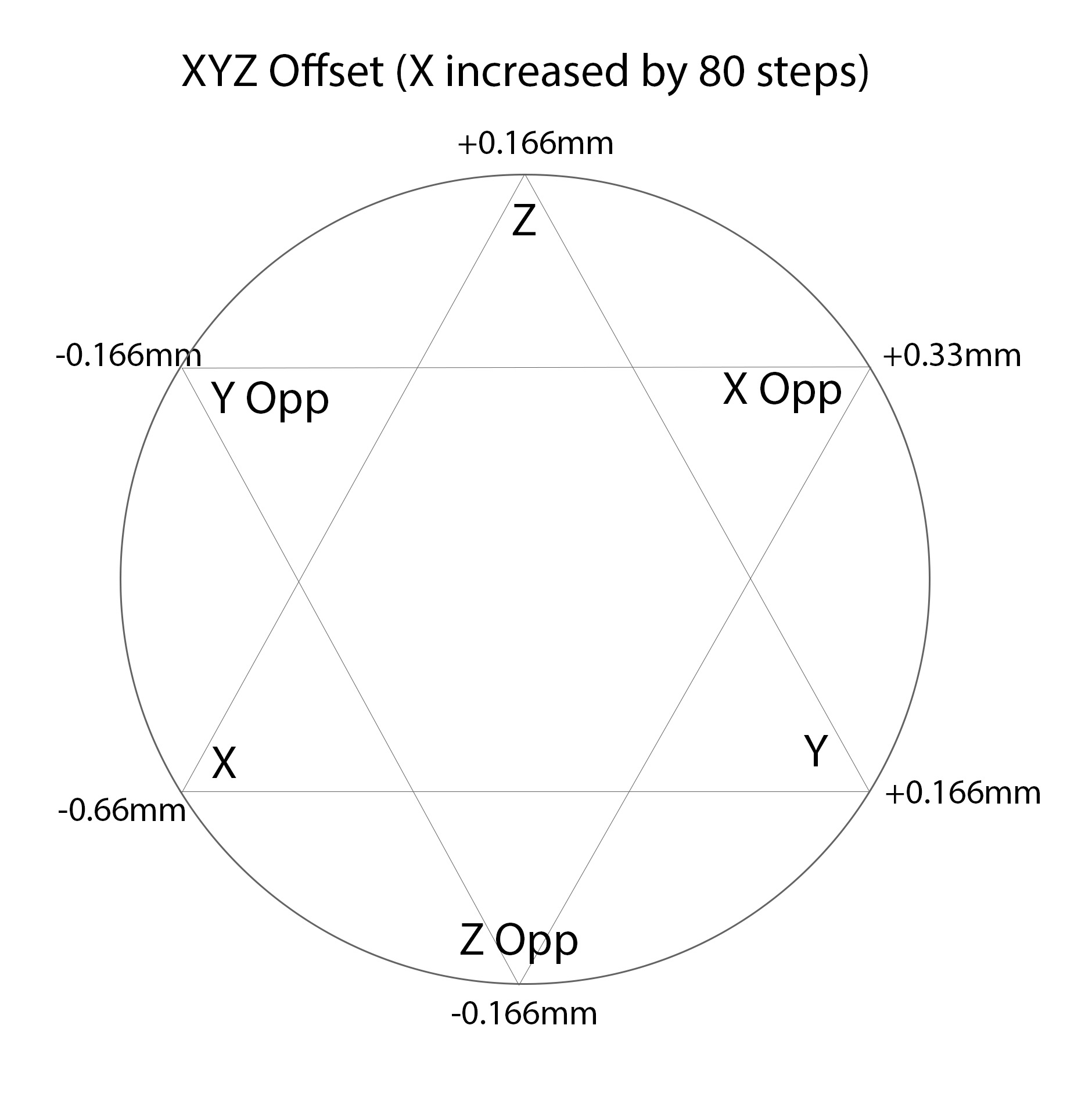

I just completely bypassed the Delta Radius, now that I know that it affects more! And not just theoretically, once I had corrected the XYZ offset, it worked flawlessly.
The actual XYZ offset when changed 80 steps
The values for the diagonal rod, horizontal radius, and tower rotation all changed in more believable ways, i.e. by lesser amounts.
After 4 iterations, with the 7 point calibration, the build plate was 0 all around. So this time, in theory, the XY dimensions should have correct values. Not only that, the calibration took a fraction of the time because I was able to skip the whole Delta Radius portion!

I'd use a thin feeler gauge instead of paper...
