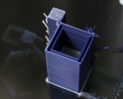

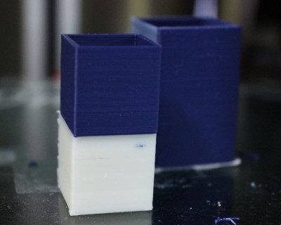

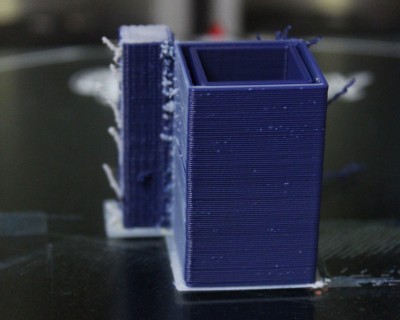

Following are photos of my first dual extruder print. The two parts of this design are a hollow box (printed in white) measuring 20mm X 20mm X 20mm; it has 1mm thick walls. The other part (printed in blue) is a square tube measuring 20 X 20 X 20mm with 1mm thick walls.
I sliced the .stls with Cura 14.01, and selected both the "Ooze Shield" and the "Wipe and Prime Tower." The "Ooze Shield" surrounds the print. The "Wipe and Prime Tower" is at the rear left corner of the print.
I still need to adjust flow control on the blue filament. I also need to tweak the X and Y Offsets by about .1mm on both extruders.
Progress!
Bill
Progress!
Bill

Looking good Bill. Doesn't it feel good when you get something working?
The prints look good, with a little more tweaking they will look fine.
