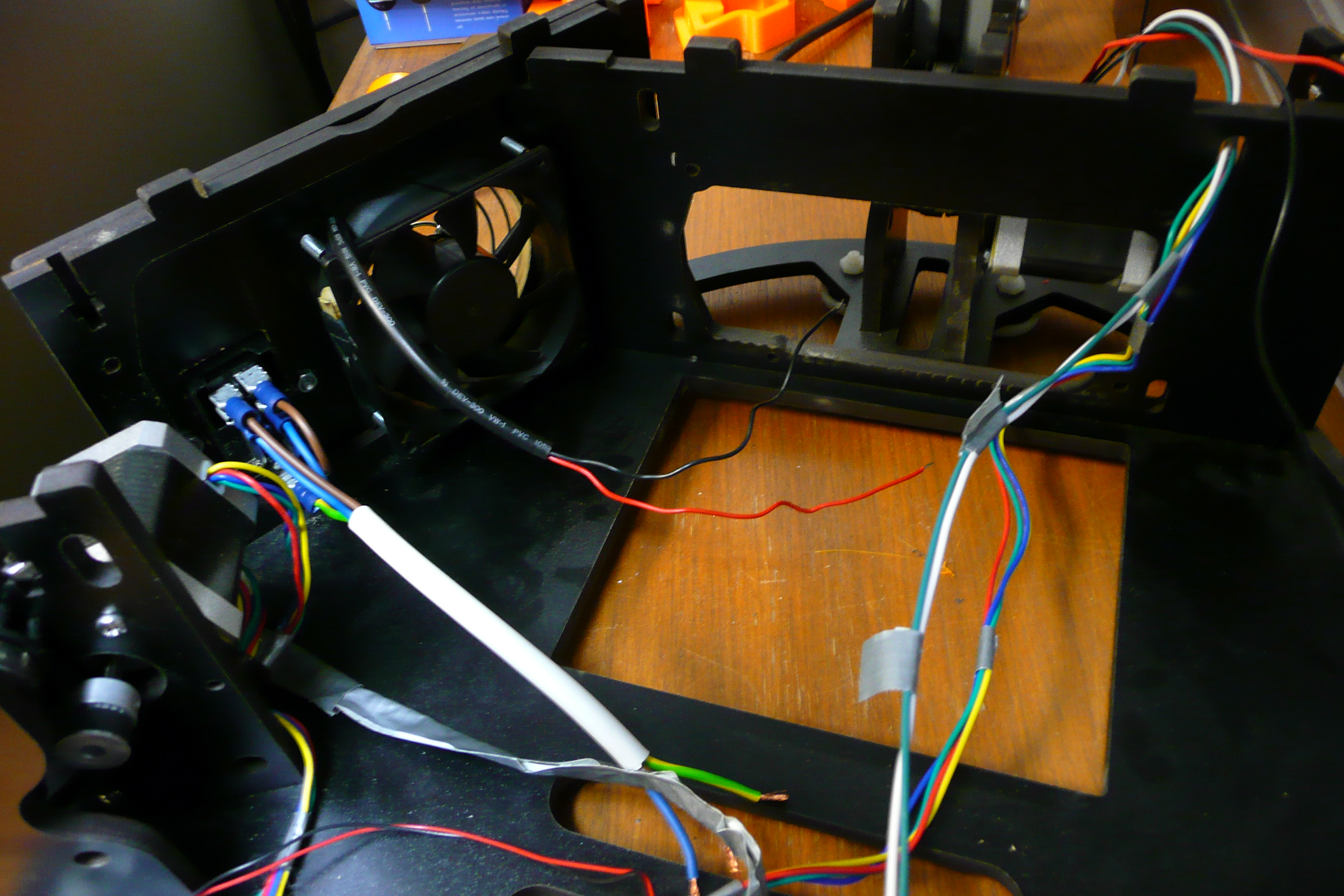

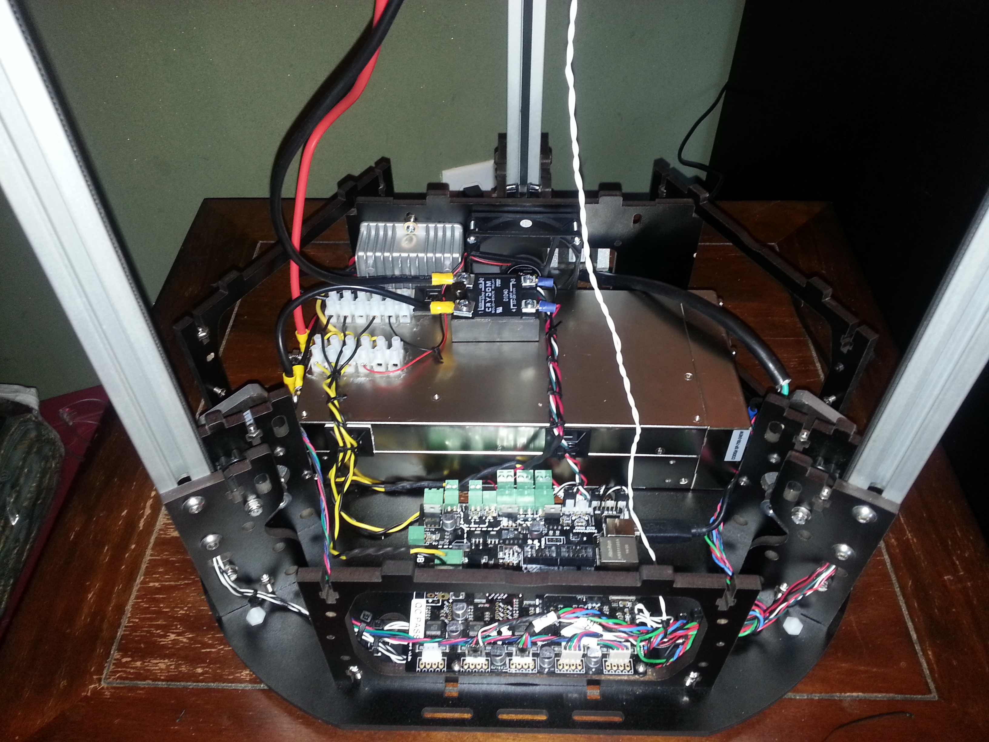

Had the parts for a little while, just dreading taking everything apart again. Then realized I could just lift the top portion of the bottom housing.
Tomorrow I'll get the thermal images of everything heating up. Curious how the 10awg wire will handle the increase in power (the power-supply is set to 20v).

Clever solution KAS. I'm glad it fitted there.

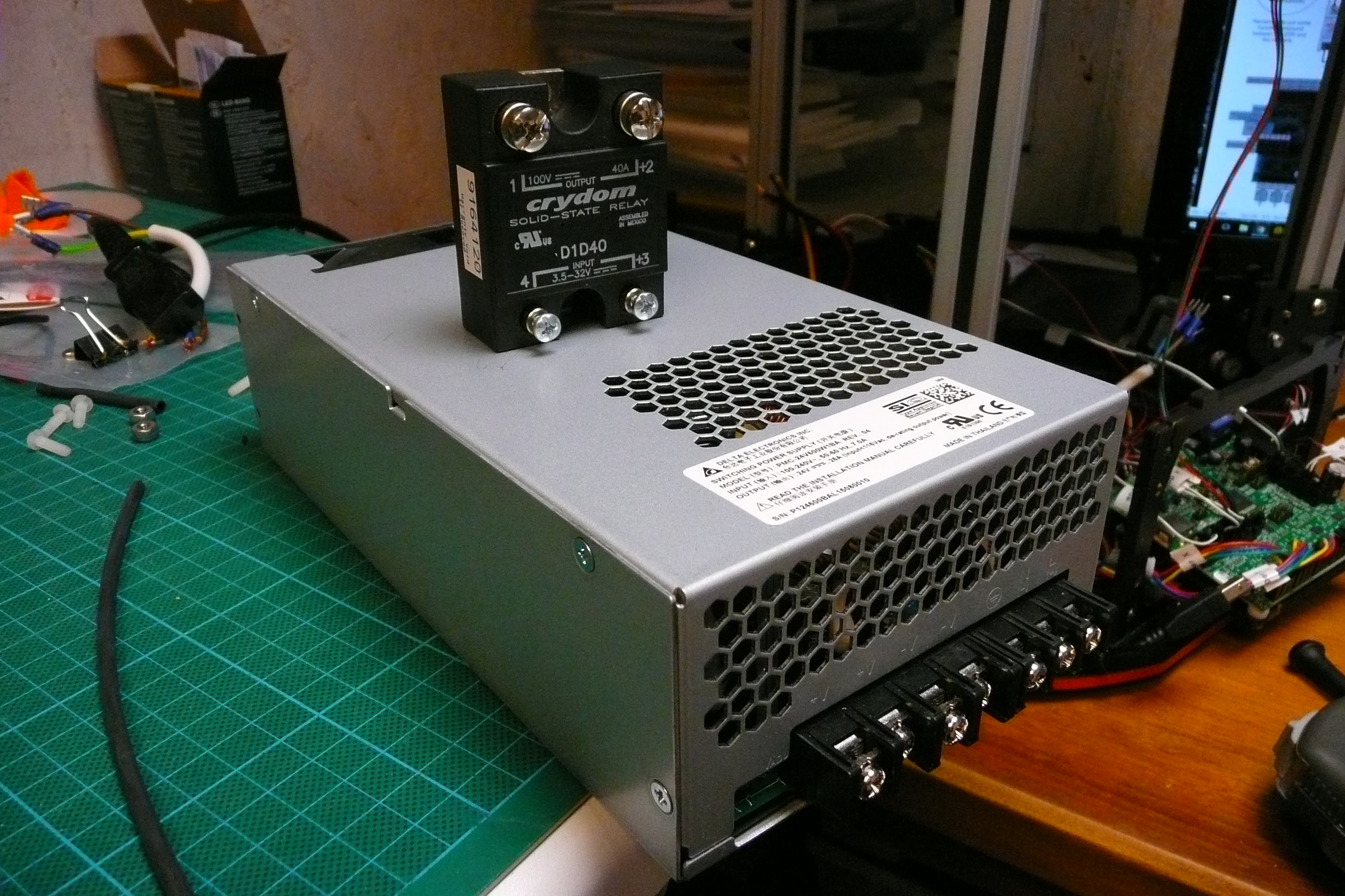

Looks like that 24V psu (which I'm assuming is a Meanwell SP-750 by the looks of it), fits much nicer in the bottom of the Rostock Max V2 than it would in my V1. The size of the PSU and lack of mounting options is why I haven't done my 24V upgrade yet.
Re: 24v install
Correct, it's the Meanwell SP-750-24. It was a tight fit, and looked a lot better until I started wiring everything up. The SSR doesn't get warm at all, but I decided to shoehorn in a fan near it anyway. The fan from the supply seems to provide ample cooling on it's own.

Re: 24v install
That the approach that I took. I mounted the IEC Fused Receptacle in the removable rear panel next to an 80mm exhaust fan centered in the panel.

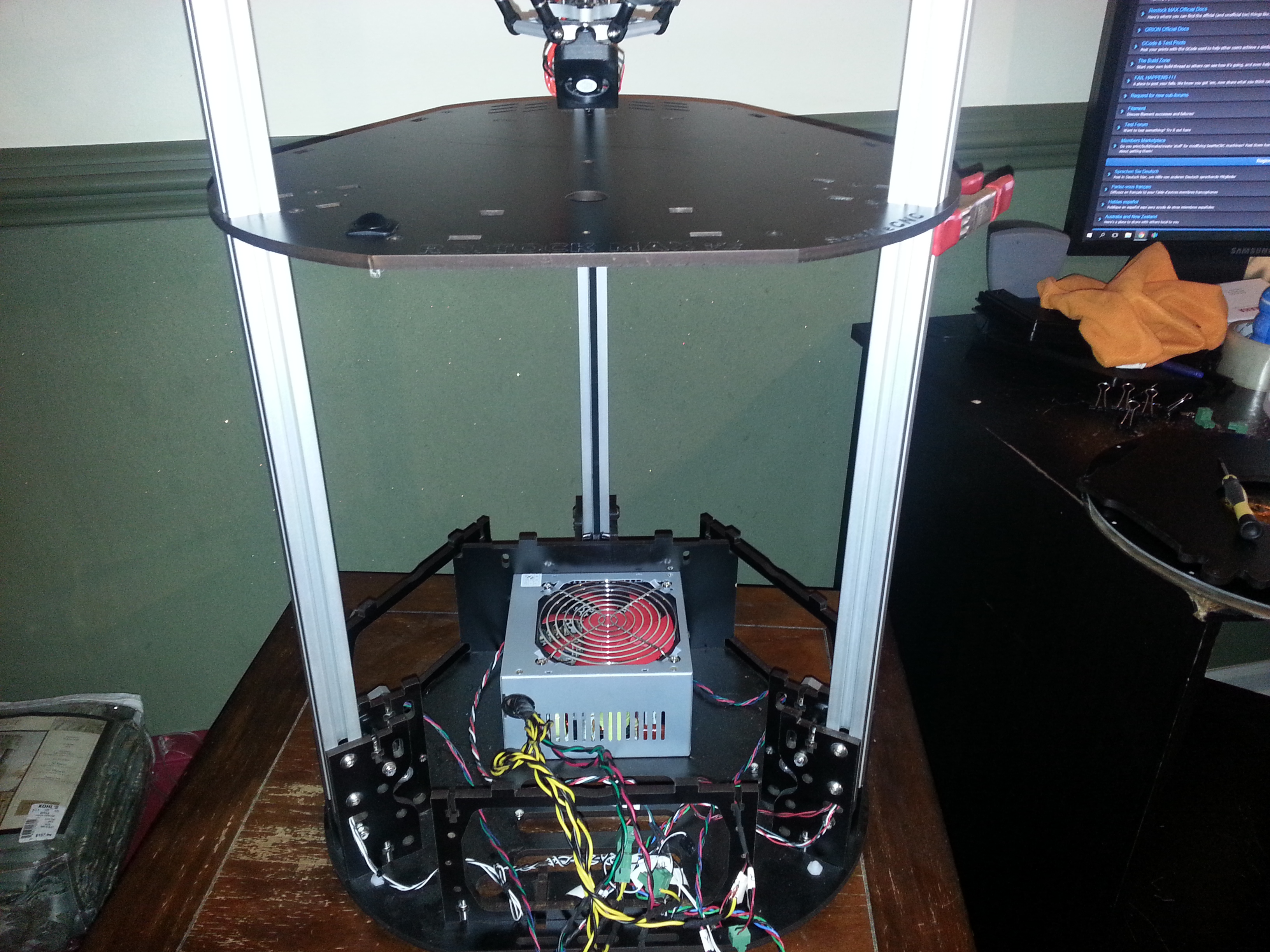

Lifting the top plate is a great idea! I am using that as an excuse for starting my own 24V conversion
. After dismantling the original Viotek from the base I see a big square hole in the bottom plate. Does this have a function? There is no airflow on the bottom side of the Viotek PSU, neither on the new Delta brand PSU I will be using. The delta looks a lot like the Meanwell. What the best way to fixate this PSU? I am thinking a few stripes of industrial foamtape, but I guess I am lazy...
I also added an 8cm fan to suck the air coming from the PSU out of the base, and added a 240V receptable with fuse too. I think I will be adding airflow to the opposite removeable plate also, to let the PSU fan suck air into the base.
Re: 24v install
The hole is there to allow the power supply to drop out through it once the screws for it have been removed.
